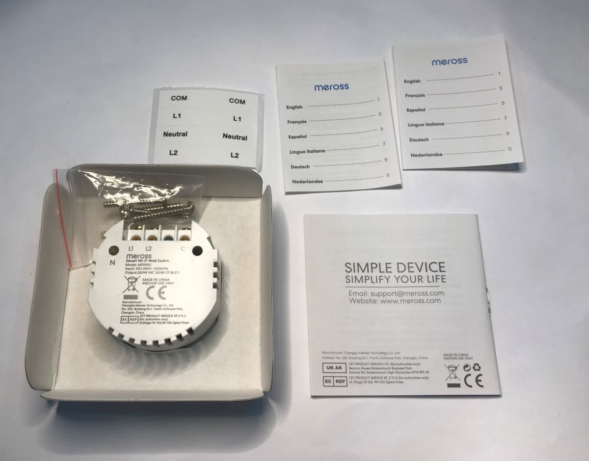

    Here I will introduce two Meross MSS550 switches, the first a touch-sensitive version and the second based on a 'clicky' microswitch. I'll examine how they are built and then I'll post the information I've gathered so far about the interesting Wi-Fi chip on the inside - the Mediatek ARM MT7682.
    Two Meross Smart Wi‑Fi Wall Switch MSS550 boxes side by side on a light background

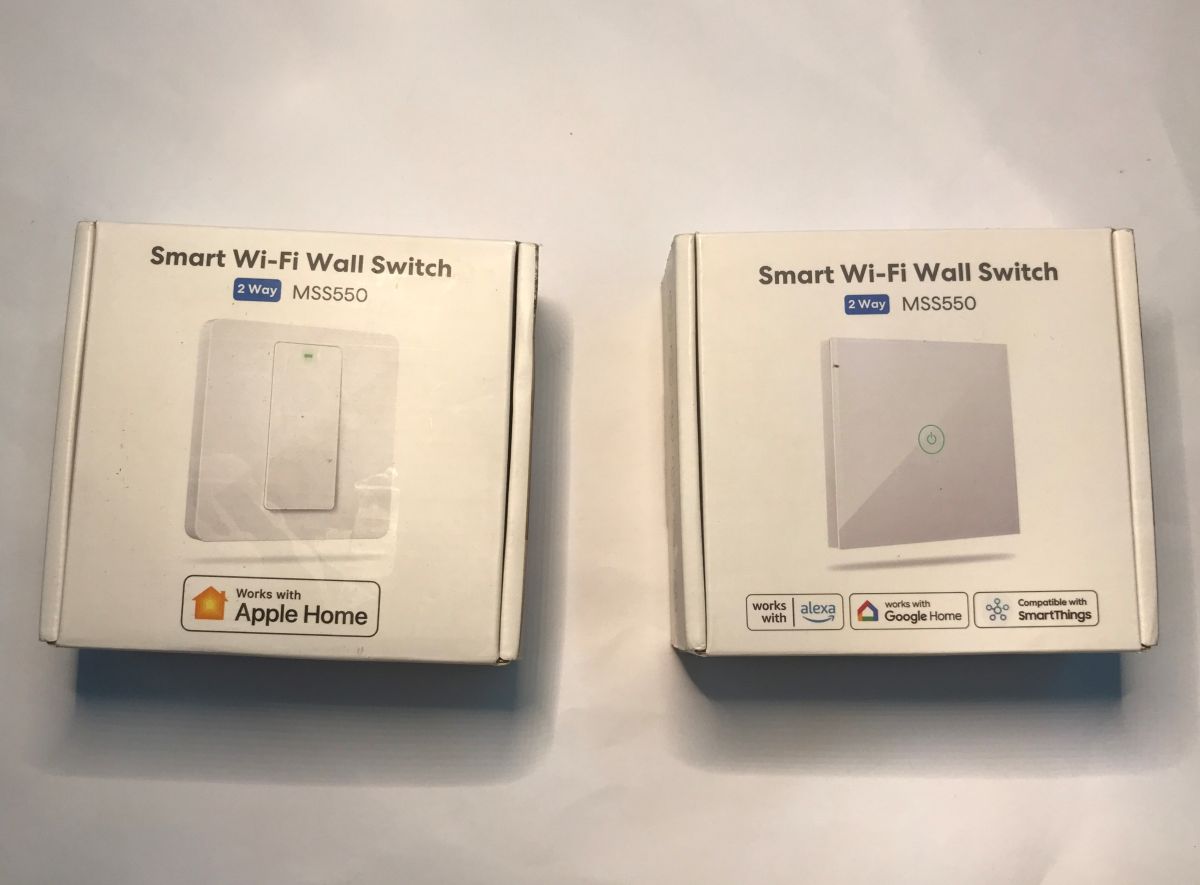

    I guess we should start with the fact that despite such a dramatic difference as the control method (touch vs. mechanical), both products share the same model name and I don't see any distinguishing features on the packaging except for the picture. This is quite strange and potentially problematic.
    Meross Smart Wi‑Fi Wall Switch 2 Way MSS550 box with Alexa, Google Home and SmartThings logos Back of Meross MSS550 wall switch box with technical specifications, warranty badge, and barcode Meross MSS550 package contents: round switch module, screws, and instruction booklets on a white background
    The full model name is in both cases MSS550-EU-TOUCH V3.0. There is also a US version, but it is for this "rectangular" box. How to connect the switch is specified in the manual:

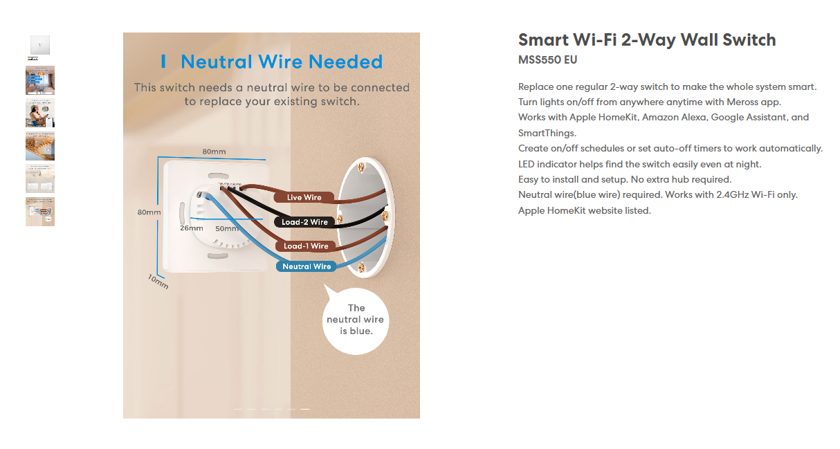

    Here you might wonder why the C and L1 and L2 designation when there is one touch - it's because this switch supports a staircase installation. It alternately switches on either L1 or L2, and C in turn stands for Common - a common line - see image from instructions.
    Wiring diagram for Meross MSS550 EU smart 2‑way wall switch showing neutral wire required

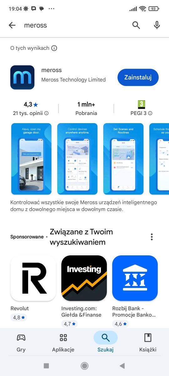

    The switch is compatible with the Meross app - then you can connect it to Apple Homekit:
    Google Play listing screenshot for the “meross” app, showing the Install button and app details App screen with a list of smart device types to add and a message that no nearby devices were found. App screen listing Meross switch models, including MSS510, MSS550, MSS560, MSS565, and MSS570 series.

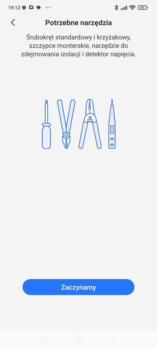

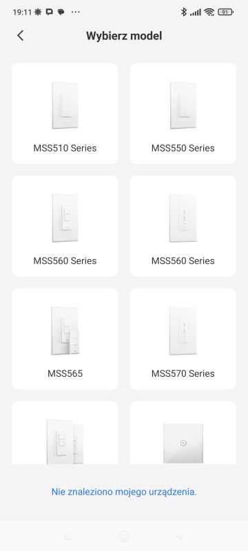

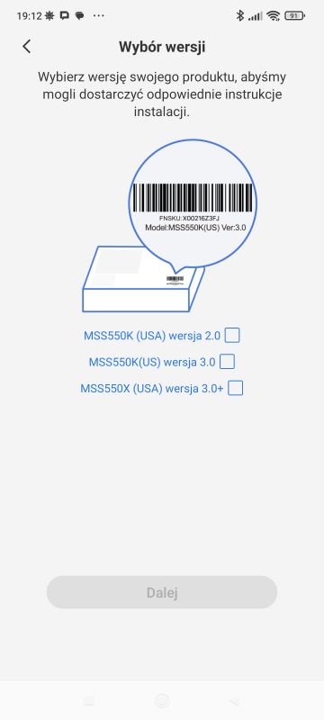

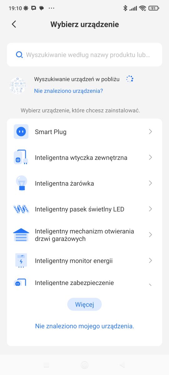

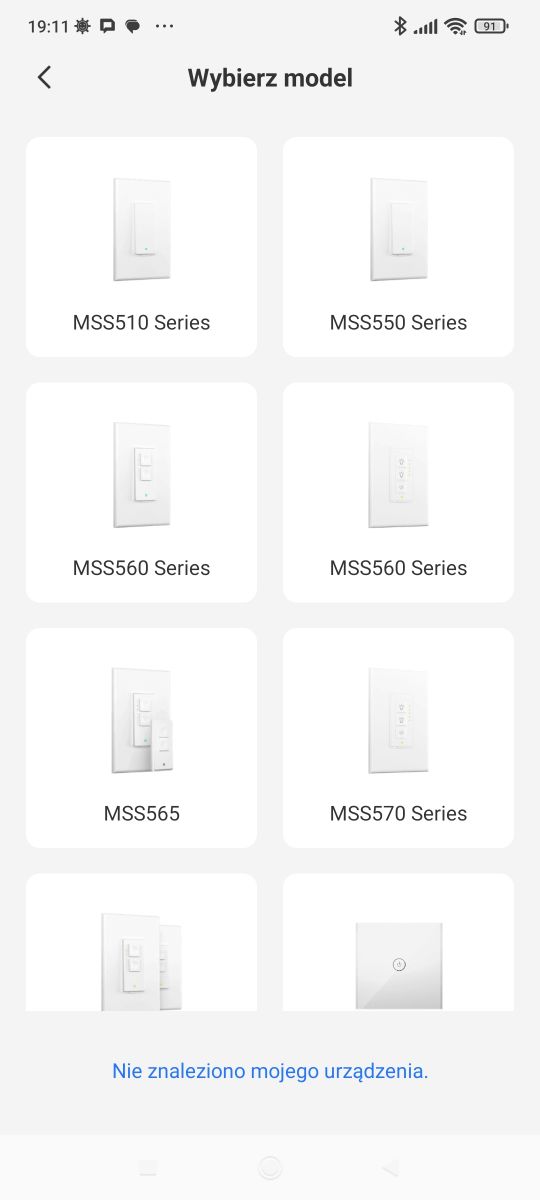

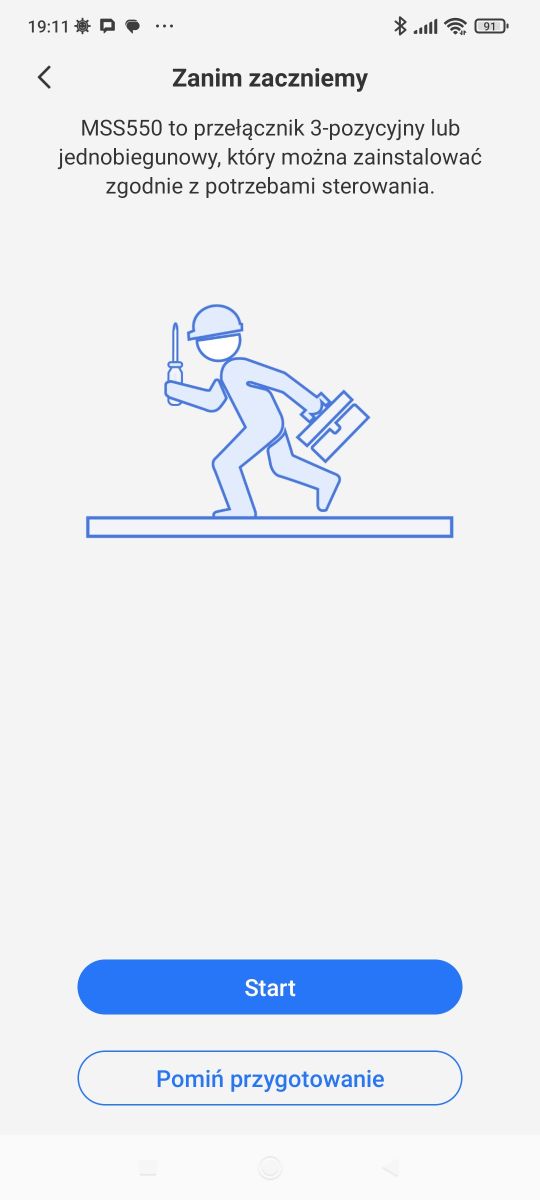

    The control itself is no different from other popular apps such as Tuya or eWeLink. What deserves a mention, however, is the pairing. Here, the app asks us whether we want the full version or the abbreviated version, and in the case of the full version it even displays instructions as to the electrical connection. There is also no clutter here as in Tuya, here we pair products by their previously known model by the app.

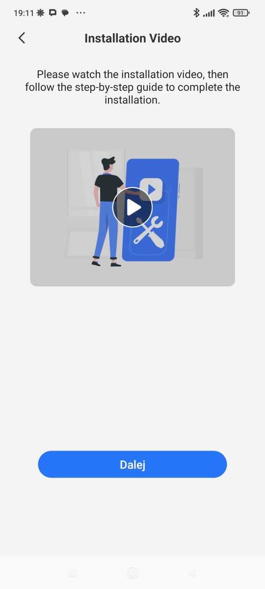

    Phone screen showing “Installation Video” page with a “Next” button at the bottom. Meross app screen showing “Before we begin” setup page for the MSS550 switch
    App screen titled “Potrzebne narzędzia” with icons of a screwdriver, pliers, wire stripper, and voltage tester App screen for selecting product version MSS550K(US), with options version 2.0, 3.0, and 3.0+
    After pairing as standard - we have remote control, automations, timers.

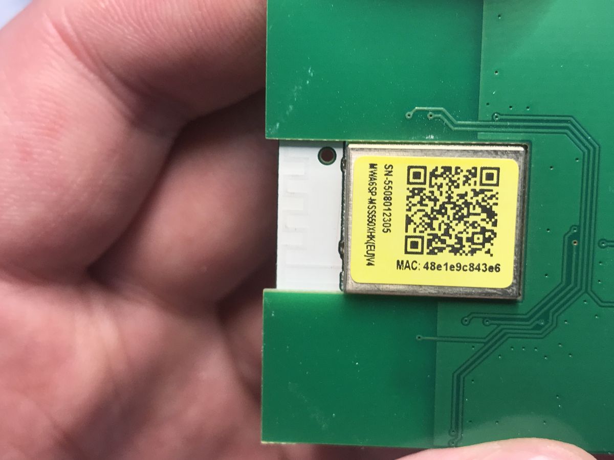

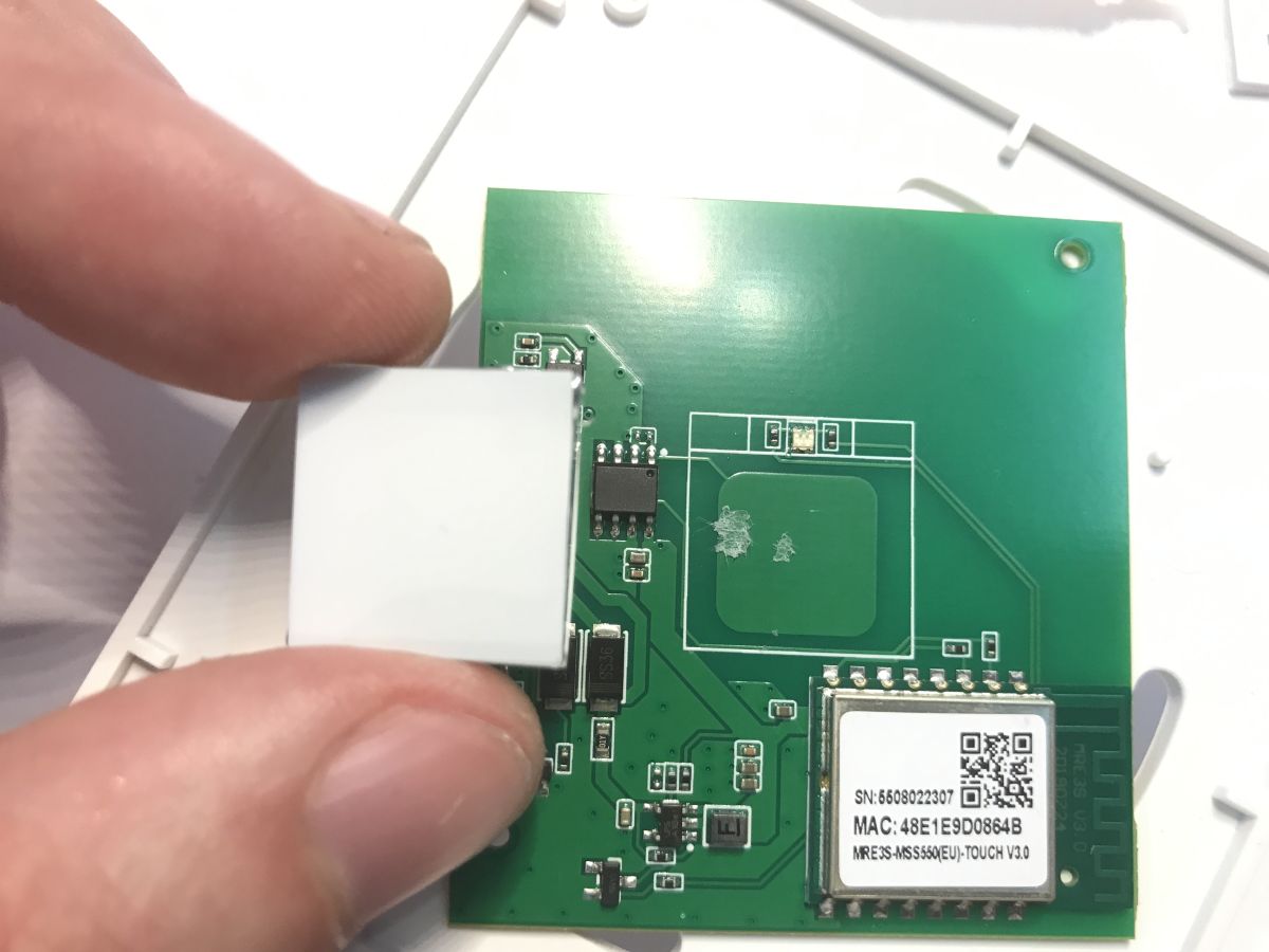

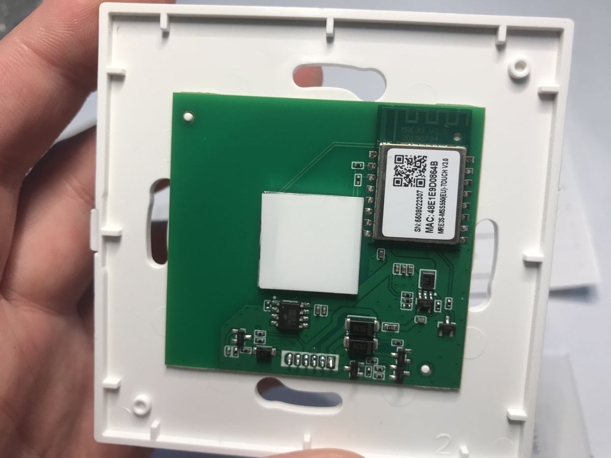

    Interior of the MSS550

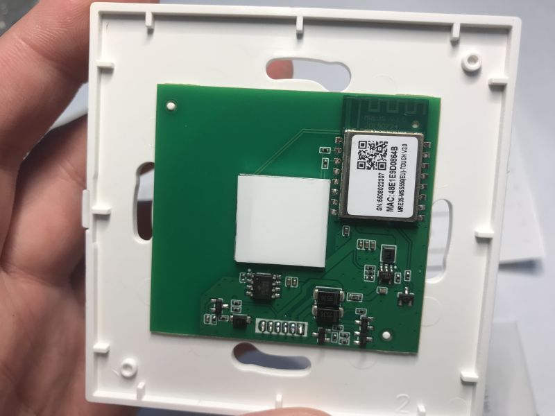

    However, I'm most interested in the build of these types of products and whether they can be altered with firmware to make them cloud-free. For this reason, I took a quick look inside.
    Green PCB inside a switch housing with a Wi‑Fi module and a QR label in the top-right corner

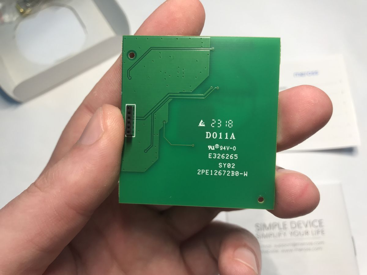

    The markings on this Wi-Fi module don't tell me anything. Could this be some kind of novelty, or rather something I haven't seen before?
    Green PCB held in a hand, with white markings “2318” and “D011A” and a connector on the left

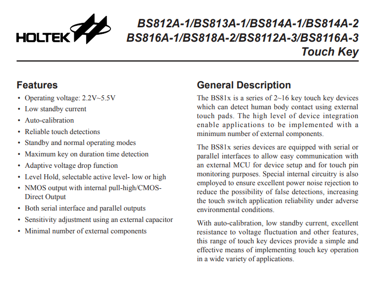

    The board itself is very simple, so we won't find the answer to that here, although you can still see the BS813A, the touch button controller, in the corner.
    Excerpt from Holtek “Touch Key” datasheet listing BS81xx ICs and a “Features” bullet list.

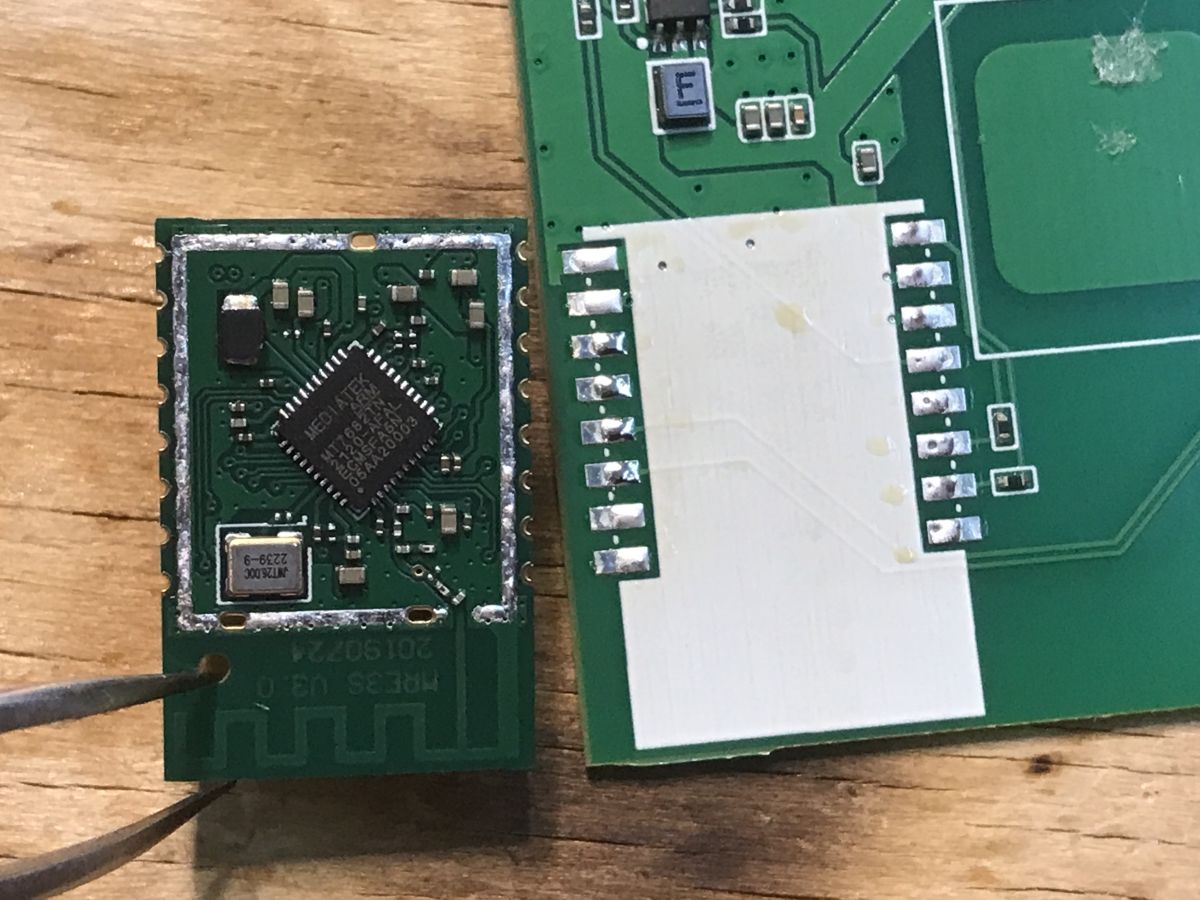

    The Wi-Fi module therefore needs to be soldered out. Rather only hot air comes into play, but first you need to remove the component from the touch button, which is easy to melt. Simply peel it off.
    Green PCB with Meross Wi‑Fi module labeled with QR and MAC; fingers hold a white block over the circuitry

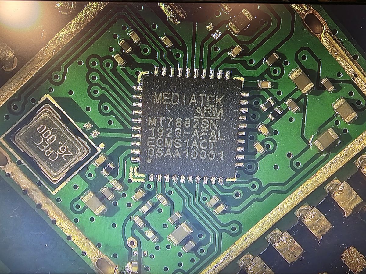

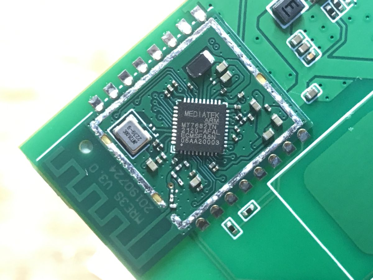

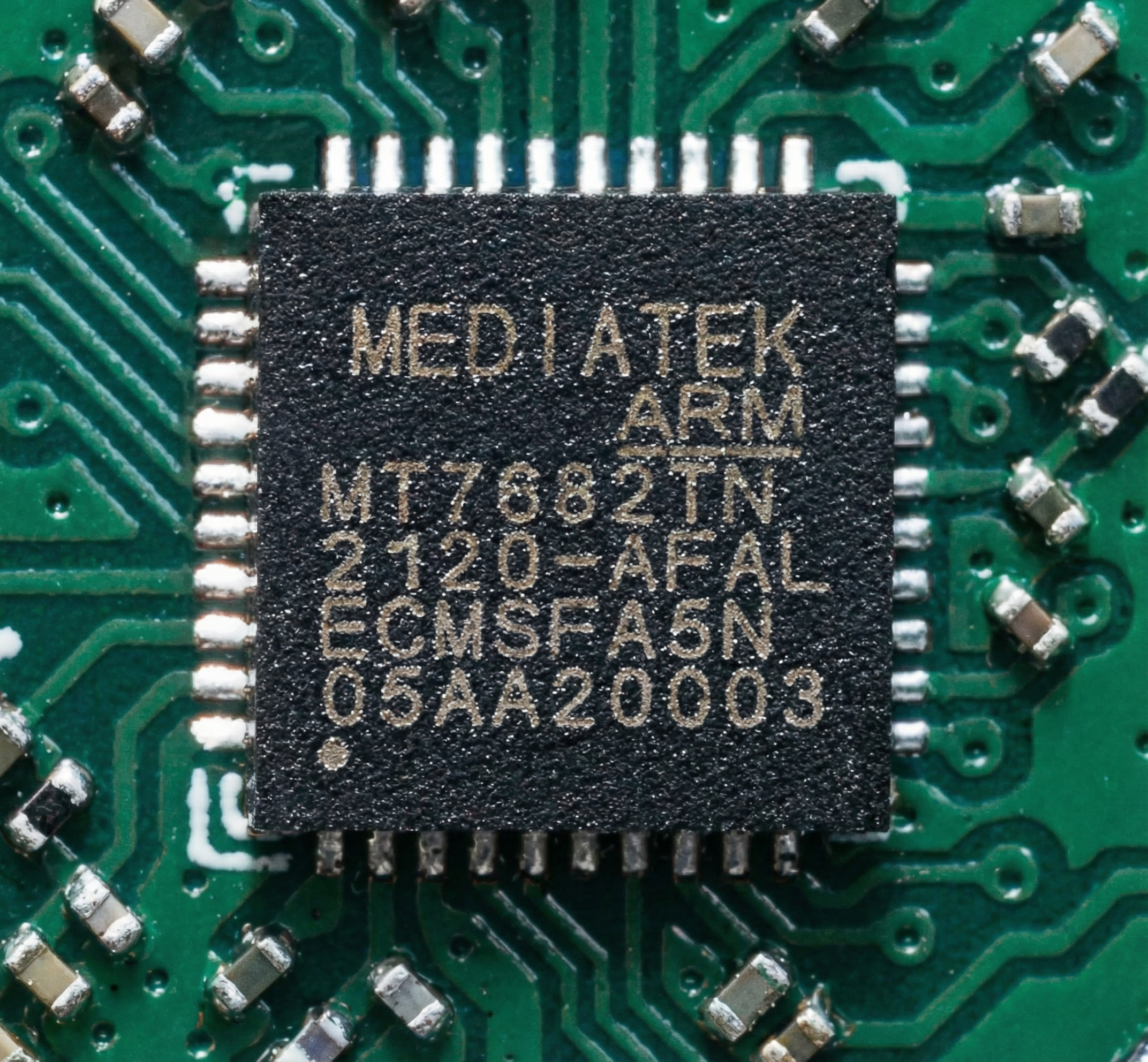

    The first one, however, I soldered off the screen. Inside the module is a Mediatek chip.
    Close-up of a Wi‑Fi module on a green PCB with a MediaTek MT7682TN chip

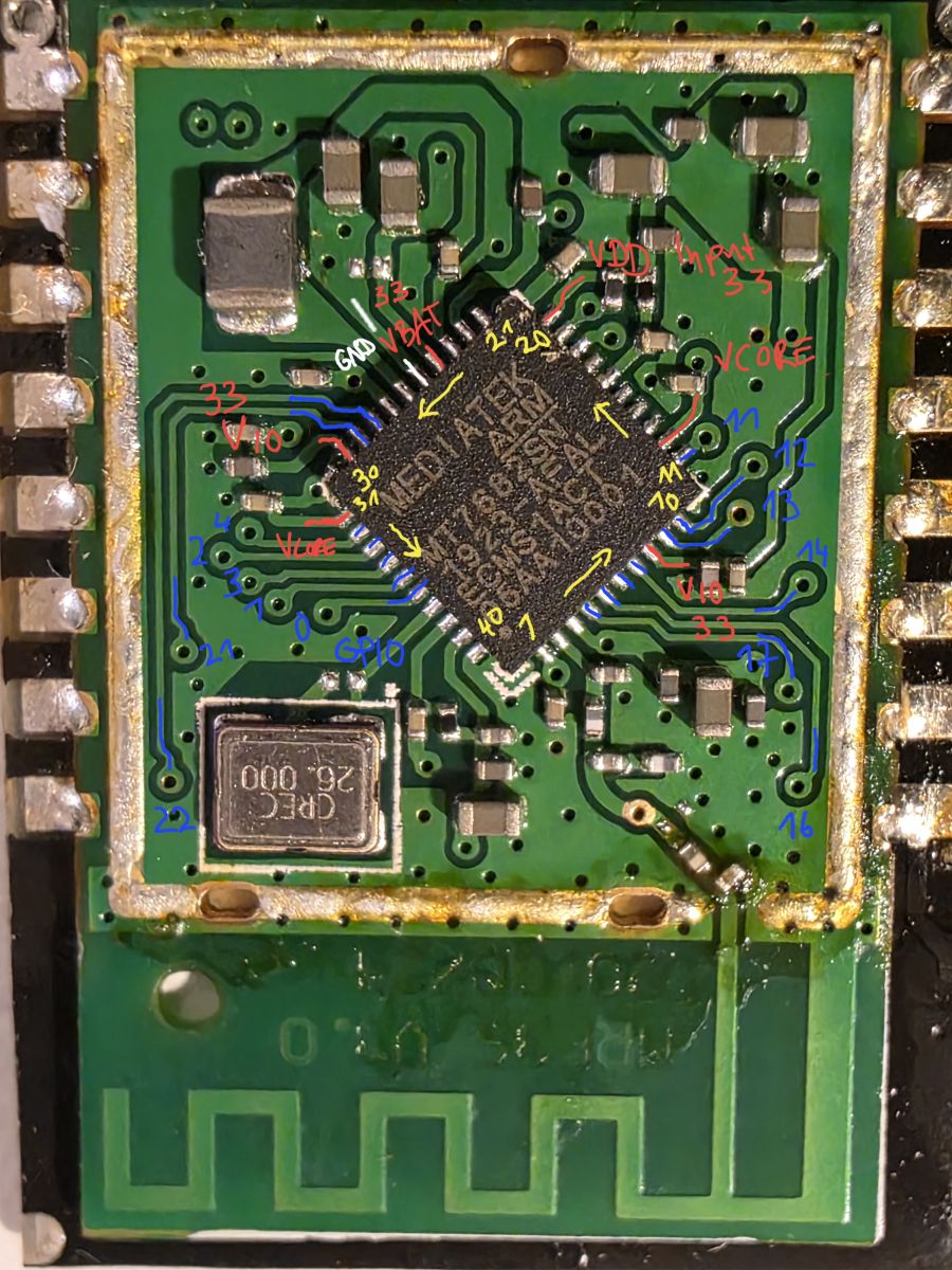

    I didn't stop there though, as I wanted to check the pad markings on the description layer.
    Close-up of a Wi‑Fi module on a PCB with a MediaTek chip next to an RF shield

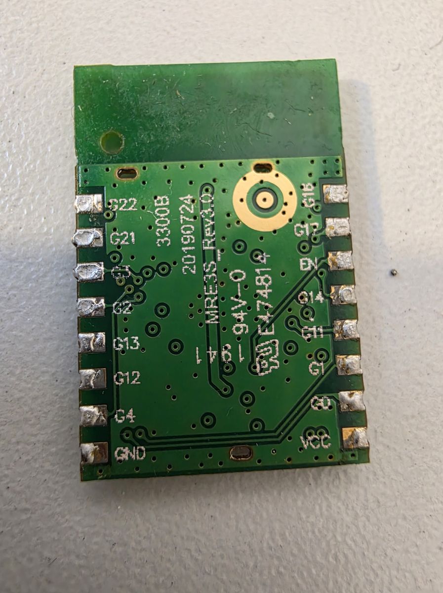

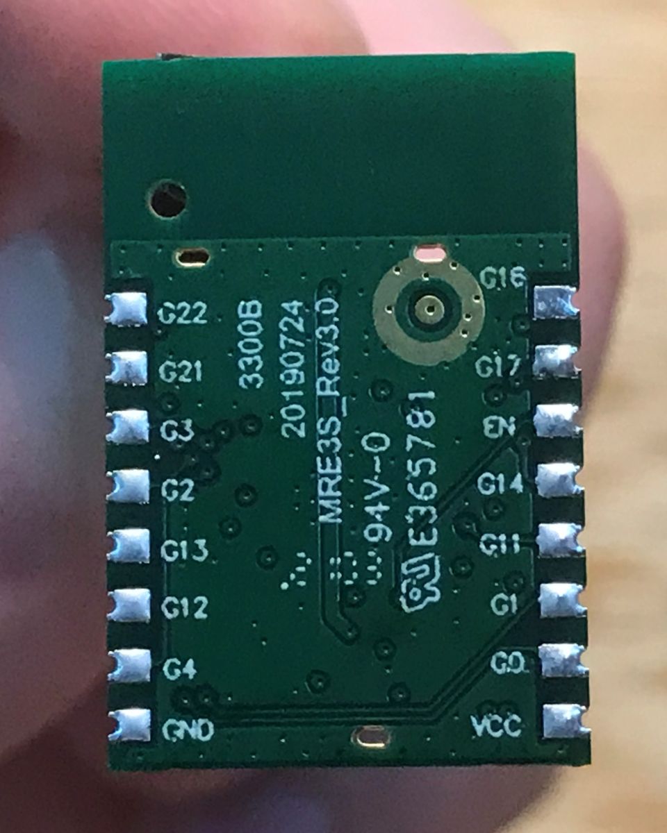

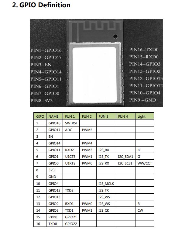

    The power supply location (ground and 3.3V) agrees with TYWE3S. The position of the EN (enable) pin does too. What I don't know is where the UART is.
    MRE3S Rev3.0 Wi‑Fi module on a green PCB, held between fingers
    The module is signed as MRE3S_Rev3.0. The name suggests that this is a module manufactured for/by Meross. The 3S designation matches WB3S/TYWE3S and indicates the format of the module. I couldn't find any more information about it except for the FCC report, which did however clarify a bit about the pinology:

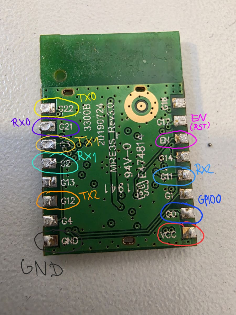

    GPIO pinout diagram of a Wi‑Fi module with a table of pin functions and a module photo

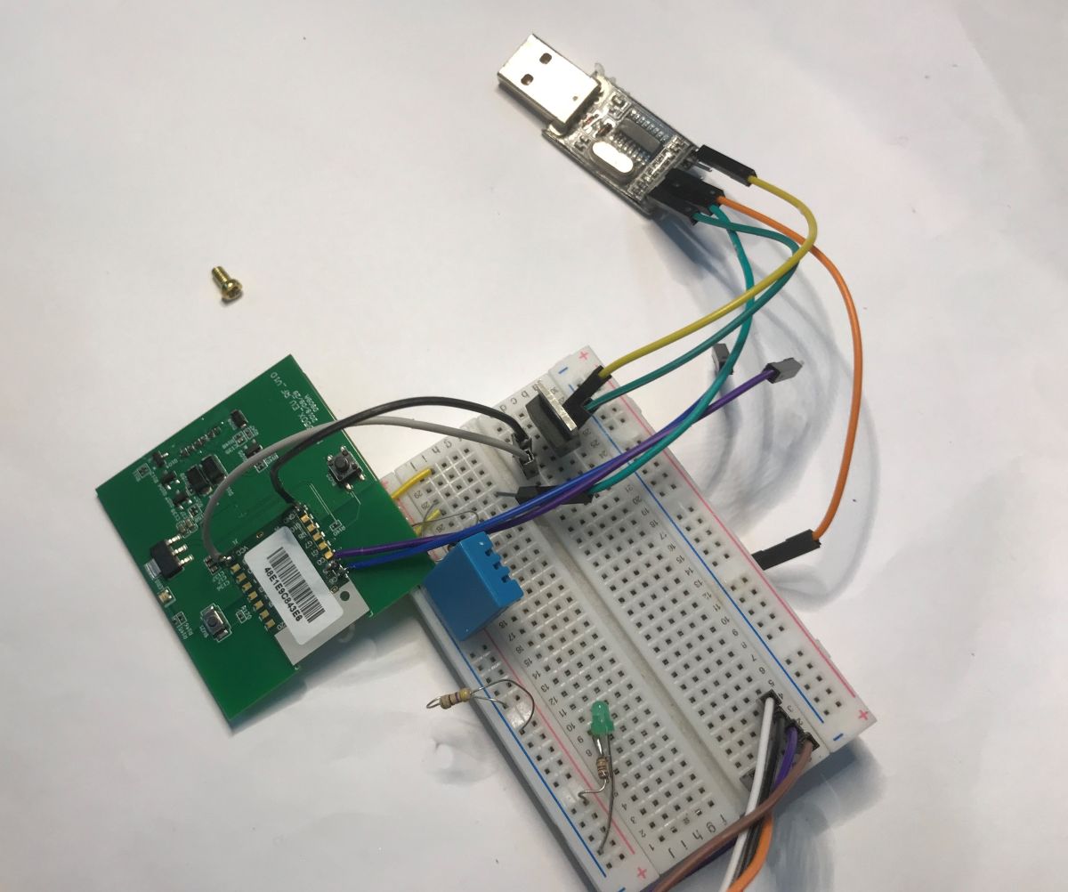

    This confirms the location of the UART in line with the expected standard. Unfortunately an attempt to collect data from it failed, my copy doesn't seem to be sending anything:
    PCB and breadboard wired to a small USB‑UART module with a USB-A plug

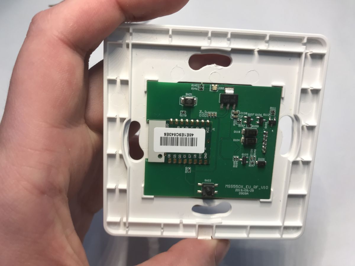

    For the sake of completeness, I'm posting pictures of the mechanical version of the button below. PCB designation: MSS550X_EU_RF_V10 2019/09/29 No major changes. Same Wi-Fi module.
    PCB inside a switch housing with a Wi‑Fi module and a barcode sticker Inside a switch: green PCB with a shielded radio module in a white housing, held in a hand
    Close-up of PCB showing “MSS550X_EU_RF_V10 2019/09/29” and SW22 push button Wi‑Fi module with metal shield and yellow QR label on a green PCB, held between fingers

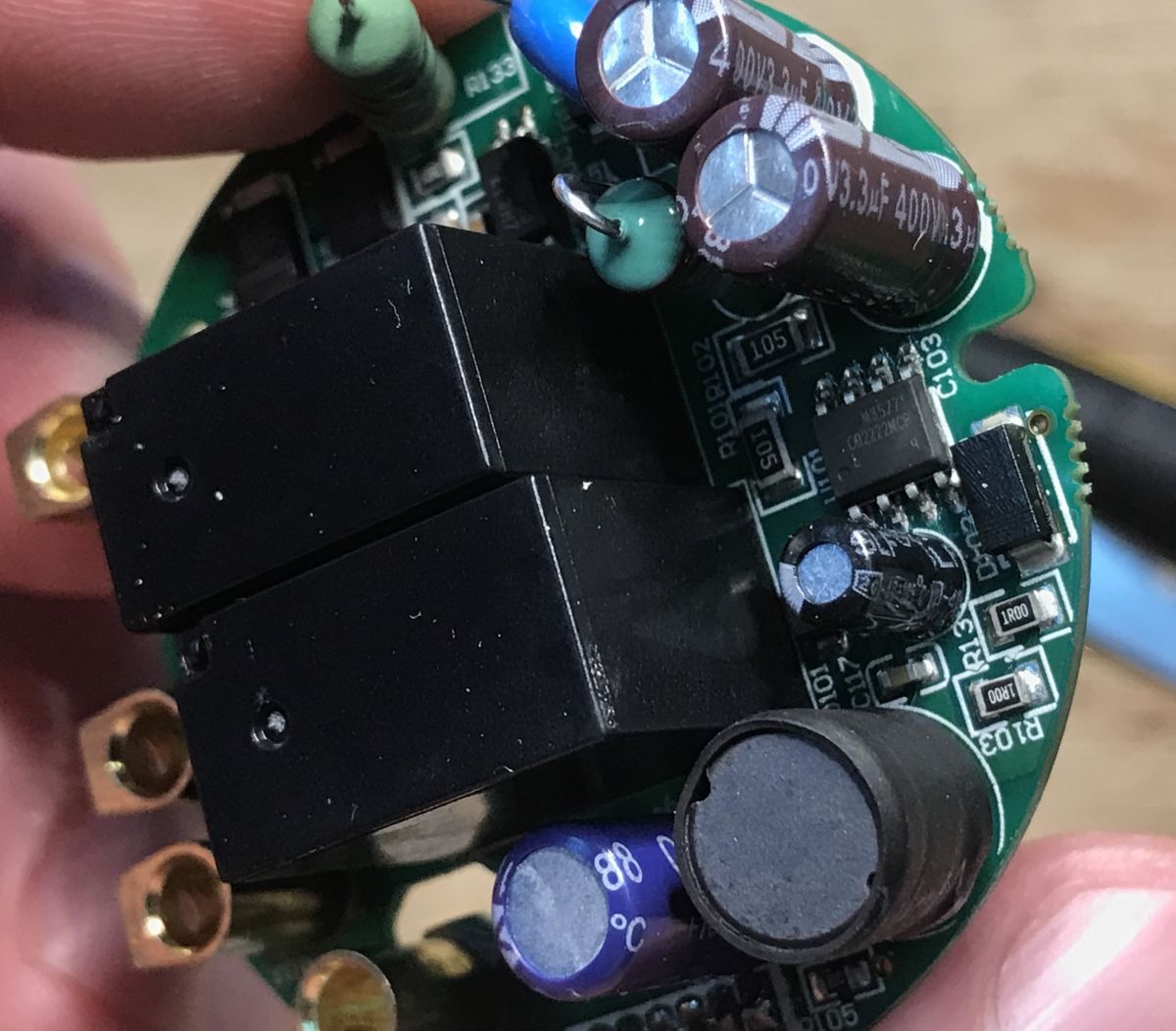

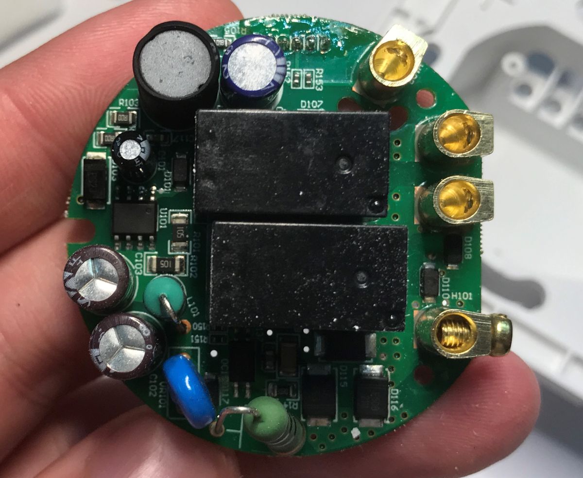

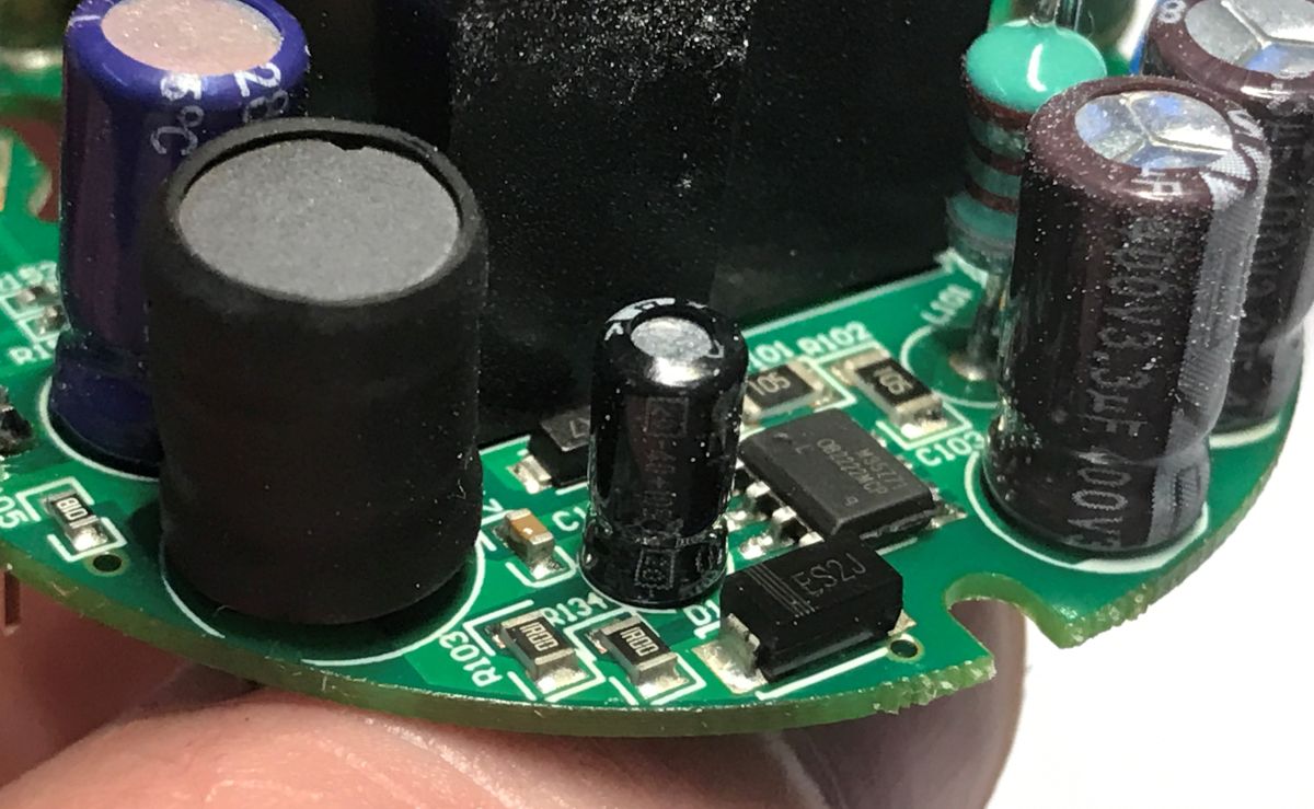

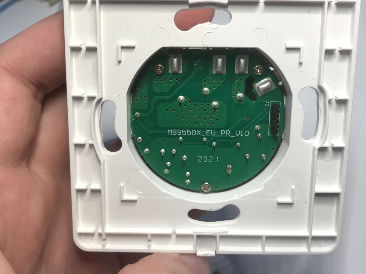

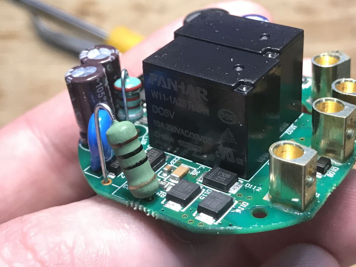

    Now a look at the executive board - power supply and relays.
    Rear view of a green PCB in a white housing, labeled “MSS550X_EU_PR_V10”
    Designation: MSS550X_EU_PR_V10

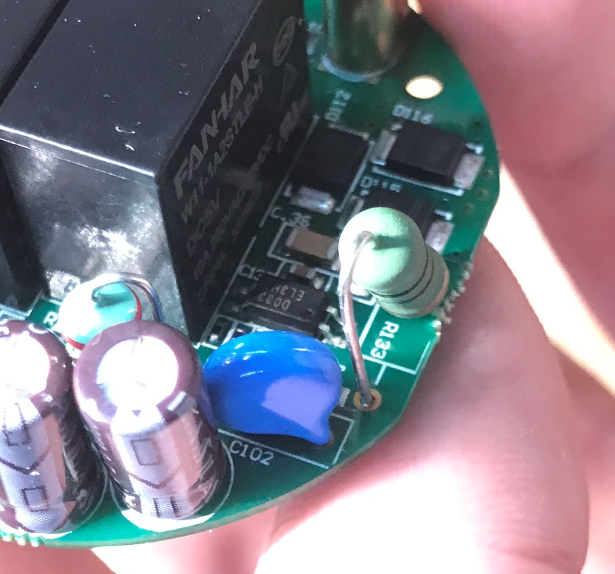

    Round PCB with two black relays and gold screw terminals, held in a hand
    There are two relays inside - in line with the L1 and L2 outputs, shorting them to C (Common).
    Macro photo of a green PCB section with electrolytic capacitors and SMD components

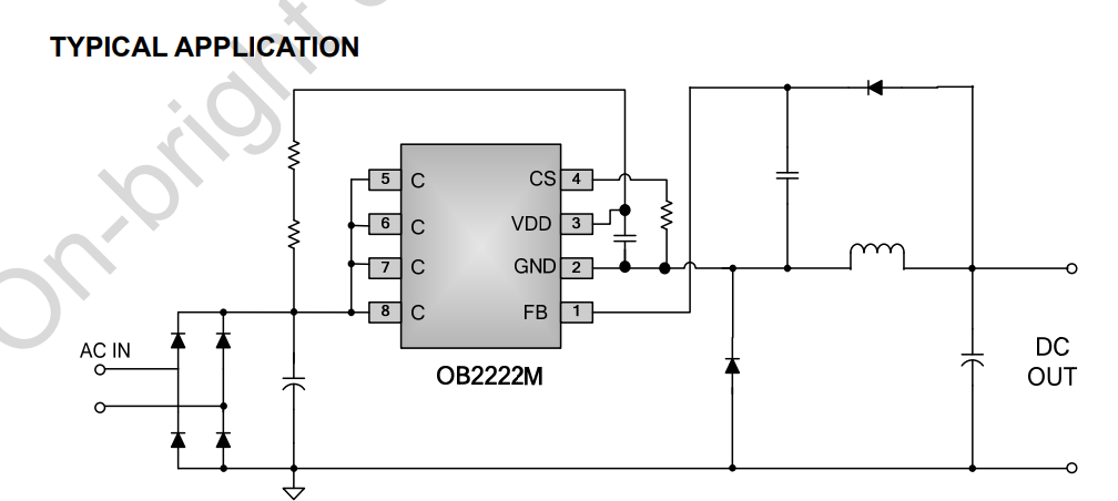

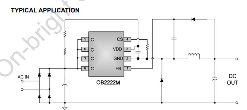

    The whole is powered by a non-isolated inverter based on the OB2222MCP. It generates 5 V. There is also a fuse and varistor in the circuit.
    “Typical Application” circuit diagram for OB2222M with AC IN and DC OUT connections

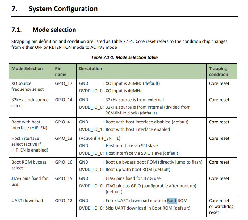

    The chip features an ARM® Cortex®-M4 core with FPU, clocked to 192 MHz, 384 KB of RAM and 1 MB of Flash memory. Unfortunately, Flash is quite scarce here, a bit like in the regular ESP8285. There may be a problem here with updating the firmware via Wi-Fi, because then you have to fit both images at once in non-volatile memory.

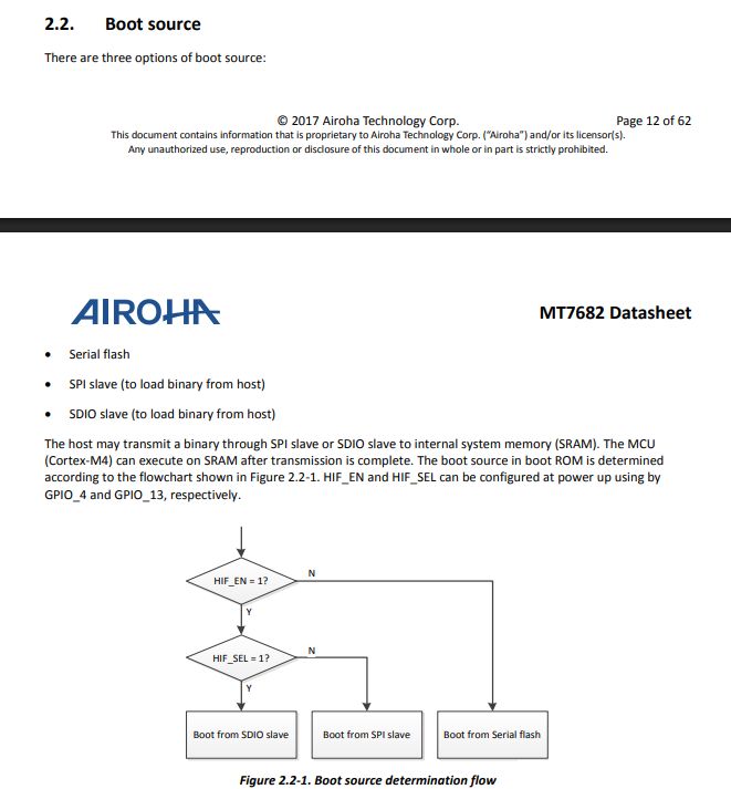

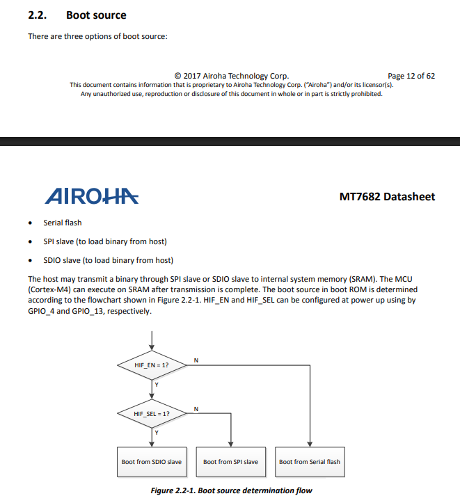

    Personally, I'm most interested in changing the firmware, and for that you need boot settings. The hope, however, is an external Flash - the option to boot from it via SPI.
    MT7682 datasheet excerpt: “Boot source” section with boot options list and a flowchart for boot selection
    “Mode selection” table showing GPIO strapping pins and conditions for system configuration in a datasheet.
    The serial option looks promising. So we are interested in the HIF_EN (GPIO_4) and HIF_SEL (GPIO_13) pins. These are available on the MRE3S pads.

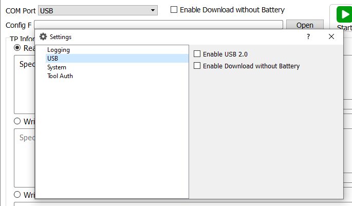

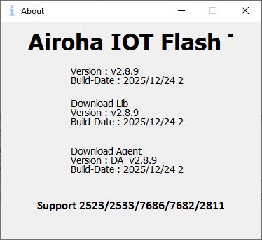

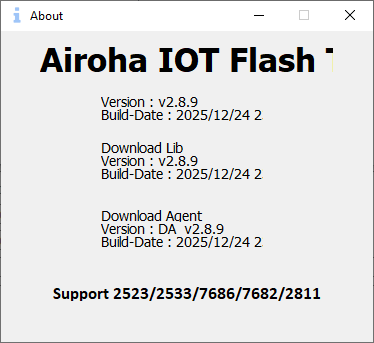

    The tools include IOT_Flash_Tool :
    Screenshot of Airoha IoT Flash Tool with an empty table and a Start button
    According to the "About" tab, the version of this tool is 2.8.9. What surprises me is the compilation time. I fired it up on the 24th, and the same date appeared in the program.
    “About” window of Airoha IOT Flash Tool showing version and build dates
    The port selection suggests that, in addition to the virtual COM ports, there is the possibility of operations directly via USB.
    Screenshot of a tool showing a “Settings” window with USB 2.0 and “Download without Battery” options
    At this point we probably have everything to compile, rip and upload the batch. We need to set the appropriate levels on the GPIO and connect the USB to UART converter. However, I will report the results in a separate topic.

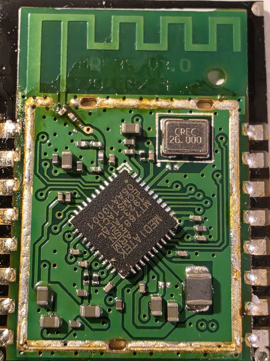

    Hello p.kaczmarek2! I was very surprised and happy to find your post here. Thank you, it is good to know I am not the only one with this module!
    I still had two unused modules in my parts collection, one of them is MR3E_MWA6E, which has RTL8710CF and which I was able to flash yesterday, thanks to newly supported platforms in your OBK flasher and firmware.
    The other one is exactly the one from your topic here, the MRE3S with Mediatek MT7682SN. While going through different posts for flashing instructions for the RTL chips, I had the secret hope that the method would work for the Mediatek too, as I thought maybe it is just another label but is the same as the Realtek, but obviously it is not. I have done some digging and traced back all the relevant traces that are usually interesting for the flashing process. I used the datasheet and double checked, it should be all correct. I was almost ready to connect it and try flashing with OBK RTL method, just to see if it works, but then I found your post here and I think it is not necessary to try because it is not supported yet. However, I want to share the pictures and traces, so just in case it would be supported in the future, we would have already a good reference where to connect our wires.
    Close-up of a green PCB with a MediaTek MT7682SN chip and a metal resonator can Close-up of a green PCB module with an IC chip and a metal can marked “CREC 26.000” Green PCB with solder pads on both sides and pin labels, including GND and VCC Close-up of a PCB with a QFN IC and a printed antenna, with colored handwritten trace annotations. Green PCB module with solder pads, printed pin labels, and handwritten colored markings for UART and power
