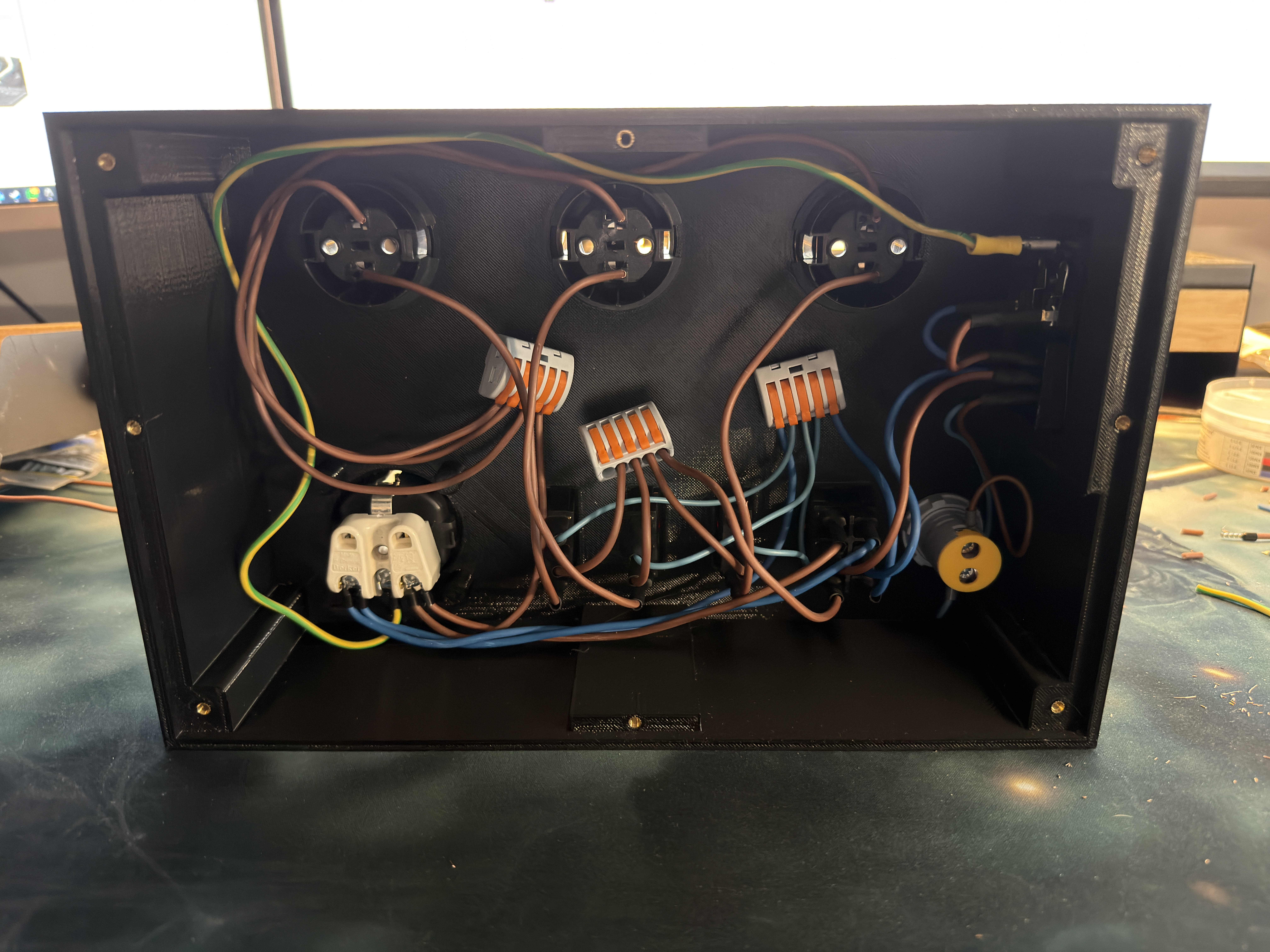

My first project. Some time ago I wanted to repair an old radio from my father-in-law as a gift for my wife, but I didn't want to burn it out extra. So I came up with a bulb tester. It was supposed to be as simple as possible, but somehow I got worked up and added a few extra components. I plan to add one more - an ammeter on the output. The whole layout, as well as the design with the case printing, realised by me.
Key information about the design:
1. Enclosure: Designed in CAD and printed on an Ender 3 V3 Plus. The walls are 4 mm thick, which provides great rigidity.
2. Assembly: All components (sockets, panel) are mounted with M3 screws screwed into brass inserts molded into the plastic. This avoids the threads becoming worn in the print.
3. Power supply: I used an IEC socket with a double 6A fuse. The filter limits the continuous current to 6A (about 1380W), which is sufficient in my conditions.
4. Operating logic: The main switch KCD4 allows you to select TESTER mode (via the bulbs) or BYPASS mode (direct). The three switches KCD3 allow the selective connection of bulbs of different wattages, giving control over the limiting current.
5. Safety: the PE protective conductor is pulled directly from the power socket to the pin in the Schuko output socket.
6. Interior: Connections based on WAGO 221 connectors (star topology) and LgY 1.5 mm² wires.
7. Monitoring: AD16 voltmeter plugged in directly behind the input socket (piggyback), so it works independently of the tester mode. (As an indicator that the IEC socket is switched on.
8. We plan to add an Ammeter on the output to monitor the current drawn.

miramire 18 Mar 2026 22:16
This is interesting and helpful I often use such a tester but on one bulb. If I can advise, the bypass/test switch should be such that it always goes back to test because sometimes when checking the... [Read more]
viayner 19 Mar 2026 06:03
Hello, i was a little confused by the title at the beginning, as in the old days, when there was a shortage of everything, especially meters, testers where the indicating element was an incandescent bulb... [Read more]
szeryf3 19 Mar 2026 07:19
Very cool you came up with this tester. I hope it will perform well. [Read more]
pcichomski 19 Mar 2026 09:30
A cool and useful item. I use one too, but in my house it's more coarse. If you don't have one then I would recommend some sort of indicator that you have voltage applied to the output socket - while still... [Read more]
Rothgnaar 20 Mar 2026 18:50
Thank you. I need to look for such a switch. This is my first project so I haven't taken everything into consideration yet :) Added after 1 [minute]: Thank you! This is my first project, I'll... [Read more]
Marian B 21 Mar 2026 12:17
In my opinion, all types of projects, even very simple ones, should be accompanied by a wiring diagram. Then you don't have to read the description many times to understand what it's all about. A quick... [Read more]
rakato11 22 Mar 2026 16:07
I completely agree with this. As soon as I started reading the post, I looked for a diagram but there wasn't one. Anyway, great idea for inspiration. I've been planning to build something like this for... [Read more]
tos18 22 Mar 2026 16:22
Nicely done. Although the vago connectors could have been avoided Don't you think it would be more useful to measure the voltage on the output socket ? [Read more]
gulson 22 Mar 2026 20:26
For a first project, the design is very impressive, it also looks quite safe and also reusable without fear of damage. And then there's the noble motivation - repairing a commemorative radio. How did... [Read more]
jarekgol 23 Mar 2026 12:36
You can still make an extra socket for a kettle of water, this increases the short-circuit current to about 10A, useful for power tools. But in your case, the filter may not be able to cope with it. I... [Read more]
Rothgnaar 14 Apr 2026 12:23
- About you I thought, maybe I will make one and add it here, thanks for your attention. The WAGOs had the advantage that I can undo them at any time. But ultimately the rail was to be mounted in... [Read more]
zybex 15 Apr 2026 09:14
This could be solved by using a relay that would switch the bypass/test supply with its contacts. In order not to get confused this bypass would require an additional button to be pressed. A relay of course... [Read more]
