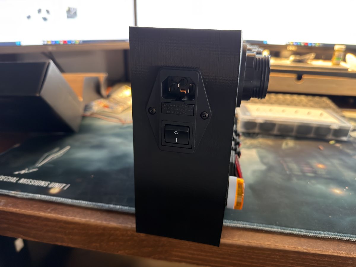

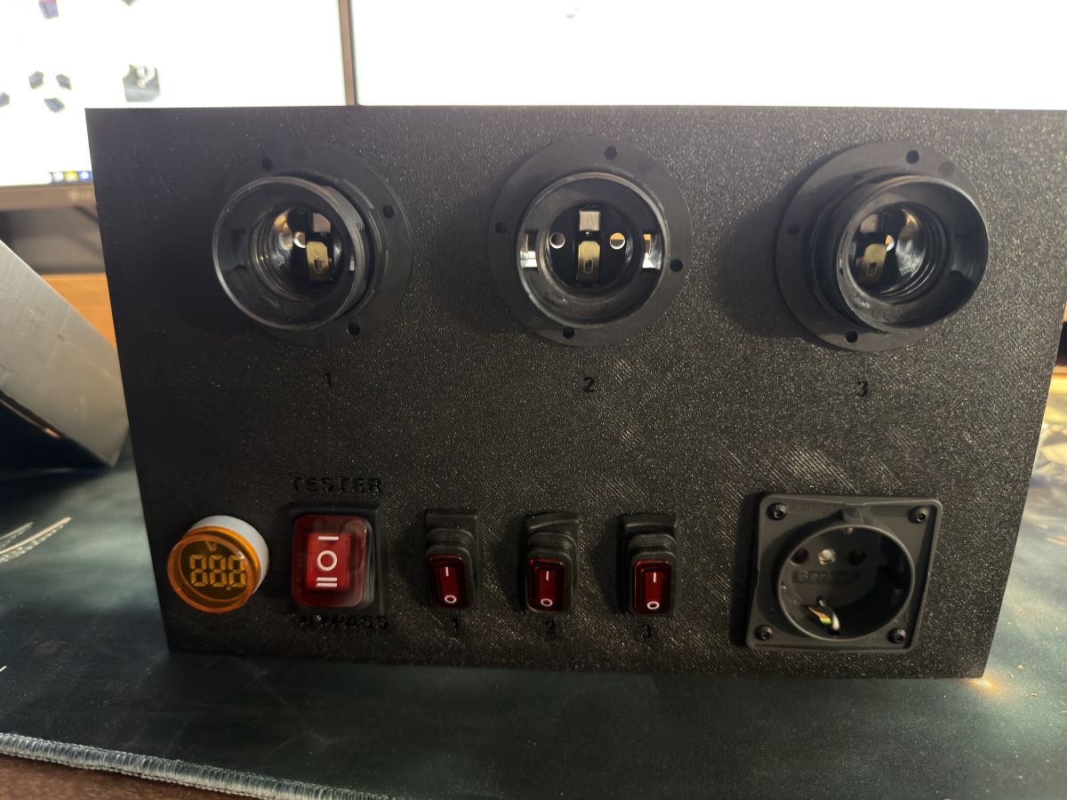

  • Good morning.
    My first project. Some time ago I wanted to repair an old radio from my father-in-law as a gift for my wife, but I didn't want to burn it out extra. So I came up with a bulb tester. It was supposed to be as simple as possible, but somehow I got worked up and added a few extra components. I plan to add one more - an ammeter on the output. The whole layout, as well as the design with the case printing, realised by me.
    Key information about the design:
    1. Enclosure: Designed in CAD and printed on an Ender 3 V3 Plus. The walls are 4 mm thick, which provides great rigidity.
    2. Assembly: All components (sockets, panel) are mounted with M3 screws screwed into brass inserts molded into the plastic. This avoids the threads becoming worn in the print.
    3. Power supply: I used an IEC socket with a double 6A fuse. The filter limits the continuous current to 6A (about 1380W), which is sufficient in my conditions.
    4. Operating logic: The main switch KCD4 allows you to select TESTER mode (via the bulbs) or BYPASS mode (direct). The three switches KCD3 allow the selective connection of bulbs of different wattages, giving control over the limiting current.
    5. Safety: the PE protective conductor is pulled directly from the power socket to the pin in the Schuko output socket.
    6. Interior: Connections based on WAGO 221 connectors (star topology) and LgY 1.5 mm² wires.
    7. Monitoring: AD16 voltmeter plugged in directly behind the input socket (piggyback), so it works independently of the tester mode. (As an indicator that the IEC socket is switched on.
    8. We plan to add an Ammeter on the output to monitor the current drawn.
    Inside a black enclosure with three lamp holders and wiring connected via WAGO lever connectors Black bulb tester front panel with three E27 lamp holders, rocker switches, and a Schuko outlet Black device enclosure with an IEC power inlet and rocker switch on the side, on a desk.

    miramire
    This is interesting and helpful I often use such a tester but on one bulb.
    If I can advise, the bypass/test switch should be such that it always goes back to test
    because sometimes when checking the device often you can make a mistake and leave it on bypass.

    A cool and useful item. I use one too, but in my house it's more coarse. If you don't have one then I would recommend some sort of indicator that you have voltage applied to the output socket - while still in the bulb circuit, of course. I also play with tube circuits and in the heat of battle a glance is enough to judge whether I have a powered circuit or not. The other thing is, if you want to play around with this sort of thing, you might also want to get yourself some sort of safety isolation transformer and use it in addition for repairs.

    >>21865590 Thank you. I need to look for such a switch. This is my first project so I haven't taken everything into consideration yet :)
    Added after 1 [minute]:
    >>21865680 Thank you! This is my first project, I'll be honest, so far it has drawn me in more than repairing the radio :)
    >>21865750 I am planning an Ammeter for the output. As for the repair itself, I'll be getting on with it soon, but I still need to brush up before I sit down to it. For now, just designing this tester has drawn me in more than the repair :)

    Nicely done. Although the vago connectors could have been avoided
    Rothgnaar wrote:
    7. Monitoring: AD16 voltmeter plugged directly behind the input socket (piggyback), so it works independently of the tester mode. (As an indicator that the IEC socket is switched on.
    Don't you think it would be more useful to measure the voltage on the output socket ?

    You can still make an extra socket for a kettle of water, this increases the short-circuit current to about 10A, useful for power tools. But in your case, the filter may not be able to cope with it.
    I have 4 400W halogen incandescent bulbs in the house switched on by pushbuttons, and when I need much less than 400W I solder a bulb on the wires, but I can't remember when 400W in series was too much for me.

    >>21867256 - About you I thought, maybe I will make one and add it here, thanks for your attention.
    >>21868054 The WAGOs had the advantage that I can undo them at any time. But ultimately the rail was to be mounted in the housing (I did not have it available). As for the meter, of course, but the one on the input simply replaces the LED indicating whether the switch is on or off, because it has no indicator in itself but is on the side of the housing, such a tidbit instead of a diode :)
    >>21868626 Well it was a project that came from a single bulb. I thought to myself that when I was making the housing I might be tempted to add an extra 2 and so it worked out.

    miramire wrote:
    As far as I can advise, the bypass/test switch should be such that it always returns to test
    because sometimes with frequent checking of the device you can make a mistake and leave it on bypass.
    This could be solved by using a relay that would switch the bypass/test supply with its contacts. In order not to get confused this bypass would require an additional button to be pressed. A relay of course with a coil for ~230V with decent contacts.
