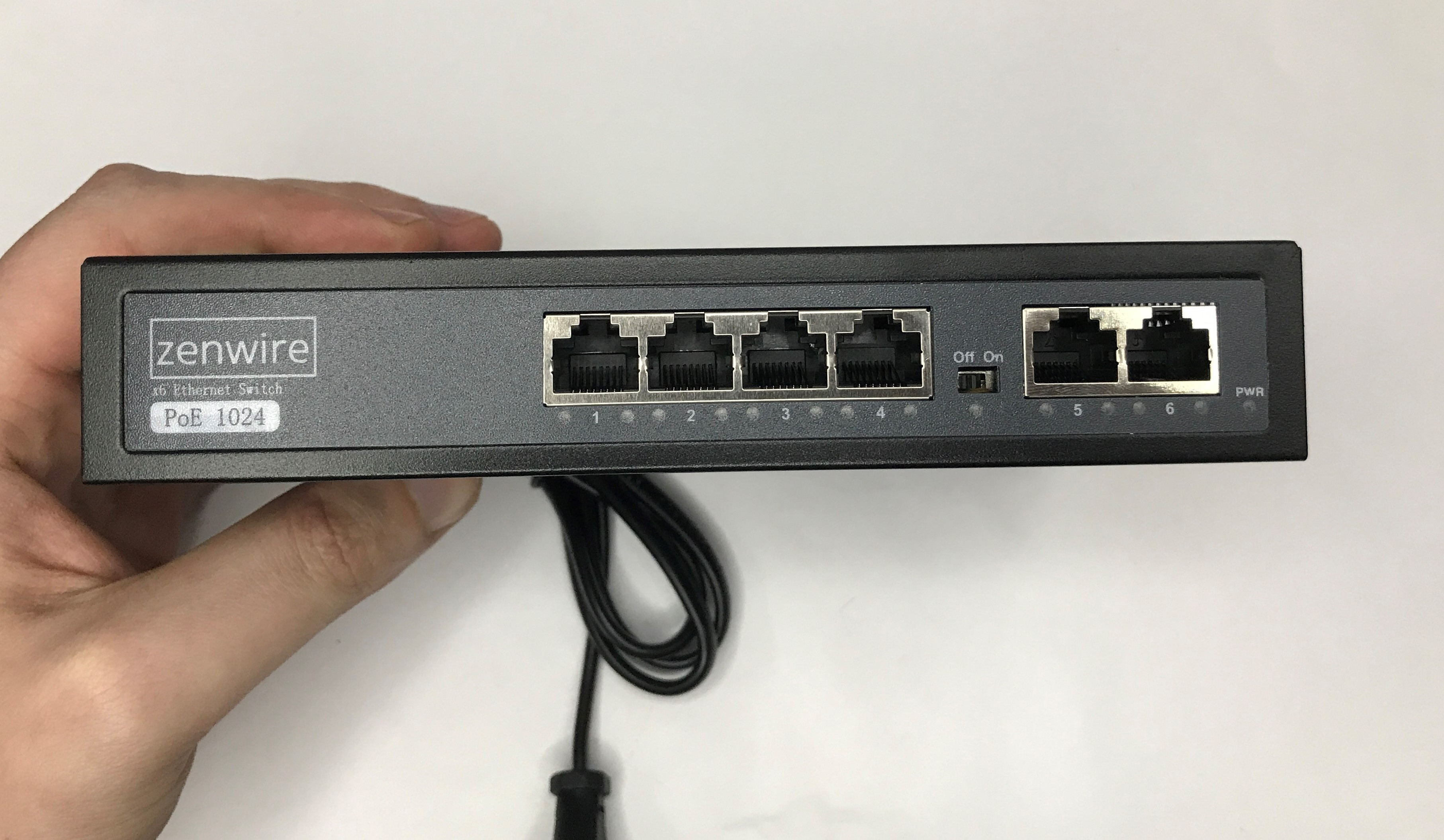

Front panel of Zenwire PoE 1024 Ethernet switch with six RJ45 ports and an On/Off switch
Here I will show the inside of a PoE-compliant IEEE 802.3af/at/bt switch with up to 60 W, offering 4 LAN ports (with power), 2 uplink ports and a throughput of up to 1.6 Gbps. PoE (Power over Ethernet), as the name suggests, is a technology that allows data and power to be transmitted simultaneously over the same network cable. For example, IP cameras, access points or there VoIP telephones, as well as many other devices, can be conveniently powered in this way.
Box of Zenwire PoE 1028 Ethernet PoE switch with device image and feature icons Box labeled “zenwire” 6x Ethernet PoE Switch (PoE 1024) on a light background White zenwire box showing PoE 1024 and PoE 1023 model info and manufacturer details
The box is interesting in that it has one model on one side and another on the other - and it's the same box.
The product costs just under PLN70 and is advertised as designed in Poland, which already made me curious - the production is obviously in PRC, but the design is supposedly ours. We'll have a look inside soon, there's still a manual left:

In summary, this was a brief demonstration of a PoE switch which, according to the information on the packaging, was designed in our country. It is difficult for me to judge how much this was actually the case, although undoubtedly inside you can see some savings on components and changes of plans in relation to the design of the PCB itself. Also, not all the electronic circuits inside have been clearly identified, so if anyone has anything more to add, feel free to comment. Do you use PoE switches?
