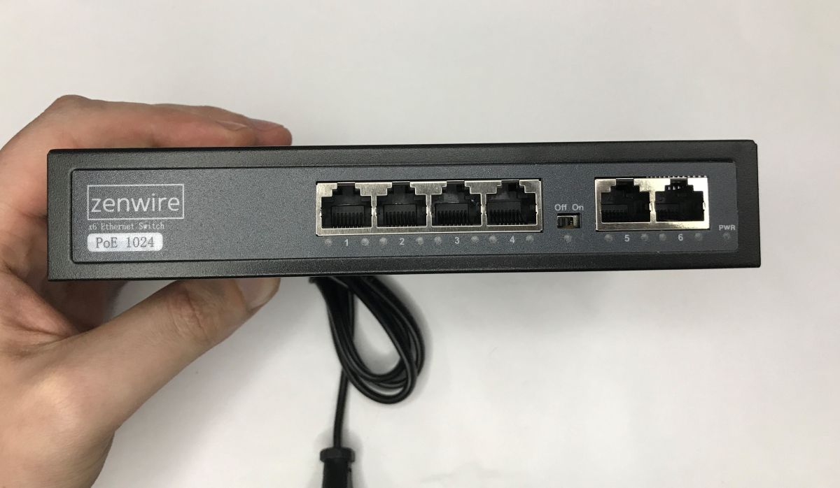

  • Front panel of Zenwire PoE 1024 Ethernet switch with six RJ45 ports and an On/Off switch
    Here I will show the inside of a PoE-compliant IEEE 802.3af/at/bt switch with up to 60 W, offering 4 LAN ports (with power), 2 uplink ports and a throughput of up to 1.6 Gbps. PoE (Power over Ethernet), as the name suggests, is a technology that allows data and power to be transmitted simultaneously over the same network cable. For example, IP cameras, access points or there VoIP telephones, as well as many other devices, can be conveniently powered in this way.

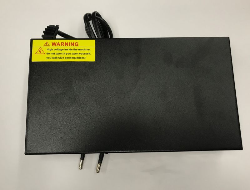

    The casing is encouraging, it is metal and quite solid.

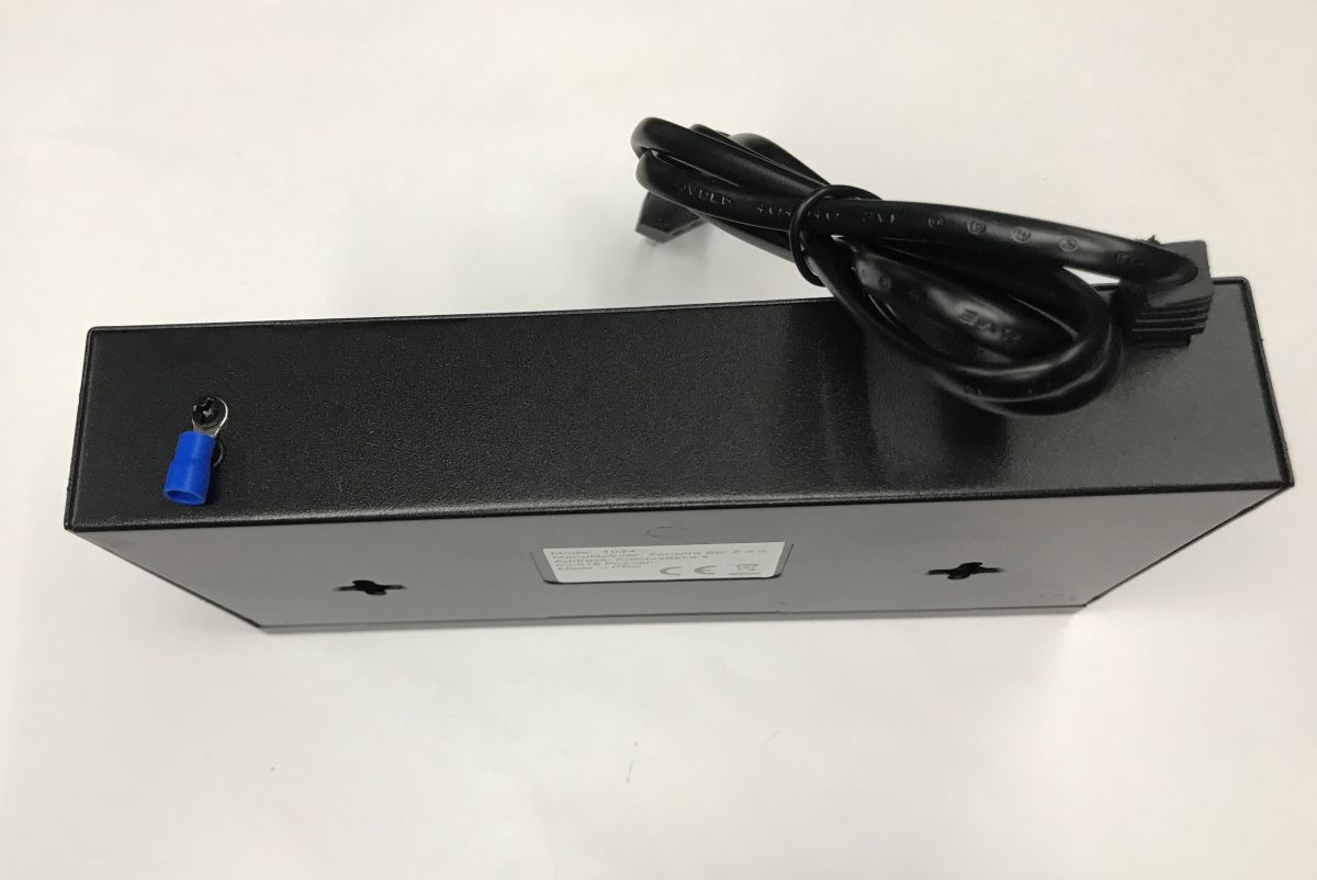

    Black metal device case with yellow “WARNING” label and a power cord ending in a Euro plug
    The cable is not grounded, but can be connected next to it:
    Black metal device case with an attached power cable and a small blue cap on the left

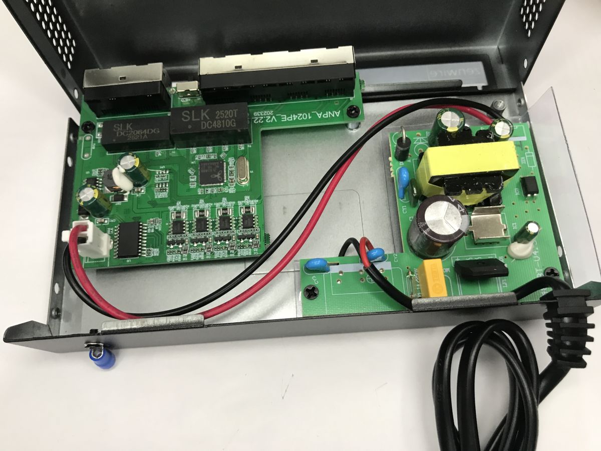

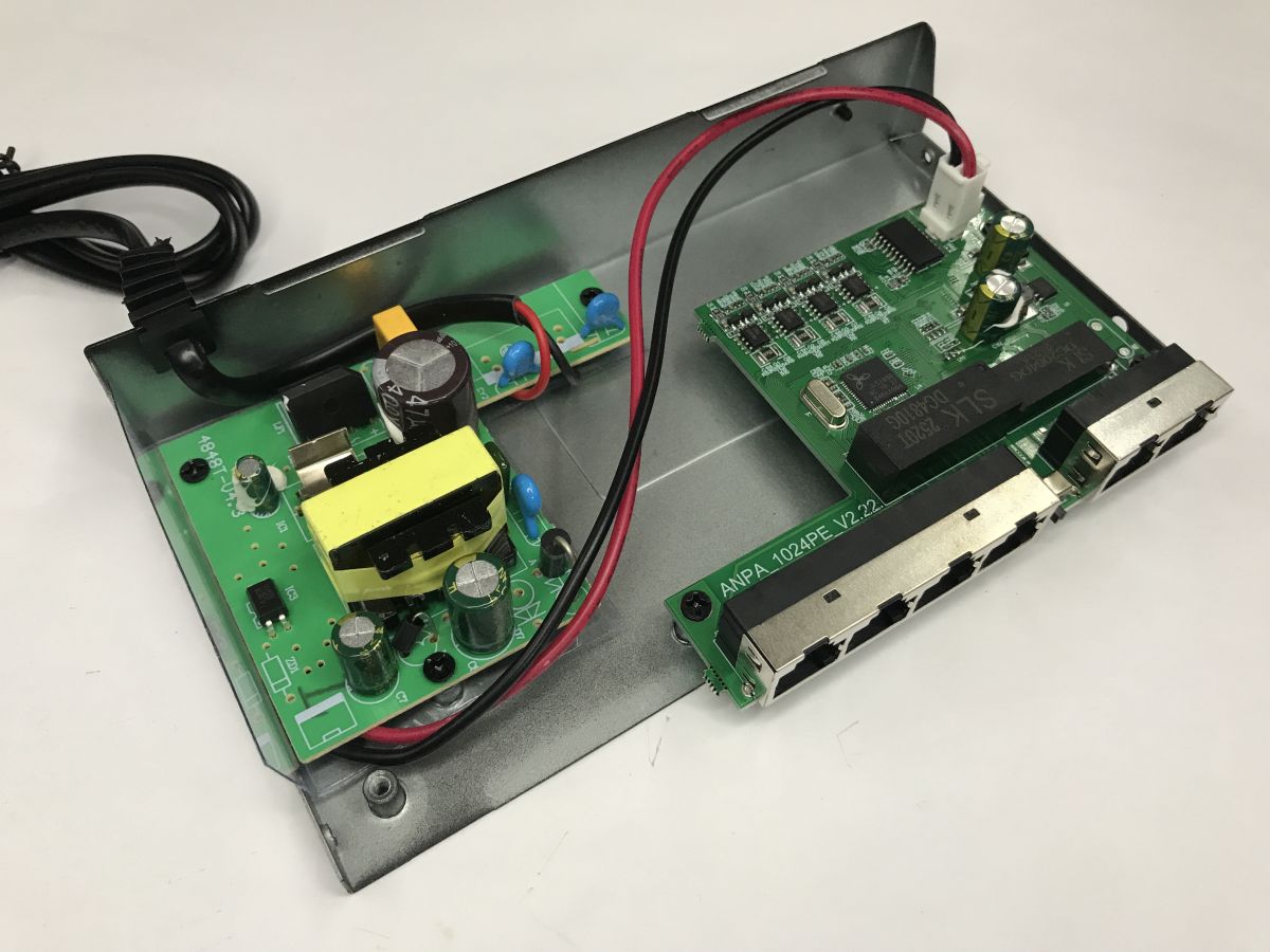

    We take a look inside. There we have two boards - one is the power supply and the other is the mains controller.
    Inside a metal PoE switch case with two PCBs, wiring, and a separate power-supply board
    PCB designation: ANPA_1024PE_V2.22:
    Inside a PoE switch: metal case with two PCBs, including RJ45 ports and a power-supply module

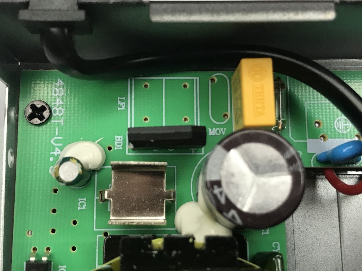

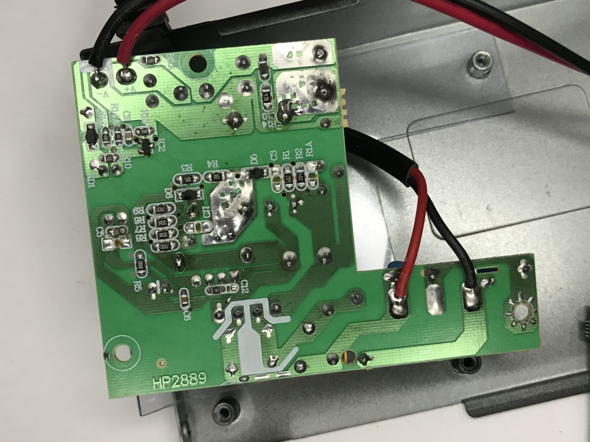

    PCB from the power supply - here we have a simple flyback topology, I even see a TL431 on the bottom:
    Underside of a green PCB with red and black wires soldered, mounted inside a metal enclosure
    There's an empty space on the power supply input for filters and a varistor:
    Close-up of power-supply PCB with electrolytic capacitor, MOV/fuse footprints, yellow capacitor, and wiring
    I haven't checked what the inverter is realised on - I didn't want to desolder the heatsink. Maybe it's some kind of circuit from the ViPER or TNY series?

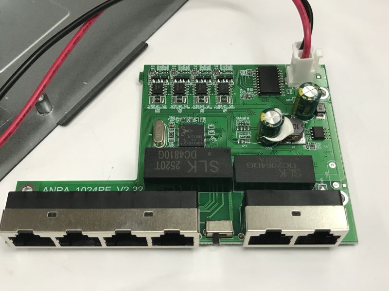

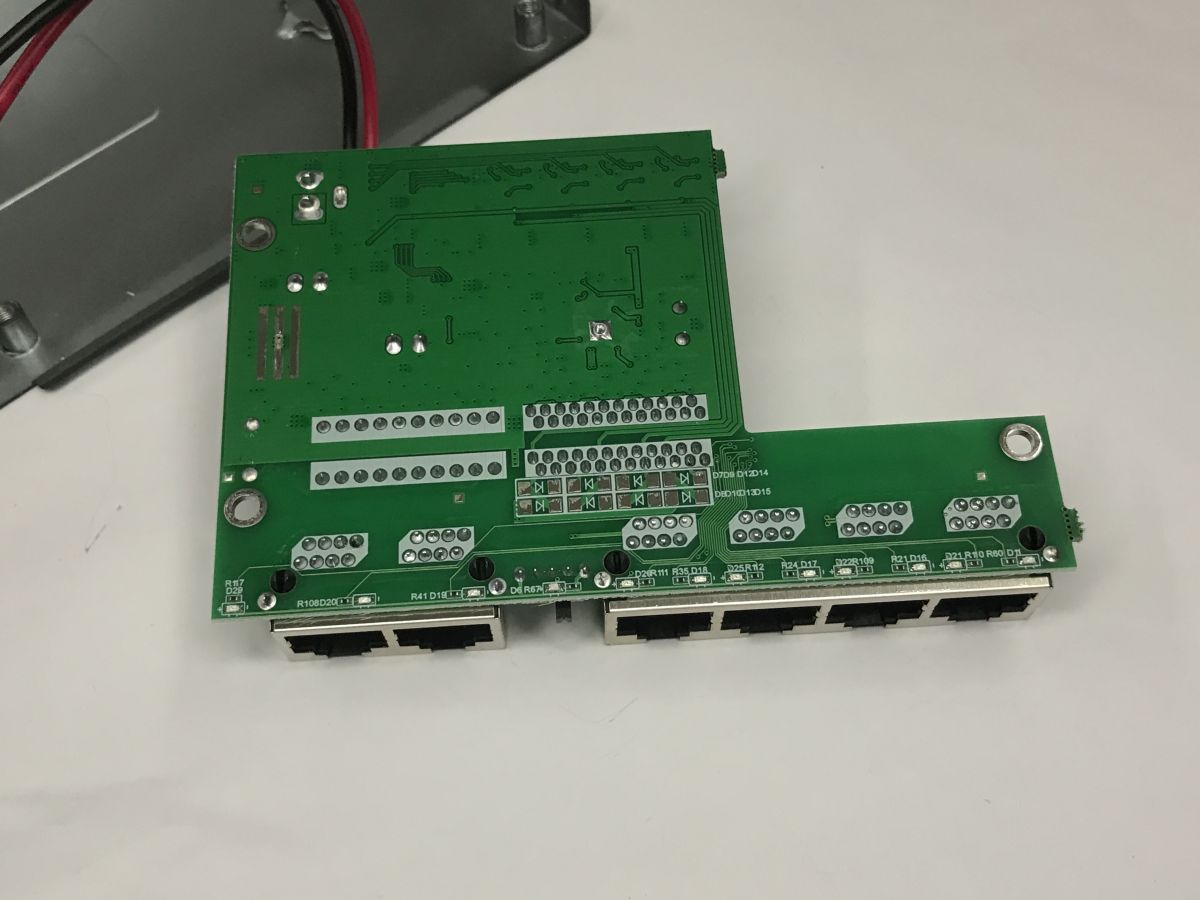

    Now for the second board. Anyone lusted after the protective LEDs? The connector LEDs are on the bottom of the PCB, I guess it was cheaper that way than buying RJ45 connectors with built in LEDs.
    Green switch PCB with six RJ45 ports, viewed from the trace and solder side

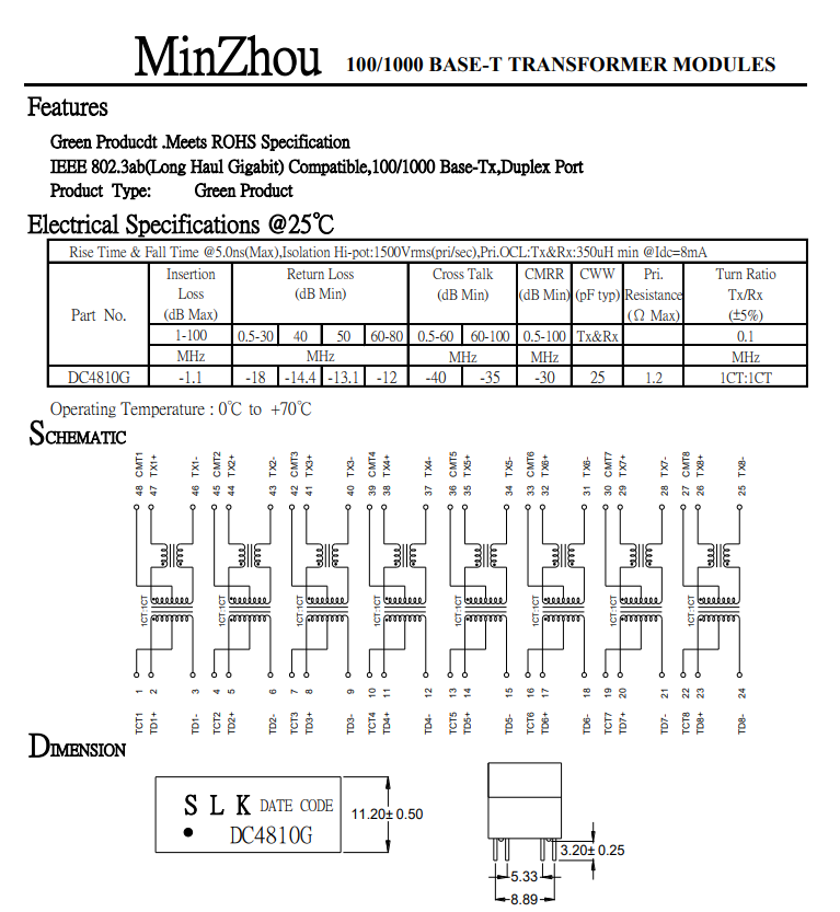

    Isolation signal transformers are separate (no integrated 'magjack' here):
    PoE switch PCB with six RJ45 ports and power components on a tabletop
    DC4810G and DC2064DG. Catalogue note that it is for gigabit connection.
    MinZhou datasheet page with specs table and schematic for 100/1000 BASE‑T transformer module DC4810G

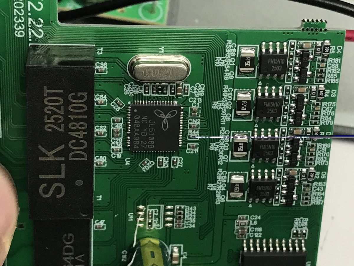

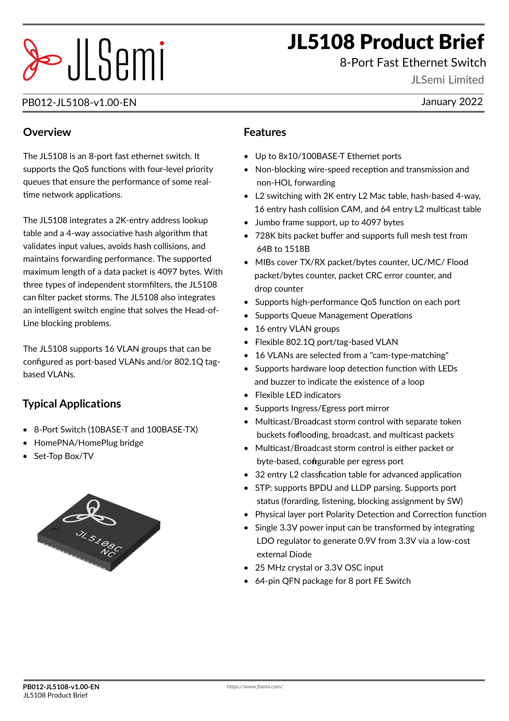

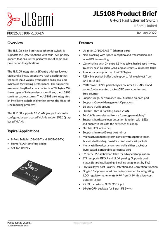

    Apart from that, we have the main controller, the main inverter and four FM15N10 chips in there.
    Close-up of a PoE switch PCB showing JL5108B IC, SLK transformer, and SMD component sections
    JL5108B:
    “JL5108 Product Brief” page by JLSemi with overview text and a bulleted list of Ethernet switch features

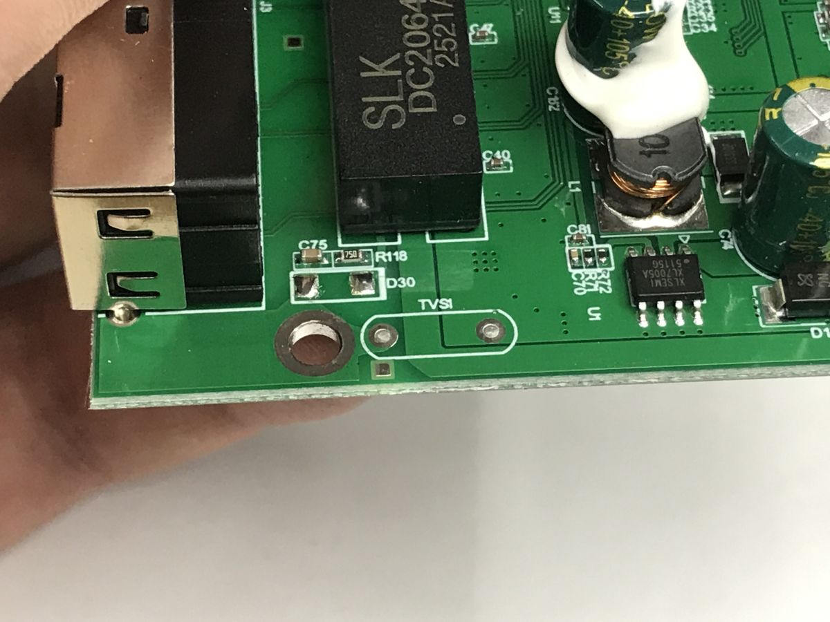

    FM15N10 role I did not recognise, maybe it is a MOSFET?
    Close-up of a PoE switch PCB by an RJ45 port, showing TVS1 and D30 pads and a DC2064DG-marked chip
    There is also an XL7005A inverter on the input, this is probably used to step down the voltage to supply the rest of the circuit. Interestingly, there is a place on the PCB for a TVS protection diode, but it is not soldered on. Next to the inverter, there is still a surface-mounted chip in a SOIC case, which is not marked.

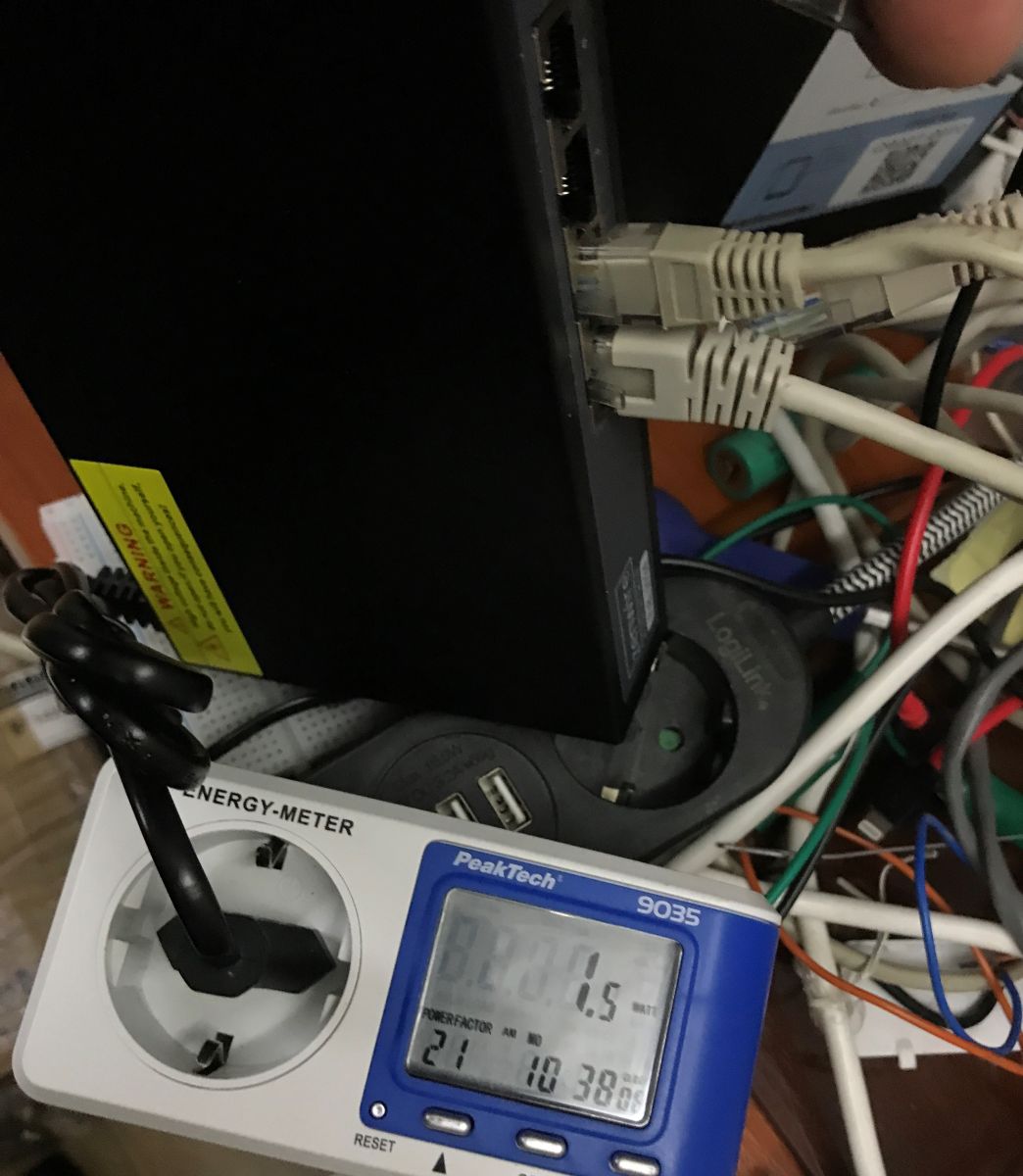

    I briefly tested this switch at my site, but without PoE testing. With no wires connected (or no network traffic) it draws about 1.5 W, with moderate traffic it draws 2.5 W.
    Network switch with Ethernet cables connected and a PeakTech 9035 power meter showing 2.1 W Network switch with Ethernet cables connected and an energy meter showing 1.5 W
    I then mounted the switch in the target location to work with the cameras and it works flawlessly.

  • Earth connection warning for metal-cased PoE switch
    #8 21869002
    Homo_toxicus
    Posts: 1128
    Help: 76
    Rate: 378

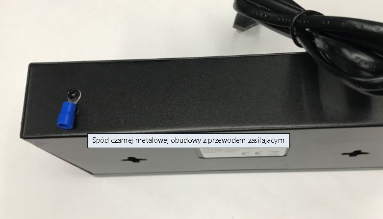

    As for me, I would be afraid to use this Chinese "contraption". Metal casing and no protective wire in the mains supply. It's asking for trouble.
    EDIT: I didn't see that - sorry.
    You can connect the earth to yourself.
    Bottom of a black metal enclosure with a power cable and a blue crimp terminal on a screw
    I can already see users buying cable in bulk, crimping the end and connecting it to earth....
    Typical Chinese disregard for regulations and common sense.
    It may have been designed in Poland. The Chinese man was on remote work.

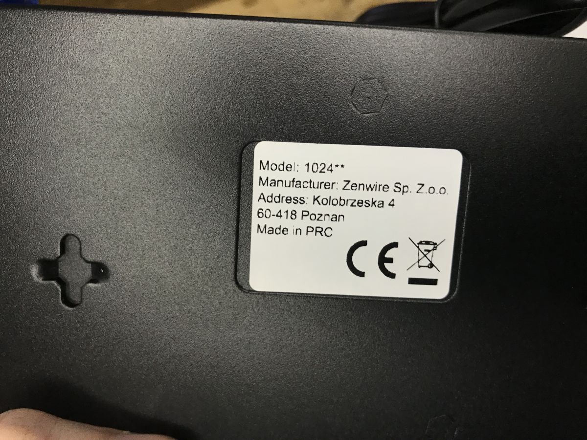

    Bottom plate:
    White label on black device with model and Zenwire manufacturer details, plus CE and crossed-out bin symbols
    Why such a question?

    I think the nameplate is an important description of any product, so it should be in the product description.
    I notice that a Polish company is listed as the manufacturer, only that there is no mention in the KRS that it produces anything ;)
    I don't know if it might be the photo that's deceiving, but it seems to me that there's something wrong with the proportions of that CE standard mark.
    Grid diagram with red axes comparing proportions of the “CE” mark.
    https://pl.wikipedia.org/wiki/Oznaczenie_CE

What should you check on the bottom nameplate of a budget PoE switch to verify safety markings like CE and manufacturer details?
Check the bottom plate for the named manufacturer, the declared model, and whether the CE mark looks proportionally correct. In this thread, a commenter specifically questions the CE symbol proportions and notes that a Polish company is listed as manufacturer, while also doubting whether it actually produces the device. A clear, credible nameplate matters because it is the quickest traceability check on a budget switch. [#21870285]
Why is a metal-cased switch with an ungrounded mains lead considered risky, and how should protective earth be handled properly?
A metal enclosure raises concern when the mains lead is not factory-grounded, because any insulation fault can put hazardous voltage on the case. The thread shows an earth connection point next to the cable entry, but one commenter warns that leaving grounding to the buyer invites unsafe improvisation. Protective earth should be bonded to the chassis through the intended terminal, not added informally after purchase. [#21869002]
