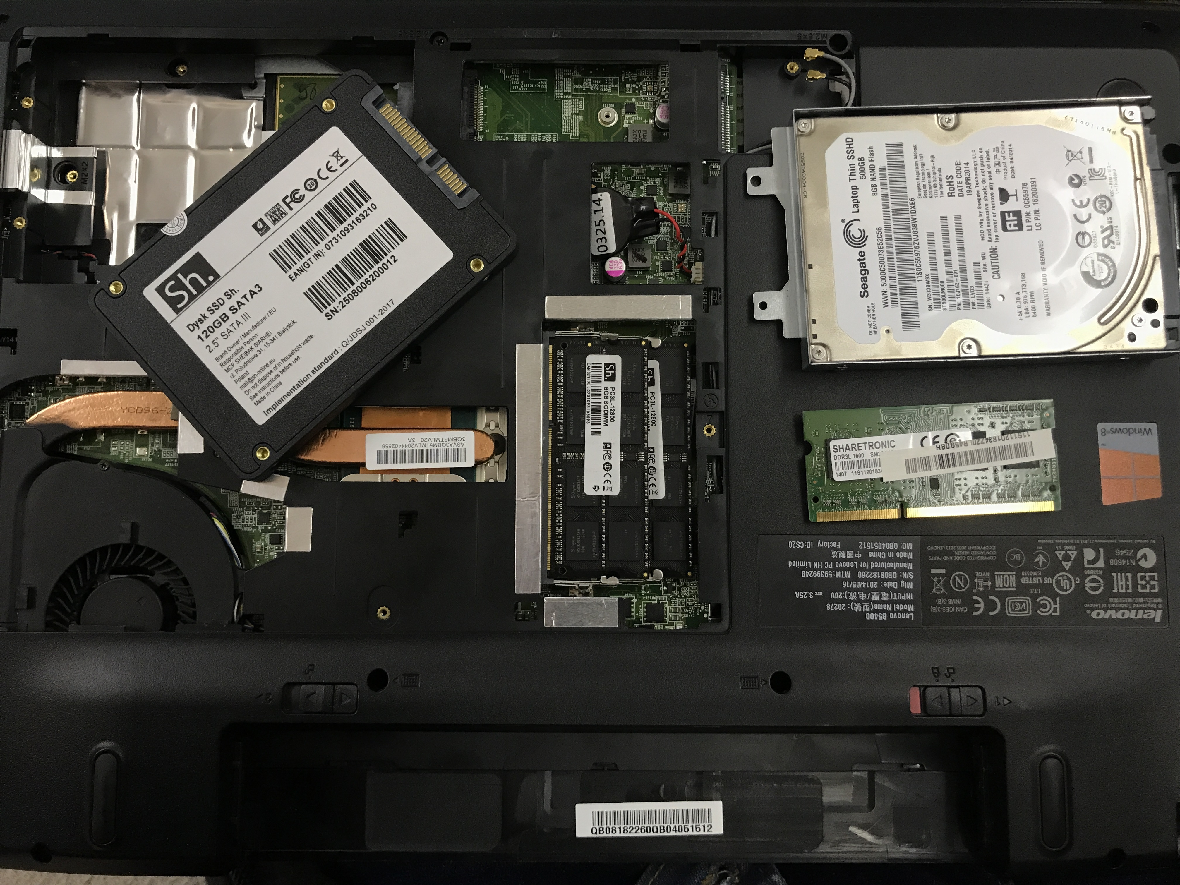

Laptop internals with RAM modules, a Seagate 2.5-inch drive, and a disconnected SSH 120GB SSD
An interesting service story today. Can swapping 4 GB RAM for 8 GB damage a laptop so that it can no longer even boot or install the operating system? I have personally found out that this is possible - here I will show what happened and present the solution to the problem. Does your laptop not boot after an upgrade attempt, does not see the USB drive with the system, does not boot the system even though it can see the drive? This is the topic for you.
BIOS/UEFI information screen showing version details, Intel Pentium 3550M CPU, and 4096 MB installed memory.
The patient is a Lenovo B5400 laptop. On the one hand it's already quite old, several years old, still from the Windows 8 era, based on a dual-core Intel Pentium 3550M, but on the other hand it's well-preserved, with no scratches, a full set of hardware and a holding battery. It could still be suitable for social media, browsing the internet and making payments.
The only problem is that lukewarm SSHD drive and the measly 4 GB of RAM. Especially as that 4 GB is in the form of a single bone, and the replacement SSD I already have in stock from liquidation....

I started with this RAM. Something tempted me to try with two 8GB bones each. I guess that's silly, as RAM prices are knocking down, but everyone has different hobbies. I matched the two matching dice. Of course I disconnected the battery before running. With the 2x8 GB configuration the laptop wouldn't get up, and after running 4 + 8 GB there was an unusual problem. The laptop stopped booting Windows even though the drive was seen. I checked the standard stuff:
- second SATA media, second SATA port (I have a drive bay for the CD/DVD slot)
- booting from USB (Linux)
- bIOS settings, legacy, fastboot
- cMOS reset (battery)
Nothing wanted to work, so I decided to revert to the initial RAM configuration (the memory that came from the factory) and then I found that the problem still remains and booting does not work despite repeating the above described operations.
