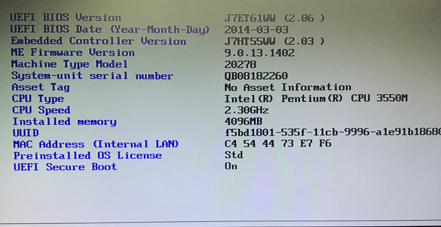

    An interesting service story today. Can swapping 4 GB RAM for 8 GB damage a laptop so that it can no longer even boot or install the operating system? I have personally found out that this is possible - here I will show what happened and present the solution to the problem. Does your laptop not boot after an upgrade attempt, does not see the USB drive with the system, does not boot the system even though it can see the drive? This is the topic for you.
    BIOS/UEFI information screen showing version details, Intel Pentium 3550M CPU, and 4096 MB installed memory.
    The patient is a Lenovo B5400 laptop. On the one hand it's already quite old, several years old, still from the Windows 8 era, based on a dual-core Intel Pentium 3550M, but on the other hand it's well-preserved, with no scratches, a full set of hardware and a holding battery. It could still be suitable for social media, browsing the internet and making payments.

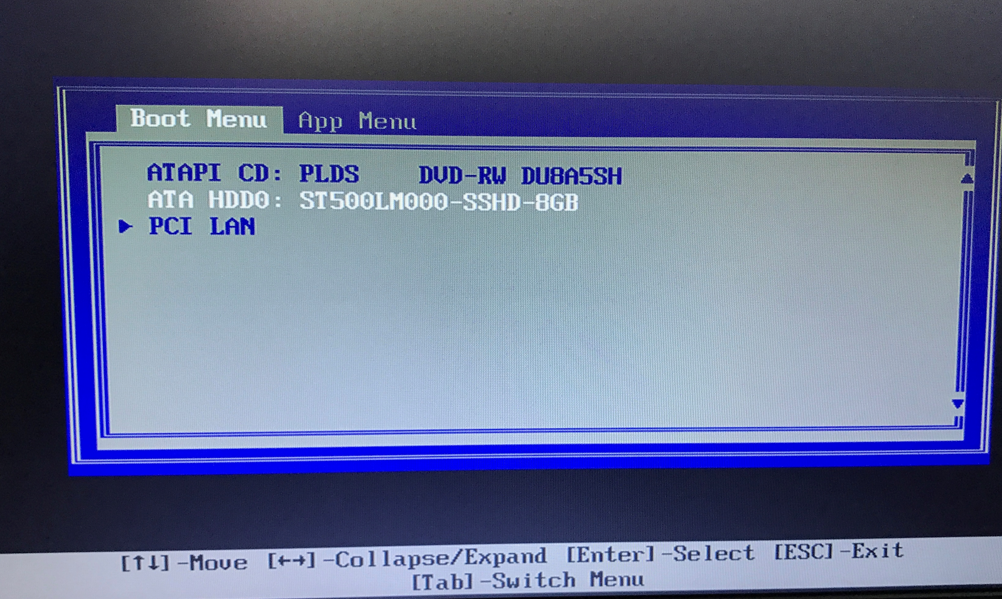

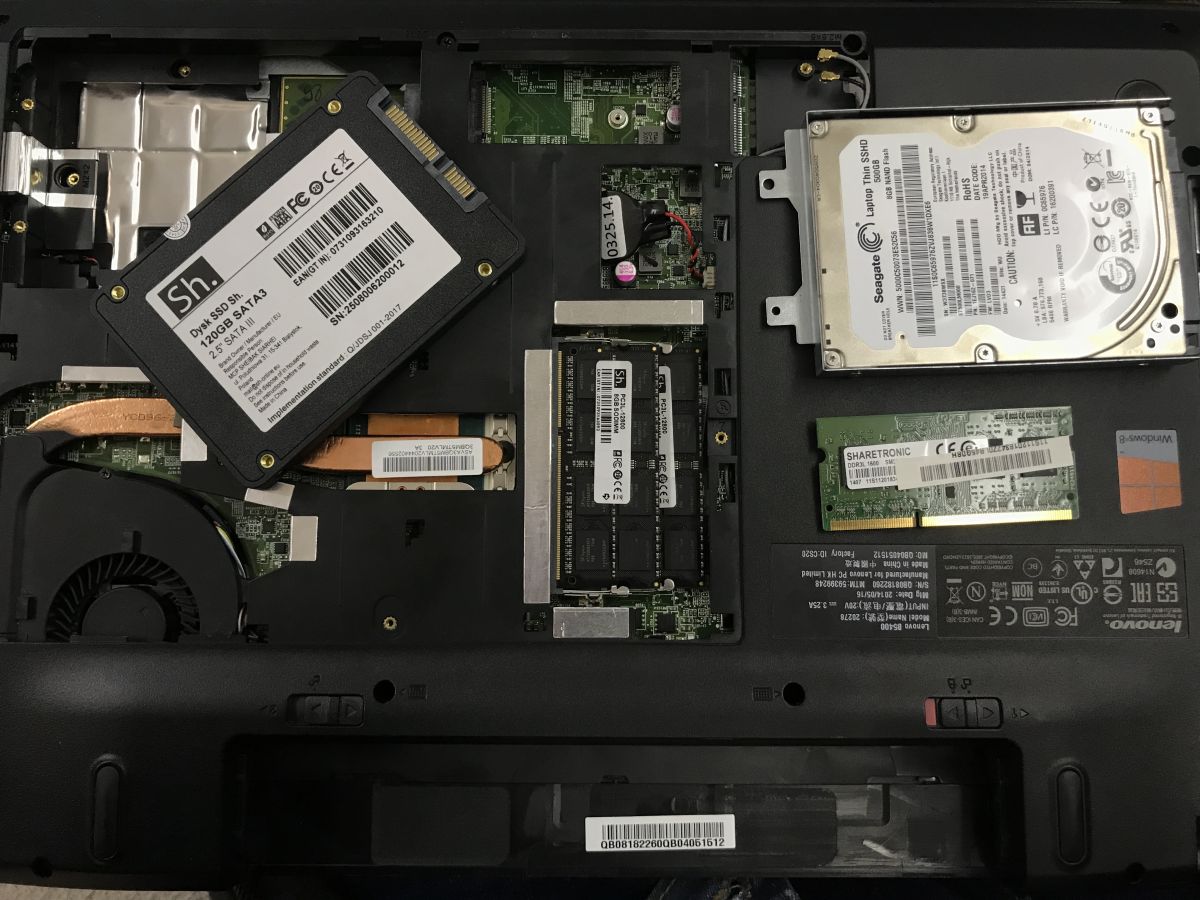

    I started with this RAM. Something tempted me to try with two 8GB bones each. I guess that's silly, as RAM prices are knocking down, but everyone has different hobbies. I matched the two matching dice. Of course I disconnected the battery before running. With the 2x8 GB configuration the laptop wouldn't get up, and after running 4 + 8 GB there was an unusual problem. The laptop stopped booting Windows even though the drive was seen. I checked the standard stuff:
    - second SATA media, second SATA port (I have a drive bay for the CD/DVD slot)
    - booting from USB (Linux)
    - bIOS settings, legacy, fastboot
    - cMOS reset (battery)

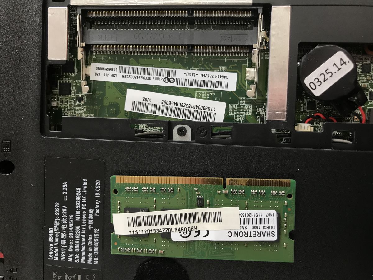

    Nothing wanted to work, so I decided to revert to the initial RAM configuration (the memory that came from the factory) and then I found that the problem still remains and booting does not work despite repeating the above described operations.
    Open laptop RAM bay with SO-DIMM slots and a DDR3L 4GB module lying below

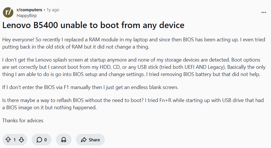

    A quick web search quickly made me realise that I'm not the only one having this problem on this particular model of laptop:
    Screenshot of a Reddit post about a Lenovo B5400 that cannot boot after a RAM replacement.
    It's exactly the same as mine! The laptop, colloquially speaking, has been "stoned" and now needs to be rescued. I decided on the "atomic" option, which is to upload a new BIOS with the CH341 programmer. This requires getting into the motherboard, i.e. you have to take the whole laptop apart.

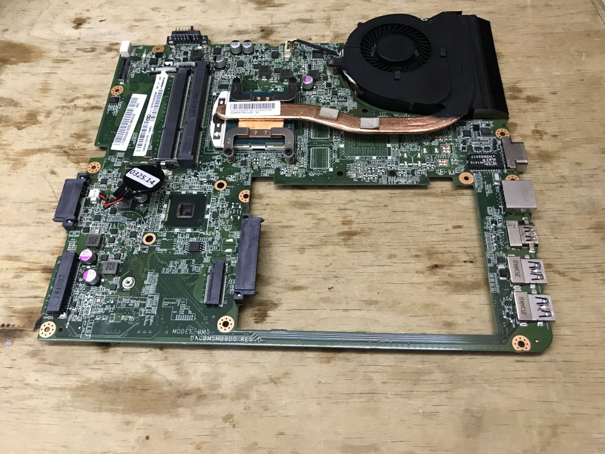

    Laptop motherboard with fan, copper heatsink, and RAM slots on a wooden work surface

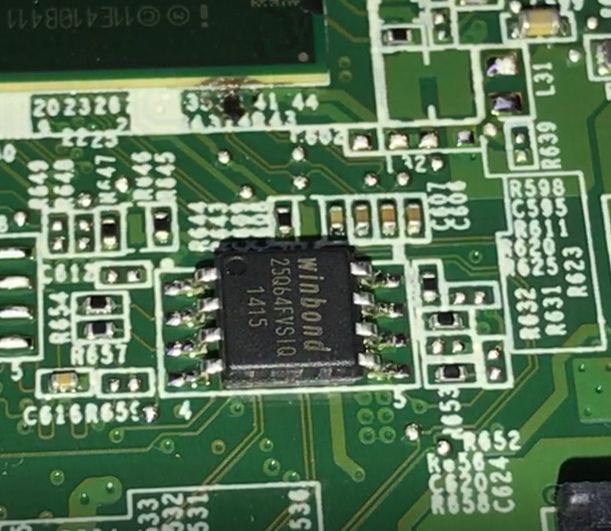

    The BIOS is in a tiny flash memory bone, here Winbond 25Q64FVSIG. the 64 in the name indicates the size - 64 megabits, or 8 megabytes. It needs to be programmed, but first also make a copy of it .
    Close-up of a motherboard section with a Winbond 25Q64FVSIG chip and surrounding SMD components

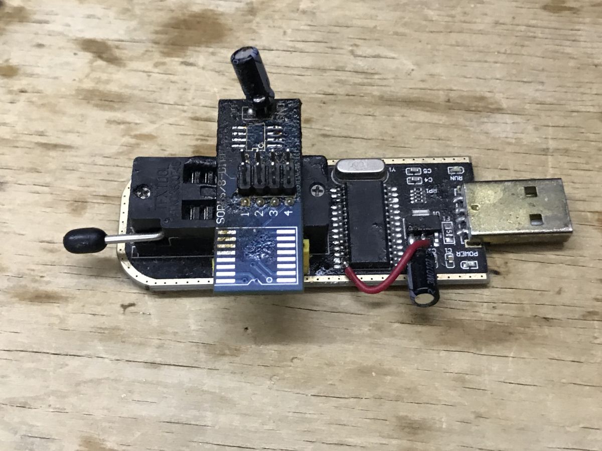

    Such a memory is supposedly programmable on the chip, but in my experience this doesn't always work well, so I soldered the whole thing out with hot air and programmed it on a board-transfer from CH341. Of course the uploaded BIOS has to be preferably under the same version and revision of the motherboard as we have, plus it also contains the keys/OEM, so you either have to patch them yourself afterwards or resign yourself to losing them.... i was able to find a fit on the web for the upload candidate. Internet forums are a treasure mine though.
    CH341 USB programmer with SOP8 clip and adapter board on a workbench

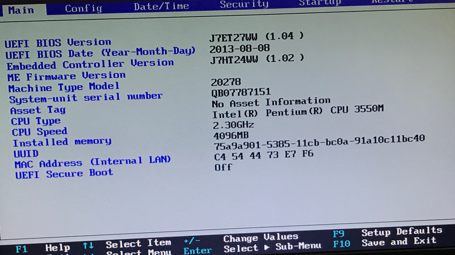

    The laptop has started! The BIOS shows an older version. You can see the differences:
    Lenovo UEFI BIOS screen showing BIOS version, Intel Pentium 3550M, and 4096 MB installed memory

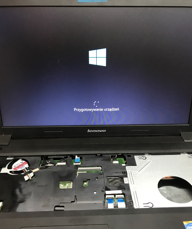

    Windows from the old drive boots immediately, so it is however it was indeed the BIOS that was at fault:
    Lenovo laptop with partially opened interior; Windows logo on screen with “Przygotowywanie urządzeń” text.

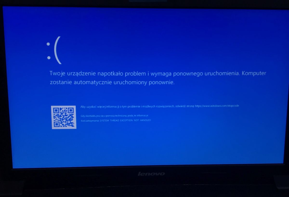

    However, the 8+8 version gives a blue screen of death, so in the end I opted for 8+4. 8+4 works in both combinations, so it's not like one of the new bones is faulty either.
    Windows blue screen error with restart message and QR code shown on a Lenovo laptop screen.
    The 4+8 version works fine. Also booting from USB now works. You can install your preferred operating system. There are not the problems that appeared before.

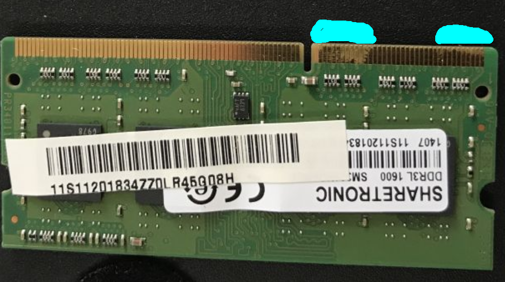

    Let's take a closer look at the state of the connector of this RAM module (tick marks mine):

    That's its own way, except that it's the old 4 GB RAM module what was there, not the new one, so that neither explains the "brick" nor the blue screens with the 8+8 combination.

    Fn+R didn't work for me, by the way, you have a screenshot from Reddit (first post) about that too. I was surprised myself, and at first I already thought I had damaged something with electrostatics (first time ever), but a quick web search showed that I wasn't the only one who had this situation.

    This is by the way, except that this is the old 4 GB RAM module that was there, not the new one, so this neither explains the "brick" nor the blue screens with the 8+8 combination.
    A. Looking at this photo, I thought of the laptop getting wet from underneath and expected a similar condition of the memory module slot.
    What is it like in reality?
    B. Isn't there the possibility of some sort of error when trying to operate the RAM modules in dual-mode?

    The contacts on the RAM dice are indeed very dirty. I always clean the contacts with isopropyl alcohol in such cases, although some people recommend for this purpose.... a pencil eraser. :)
