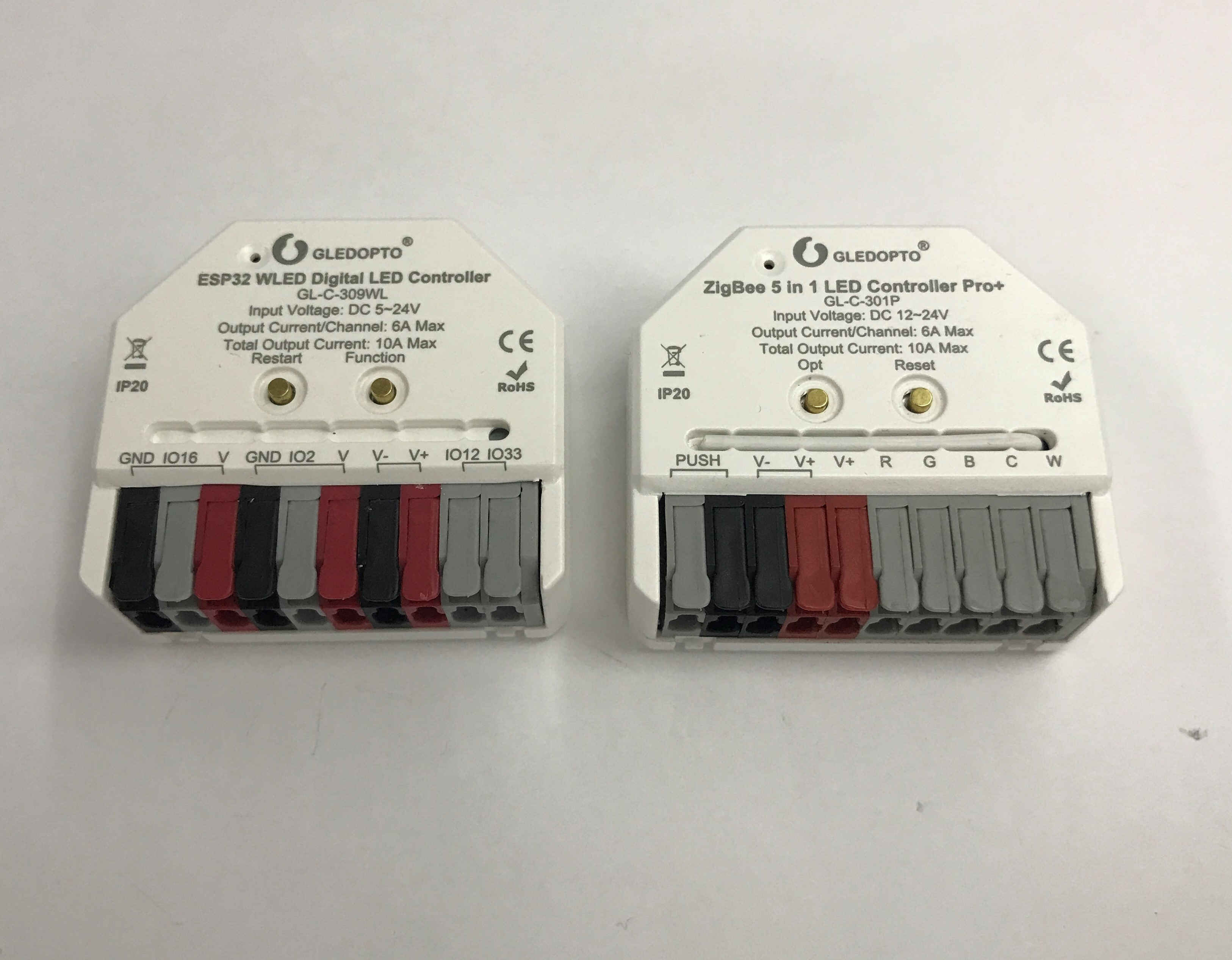

Two white Gledopto LED controllers with wire terminals, labeled ESP32 WLED and ZigBee 5-in-1
Today I am showing two LED controllers that can work without a cloud from the factory. No soldering is required. The first one is the GL-C-309WL, it is based on ESP32 and has an open WLED firmware uploaded. It works 100% locally, we configure it via Wi-Fi. The second is the GL-C-301P, it offers Zigbee communication and can work with Home Assistant via any supported transceiver for Zigbee2MQTT. Both of these devices could be a good choice for those who value privacy and security for their installations.
Let's start with the WS2812 controller. The GL-C-309WL operates on 5-24 V DC. It has IO16, IO2, IO12 and IO33 pins. These can be configured later in the software. Instructions:

This is used to control a strip of individually addressable, coloured WS2812 or similar LEDs.
