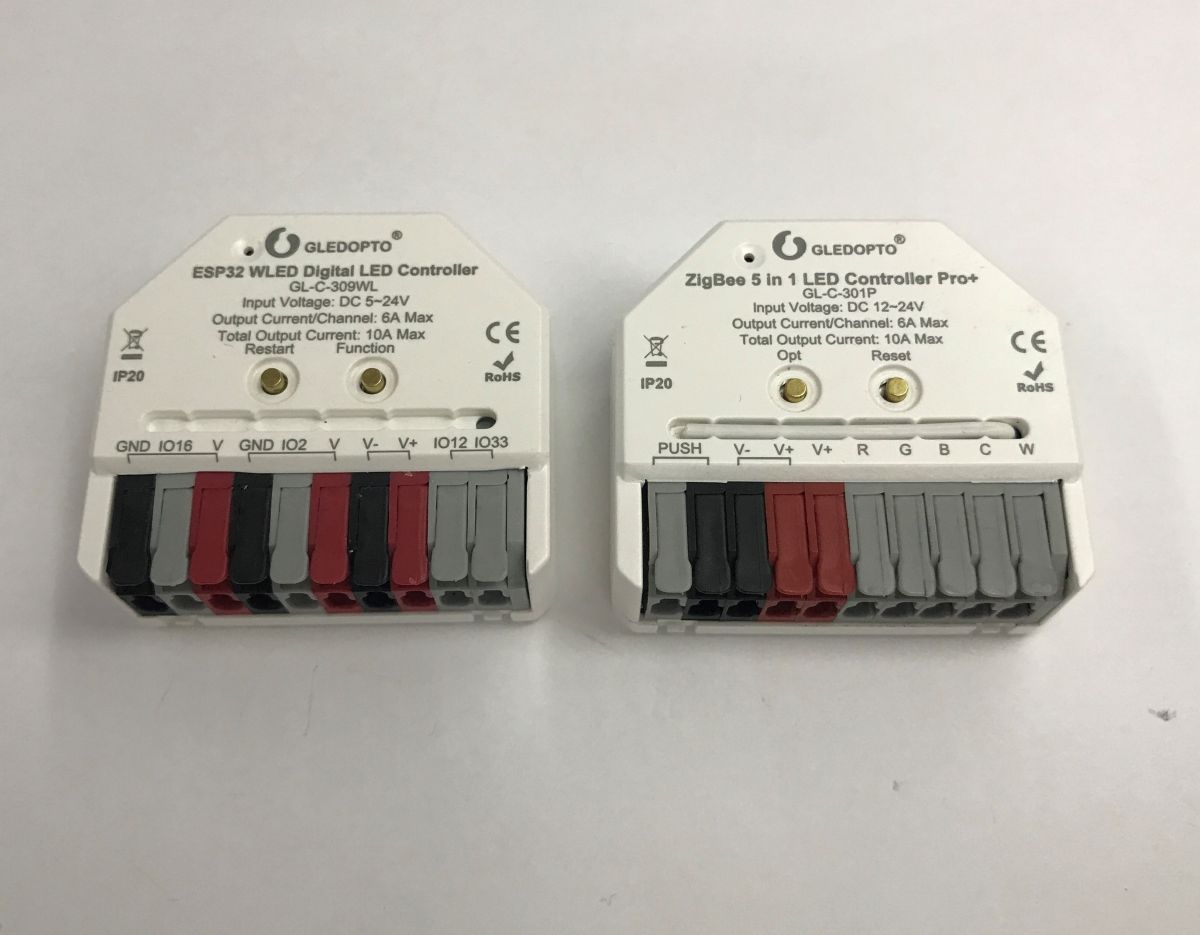

    Today I am showing two LED controllers that can work without a cloud from the factory. No soldering is required. The first one is the GL-C-309WL, it is based on ESP32 and has an open WLED firmware uploaded. It works 100% locally, we configure it via Wi-Fi. The second is the GL-C-301P, it offers Zigbee communication and can work with Home Assistant via any supported transceiver for Zigbee2MQTT. Both of these devices could be a good choice for those who value privacy and security for their installations.

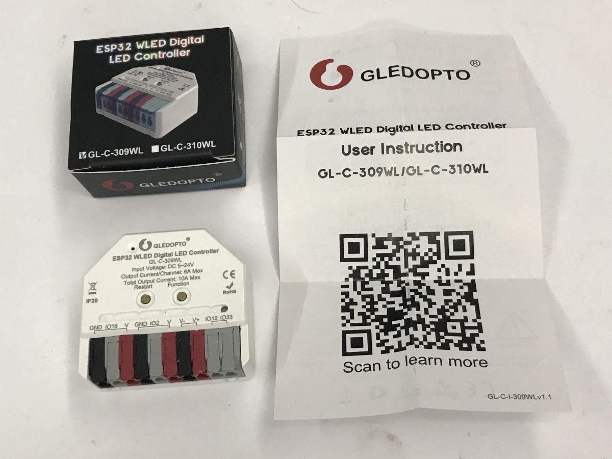

    Let's start with the WS2812 controller. The GL-C-309WL operates on 5-24 V DC. It has IO16, IO2, IO12 and IO33 pins. These can be configured later in the software. Instructions:
    Gledopto ESP32 WLED LED controller GL‑C‑309WL with box and instruction sheet with QR code Gledopto GL-C-309WL LED controller box, the white controller unit, and a leaflet with specs and wiring diagram
    This is used to control a strip of individually addressable, coloured WS2812 or similar LEDs.
    Inside we have the WLED firmware uploaded:

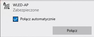

    The whole thing, when reset, forms an AP network with the password wled1234:

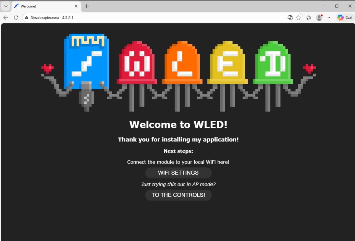

    The configuration page is at IP address 4.3.2.1, there you can pair the device with our network and set its mode of operation.

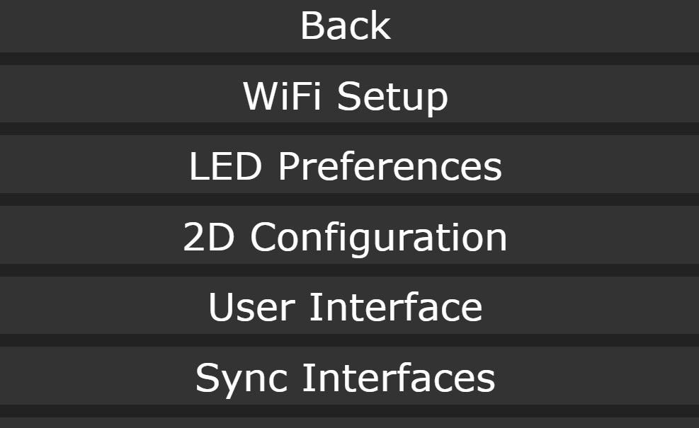

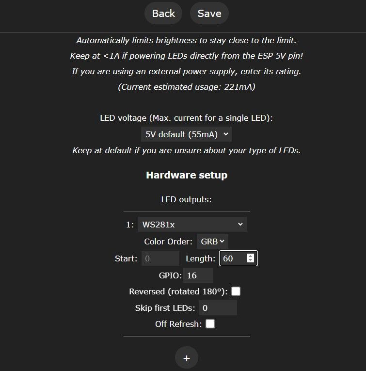

    This is done in the menu - here you basically have to set the number of LEDs in the bar used and the colour order and GPIO on which it is connected.
    WLED settings menu showing WiFi Setup, LED Preferences, 2D Configuration, and other options
    Screenshot of WLED settings: WS281x output, GRB order, length 60, and GPIO 16
    After that, you can freely select animations from the menu and connect the controller to other ecosystems:
    Screenshot of the WLED web UI with a color wheel, effect list, and brightness slider

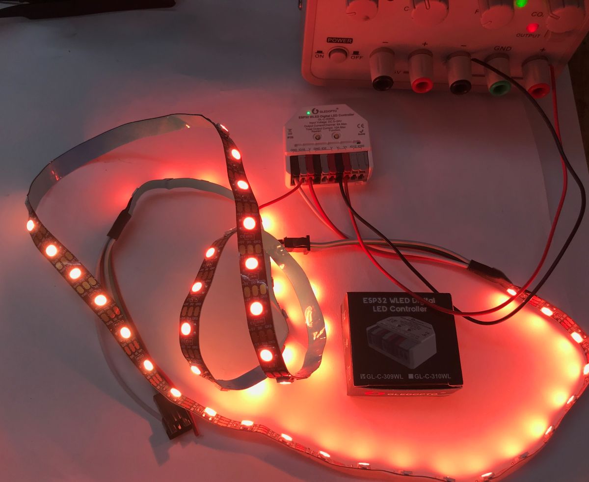

    Examples of effects with the individually addressable WS2812 strip powered by 5 V:
    Red-glowing LED strip connected to an ESP32 WLED controller on a workbench Lit LED strips lit on a table, connected to a Gledopto controller and bench power supply Green-lit LED strip connected to an ESP32 WLED controller on a desk, with the product box nearby. Purple-lit LED strip on a table connected by wires to an LED controller module

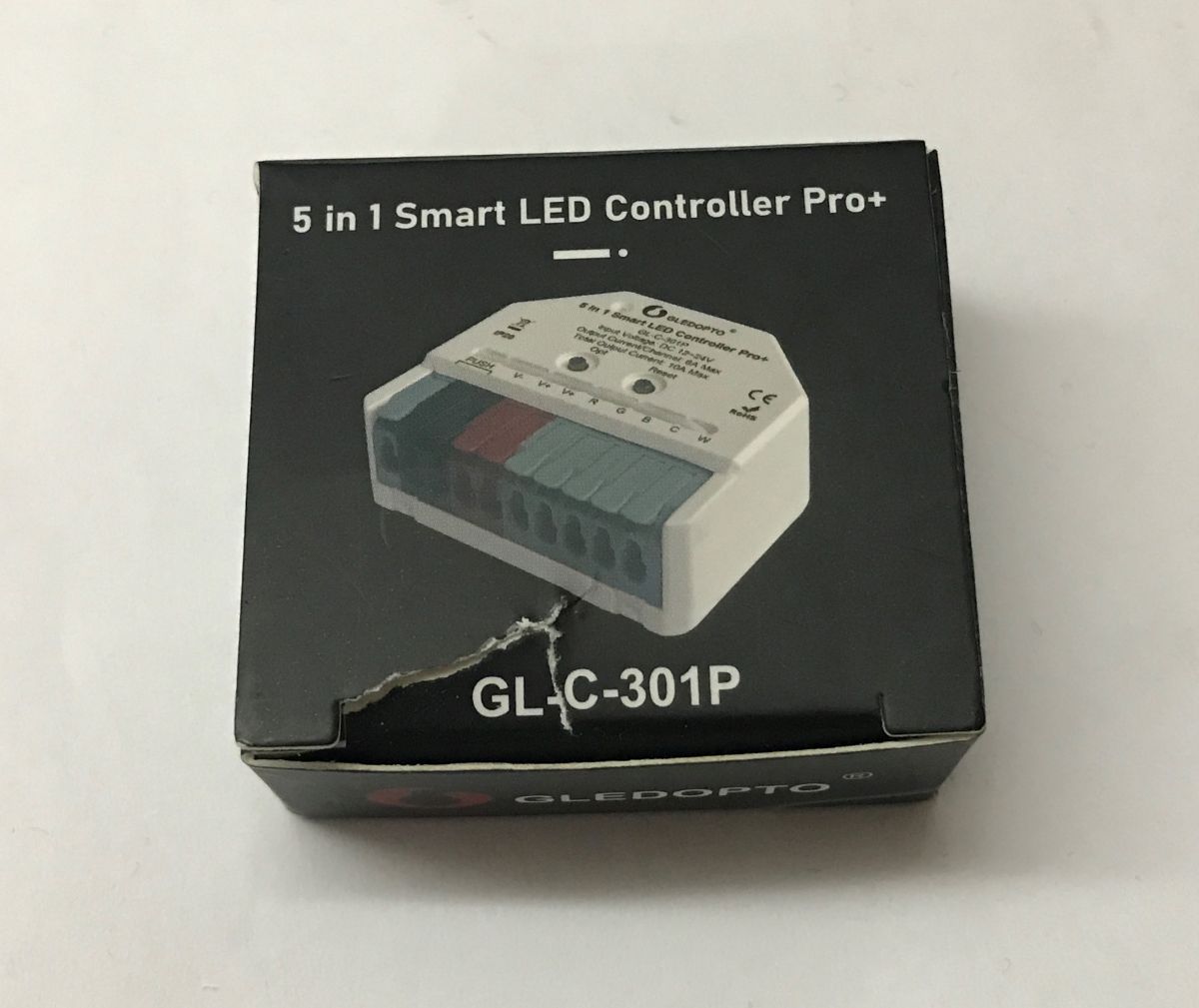

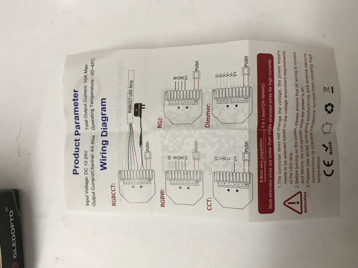

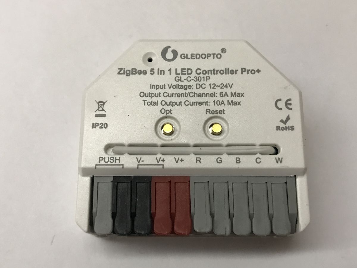

    The GL-C-301P is still left. There is no Wi-Fi here, but there is Zigbee. It can work with HA as we have a CC2531 antenna. It supports RGBCW LED strips at 12-24 volts.
    Product box labeled “5 in 1 Smart LED Controller Pro+” with model GL-C-301P Gledopto ZigBee 5-in-1 LED Controller Pro+ GL-C-301P with terminals V-, V+, R, G, B, C, W
    Instruction sheet with product parameters and wiring diagrams for an RGBCCT LED controller on a white surface GLEDOPTO GL-C-301P instruction sheet with a QR code and “Scan to learn more” text

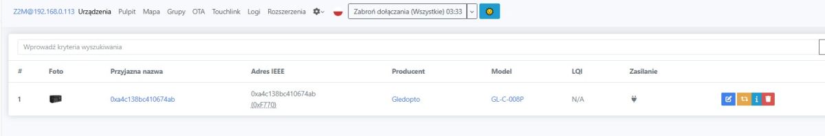

    Home Assistant correctly detects the device:
    Zigbee2MQTT interface screenshot with a device list and pairing logs on the right
    It is detected fully correctly - as GL-C-008P:
    Zigbee2MQTT screenshot showing Devices list with a Gledopto GL-C-008P controller
    Zigbee2MQTT screen showing details for a Gledopto GL-C-008P LED controller

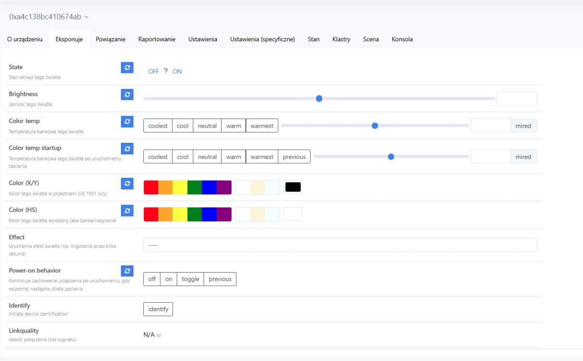

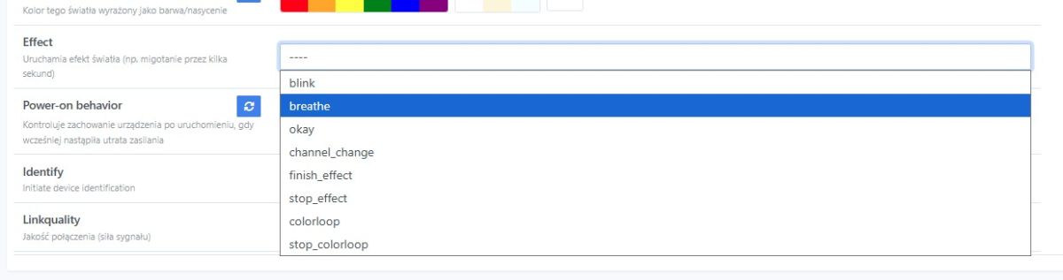

    Integration with HA offers control over brightness level, RGB colour and CW temperature. In addition, we can change the state of the controller after start-up (on, off, switching, memory).
    Home Assistant screenshot showing light controls: brightness, color temperature, color pickers, and effects.
    Available effects:
    Home Assistant settings screenshot with an Effects dropdown for a light, “breathe” highlighted.

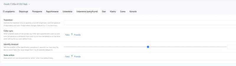

    Specific settings - interesting, there is even a smooth switching time between colours:
    Screenshot of Home Assistant device settings with toggles and an “Identify timeout” slider

  • Physical OPT button selects controller mode
    #2 21869231
    krzbor
    Posts: 1783
    Help: 42
    Rate: 1072
    it is not possible, for example, to control these 5 independent single-colour LED strips
    From the description it appears that it can work as a "dimmer" - generally that it can work in 5 different modes. Have you checked how this is selected? This "dimmer" mode suggests the ability to control 5 LED strips independently, and that could be very interesting.
    I asked Chat about this. He gave me the answer:
    You do this physically with a button on the controller (OPT):
    a short press on OPT → switches the mode
    NOTES:
    ➜ each time you change mode, the device removes the Zigbee pairing
    So the procedure looks like this:
    Switch on the controller
    You click OPT until you hit mode (e.g. RGBW / CCT etc.)
    Only then:
    reset (if necessary)
    pairing to Zigbee2MQTT
  • #3 21869284
    Posts: 14770
    Rate: 12913
    The instructions on the schematic repeat V+ next to each output terminal, which would suggest a common contact operation, plus I don't know about the HA - supposedly it would see 5 separate dimmer entities? No less, I'll check when I'm there.
