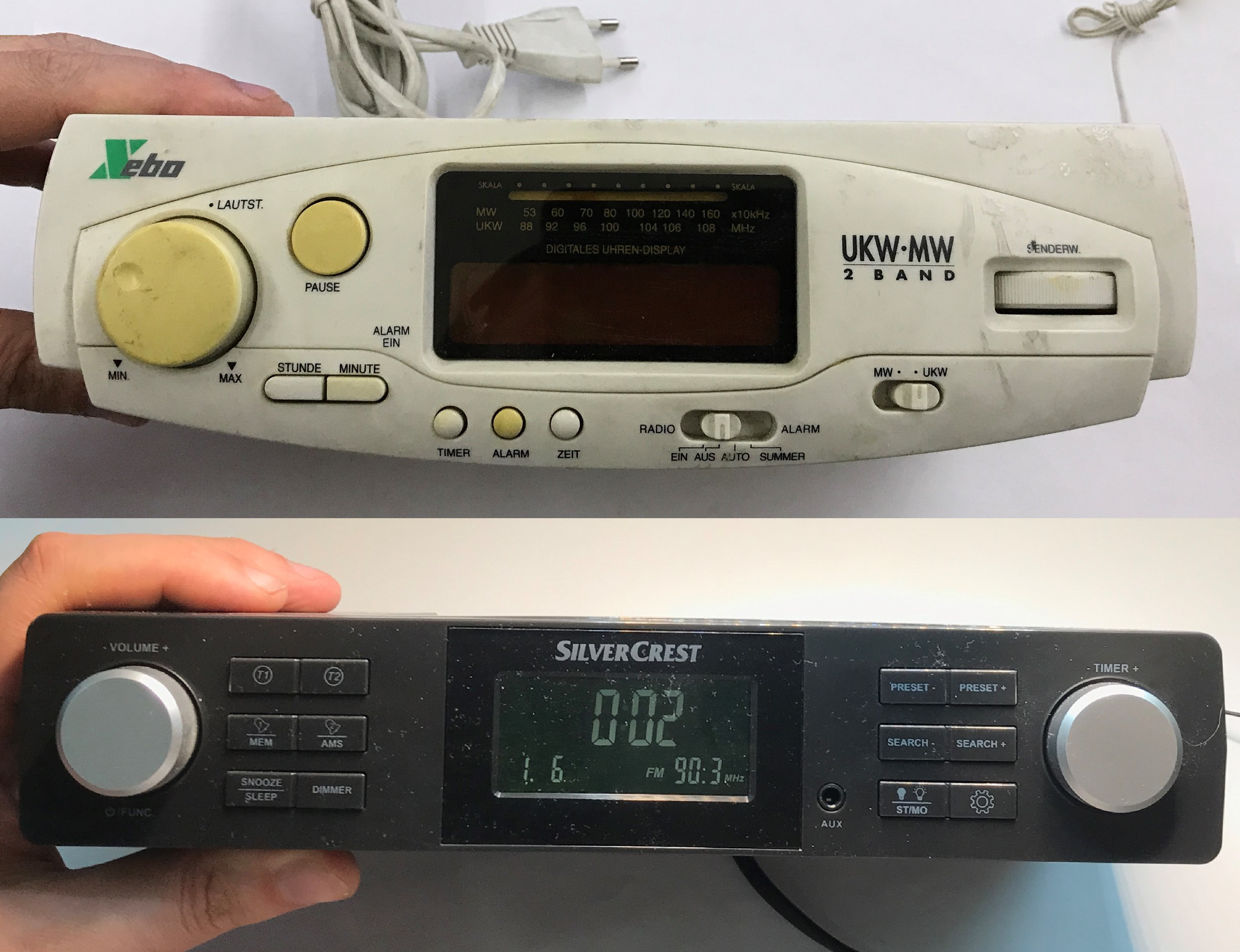

Two kitchen clock radios: older white unit with mechanical dial and newer black SilverCrest with LCD
What is the evolution of the kitchen alarm clock radio? Do the newer models differ from the older ones in construction? How is the tuning, display, power supply implemented? Here, I will try to demonstrate this using the example of two kitchen radio receivers from different periods. Let's start with the older one.

Although both devices belong to the same equipment category, the design differences between them are very clear. The most noticeable changes are:
- power supply - the heavy mains transformer used in the older model has been replaced by a lightweight and more efficient switching power supply (flyback topology).
- audio track - the older receiver only offers mono sound, while the newer model already supports stereo.
- degree of digitalisation - the older unit uses a simple analogue AM/FM radio path working with a clock chip (LM8560). The newer model is dominated by digital electronics: the radio receiver is integrated in a single chip (C9636), controlled via an I2C interface and offering functions such as RDS or automatic station search.
- in addition, there are clear differences in the way information is handled and presented:
- tuning - the mechanical tuning on the older model was replaced by digital control using an encoder.
- display - a more energy-efficient LCD was used instead of the LED display.
The whole thing shows well the direction of development of this type of equipment - from simple, analogue designs to highly integrated, digitally controlled systems with greater functionality and convenience of use.
The question is, which radio was better? I leave it to you to decide...
