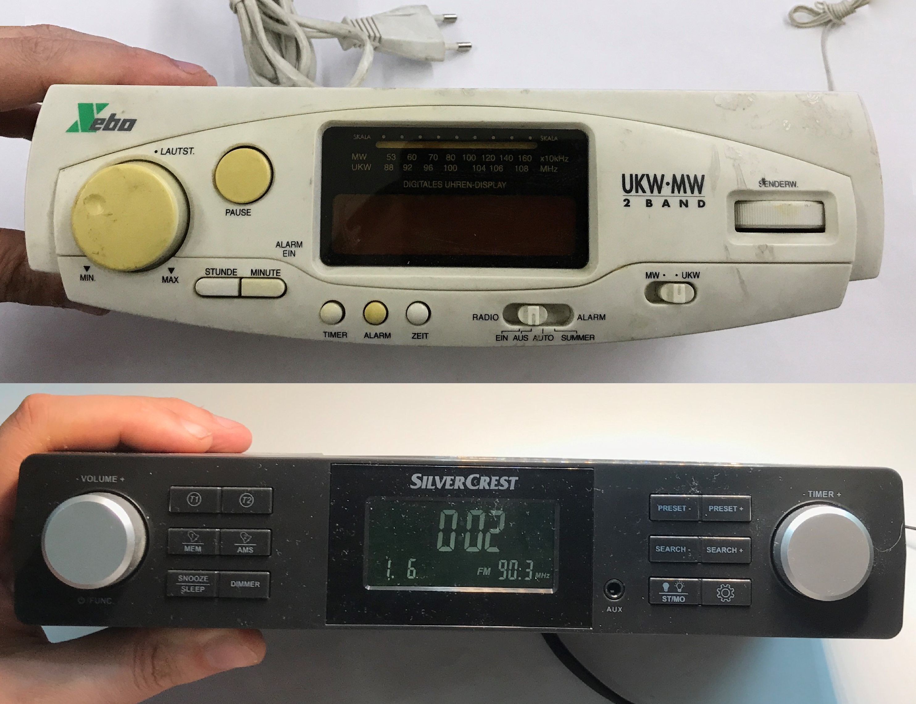

  • Two kitchen clock radios: older white unit with mechanical dial and newer black SilverCrest with LCD
    What is the evolution of the kitchen alarm clock radio? Do the newer models differ from the older ones in construction? How is the tuning, display, power supply implemented? Here, I will try to demonstrate this using the example of two kitchen radio receivers from different periods. Let's start with the older one.

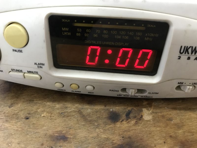

    URB 693A
    The URB 693A features a large 7-segment LED display and mechanical scale. The radio can operate in alarm clock and timer mode.
    Close-up of a kitchen radio with red 0:00 LED clock display and MW/UKW tuning scale

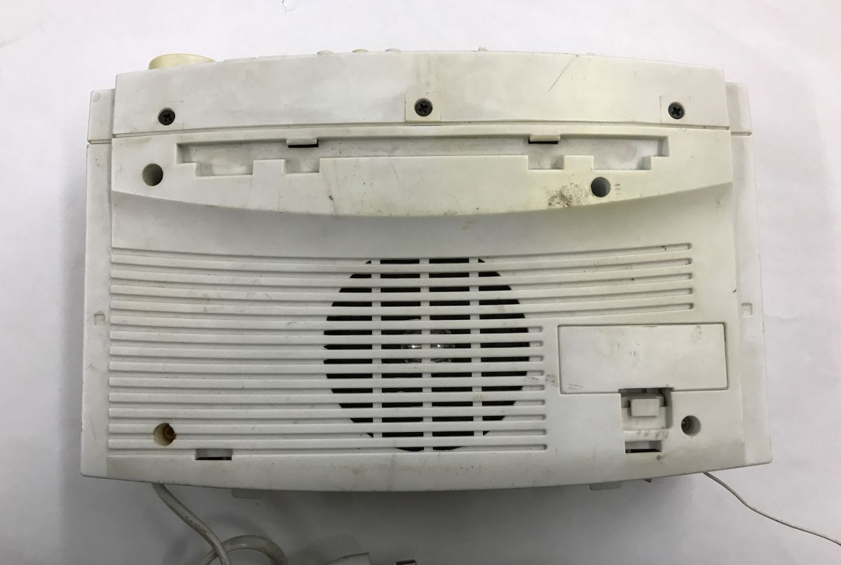

    A glance at the underside reveals that the whole thing only plays in mono mode. You can also see the battery slot for keeping time.
    Bottom view of a white kitchen radio with a speaker grille and a battery compartment cover

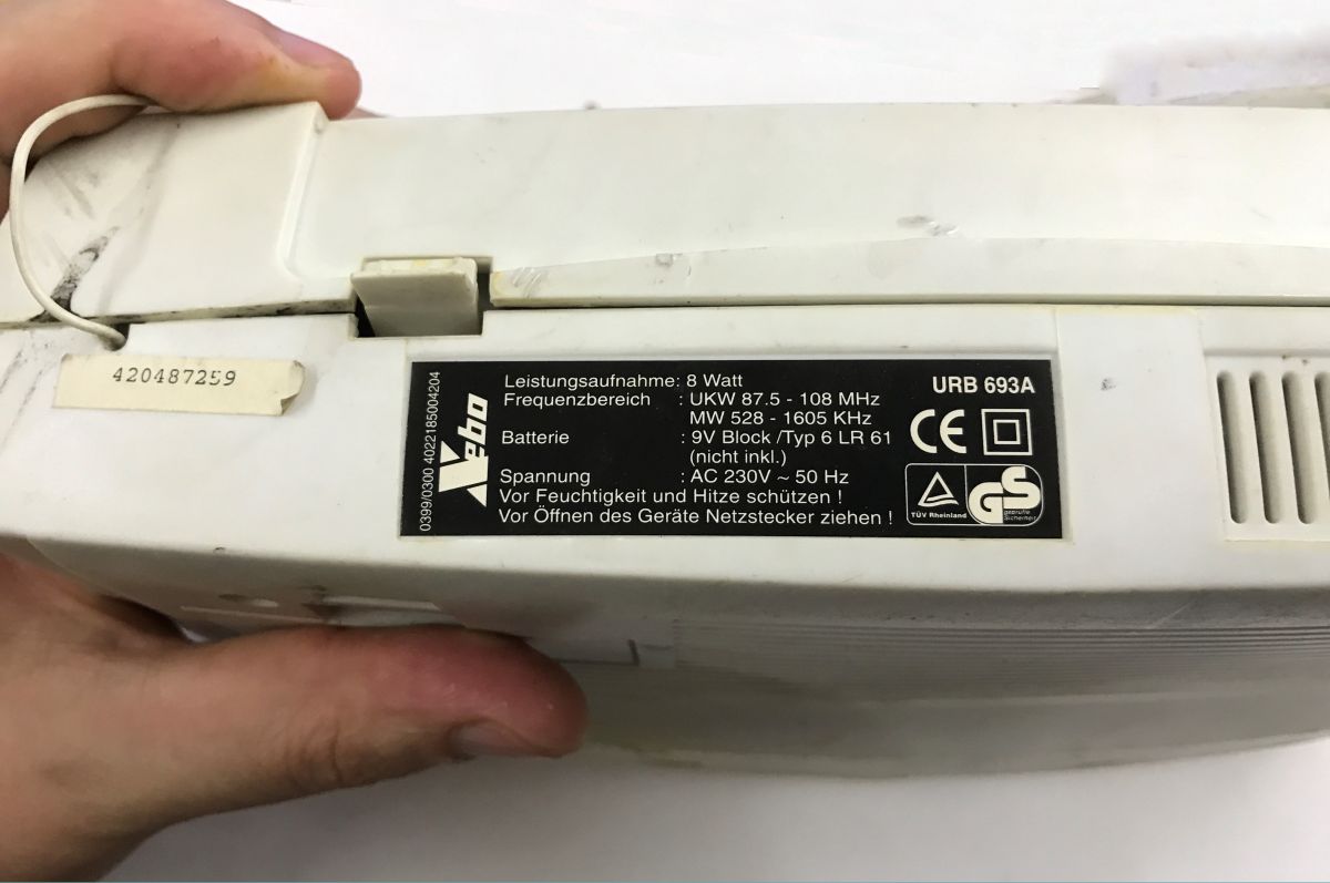

    Nameplate:
    Nameplate label “URB 693A” on the underside of a white device, held in hands

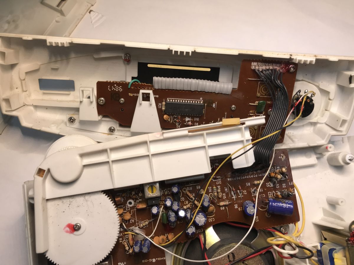

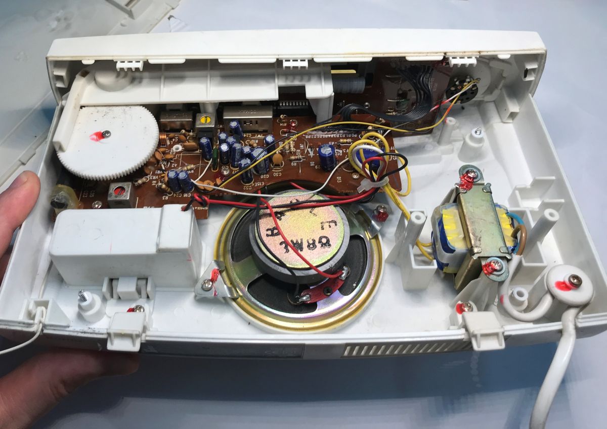

    Let's take a look inside. The first thing that strikes the eye is the classic mains transformer, there is no switching power supply here. Apart from that, there is the already mentioned mechanical scale, a single speaker and a single-sided PCB.
    Inside a white radio: PCB, speaker, transformer, and a tuning mechanism with a large gear wheel
    You can also see the screws secured to prevent loosening in transit.
    Interior of a kitchen radio with brown PCBs, tuning gear, wiring harness, and a round speaker

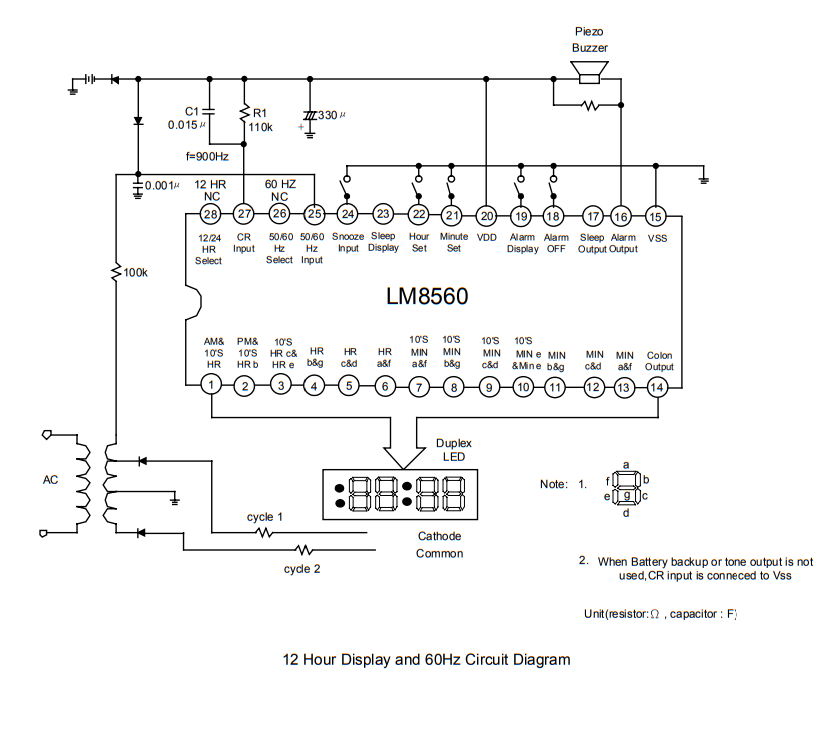

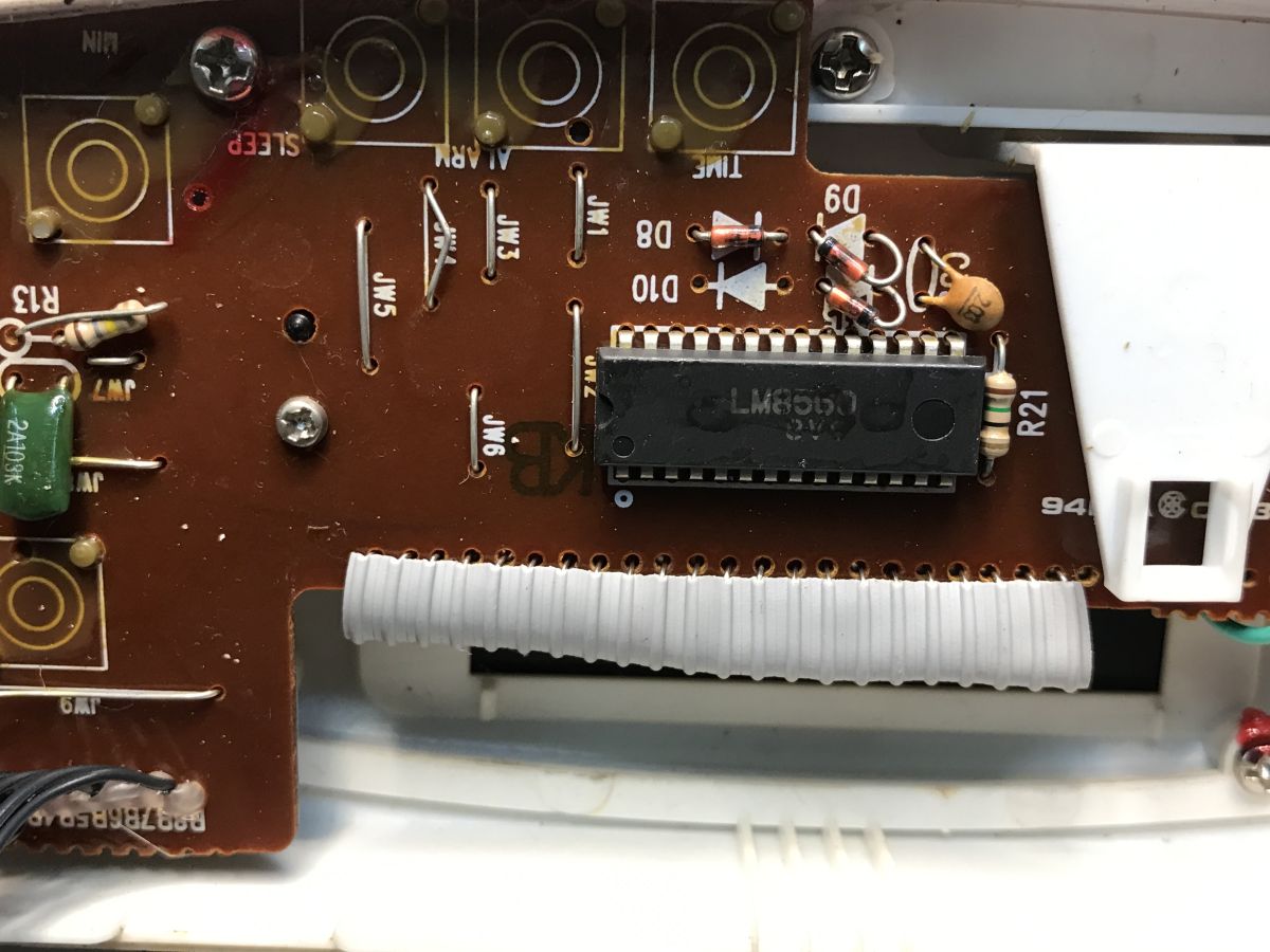

    The display is controlled by the LM8560:
    Close-up of a brown PCB with an LM8560 IC and a ribbon connector inside a device housing

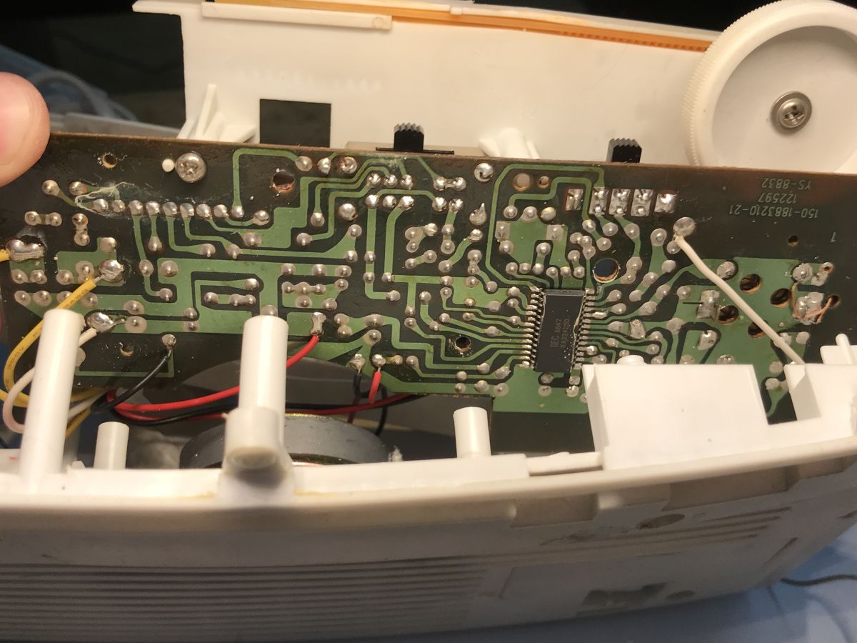

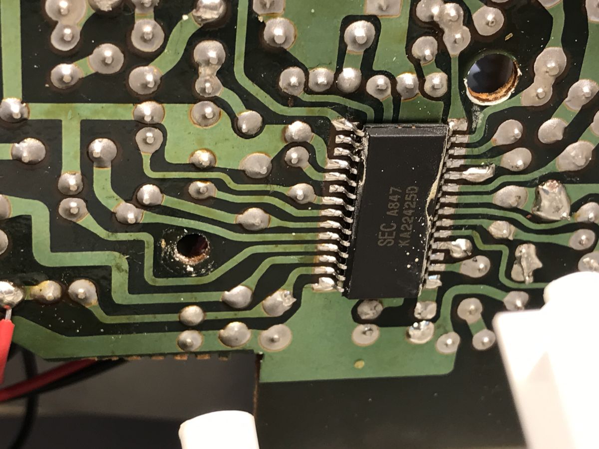

    Separately is the KA22425D chip, an AM/FM radio controller, fully analag:
    Close-up of PCB underside with IC marked “SEC A847 KA22425D” and soldered traces Bottom side of a PCB inside a white radio casing, showing traces, solder joints, an IC, and wires

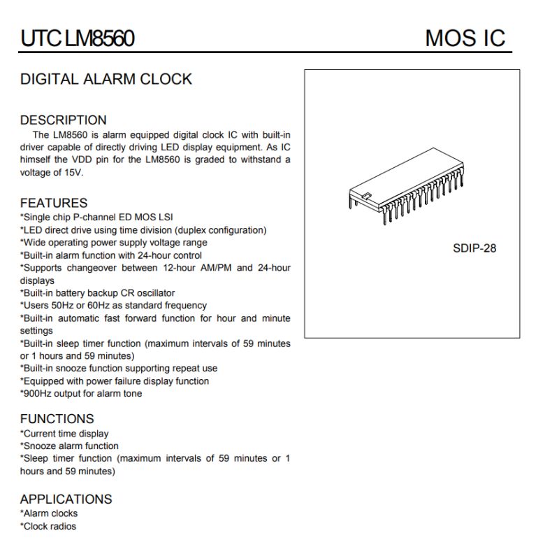

    The LM8560 handles pushbuttons, display and timing. Timing is clocked by the frequency of the mains through a transformer and, in the event of a power failure, is sustained by the battery through a simple RC generator. The LM8560 can switch the radio on and off when used as an alarm clock.
    Datasheet page for UTC LM8560 with feature lists and an SDIP-28 package drawing
    LM8560 circuit diagram for clock/alarm control and 7‑segment LED display multiplexing

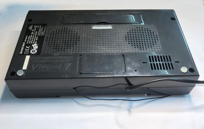

    SilverCrest SKR 800 C3
    A newer radio, also with backup, but already stereo and with an additional light.

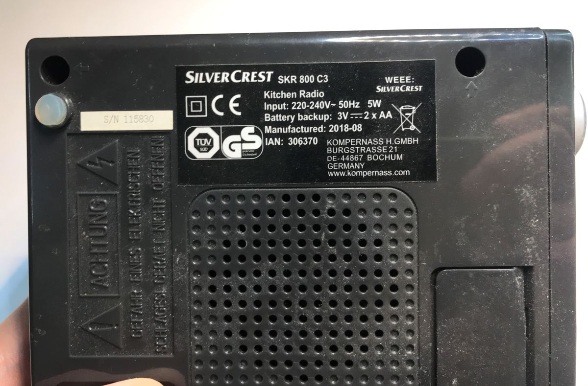

    Bottom of a black SilverCrest radio with speaker grille, battery flap, and specification label
    Plaque:
    Bottom of a black SilverCrest SKR 800 C3 kitchen radio with rating label and speaker grille

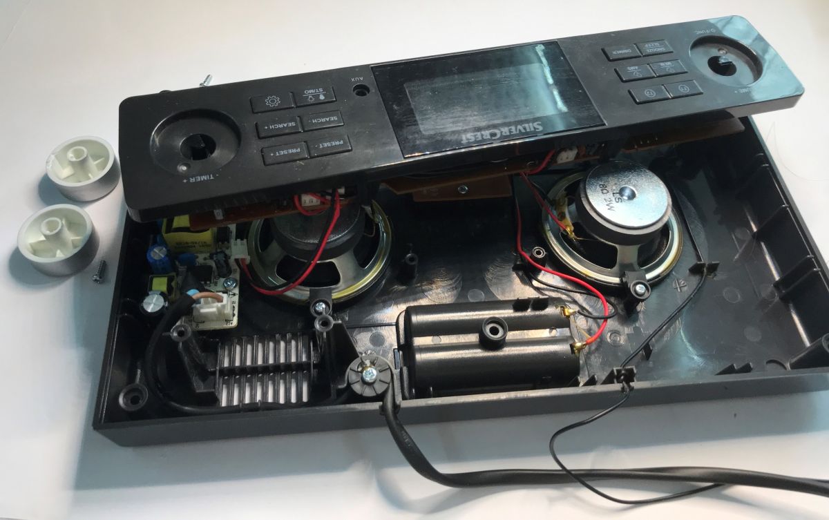

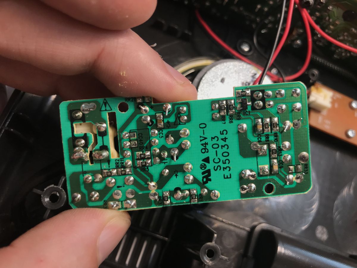

    The first change inside is the replacement of the mains transformer by a lighter, cheaper and more efficient switching power supply.
    Inside an open clock radio: two speakers, PCB boards, wiring, and a power-supply module
    In this case, it is based on the SW2604A circuit - this is a flyback converter driver integrated together with a keying transistor. The feedback is taken from the secondary side via an optocoupler. I even see a noise filter on the primary side, many manufacturers omit it. TL431 in the role of reference voltage hides at the bottom of the PCB:
    Bottom of a green PCB held between fingers, with solder joints and markings “94V-0 SC-03 E550345”.

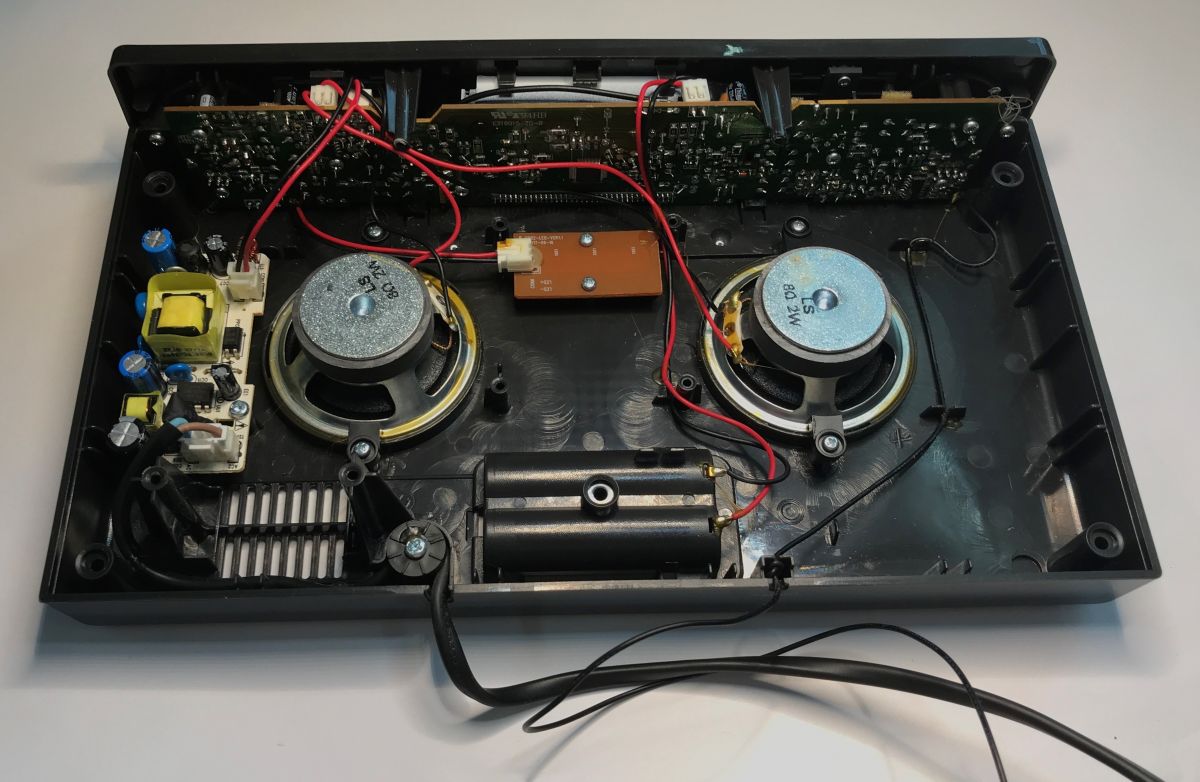

    It's now time for the PCB proper. There is one, but a single-sided one anyway:
    Disassembled SilverCrest radio showing speakers, battery holder, and circuit board

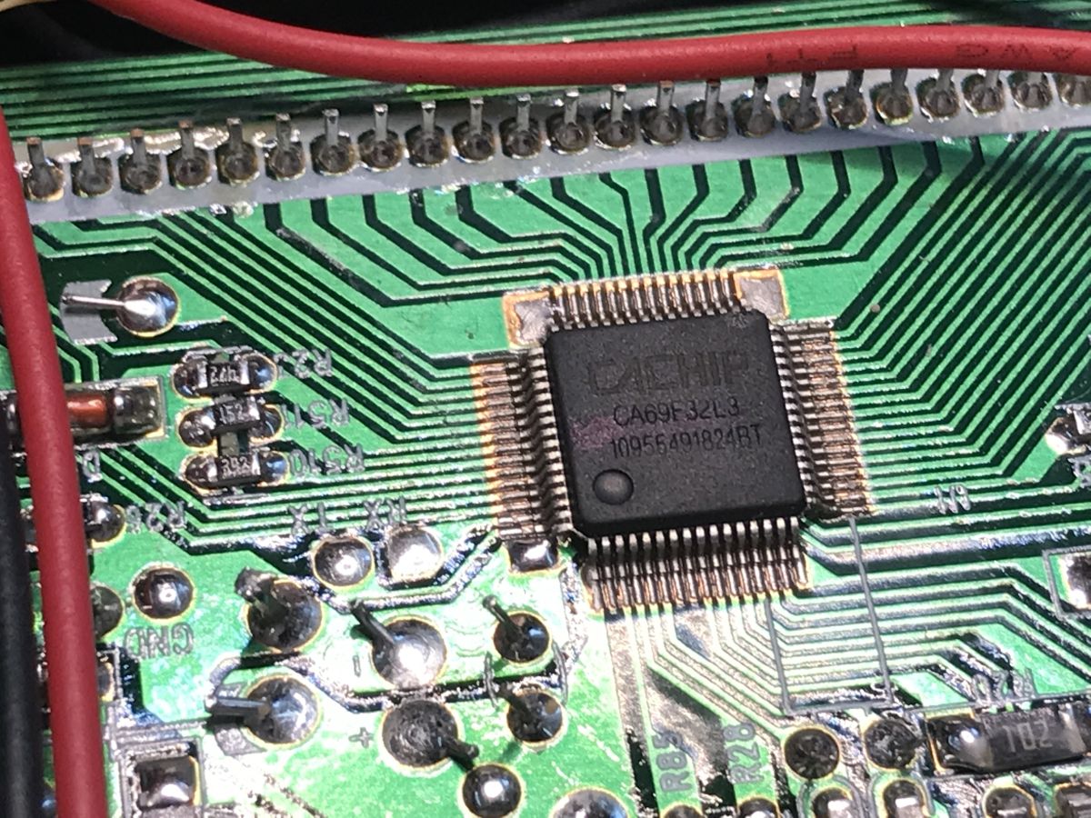

    What strikes the eye immediately is the encoder - something like a 'digital potentiometer'. Instead of changing the resistance, it generates pulses which the microcontroller reads.
    Close-up of CA69F32L3 microcontroller on a green PCB with dense traces and red wires
    The microcontroller itself is here the CACHIP CA69F32L3. It controls the LCD display directly, so it must have a built-in controller, and it also handles the buttons. Separately we only have the radio circuit:

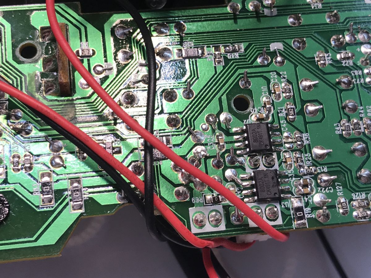

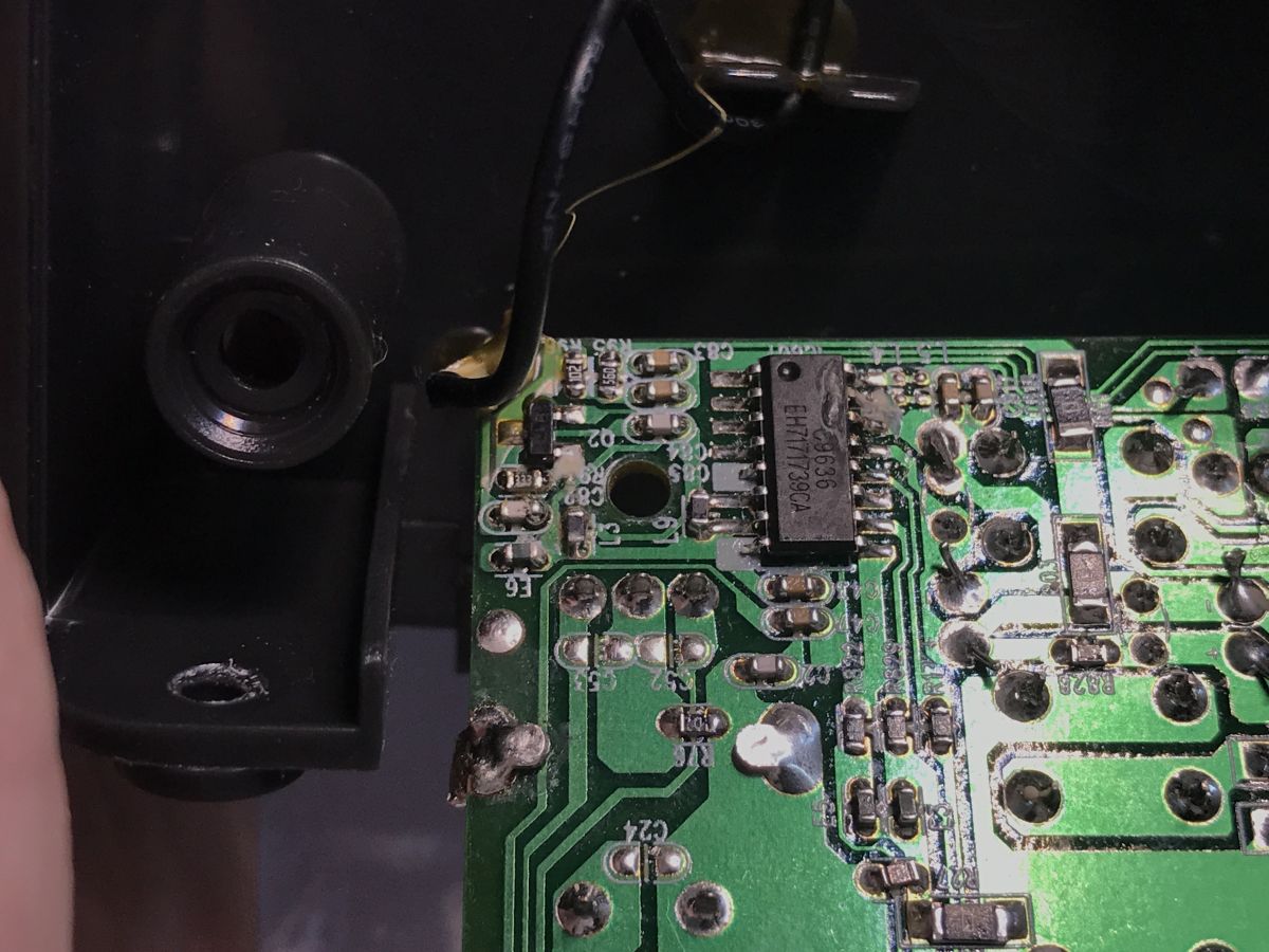

    There are still two pieces of 8002A audio amplifier left - right next to the speakers:
    Underside of a green PCB with solder joints, traces, two 8002A chips, and red and black wires crossing

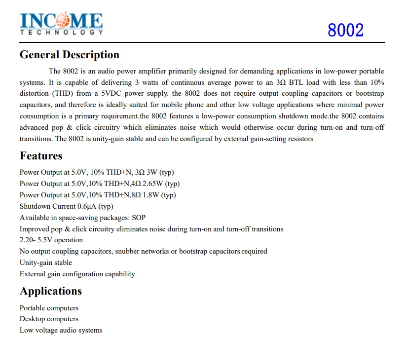

    Catalogue note:
    Datasheet page for 8002 audio power amplifier with general description and feature list

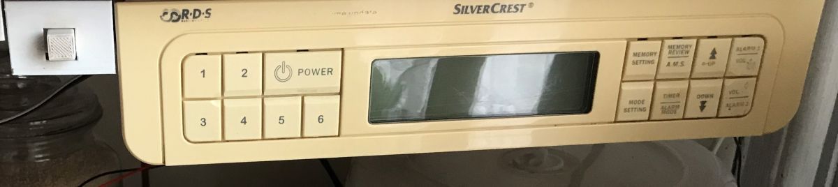

    There has also been one kitchen radio at my place for years, quite similar to what I presented in the first post, but there is a funny story connected with it.
    Control panel of a SilverCrest radio with display plus numeric and function buttons
    Namely, this radio, like other copies, has an alarm clock in it. But there are non-technical people in my house who have trouble operating equipment such as a radio. And the alarm clock on this unit is set from the default time of 00:00, so when someone accidentally turns on the alarm clock, it is just set to midnight. Well, that's how we've been woken up at midnight several times over the past decade or so by this radio turning on full blast as a result of someone 'blindly clicking' during the day. One time we decided that enough was enough, and the radio is unplugged when not playing.

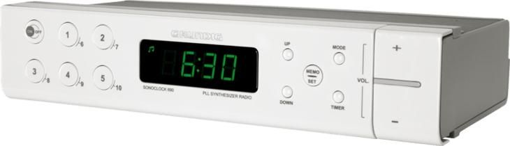

    Nothing after stereo if the radio has speakers in a common compartment and placed so close together. Anyway, both units give the impression of being shoddy.
    At my parents' house they play something like the Grundig Sonoclock 690, oh yeah:
    White Grundig Sonoclock clock radio with green 6:30 display and front control buttons
    Simple to use, but most importantly.... has a large (10 cm) good quality speaker and I must say that for a kitchen radio, it's downright a pleasure to listen to.
