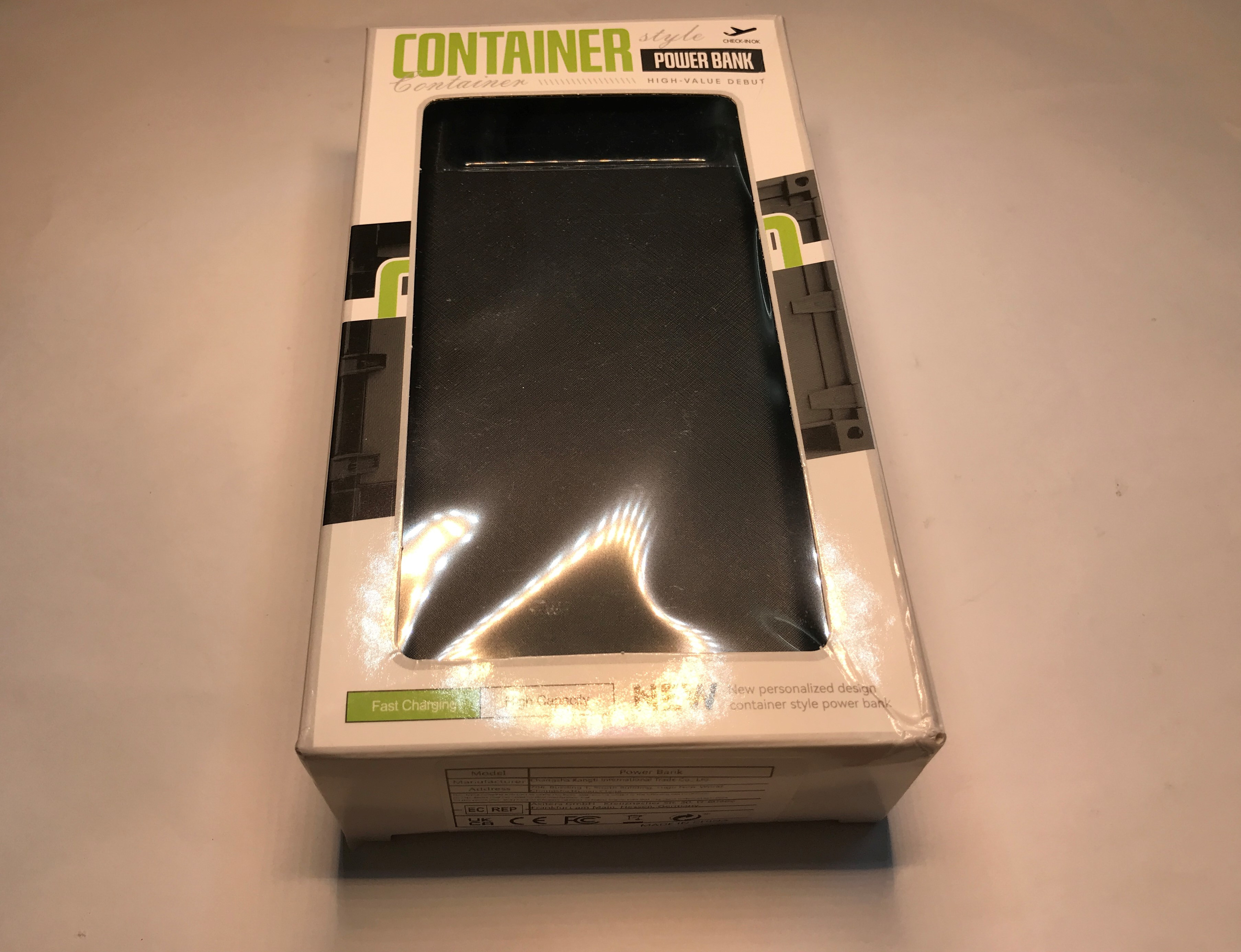

  • A no-name AliExpress powerbank labeled “Power Bank” and claiming 50 Ah at 3.7 V was bought for about 50 PLN (~15 USD) to see whether the bargain is real.
  • The casing advertises “fast charging,” but the unit has no Quick Charge support, only 5 V/2.1 A output, and a QC trigger cannot raise the voltage.
  • Charging from 0 to 100% draws less than 16 Ah at 5 V, while discharge tests deliver about 12.5 Ah at 5 V.
  • The biggest red flag is the mismatch between 50 Ah and 74 Wh: the numbers imply roughly 20 Ah, suggesting bad labeling, a typo, or creative marketing.
Black power bank in a windowed box labeled “CONTAINER” and “POWER BANK”
I've been presenting my capacity tests of various powerbanks on the forum for a while now, but I've recently realised that I've been too conscious of choosing good models such as Baseus , JoyRoom or Romoss . For this reason, I decided to go for the first cheapest 50 Ah powerbank from China and see what happens. Will I get a package at all, or will they send a brick?
I paid about 50PLN (~15USD). The price is quite small, but maybe that's because importers don't have to make money when I buy direct from overseas?

In summary , there are two problems here.
The first problem is the lack of QC, this significantly slows down the charging of modern devices. The packaging slogans 'fast charging', but that's just marketing text, it's different to supporting the Quick Charge standard.
The second problem is capacity. The first thing that surprises me is the declaration of 74 Wh of energy while claiming 50 Ah of capacity. How did they come up with that? As the cells inside are nominally 3.7 V, after all, from 50 Ah it will come out around 185 Wh rather than 74 Wh. To get 74 Wh at nominal 3.7 V, the capacity would have to be ~20 Ah, not 50 Ah.
You could even conclude that this is a 20 Ah powerbank that a creative marketing person changed 20 to 50 to make it look better, while forgetting about those watt-hours because he probably didn't even know what they were...
Or a typo crept in.
