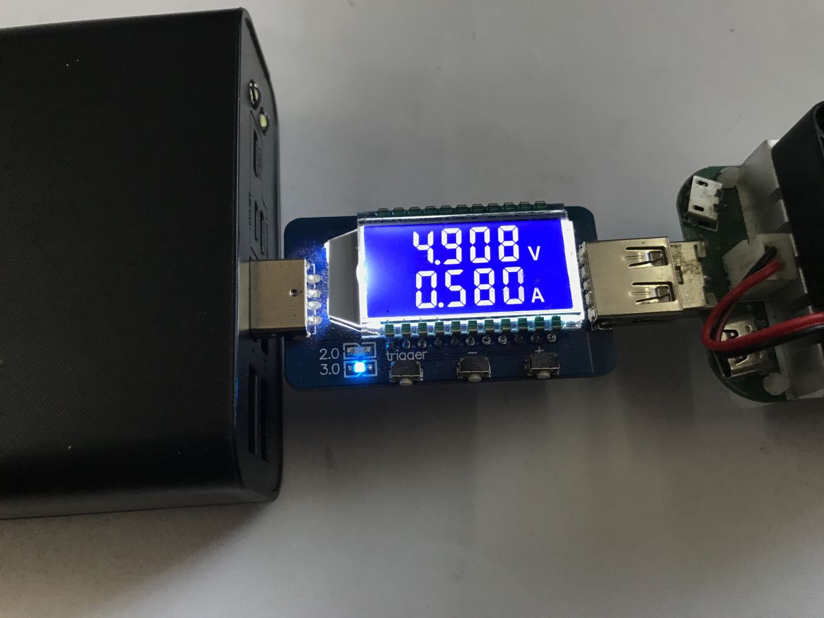

    The case says "fast charging" but not "quick charge" - there will be no QC standard, i.e. supplying higher voltage than 5 V?

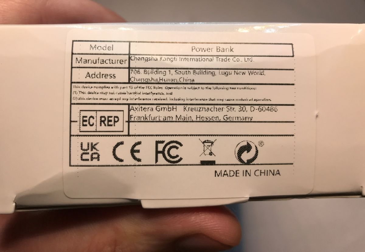

    Power bank package label with manufacturer details and CE, FCC, UKCA marks, plus “MADE IN CHINA”
    Look in vain on the casing for information about the model of the powerbank. According to the sticker, the model is simply "Power Bank". The "Container" on the packaging is already some kind of a nameplate.

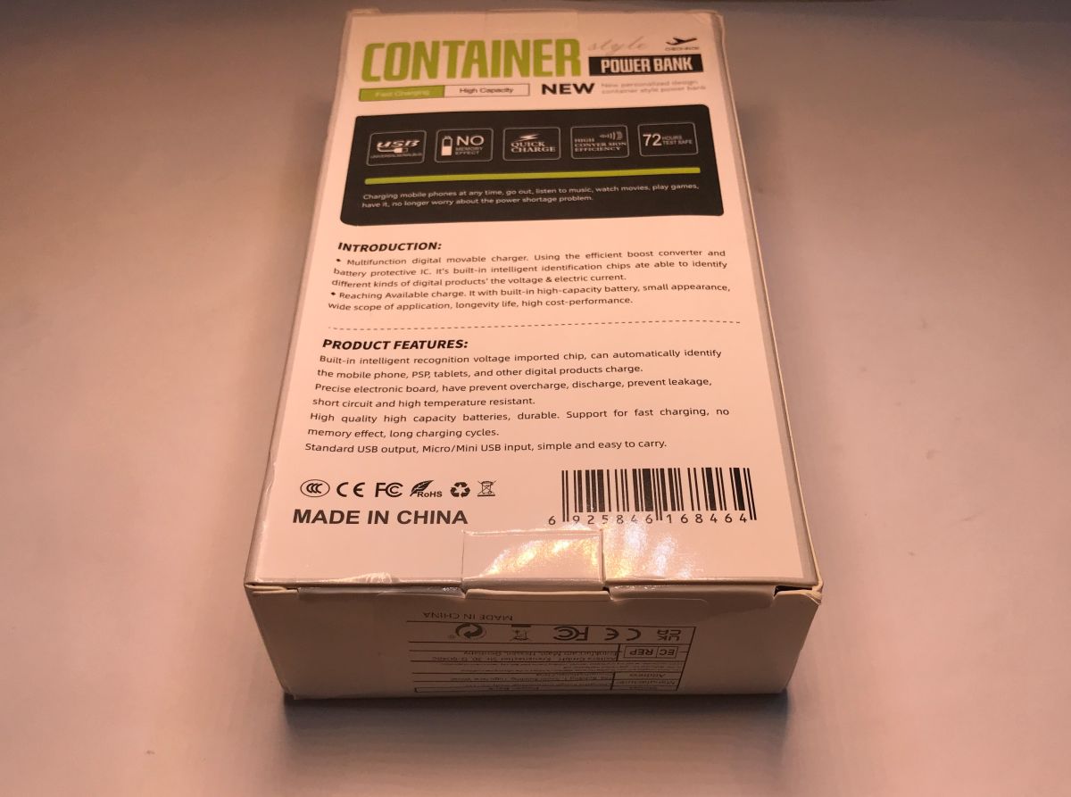

    Box of “CONTAINER Power Bank” showing product text, feature icons, and a barcode
    There is quite a long product description on the packaging, but I don't see any specifics.

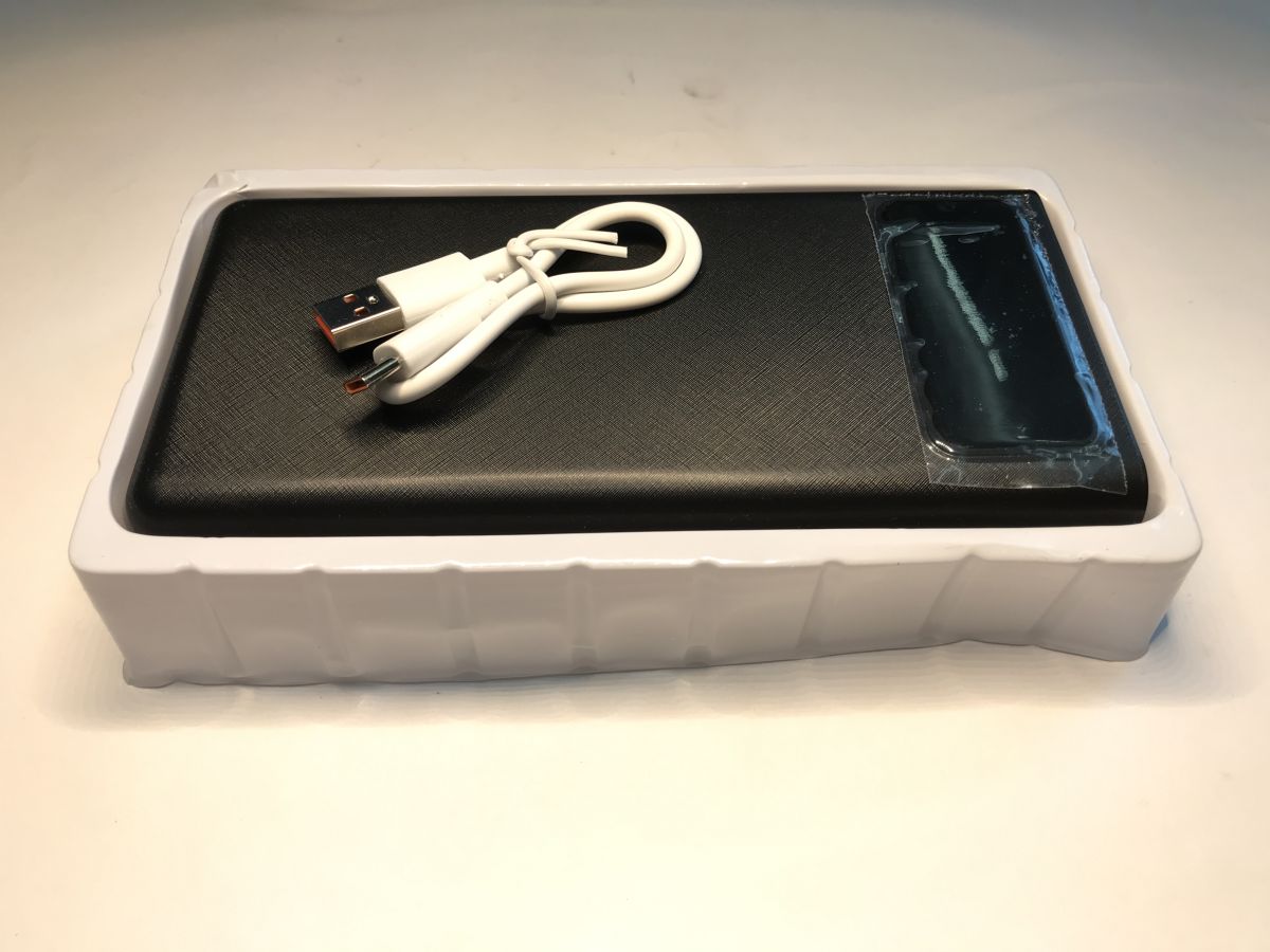

    Black power bank in a white tray with a coiled white USB cable on top
    A USB C cable is included.

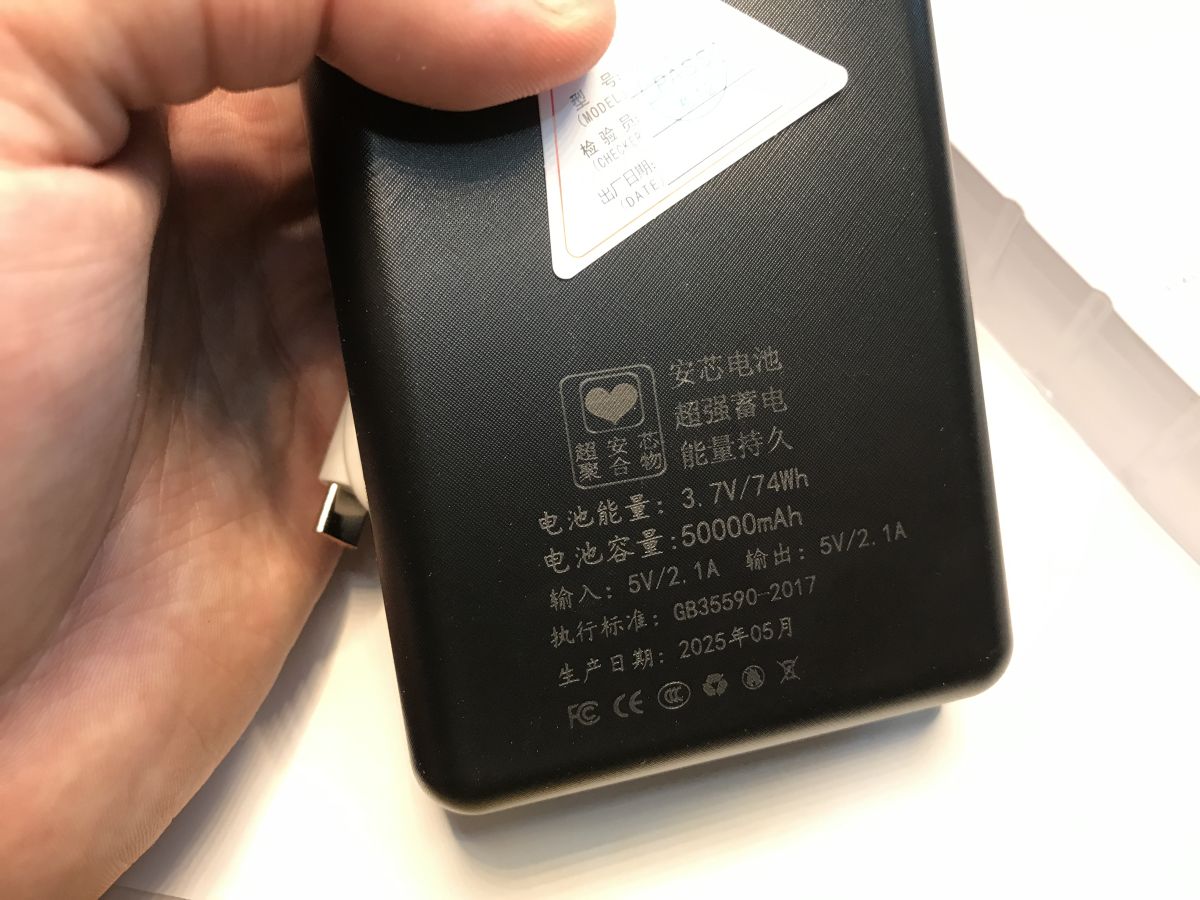

    Close-up of the back of a black power bank with Chinese text: 3.7V/74Wh, 50000mAh, 5V/2.1A
    Finally, on the powerbank itself, there is what looks like a model name - GB35590-2017. These 2017s are worrying. Declared capacity: 50 Ah at 3.7 volts,. That would make a good match. What surprises me is the 74 Wh.
    After all, if you multiply, it comes out rather 185 Wh of energy? Even if they were to take losses into account, it blandly comes out many times less. Could it be that it is not 50 Ah after all, but, say, 20 Ah?
    Let's check further. Production date May 2025. I am also concerned about the voltage and current - only 5 V and 2.1 A? There is not even QC.

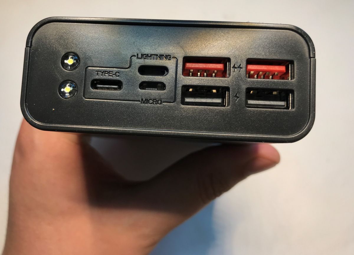

    Ports - supposedly the orange colour indicates a higher current port?
    Close-up of a power bank port panel with USB-A, USB-C, Lightning, micro-USB ports and two LED lights

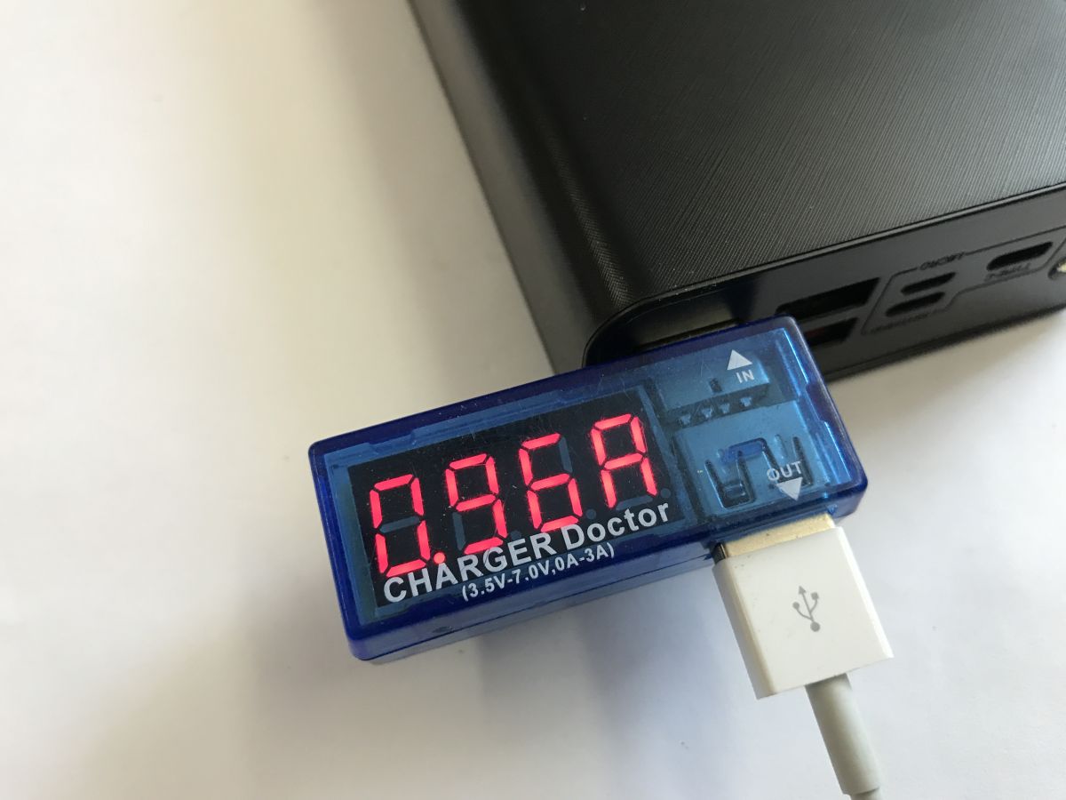

    First load tests.
    The powerbank is able to provide a total current up to about 2.5 A, then the voltage drops. My phones (Xiaomi 11 and iPhone 7) are charged at 5 V, current up to 1 A. The QC Trigger is unable to trigger a higher voltage.
    Power bank connected to an electronic load with cooling fan and LED display on a white surface Phone charging from a power bank via a USB meter; phone shows 62%, meter reads 0.96 A.
    USB “CHARGER Doctor” meter with red display showing 0.96 A Power bank connected to a USB meter showing 4.908 V and 0.580 A on a white surface

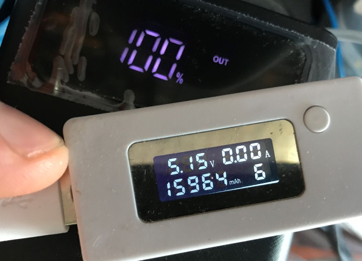

    Next it is time to check the capacity.
    Charging is done with a current of just under 2 A. Charging from 0 to 100% shows on the meter less than 16 Ah drawn (at 5 V).
    Close-up of a USB meter showing 5.15 V, 0.00 A and 15,964 mAh, with a 100% display in the background
    After multiplication, here we have 80 Wh. You can already see that the expected 50 Ah output will be far short of this, as there are losses both when charging the cells and when discharging them. Nevertheless, let us check. Three separate tests:

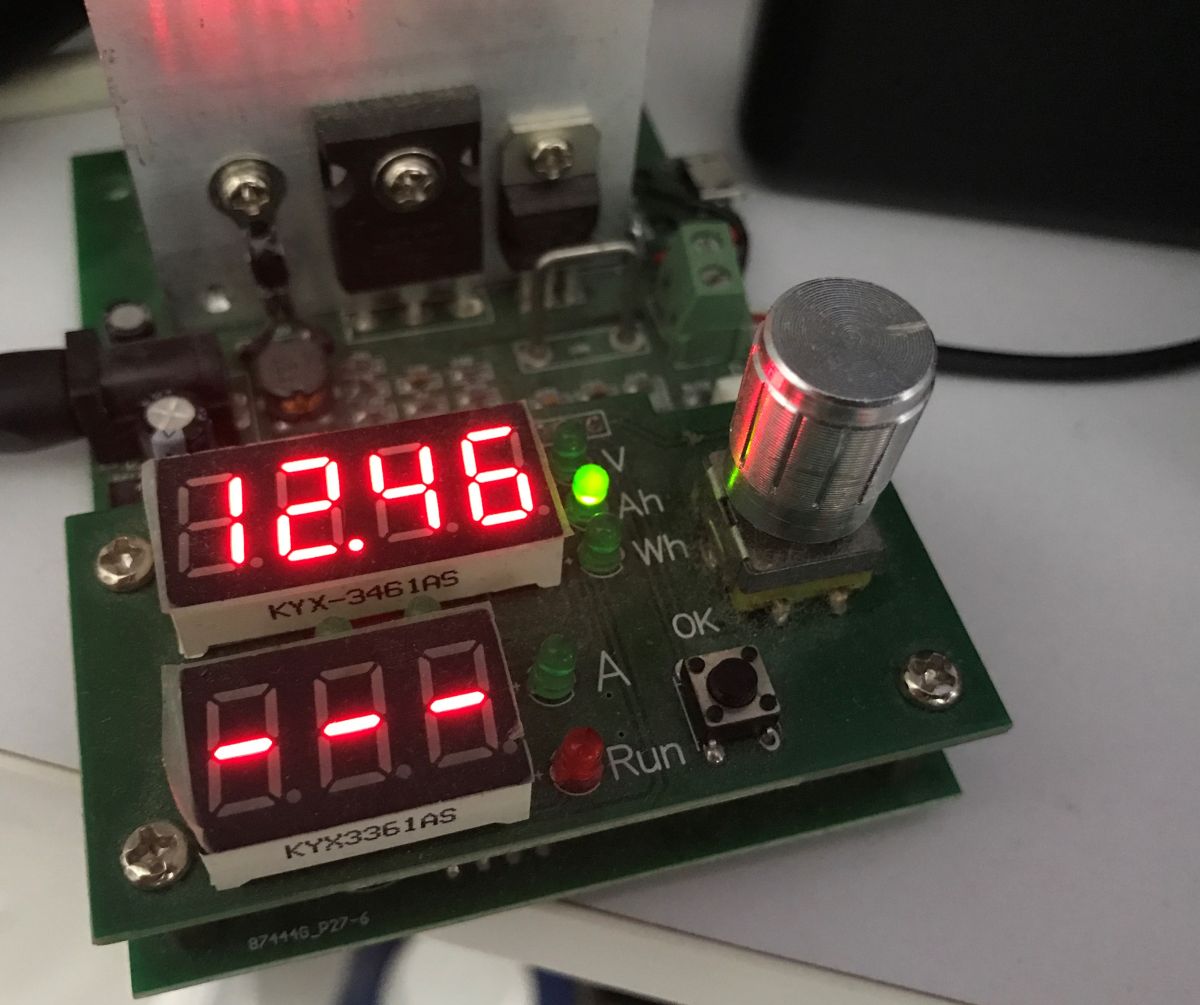

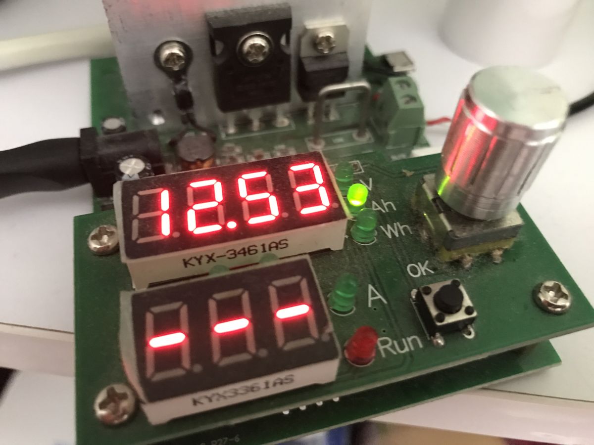

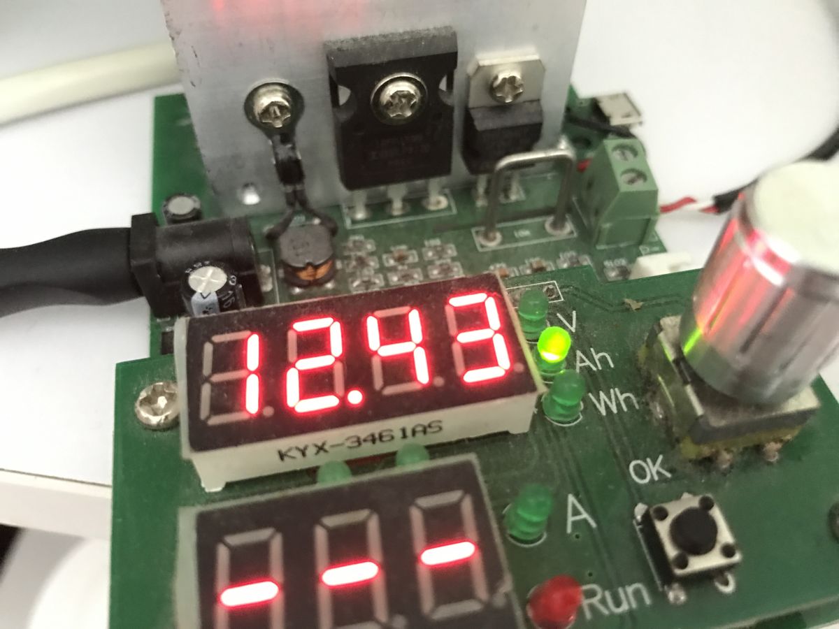

    Measurement module on a PCB with red LED display reading 12.46 and a metal knob Electronic PCB with red LED display reading 12.53 and indicator LEDs labeled Ah and Wh Test PCB with red 12.43 readout and LEDs next to labels V, Ah, and Wh
    At 5 volts, approximately 12.5 Ah can be obtained. This gives us 62 Wh. And the capacity?
    The nominal 50 Ah is at a cell voltage of 3.7 V, so you have to recalculate. You also have to take into account the losses on the inverter; in this series I have taken a fixed conversion factor of 0.85. Output: 12.5 Ah at 5 V, nominally 20 Ah. Unfortunately ...

    The second problem is capacity. The first thing that surprises me is the declaration of 74 Wh of energy while claiming 50 Ah of capacity. How did they come up with that? As the cells inside are nominally 3.7 V, after all, from 50 Ah it will come out around 185 Wh rather than 74 Wh. To get 74 Wh at nominal 3.7 V, the capacity would have to be ~20 Ah, not 50 Ah.
    You could even conclude that this is a 20 Ah powerbank that a creative marketing person changed 20 to 50 to make it look better, while forgetting about those watt-hours because he probably didn't even know what they were...
    Or a typo crept in.

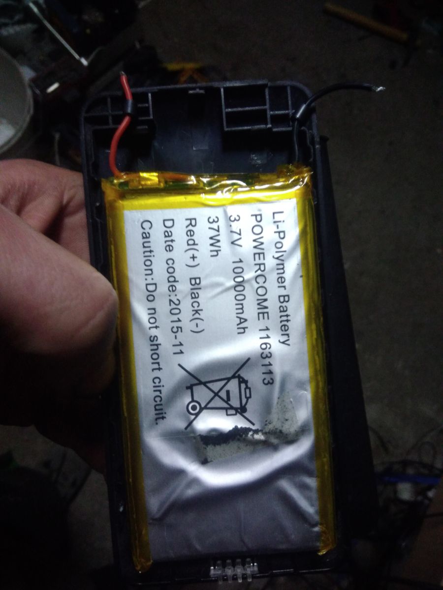

    No longer just Chinese. I use 6V zinc cells for roadside warning lights and I bought one with a capacity of 7Ah (perfectly OK) and the importer also sold one with a capacity of 50 Ah. To my tentative remark that this is physically impossible (unless they are selling camouflaged nuclear fuel cells) the salesman said (sic!) that this is new technology and, after further prodding on my part, announced that he had rewritten the Chinese label. HANDS DOWN....
  • Flat-cell pack likely explains the claimed capacity

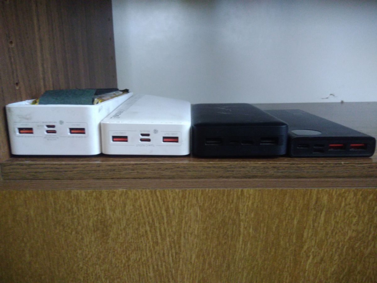

    E8600 wrote:
    I could be wrong but I infer from the casing that it is on 18650 cells the question is how many 16? Then with 3.5 Ah cells it is possible that it would show close to 50 Ah. A bit strange with this fast landing because similar enclosures handle up to 12 volts.
    No . There are usually 9960115 flat cells inside and the difference in capacity often depends on the number of cells used and multiples of 10000mAh capacity.
    https://a.allegroimg.com/original/114aff/b965...ulator-Bateria-Tablet-PowerBank-10000mAh-3-7V
    From left Baseus 30Ah , 20Ah , redmi 20Ah and baseus 10Ah
    Four power banks side by side on a wooden shelf, front view showing USB ports

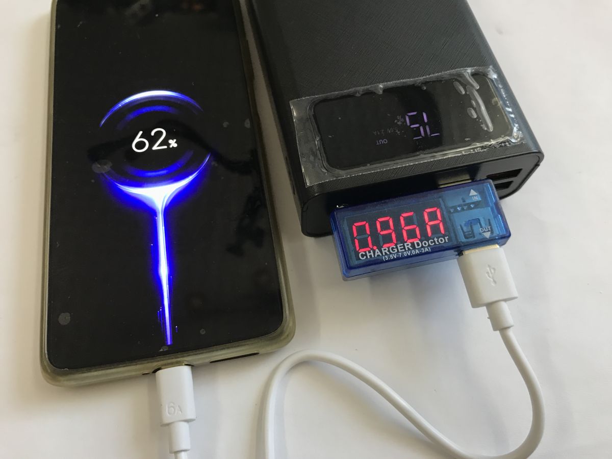

    What is the role of the USB Type C port?
    In addition to charging the powerbank itself, can an example of a smartphone be charged via this port?
