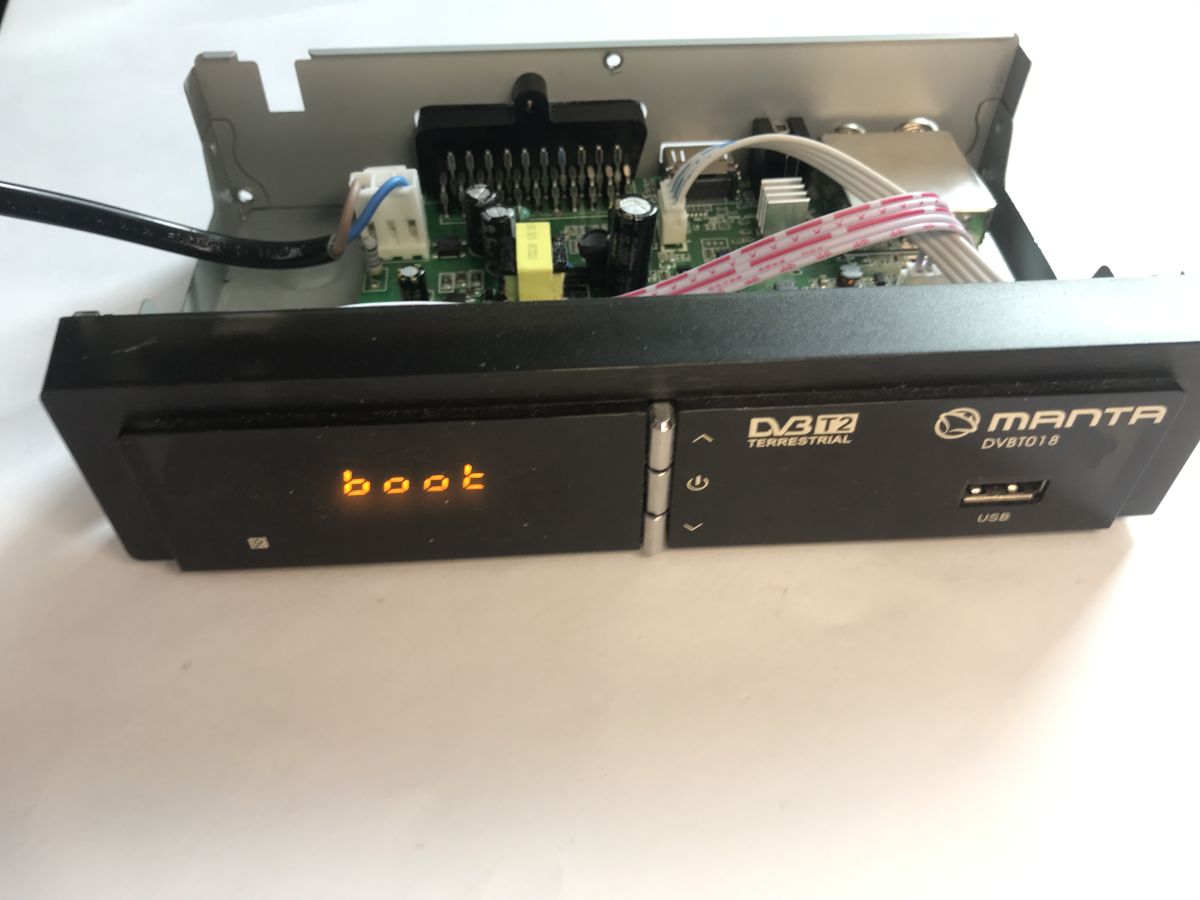

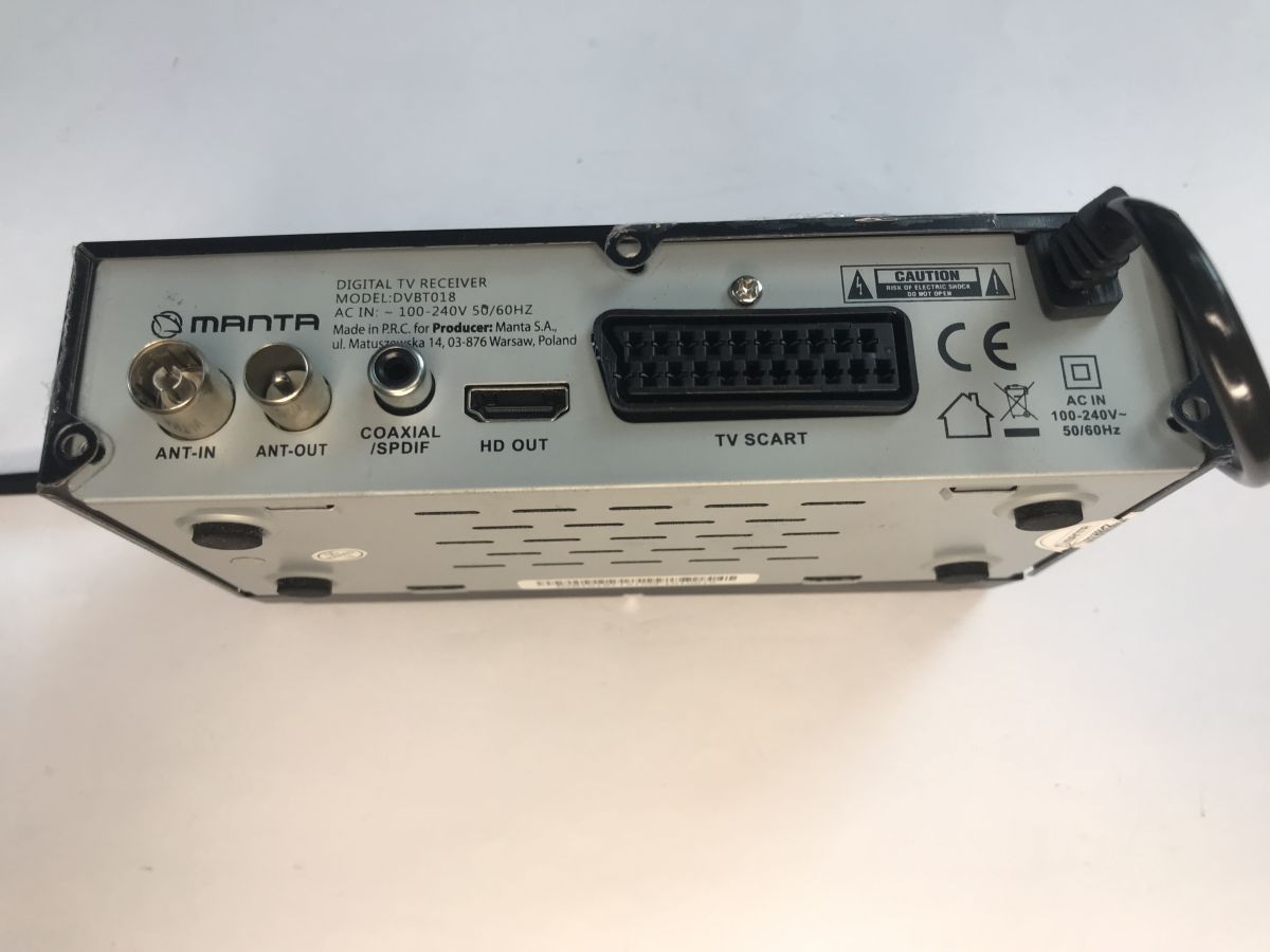

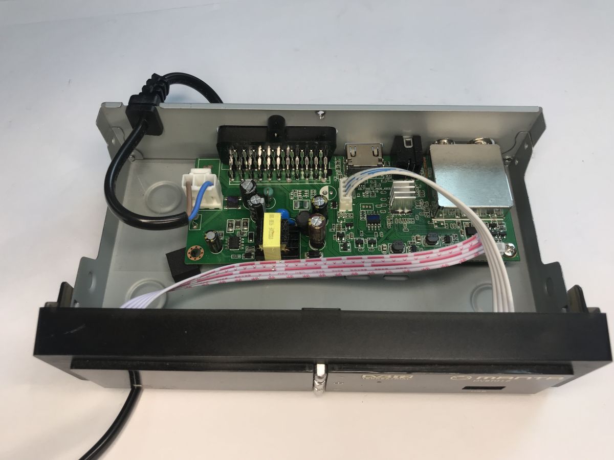

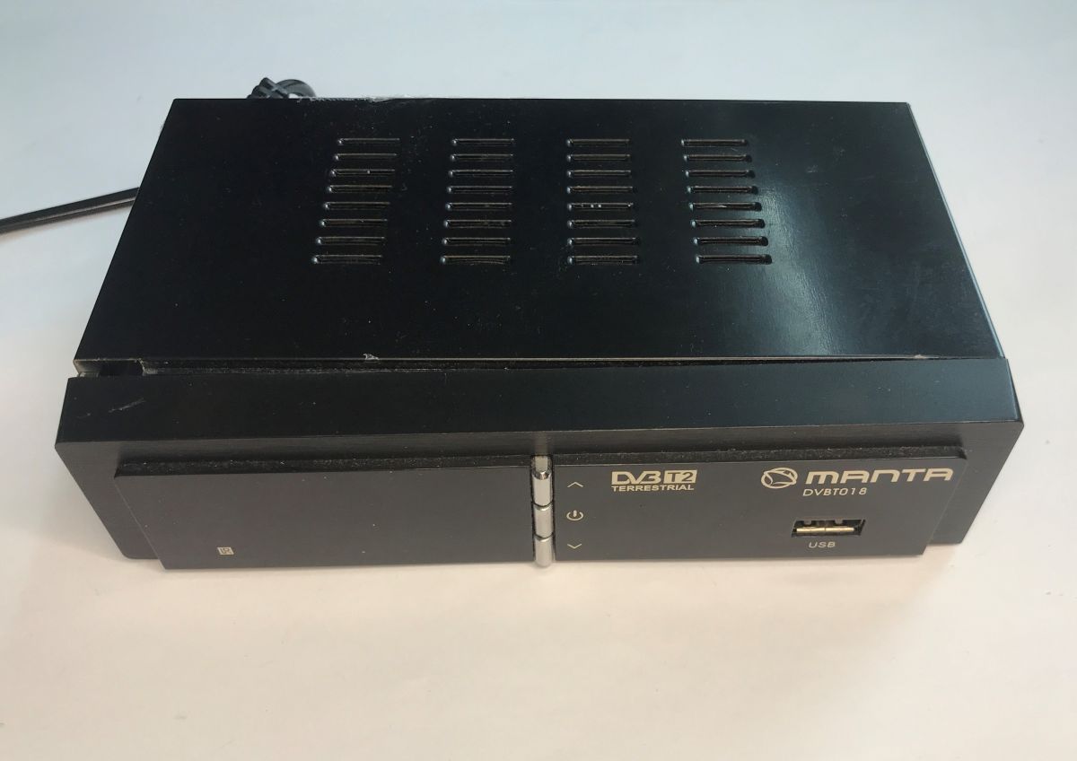

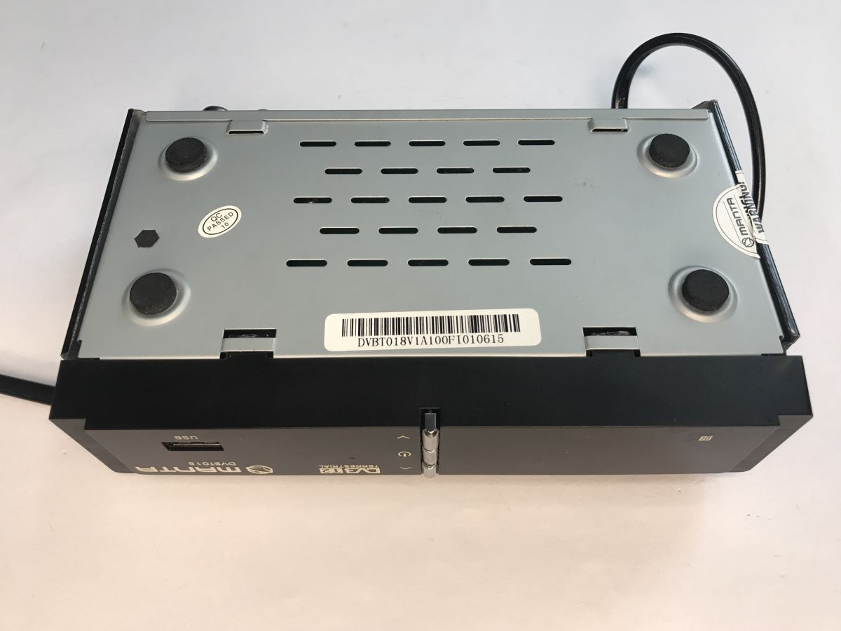

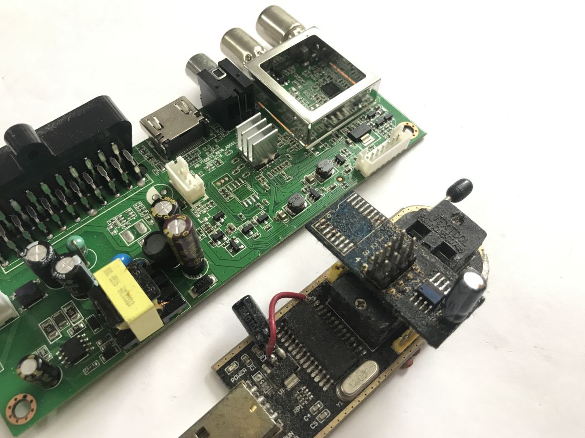

    This time, I’m presenting the budget DVB-T/DVB-T2 tuner, the Manta DVBT018, which came to me for repair showing no signs of life. The repair turned into a bit of fun with emulation – I even managed to emulate the operating system’s console (command line)! But let’s start from the beginning. Although very cheap – costing just a few dozen zlotys – the device is fully compatible with second-generation digital terrestrial television (DVB-T2 in HEVC format) and allows you to set up your own channel list. You’d think that at such a low price it wouldn’t be worth repairing, but perhaps it is? Let’s find out!
    Internal components, repairs and firmware emulation – Manta DVBT018 DVB-T2 tuner Internal components, repairs and firmware emulation – Manta DVBT018 DVB-T2 tuner

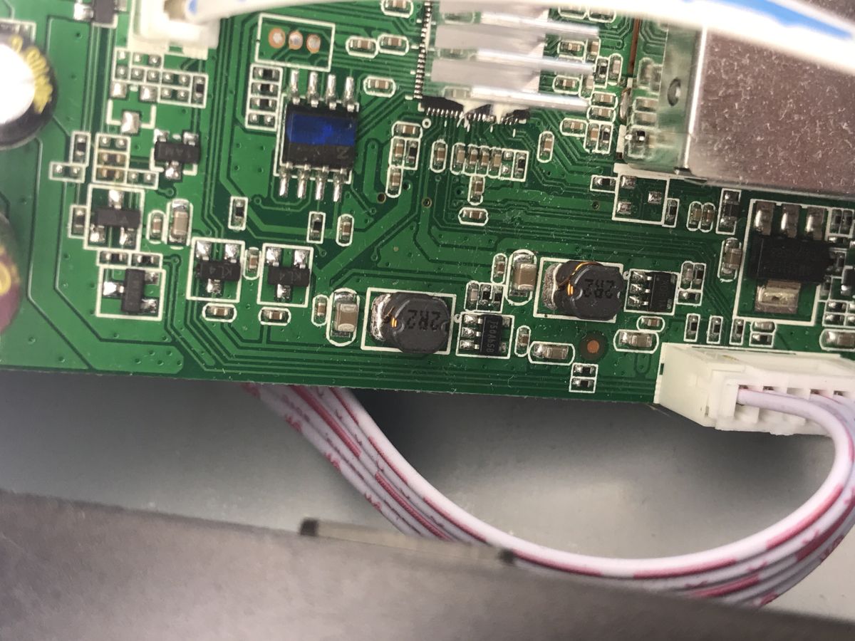

    Interior overview

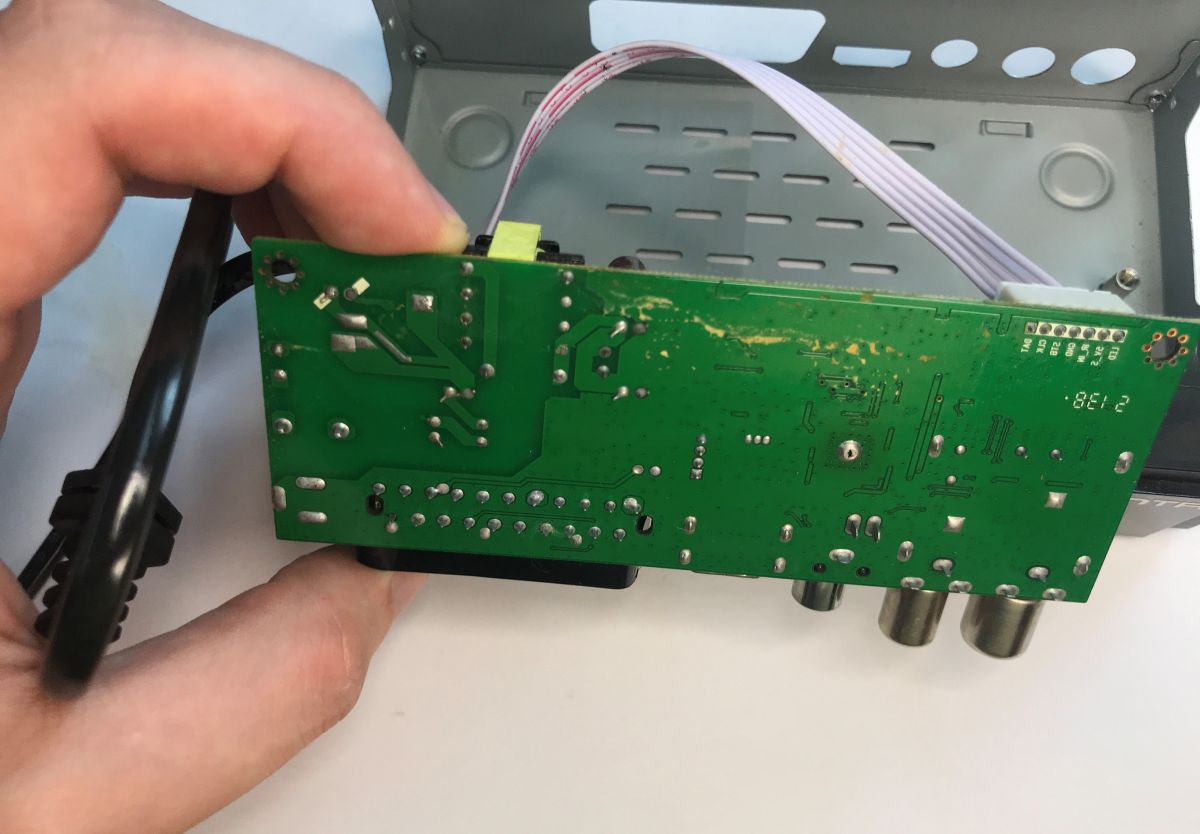

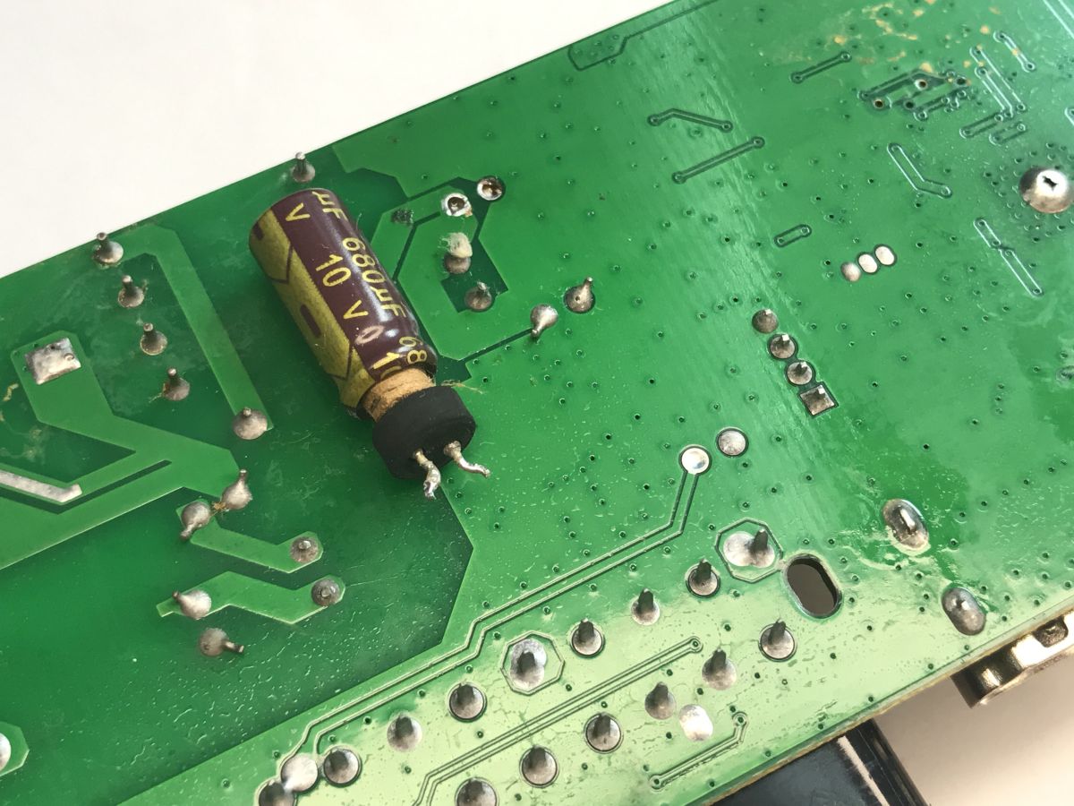

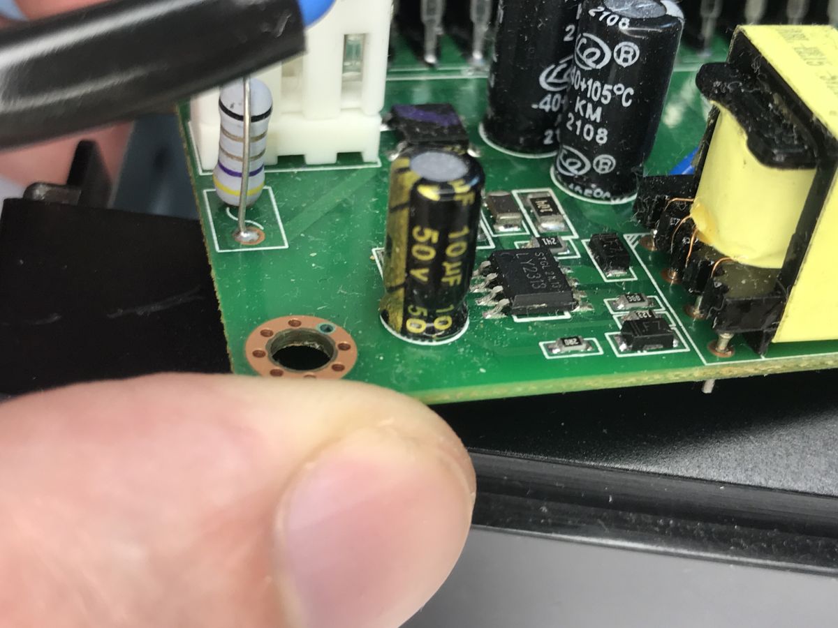

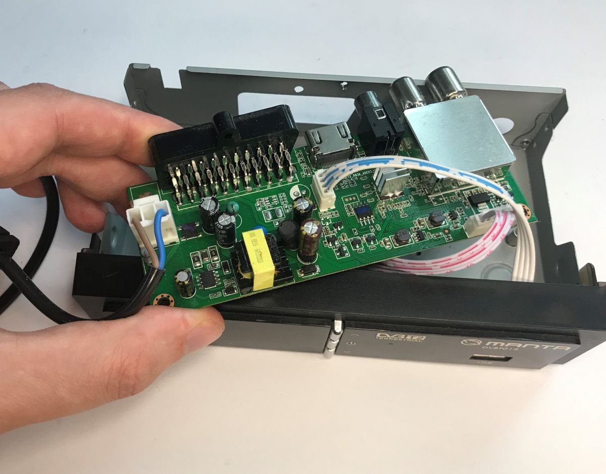

    We break the seal and take a look inside. The culprit becomes apparent almost immediately – it’s that suspiciously tall capacitor. First, however, we’ll remove the circuit board – there are no components on the underside, but we need to get to the solder joints.
    On the circuit board, I’d highlight three sections – a flyback-topology switching power supply, the main microcontroller with Flash memory, and the RF tuner:

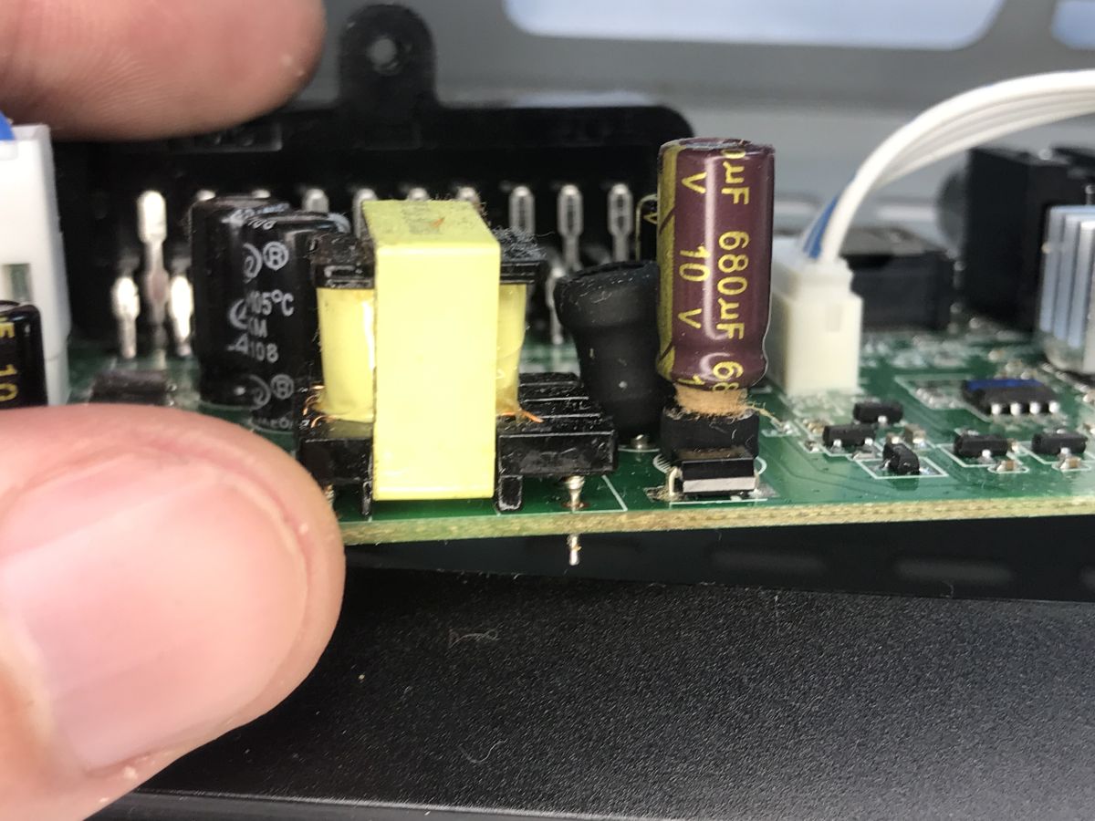

    And there’s the culprit:
    Incidentally, these days, at such low power levels, converters don’t even use optocouplers. This is known as PSR – Primary Side Regulation. This little LY2318 chip even contains a switching transistor.
    It doesn’t power the MCU directly; it generates 5 V, and then there are further step-down converters, probably down to 3.3 V or lower.

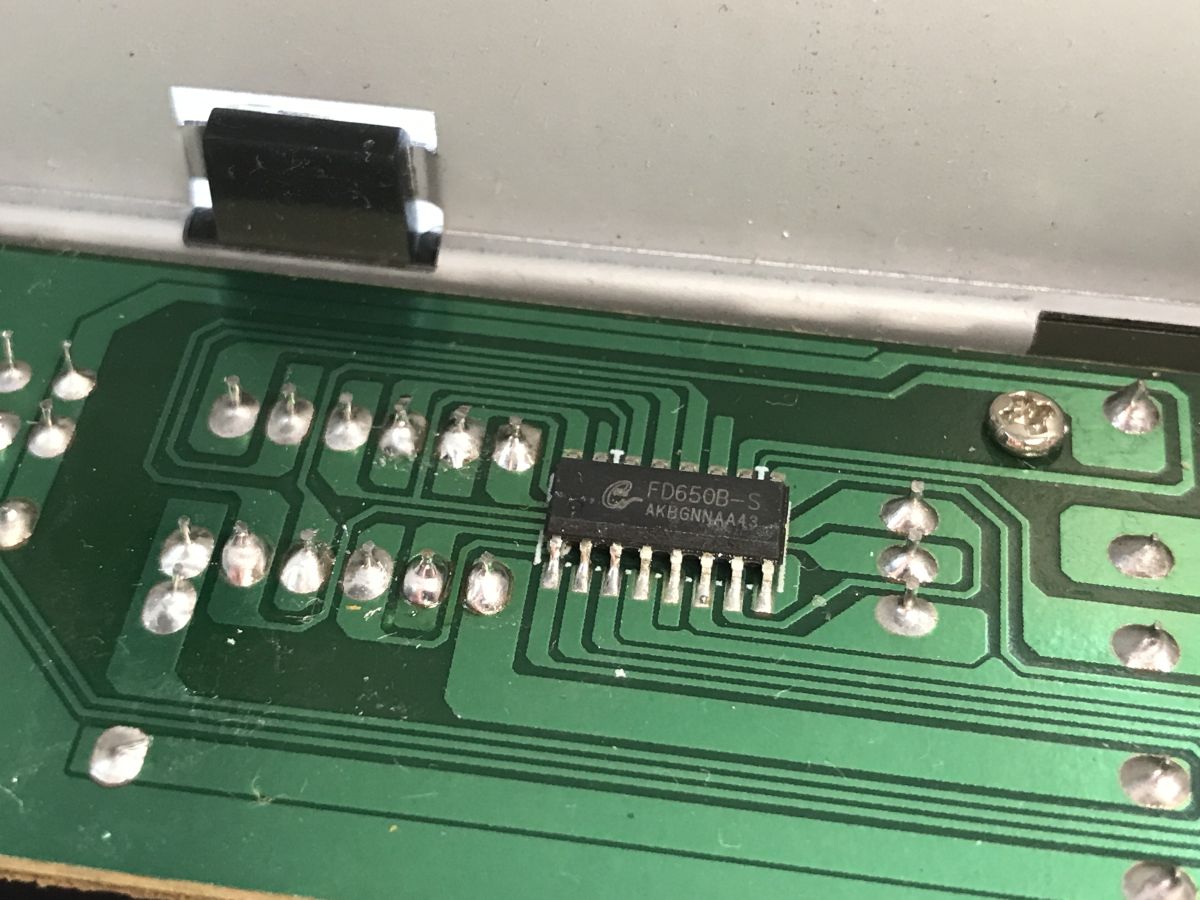

    The display is controlled by the FD650, which I have discussed previously .

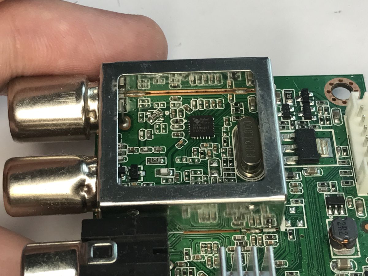

    The RF stage is based on the Rafael Micro R836.
    There is some information about it online:
    https://github.com/siddolo/R836-reverse-engineering
    Repair
    Now for the repair itself – you simply need to desolder the capacitor; I use flux to help with this. Next, you’ll need a replacement – it can’t be just any capacitor, it must be a Low ESR type. One suitable for the converter’s output. The capacitance should ideally match the original – not lower – and the voltage rating should also not be lower.
    It’s hardly surprising that the tuner works after this repair.
    Flash dumping

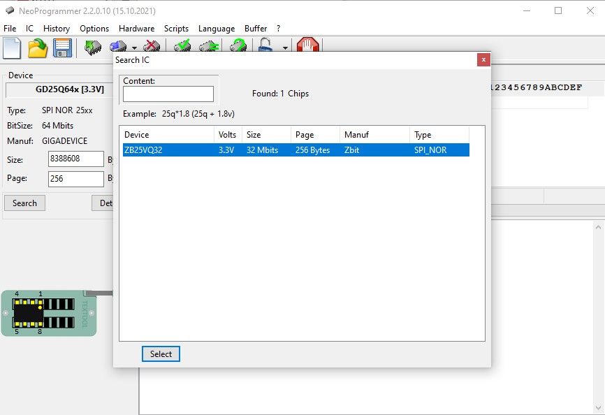

    Now for the most interesting part – the flash memory dump. It has a simple SPI interface. I desolder it using a hot-air gun, then solder it onto a CH341 socket and use that to dump it onto the computer.
    On the PC side, I use NeoProgrammer.
    Copy of the batch file:
    https://github.com/openshwprojects/FlashDumps/commit/7c15d12800ae4b96f645c9da617f6da586fd9ab9

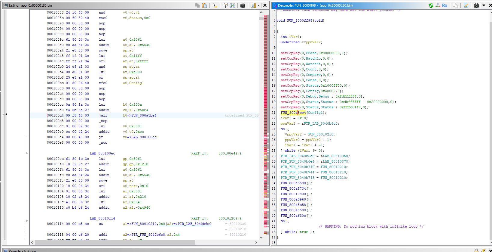

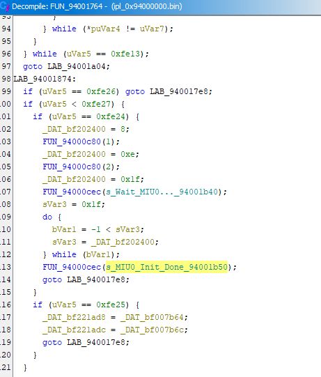

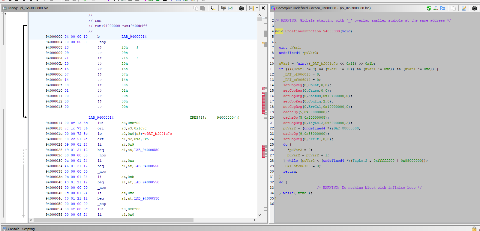

    I identified the processor by disassembling the start of the payload (the first 0x20 bytes are the header; the code continues). It’s a little-endian MIPS32 – cache initialisation and writes to the MStar peripheral space (RIU) at 0xBF200000:
    0x94000054: lui   $t0, 0xbf00
    0x94000068: lui   $t0, 0xbf20
    0x94000070: sw    $t1, 0x6700($t0)
    0x940000B0: cache 5, ($s0)
    0x94000110: lui   $ra, 0x9400      ; skok do 0x94000600

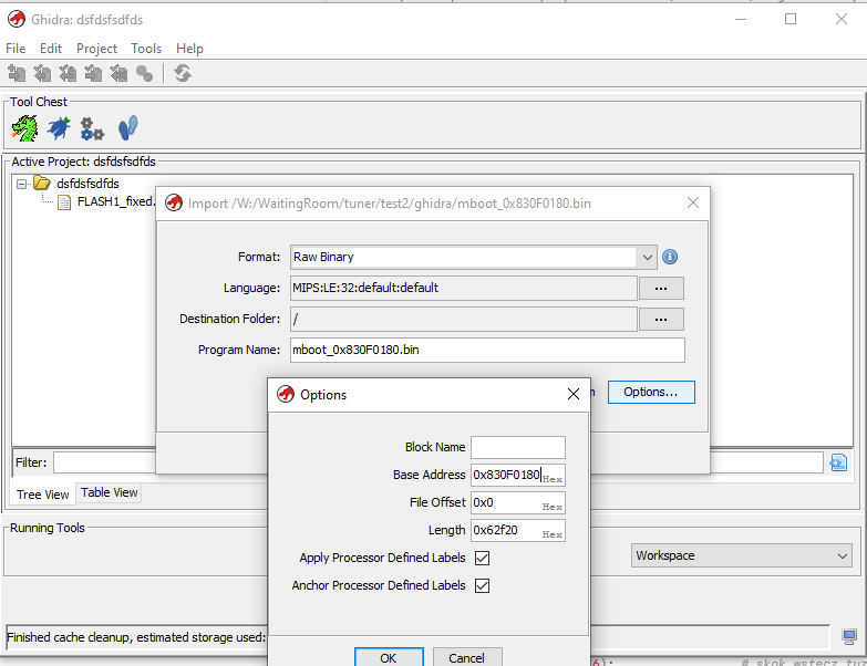

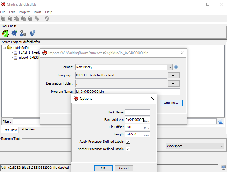

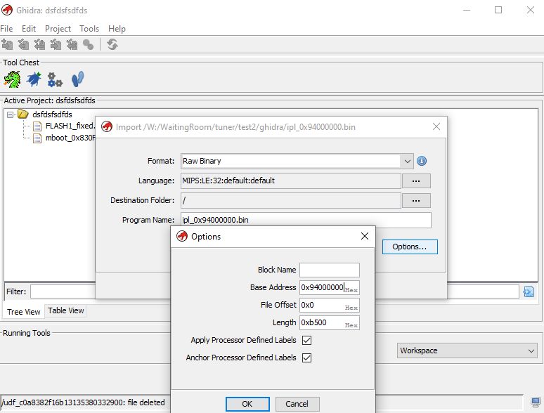

    For anyone who wants to tinker with Ghidra, I’m uploading some ready-made images – they need to be loaded as Raw Binary, MIPS:LE:32:default, with the following base addresses:
    ipl_0x94000000.bin 46336 B base 0x94000000 start code

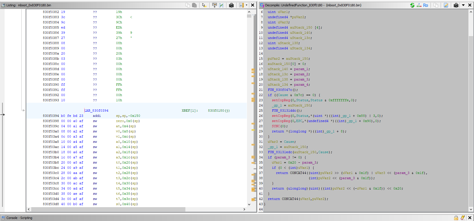

    mboot_0x830F0180.bin 405280 B base 0x830F0180 MBoot / U-Boot:
    app_0x80000180.bin 6,328,740 B base 0x80000180 eCos, entry 0x80000224

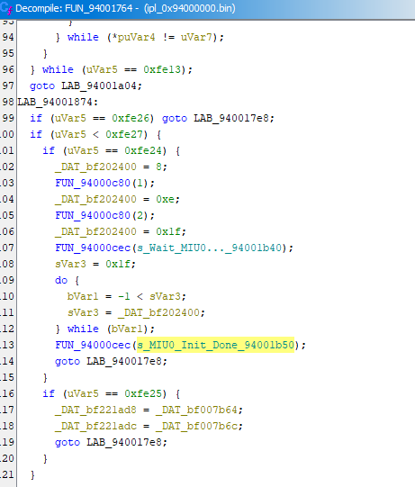

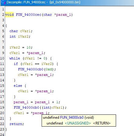

    First, you need to find the UART – this isn’t difficult. The constant ‘strings’ are immediately visible after decompilation. Presumably, 94000cec is the print function or something similar:

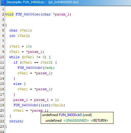

    It iterates through the string and calls
    putchar
    for each character. You can also see that Before the 0x0A (LF) character, it sends 0x0D (CR) – classic line-wrapping for a terminal:

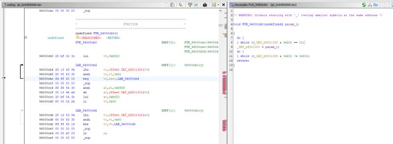

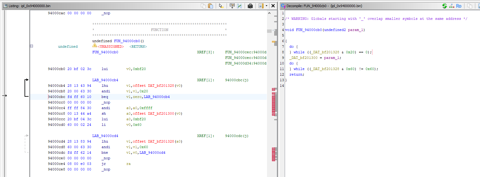

    The putchar function itself is a textbook example – two wait loops and a single write operation between them:
    The first loop waits until bit 0x20 is set in register 0xBF201328. Then the character is sent to 0xBF201300. The second loop waits for 0x60, i.e. two bits at once – and that’s a clue as to what sort of chip this is.
    This is how the 16550 behaves: bit 0x20 is THRE (‘there is space in the transmit buffer’), bit 0x40 is TEMT (‘transmitter completely empty’), and 0x60 is both together. So the first loop waits for space in the buffer, whilst the second waits until the character physically appears on the line. A blocking, fully flushing putchar – which is why the log is never lost, even when the processor resets the peripherals immediately afterwards. The offsets also match: THR is register 0, LSR is register 5; the registers are spaced 8 bytes apart, hence 0x1300 + 5*8 = 0x1328. Bit 0x01 indicates ‘data available for reading’ – this will be useful later for entering commands.

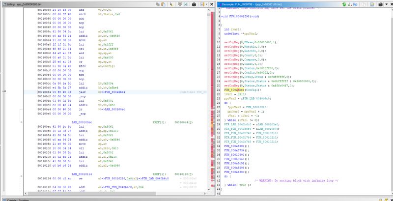

    There’s one catch with memory mapping – Unicorn for MIPS translates KSEG itself, so it maps to physical addresses : 0x94000000 to 0x14000000, and 0xBF200000 to 0x1F200000.
    The minimal version that reaches the U-Boot banner is just under 30 lines:
    Code: Python
    Three things that took me the most time, along with some interesting solutions:
    1. An unknown register cannot return a constant. The firmware is full of “wait until the bit sets” loops. If a register keeps returning the same value over and over, the emulation freezes. Alternating between 0xFFFFFFFF and 0 satisfies both “wait for 1” and “wait for 0”.
    2. The memory BIST must pass. Register 0x1F2025C0: bit 15 indicates ‘completed’, bits 0x6000 indicate errors. Without this, the IPL outputs BIST0_FAIL and gets stuck in a loop
    3. Unicorn does not have a CP0 Count register. The read operation “mfc0 rt, $9” results in an exception. It crashes for the first time in the delay routine at 0x94000C80, so the simplest solution is to replace it with an immediate return – and that sorts it out in the code above. If you needed to swap instructions on the fly, there’s a pitfall: mem_write alone isn’t enough , because Unicorn keeps the translated blocks in the cache and continues to execute the old code. A call to
    ctl_flush_tb()
    is necessary; otherwise, the replacement silently does nothing.
    The full version also adds support for reads from SPI Flash (otherwise U-Boot won’t find the application image), incrementing the timer variable (without interrupts,
    get_timer()
    never runs and
    udelay()
    loops indefinitely) and the console – more on that in a moment.

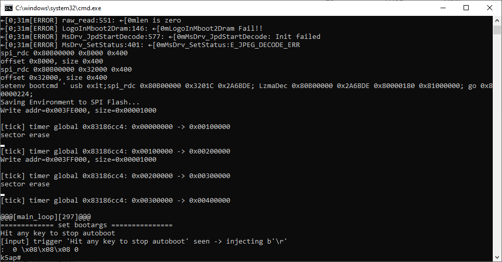

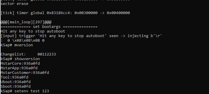

    Presentation – boot log
    We run:
    Code: Bash
    And we get the log – it’s a shame there wasn’t time to capture it from the original, but I was repairing some hardware for someone.
    B
    BOOTSPI
    BIST0_OK
    _OK!decomp
    _done
    done
    [AT][MB][start ub][0]
    U-Boot 2011.06 (Sep 23 2021 - 14:07:21)  MBOT-1106.0.10.936a0fd.201806111716
    DRAM:
    Hello U-Boot
    Stack Pointer at: 83627740
    mem initial, start 0x82CEE180, len 0x402000
    SPI:  uboot held at [8F000000~90000000]
    Now running in RAM - U-Boot at: 830F0180
    In:    serial
    Out:   serial
    Err:   serial
    [ERROR] do_spi_init_partition:1221: This function doesn't support
    ============= set bootargs ===============
    Unknown command 'panel_pre_init' - try 'help'
    [ERROR] raw_read:551: len is zero
    [ERROR] LogoInMboot2Dram:146: LogoInMboot2Dram Fail!!
    [ERROR] MsDrv_JpdStartDecode:577: MsDrv_JpdStartDecode: Init failed
    [ERROR] MsDrv_SetStatus:401: MsDrv_SetStatus:E_JPEG_DECODE_ERR
    spi_rdc 0x80B00000 0xB000 0x400
    offset 0xB000, size 0x400
    spi_rdc 0x80B00000 0x32000 0x400
    offset 0x32000, size 0x400
    setenv bootcmd ' usb exit;spi_rdc 0x80B00000 0x3201C 0x2A6BDE; LzmaDec 0x80B00000 0x2A6BDE 0x80000180 0x81000000; go 0x80000224;
    Saving Environment to SPI Flash...
    Write addr=0x003FE000, size=0x00001000
    sector erase
    Write addr=0x003FF000, size=0x00001000
    sector erase
    @@@[main_loop][297]@@@
    Hit any key to stop autoboot:  0
    enable dont overwrite function
    AC on
    sector erase
    sector erase
    Check USB port[0]:
    [USB] usb_lowlevel_init++
    [USB] USB EHCI LIB VER: 2017.08.11-k5ap
    [USB] Port 0 is Enabled
    [USB] TV_usb_init (UTMI Init) ++
    [USB] UTMI Base BF207500
    [USB] UHC Base BF204800
    [USB] USBC Base BF200E00
    [USB] BC Base BF226E00
    [USB] init squelch level 0x2
    [USB] TV_usb_init--
    [USB] Usb_host_Init++
    [USB] No USB is connecting
    [USB] USB init failed
    [USB] usb_lowlevel_init--
    Error, couldn't init Lowlevel part
    FAIL : can not init usb!!
    sector erase
    sector erase
    USB is stopped. Please issue 'usb start' first.
    offset 0x3201C, size 0x2A6BDE
    LZMA Decompression...CRC check success !!
    ok
    disable interrupts
    ## Starting application at 0x80000224 ...
    B1999 drvEMAC_GetMacAddr
    cyg_if_attach.225 - After initialize list 0x804ac364
    IFP: 0x804ac354 (eth0)
    cyg_if_attach.290 - After inserting 0x8079fa30 into list 0x804ac364
    IFA: 0x8079fa30 - <<0x8079faac>>
    cyg_if_attach.225 - After initialize list 0x808553c8
    IFP: 0x808553b8 (lo0)
    cyg_if_attach.290 - After inserting 0x8079f930 into list 0x808553c8
    IFA: 0x8079f930 - <<0x8079f9ac>>

    Now running in RAM – U-Boot at: 830F0180 - this is the same address I previously calculated from the pointers in the command table. Two independent sources agree, so the Ghidra entry is reliable.

    The emulation stops around the time the eCos drivers are initialised. There is a specific reason for this: the application appears to have been compiled for MIPS32 with support for 16-bit instructions (MIPS16e), and Unicorn struggles to handle this mode and switch the ISA. This is evident from the 2-byte-long instructions and the return addresses with bit 0 set (e.g. $ra = 0x8016E9B7, which in MIPS indicates 16-bit instruction mode). None of the available cores in the library I used would work with this...
    U-Boot console
    Since the emulator has a UART, it works both ways. Bit 0x01 in the LSR indicates ‘data is ready to be read’, so all you need to do is substitute the keystrokes there – and you have an interactive bootloader console.
    One pitfall: the space bar does not work , even though the bootloader asks for “any key”. MStar has modified this procedure – the character is read and discarded, and only Enter . I checked this by scanning the keys: the space bar, ESC, Ctrl-C and letters are ignored; only CR (0x0D) is recognised.
    So, let’s run run_console.bat:
    k5ap# printenv
    AP_SW_MODEL=0x0001
    AP_SW_VERSION=0x0001
    CM_DVBT_ADDR=0x003e8000
    CM_DVBT_ORDER=0x003e6000
    CM_DVBT_SIZE=0x00015000
    CUSTOMER_OUI=0x169B
    HW_MODEL=0x0001
    HW_VERSION=0x0001
    MstarUpgrade_complete=0
    UARTOnOff=on
    baudrate=115200
    bl_dfb_framebuffer_addr=0x01828000
    bl_jpd_inter_addr=0x02118800
    The “k5ap#” prompt indicates a fully functional console – line editing works, Backspace deletes, and the up and down arrows scroll through the command history.
    The command help is not registered in this batch, so I extracted the list of commands directly from the cmd_tbl_t array in memory. This yielded 68 commands, including:
    printenv setenv saveenv loadenv    spi_rdc spi_wrc spi2usb
    bootm go bootcheck read_boot_info    fatload fatls fatwrite usb
    mversion showversion checkVersion    ustar austar custar update_mode
    A few I tested these straight away in the emulator:
    setenv
    adds entries to the environment variables; these can then be read using
    printenv
    . I set the variable "test" to "123". The result is shown below – it’s too long for a screenshot:
