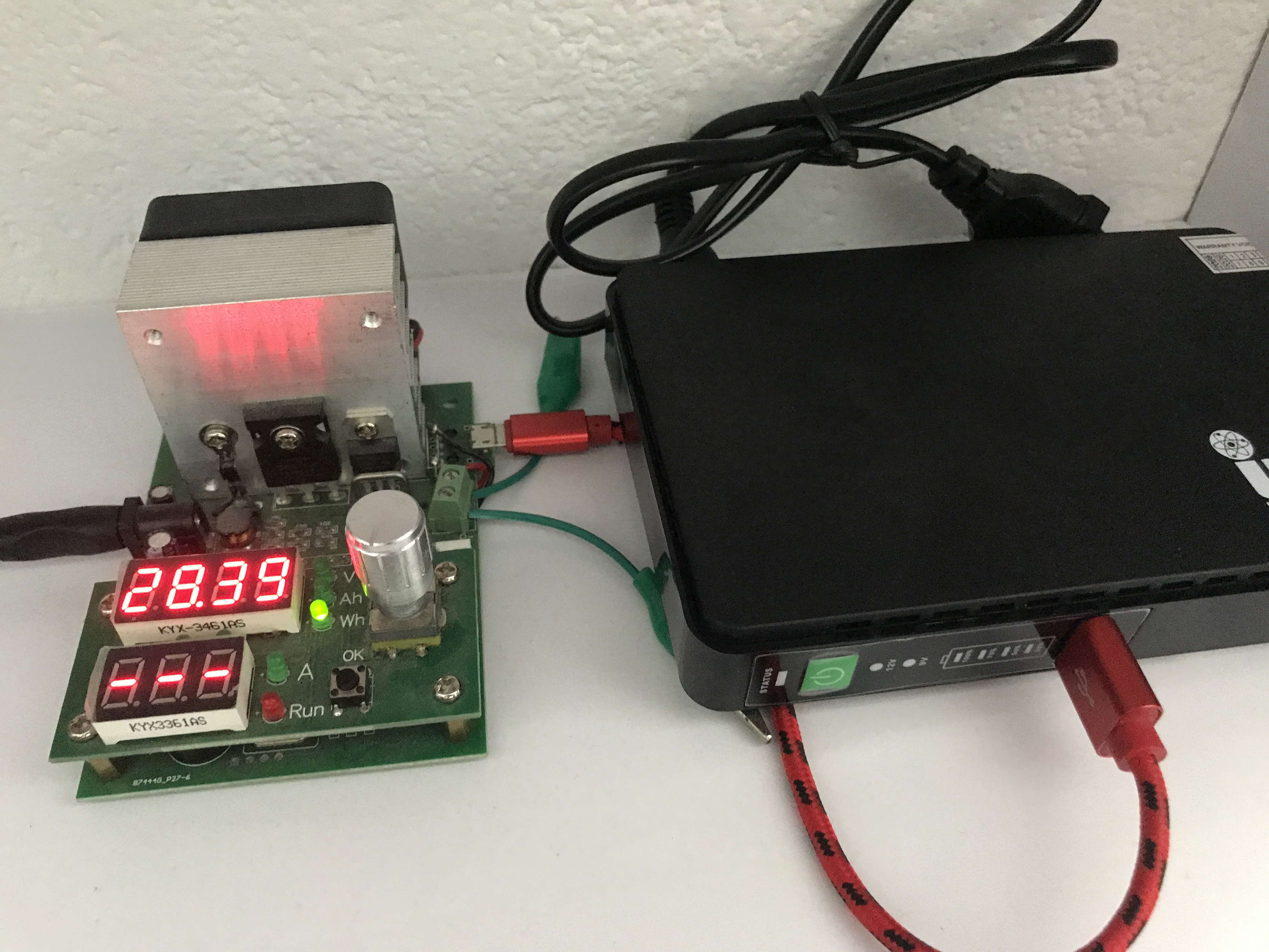

I started with the load tests. Basically it is fine, according to the information on the case, although I only checked the DC and USB output. I used an LD35 artificial load for this. The 30 W version at 12 V managed to draw more than 2 A, and the 15 W version just over less than an amp.
Electronic load with fan and red LED readout “2.50A” connected to a UPS in the background Black RouterUPS-15-POE UPS with a test module and LED display reading 13.92 Black RouterUPS-30-POE UPS with a small fan module and red LED display placed on top
When the permitted current is significantly exceeded, the UPS locks up and flashes the LEDs. It can only be unlocked by pressing the button longer.
