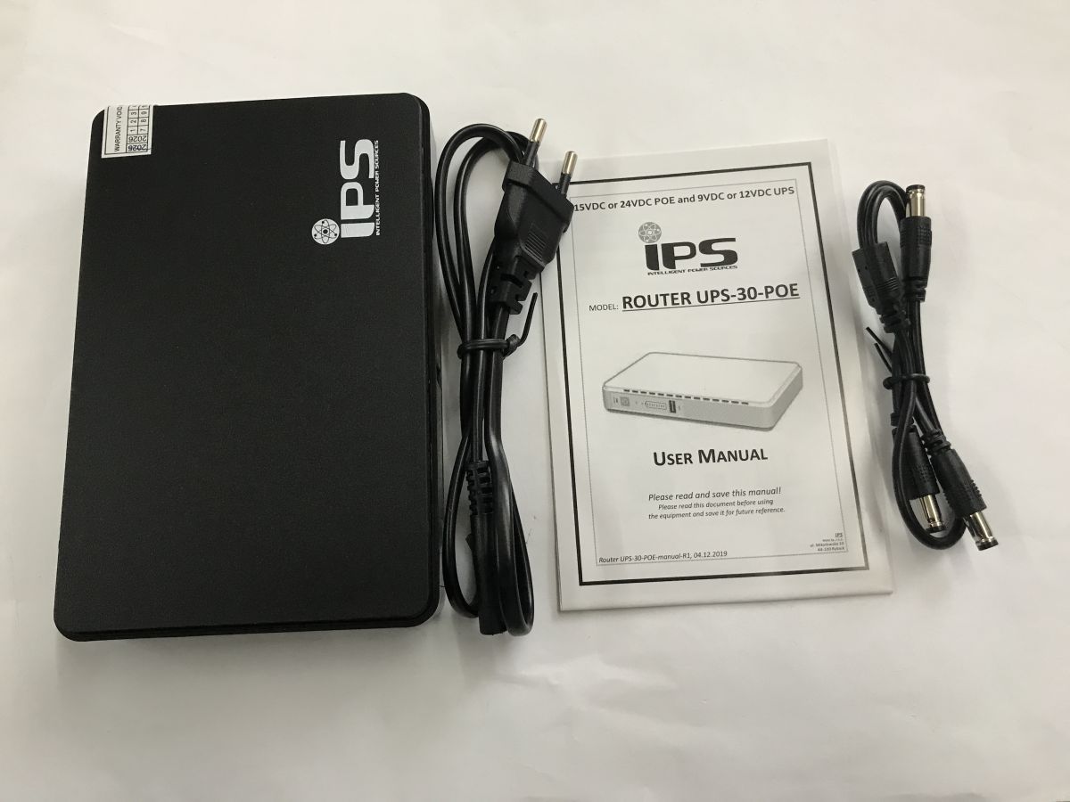

    Let's start with the contents of the kit. It is similar in both cases. Device, power cable, DC Jack cable-splitter (for two devices), manual.

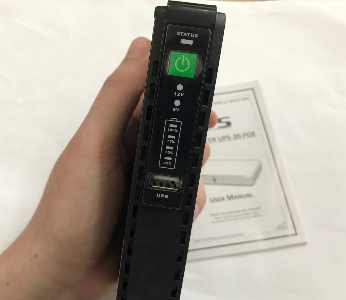

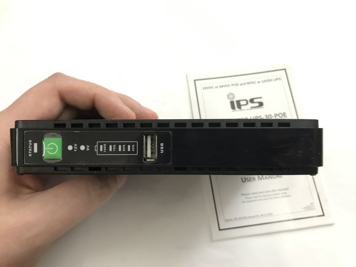

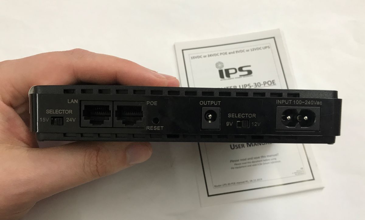

    The UPS has an on/off switch on the front, LEDs showing operating mode and charge status, USB output. On the back there is a 100-240 VAC input and a DC and two PoE outputs.
    Front of a black IPS mini UPS with power button, 9/12 V indicators and a USB port, held in a hand Hand holding a black mini UPS with green power button, 12V/9V LEDs, battery indicator, and USB port Rear panel of a mini UPS with LAN/PoE ports, DC output, 9/12 V and 15/24 V selectors, and AC input
    A clear photo of the instructions. It states the capacity: 4*2600 mAh, for a total of 10,400 mAh. This is repeated for both devices.

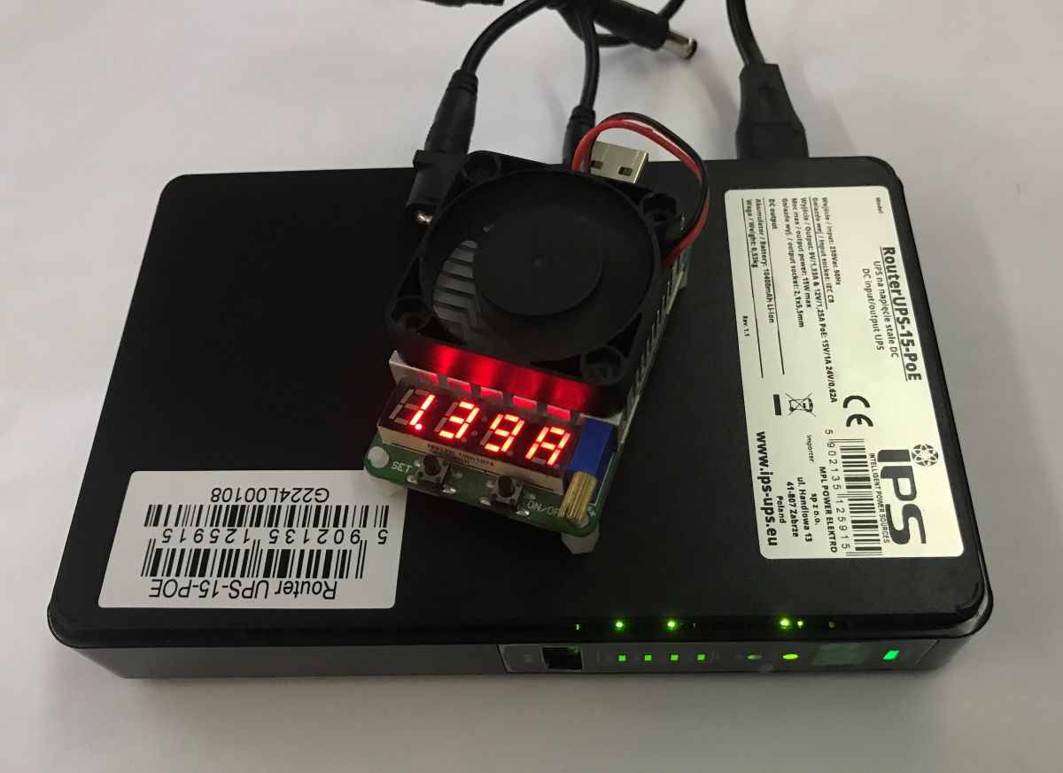

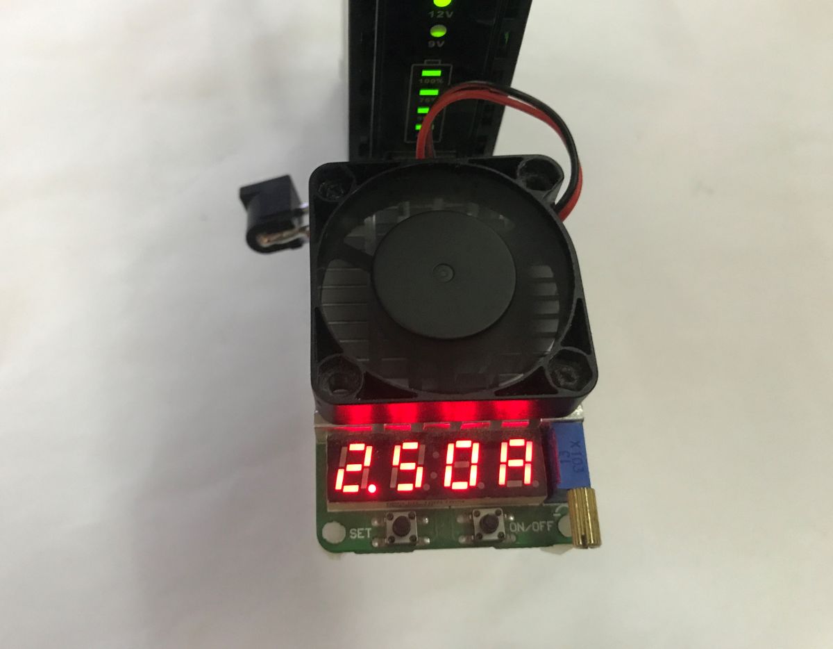

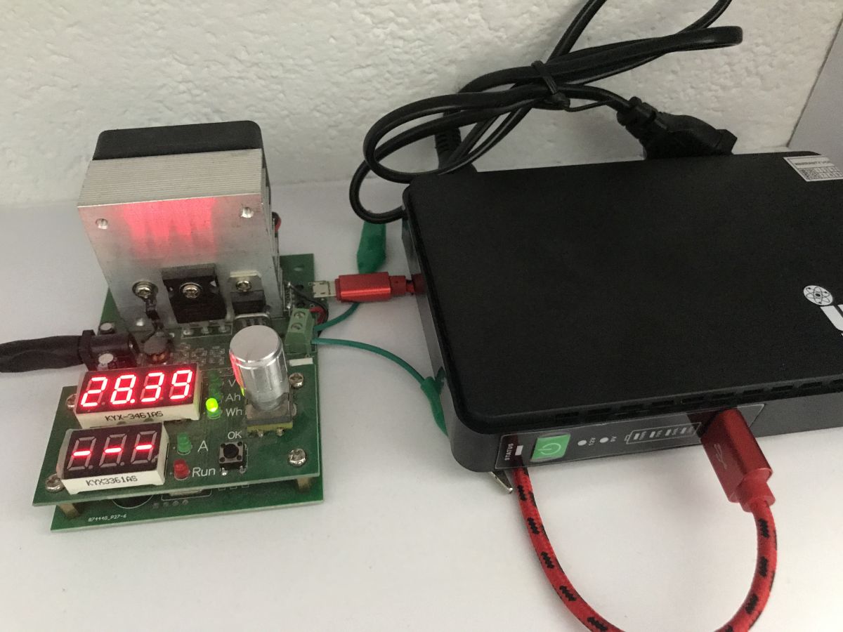

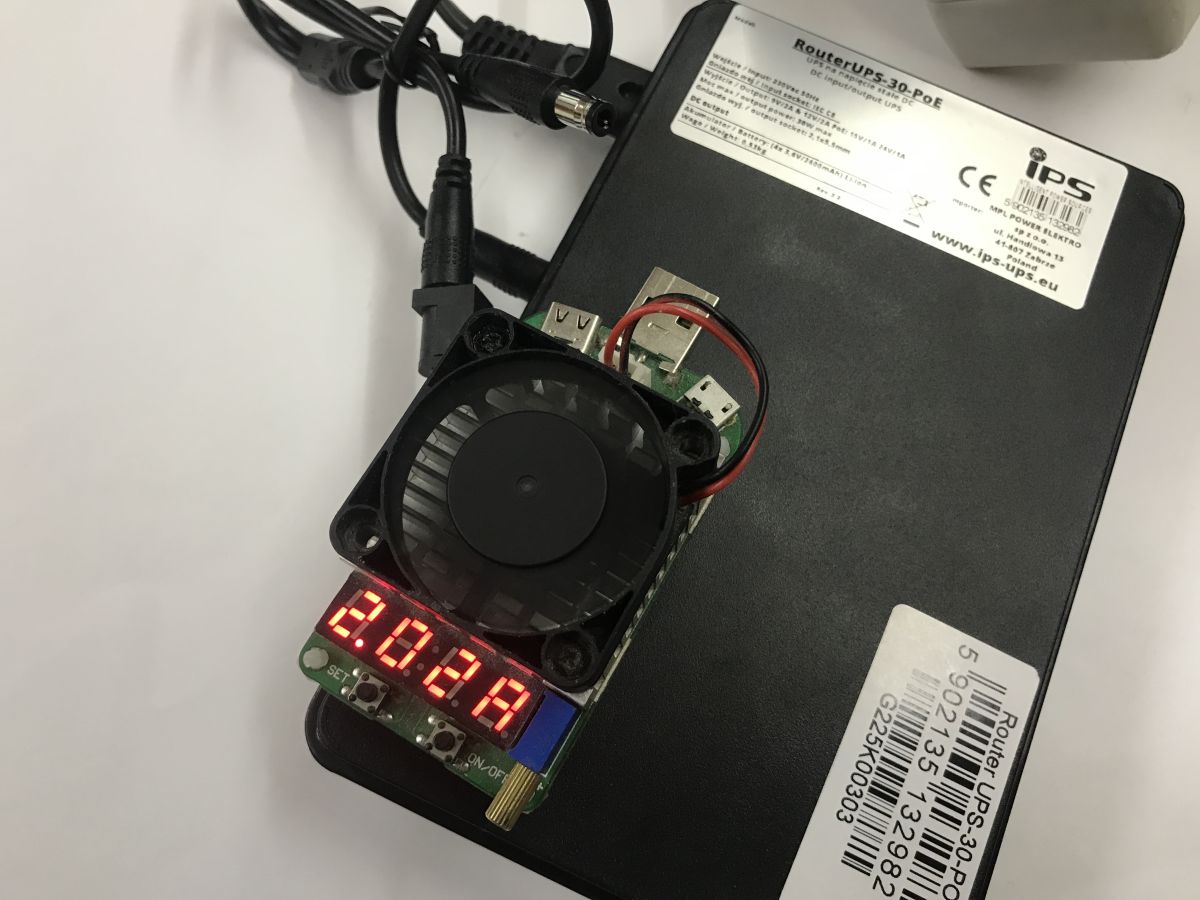

    I started with the load tests. Basically it is fine, according to the information on the case, although I only checked the DC and USB output. I used an LD35 artificial load for this. The 30 W version at 12 V managed to draw more than 2 A, and the 15 W version just over less than an amp.
    Electronic load with fan and red LED readout “2.50A” connected to a UPS in the background Black RouterUPS-15-POE UPS with a test module and LED display reading 13.92 Black RouterUPS-30-POE UPS with a small fan module and red LED display placed on top
    When the permitted current is significantly exceeded, the UPS locks up and flashes the LEDs. It can only be unlocked by pressing the button longer.

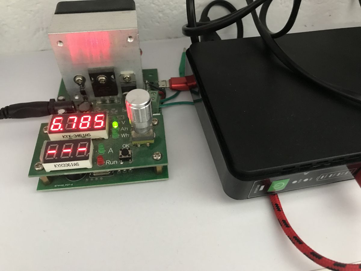

    I then checked the capacity of the cells inside. I repeated the test several times, because the first time I happened not to fully charge the whole thing (explanation in a later paragraph).
    UPS connected to a meter; red LED displays show 6.834 and 2.51, with cables on a desk Green circuit board with red LED readout 6.785 next to a black UPS unit and cables
    Similar results came out for both units, averaging around 6.8 Ah at 5 V, or 34 Wh. The battery in the middle was supposed to be 10400 mAh, but that's at 3.7 V. In theory it comes out to 38.48 Wh, but there are still losses on the inverters. I once estimated this for myself in a topic about powerbanks:

    I've taken myself a conversion factor there - 0.65. 6.8/0.65 = about 10.46 Ah per cell, ideal.

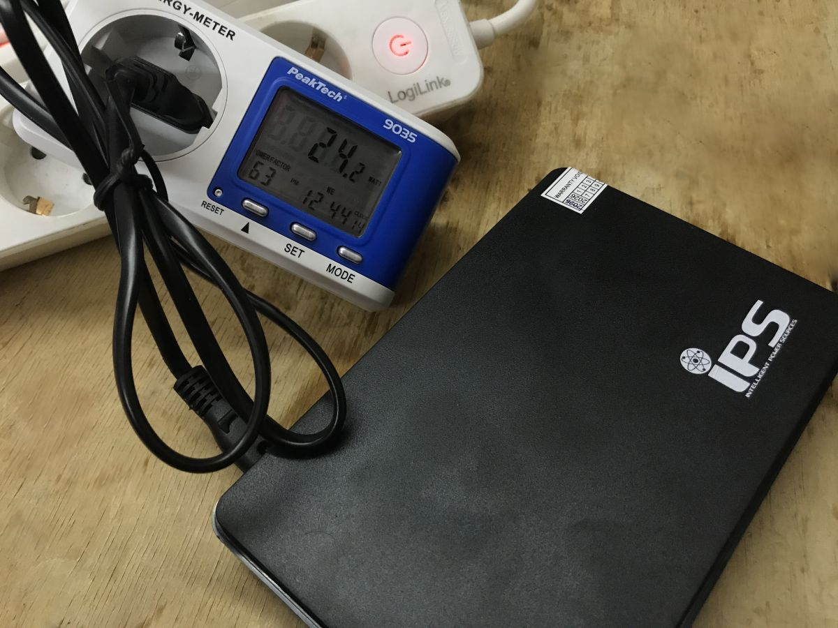

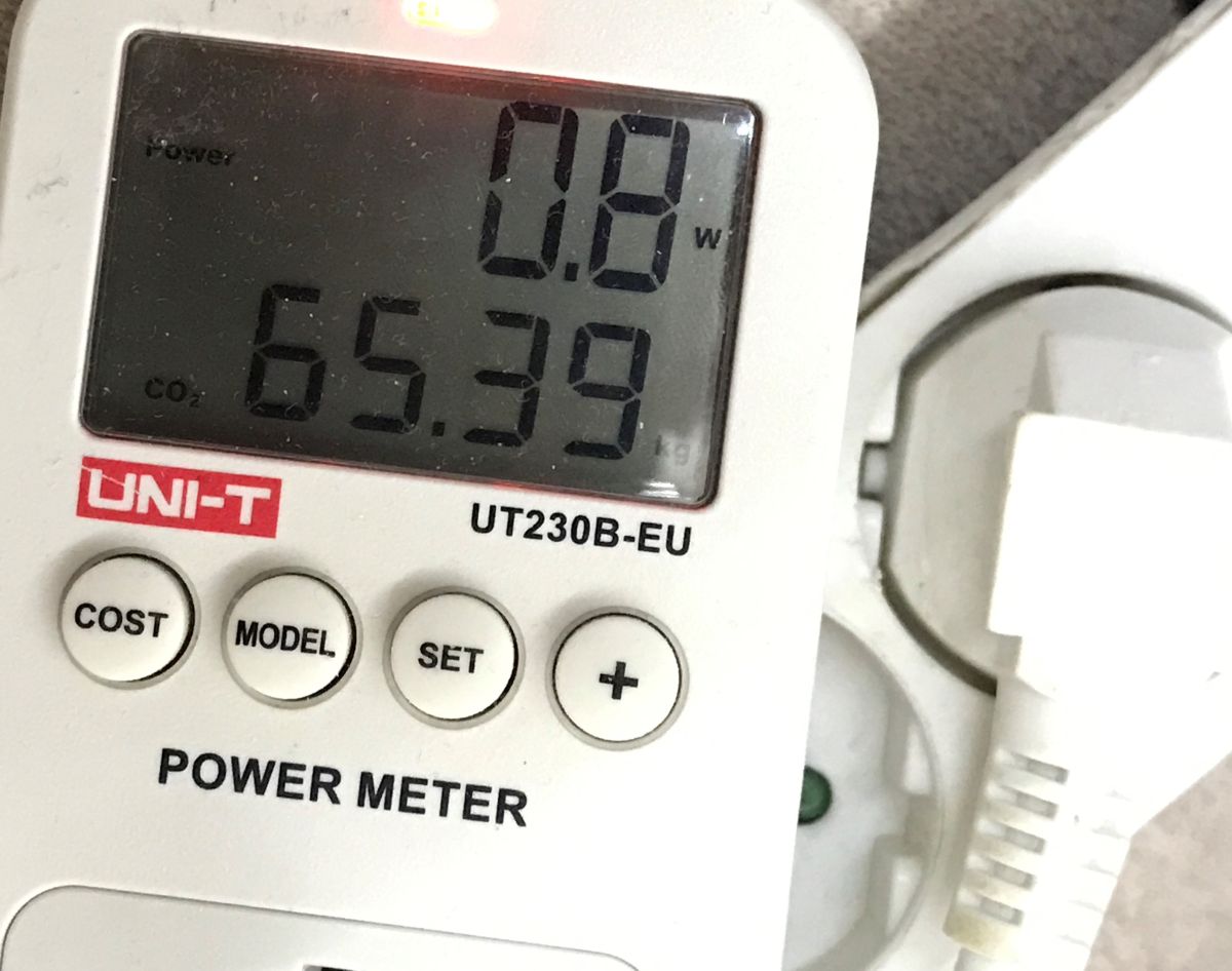

    In addition, I checked the charging - a good 24 watts this can draw from the mains:
    IPS mini UPS on a table next to a PeakTech 9035 power meter and power strip
    Only when charging does the power drop to less than 1 W.
    UNI-T UT230B-EU power meter display shows 0.8 W and 65.39 kg CO₂
    I still have an interesting observation - the UPS indicates for some time that it is fully charged and yet draws increased power, i.e. in practice it continues to charge.

    And what is the voltage on the PoE?
    It's a pity it couldn't be opened.
