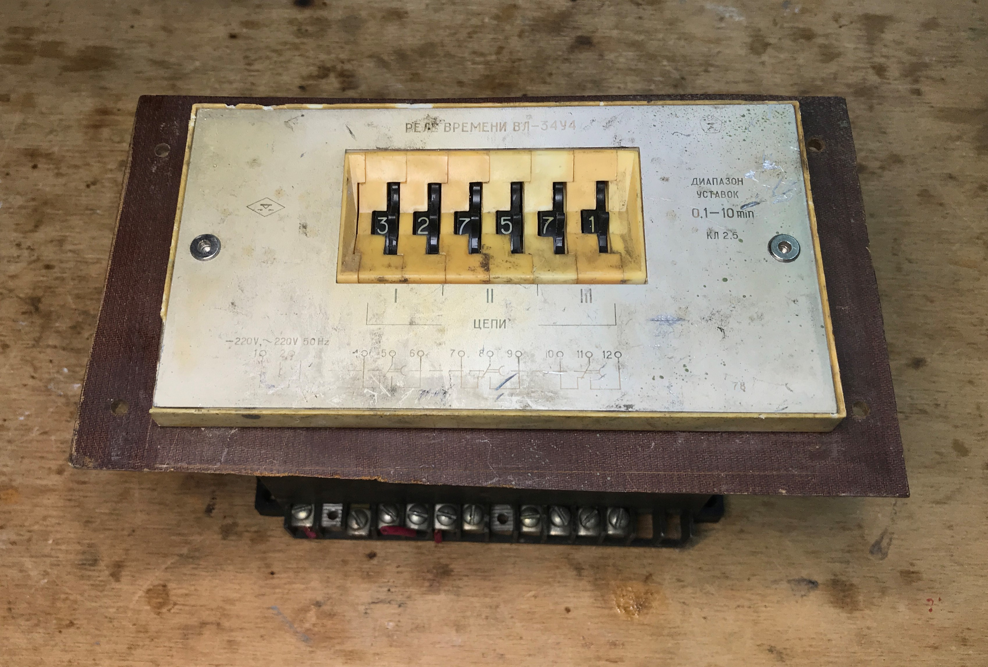

Here’s a little curiosity for today. This piece of kit is completely outside my field of expertise and not from my era, but it might still be worth a look – an old triple timer dating back to the days of the USSR. The whole thing is built using semiconductors. Time to take a look inside.
On the front panel, we can set three separate relay switching times. Just below, there is a diagram showing the internal connections and indicating which terminal screw is the common contact, normally open and normally closed. Let’s take a look inside:

TechEkspert 07 Apr 2026 18:20
Nothin' but nuthin' but nuthin' design :) MŁT resistors and relays without a case with the windings protected by a material soaked in some kind of impregnation. Typical Soviet rectifier diodes and... [Read more]
acctr 08 Apr 2026 10:15
There is also the K176LE5, 4xNOR. The correct name for this chip with a generator in the Latin alphabet is K176IE5 rather than "K176NE5", which makes it easier to search for. [Read more]
