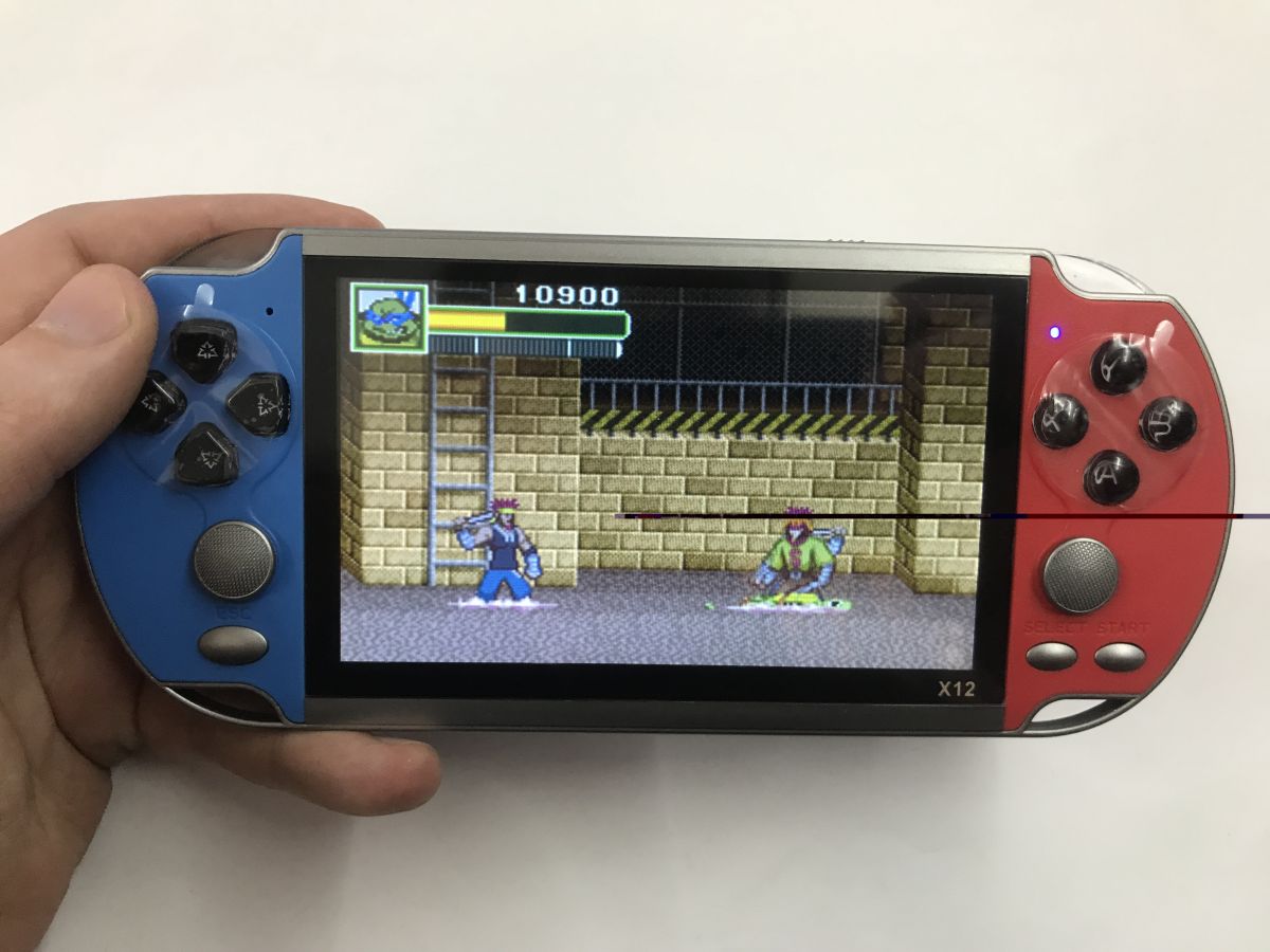

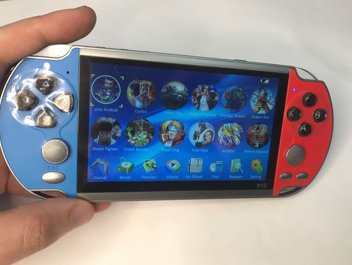

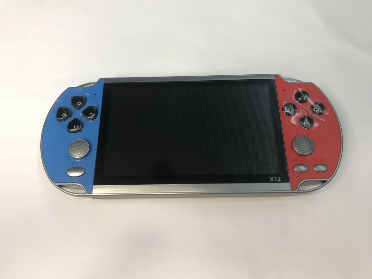

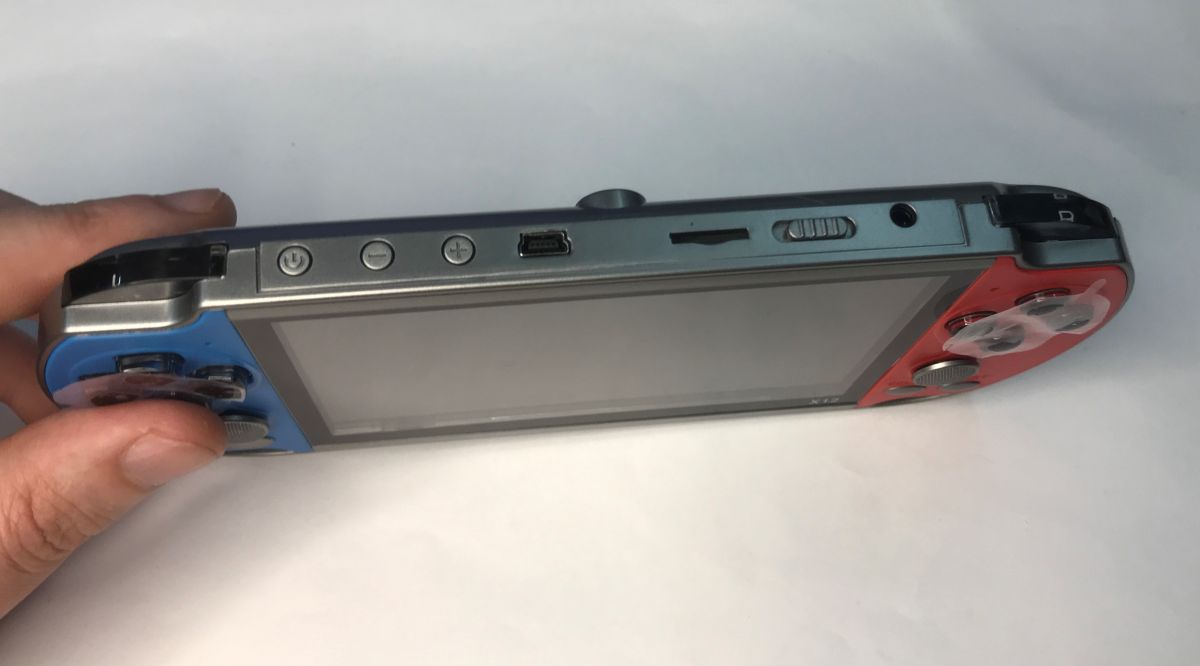

    The console is handy and flat, although the buttons walk a little more clumsy than I recall them from pads from, say, Pegasus. On the top edge, in addition to the standard buttons, charging input, audio/video output and SD card slot, we also have a volume control.
    Top edge of a handheld game console with screen, micro USB port, slider switch, and audio jack Back of a silver handheld game console with two speaker grilles and “8GB” printed on the casing. X12 handheld game console with large screen, blue-and-red body, on a white background
    On launch, we are greeted by a menu of selected games. You may get the impression that there are not that many titles here at all, but nothing could be further from the truth - you just have to enter the games folder.
    X12 handheld game console in a hand, showing a game menu on the screen, blue and red casing

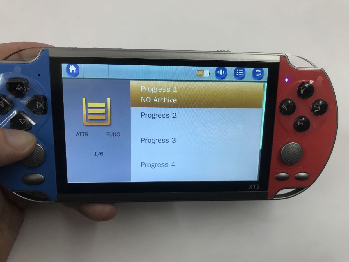

    Indeed, there are a good 11,000 files, even with the repeats it's still a lot of fun.

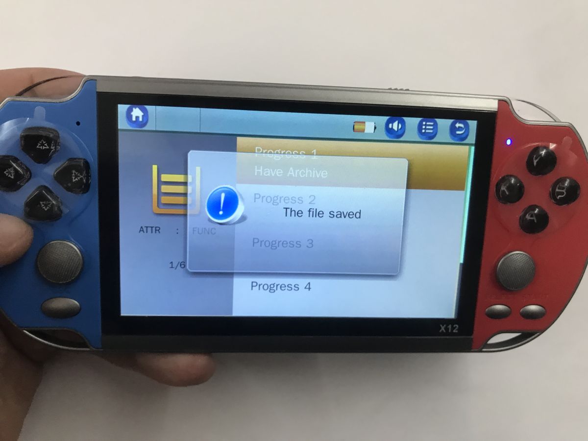

    I tested a few games. The gameplay can be saved, this is a functionality of the emulator, not the game itself.
    Handheld X12 console in hand; screen shows menu with Restart and Save Game options X12 handheld game console with blue and red sides, showing “Progress 1–4” menu on screen X12 handheld console in hands, blue-red body with “The file saved” popup on the screen

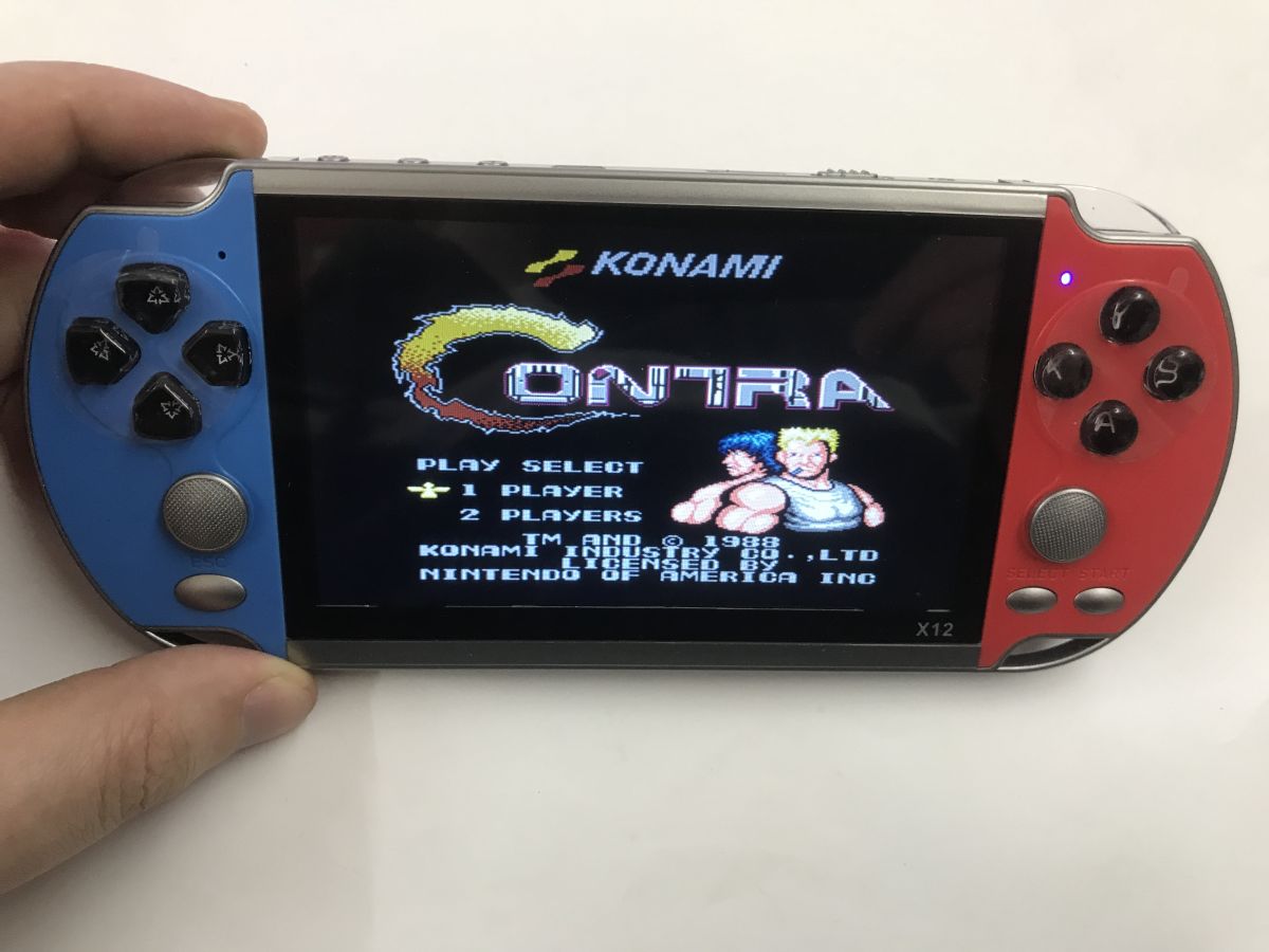

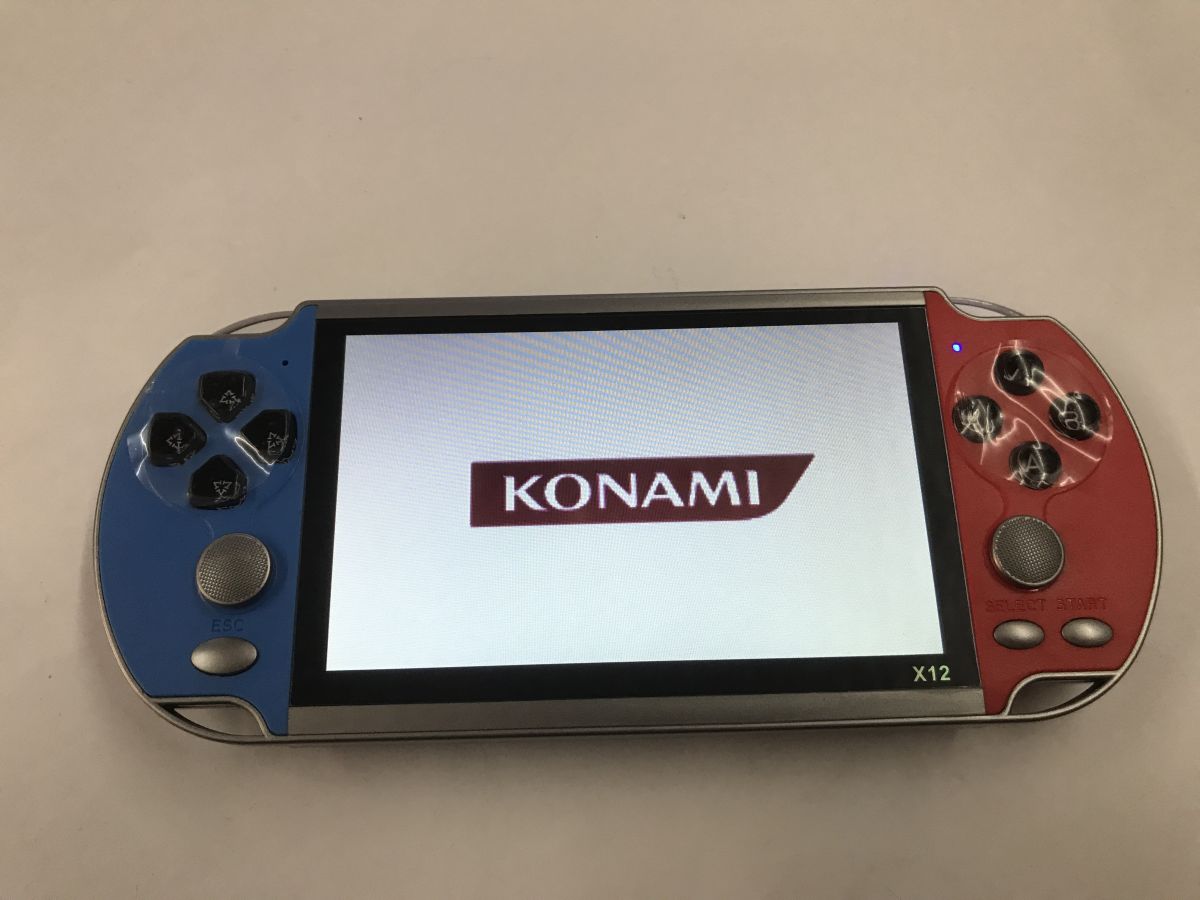

    The games look okay, there are titles I remember from my childhood, Contra, etc. The only thing to remember is that these games no console software interpolation reaches - and there may even be Japanese....
    X12 handheld console held in a hand, showing the “Contra” title menu with the Konami logo.
    Hand holding an X12 handheld console with red and blue sides; a 2D game is shown on the screen X12 handheld game console with blue and red grips, screen showing KONAMI logo X12 handheld game console in blue and red, showing a “MODE SELECTION” menu on the screen.
    The viewing angle of this screen doesn't knock it, but all in all, who would look at an angle?

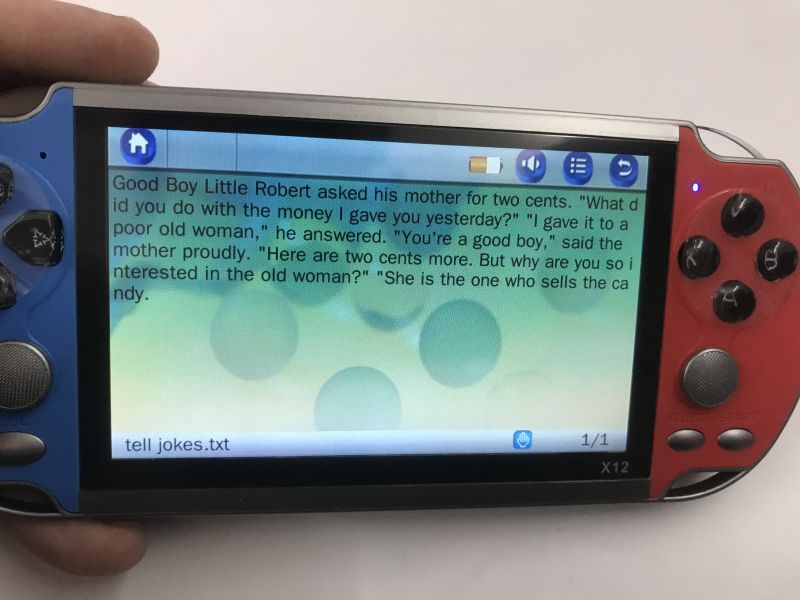

    You can also access files via the menu, you can play sound files, videos, text files, etc:
    X12 handheld console in blue and red; screen shows an English text file reader

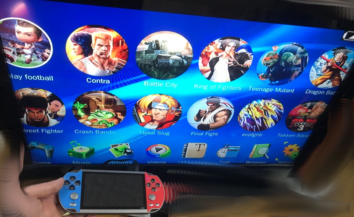

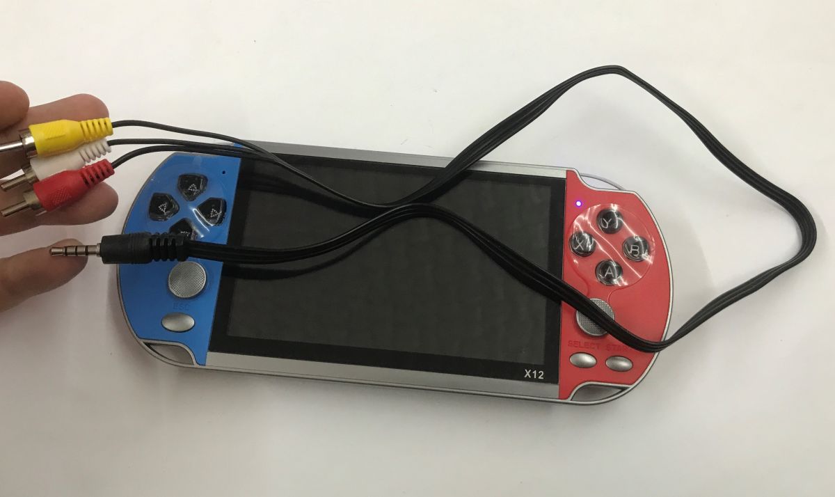

    Time for a test with the TV:
    TV input selection menu with AV2 highlighted and RCA connector icons X12 handheld game console with blank screen and connected AV cable with RCA plugs and a 3.5 mm jack
    Works, although you need to enable TVOut - PAL and NTSC modes are supported.
    Handheld X12 console in a hand, screen showing TV-out settings menu: Off, PAL, NTSC Handheld X12 console in a hand, screen shows settings menu with TV-OUT option
    Retro game menu on a screen, with an X12 handheld console in hand featuring blue and red controllers
    Just a moment, a moment... as a bit of fun, I switched myself to PAL mode with no TV connected, and still the image disappeared from the display and nothing could be done, I had to switch the console off and on. Potential pitfall.

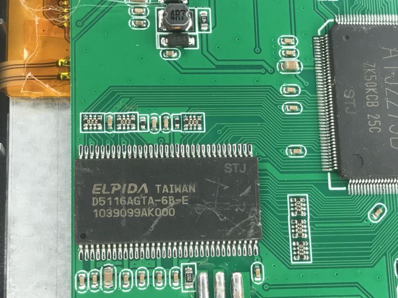

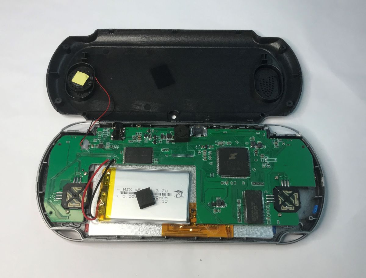

    Time to look inside:
    Inside a handheld console: green PCB, Li‑ion battery, and speaker in an opened black case

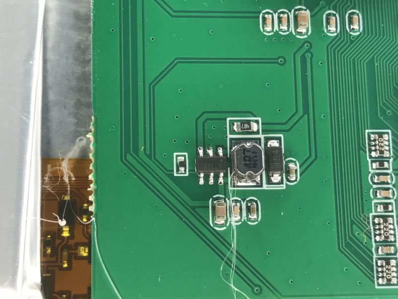

    You can see that some version of this console had a camera. There are the pads. In addition, you can see the power section, memory, main processor and RAM. In addition, there are inverters next to the processor to ensure the right low voltage for its operation.
    One of the inverters - the B11G8.
    Close-up of a green PCB with SMD parts and a shielded inductor coil

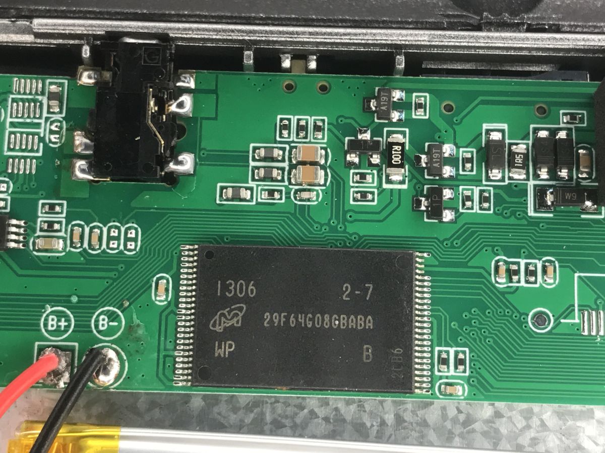

    29F64G08CBABA is a 64 Gb NAND flash memory which is 8 GB. As seen on the case.
    Close-up of a device PCB with chip marked 29F64G08CBABA and solder pads labeled B+ and B-
    D5116AGTA-6B-E is SDRAM, 512 Mb.
    Close-up of a PCB showing Elpida D5116AGTA-6B-E chip and surrounding SMD components

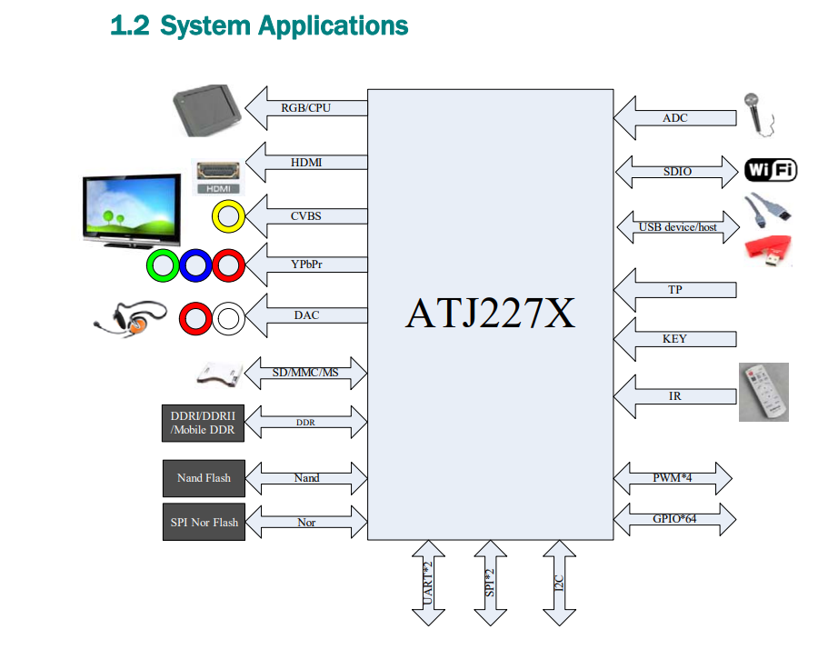

    And then there's the main SoC - the ATJ2279B.
    Close-up of a PCB with an ATJ2279B chip and surrounding SMD components

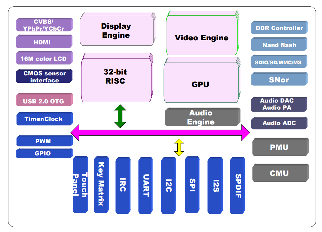

    The ATJ2279B is a highly integrated SoC based on a 32-bit RISC core up to 450 MHz, with integrated GPU, video engine and DDR/DDR2/Mobile DDR memory controller. Provides high performance with low energy consumption.
    Block diagram of ATJ227X showing video, audio, memory, and connectivity interfaces (Wi‑Fi, USB, SDIO)
    The chip supports video decoding up to HD, recording up to 720p and multiple audio and video formats. It offers HDMI, CVBS, YPbPr, 5.1 audio, SPDIF and I2S outputs and LCD interfaces with touch support.
    Block diagram of a SoC with 32-bit RISC, GPU, video engine, and multiple I/O interfaces
    The ATJ2279B features USB 2.0 HS with OTG, NAND Flash controllers with ECC, SD/MMC and a rich set of interfaces (I²C, SPI, UART, IR), enabling Wi-Fi, LAN and Bluetooth support.
    The integrated power management unit makes it a complete 'all-in-one' solution for multimedia devices.

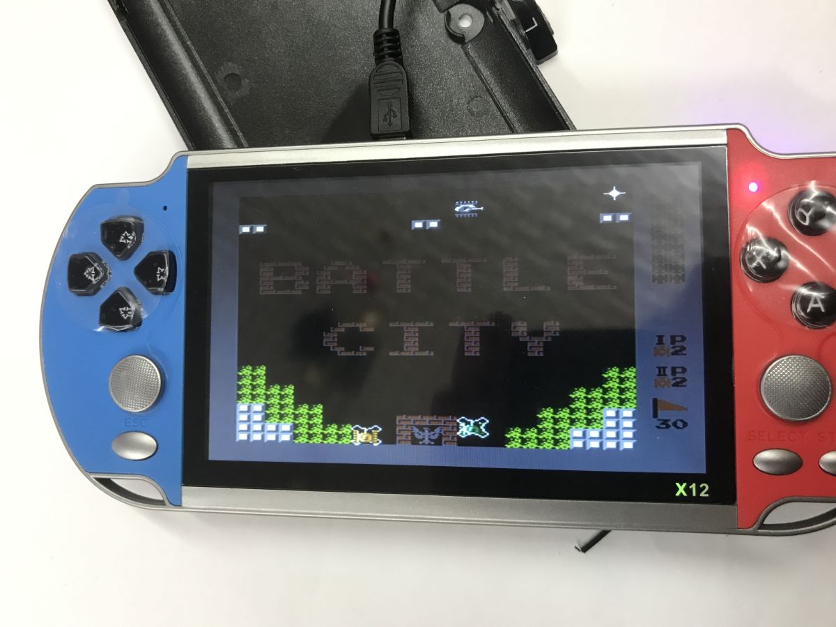

    It will be interesting to see if the console will run without a battery (I disconnected it after unscrewing the case), with USB power, yes:
    X12 handheld game console with blue and red sides, displaying the game Battle City.
    Battle City, this title I think I knew as Tank 1990.

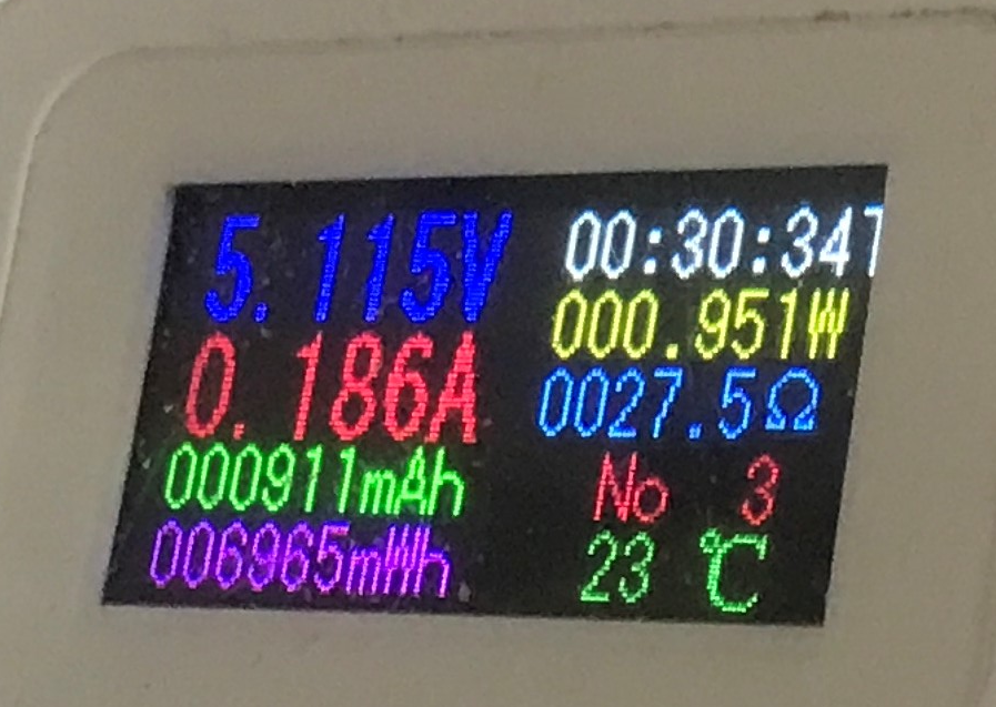

    It draws about 0.2 A at 5 V:
    Color USB meter display showing 5.115 V, 0.186 A, 0.951 W, and 23°C
