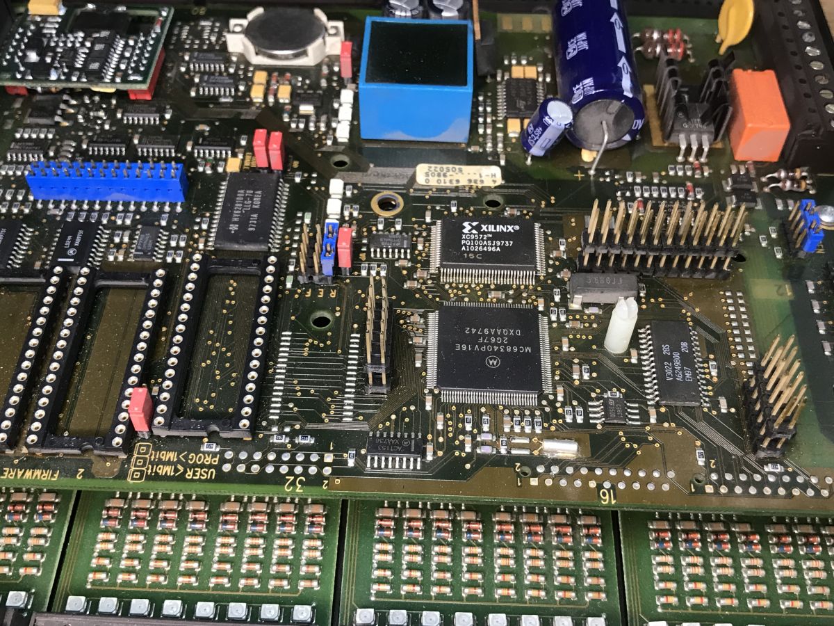

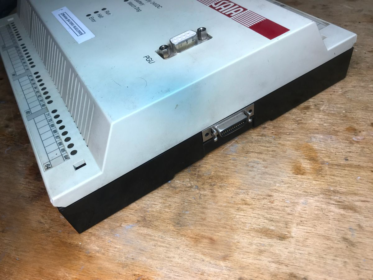

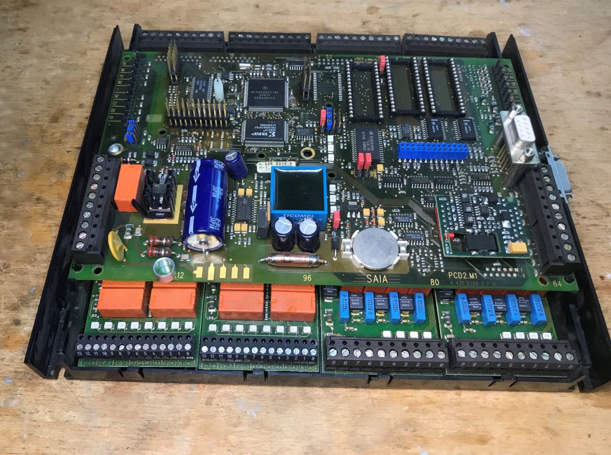

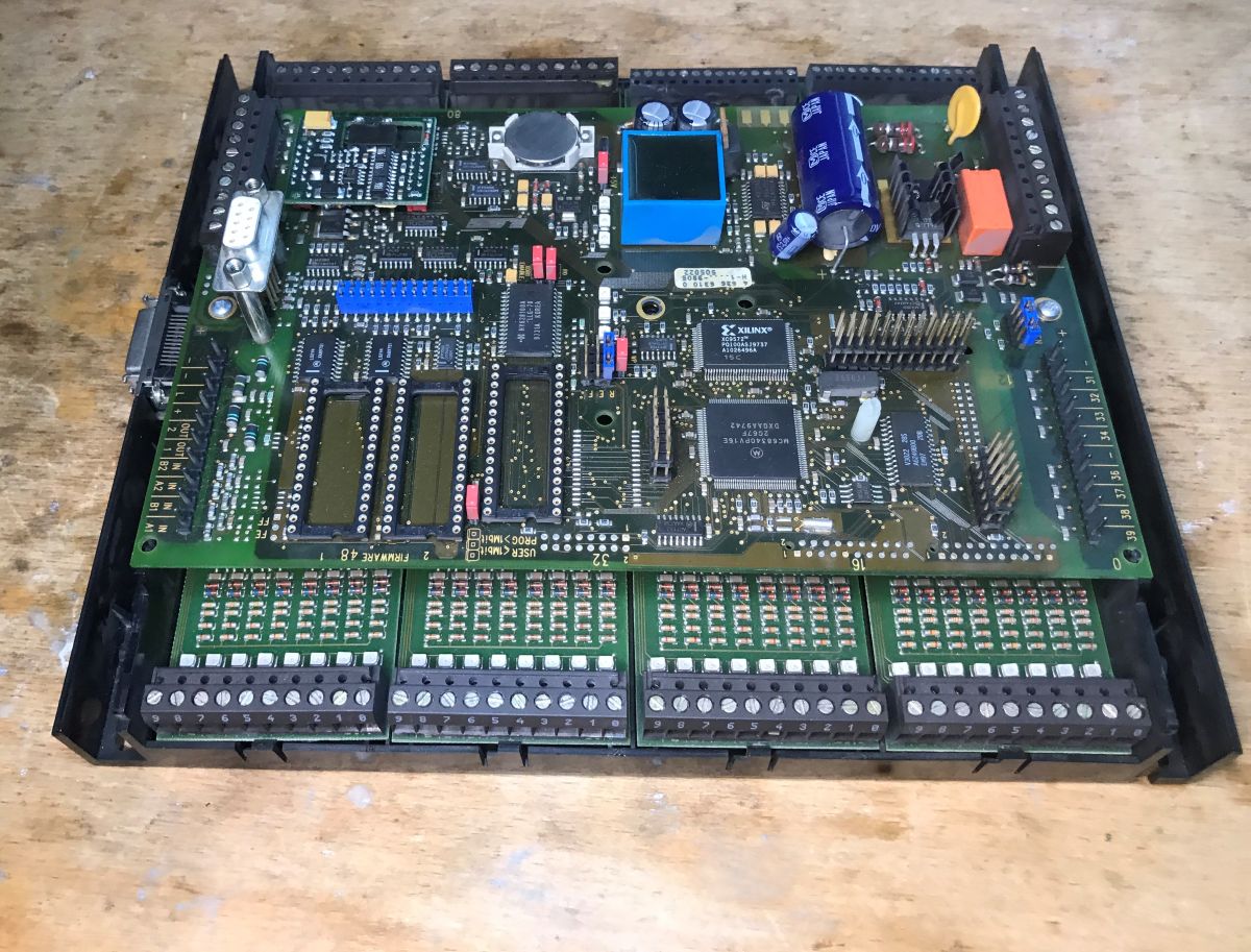

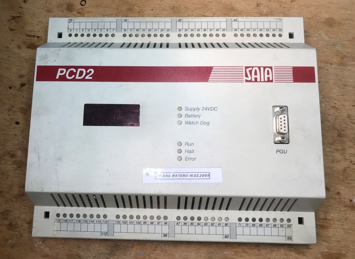

    Some time ago I presented the interior of the Saia PCD2.C100 extension cassette , today I would like to show its main module, the PCD2.M120 base unit. The PCD2.M120 consists of an enclosure, inside of which is the main board and the bus for the I/O modules, and a cover with LEDs, display and PGU (programming) connector. The connectors for the expansion cards are located on the side:
    Interior of the old Saia PCD2.M120 automation controller with expansion modules
    The motherboard sits above the bus as a separate PCB. Immediately striking are the markings and the battery for keeping time. There is no display on my copy.

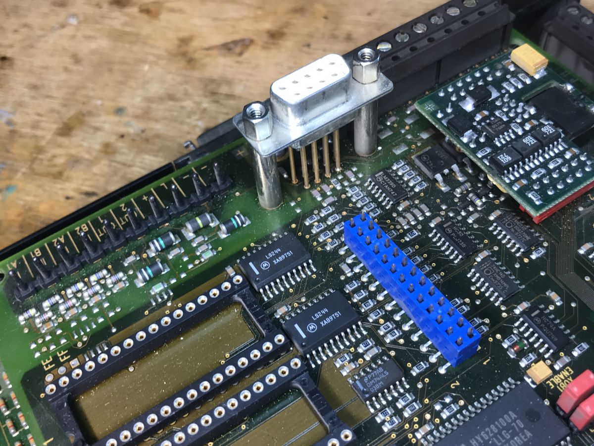

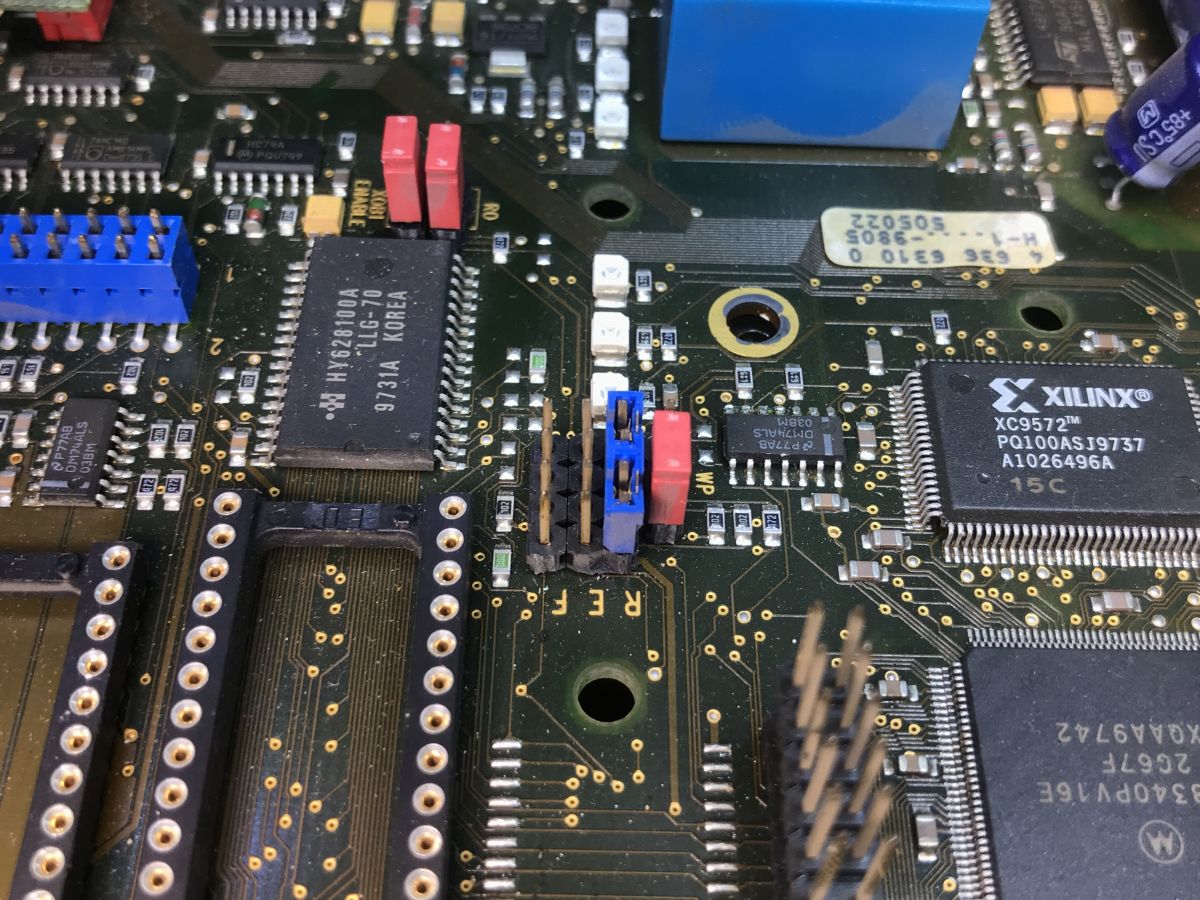

    Photo from the other side; you can see the DIP pin sockets on the memory bones along with the jumper for changing the mode.
    Additional connectors on both sides of the motherboard:

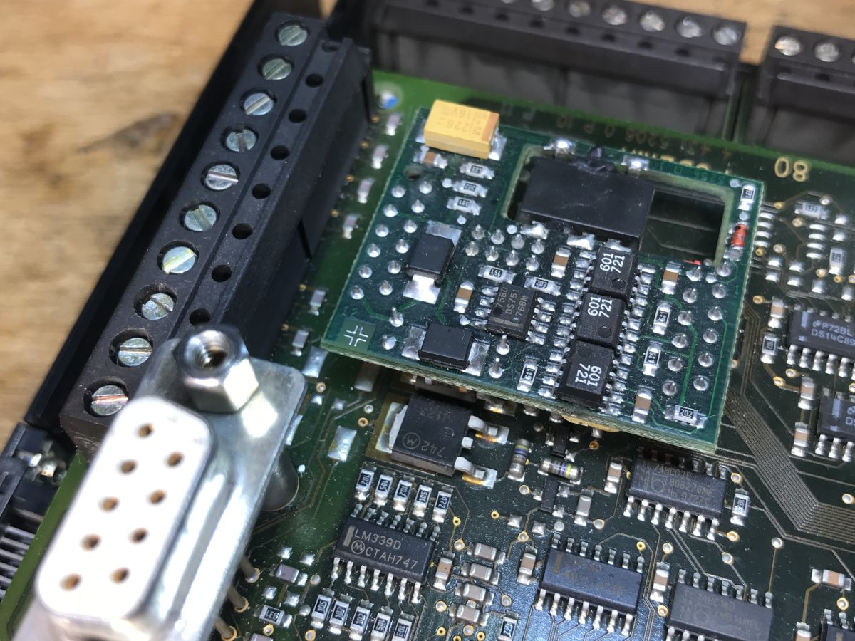

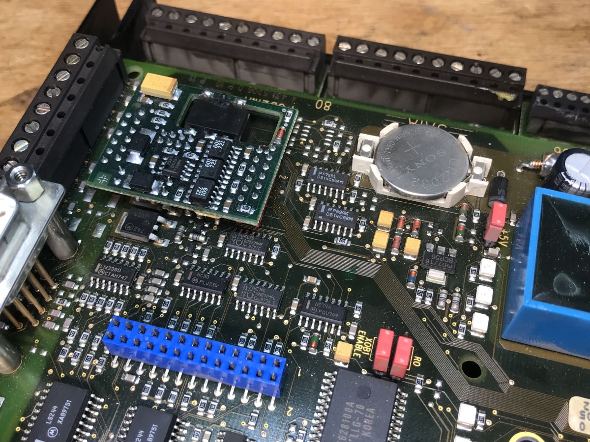

    Module with 7580 DS75176 - RS485 transceiver:
    There are further RS485 line control chips nearby - DS14C89 and DS14C88. In addition we have circuits HC30, 74HC14, HC74, 74HC03, LM339D, perhaps from bus control.

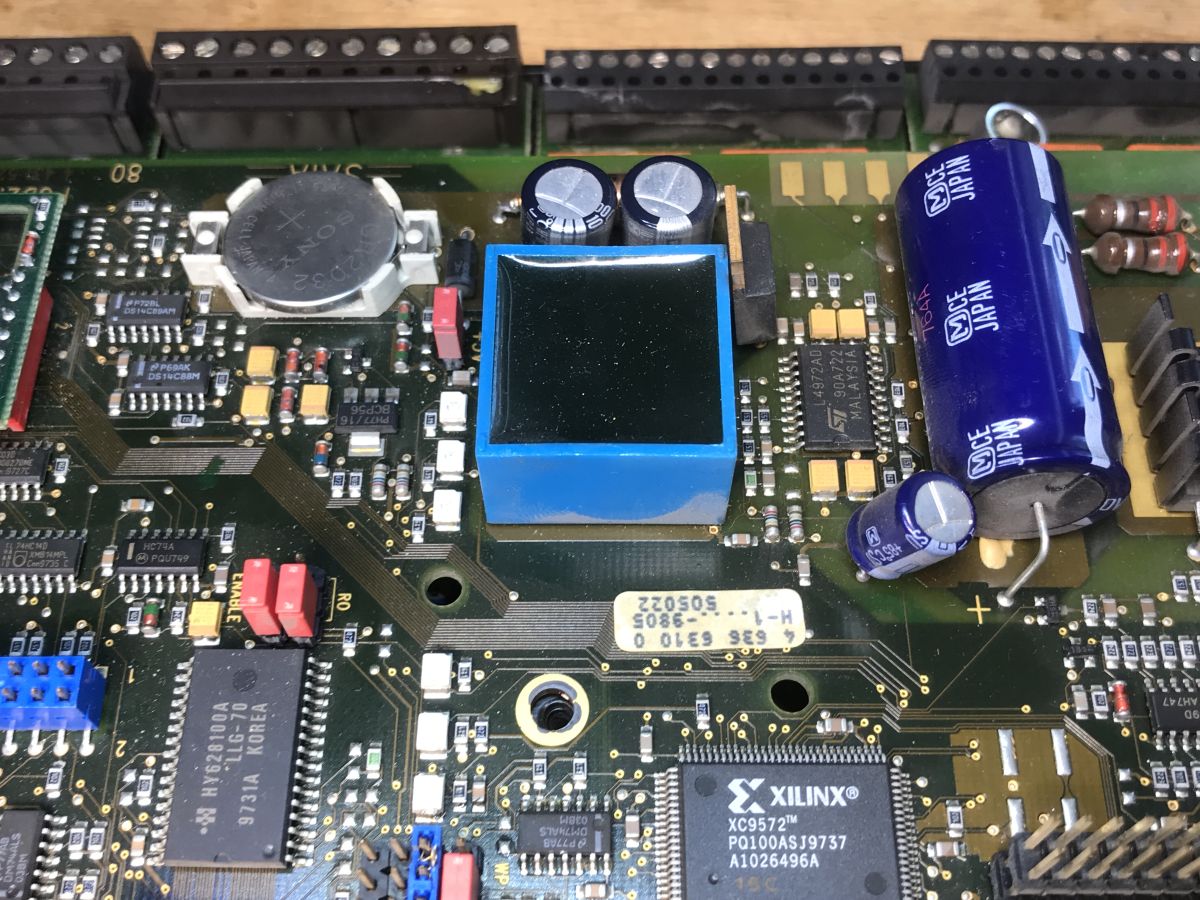

    An interesting component is the TICOMEL visible in the photo - the model is obscured, but you can see an example online - SD-17-0.63-500 0.63A 500UH. This is simply a coil. That whole circuit there is a power section based on an inverter on the L4972A.

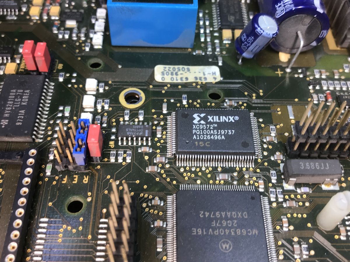

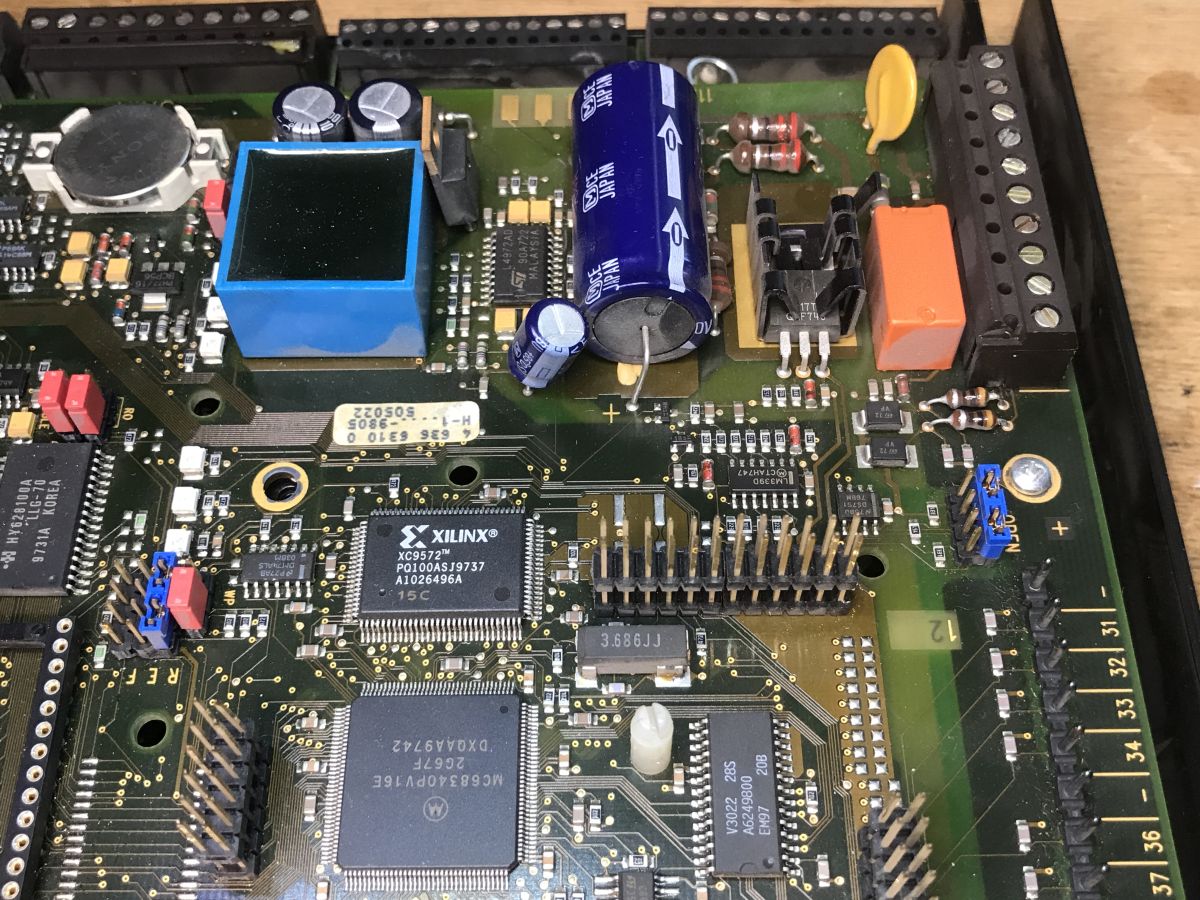

    After the power section we have the region with the main ICs. There are the Xilinx XC9572 (CPLD), MC68340 (processor with DMA, also of age, 1994) and V3022 (clock chip - you can see the oscillator next to it).
    Interior of the old Saia PCD2.M120 automation controller with expansion modules Interior of the old Saia PCD2.M120 automation controller with expansion modules
    Interior of the old Saia PCD2.M120 automation controller with expansion modules Close-up of a PCB showing a Xilinx XC9572 chip and nearby electronic components

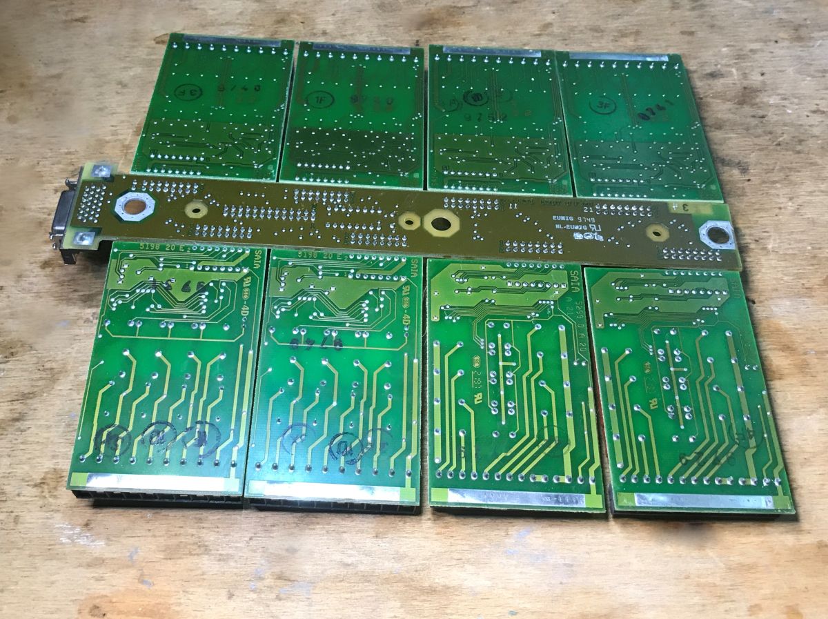

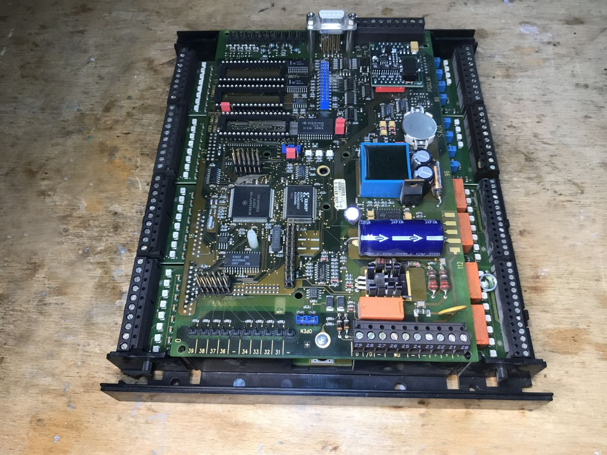

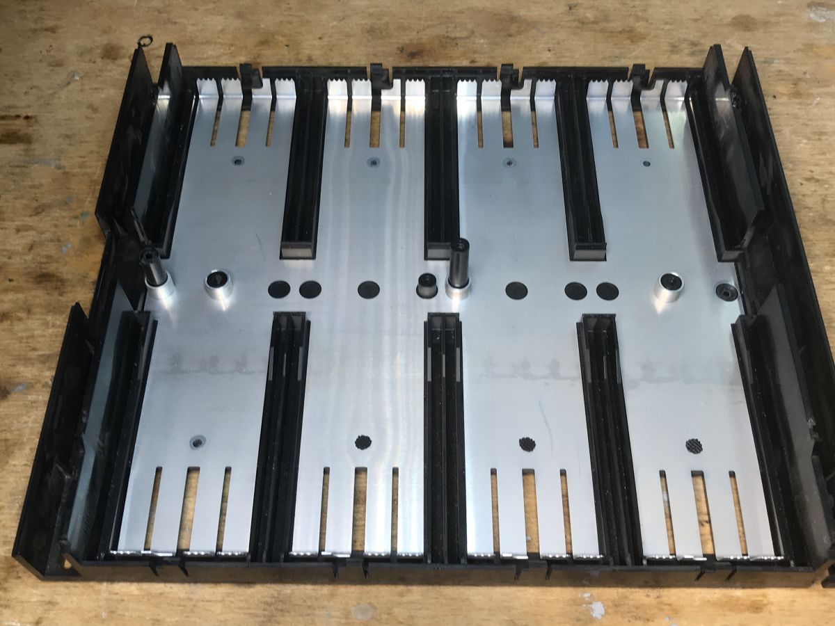

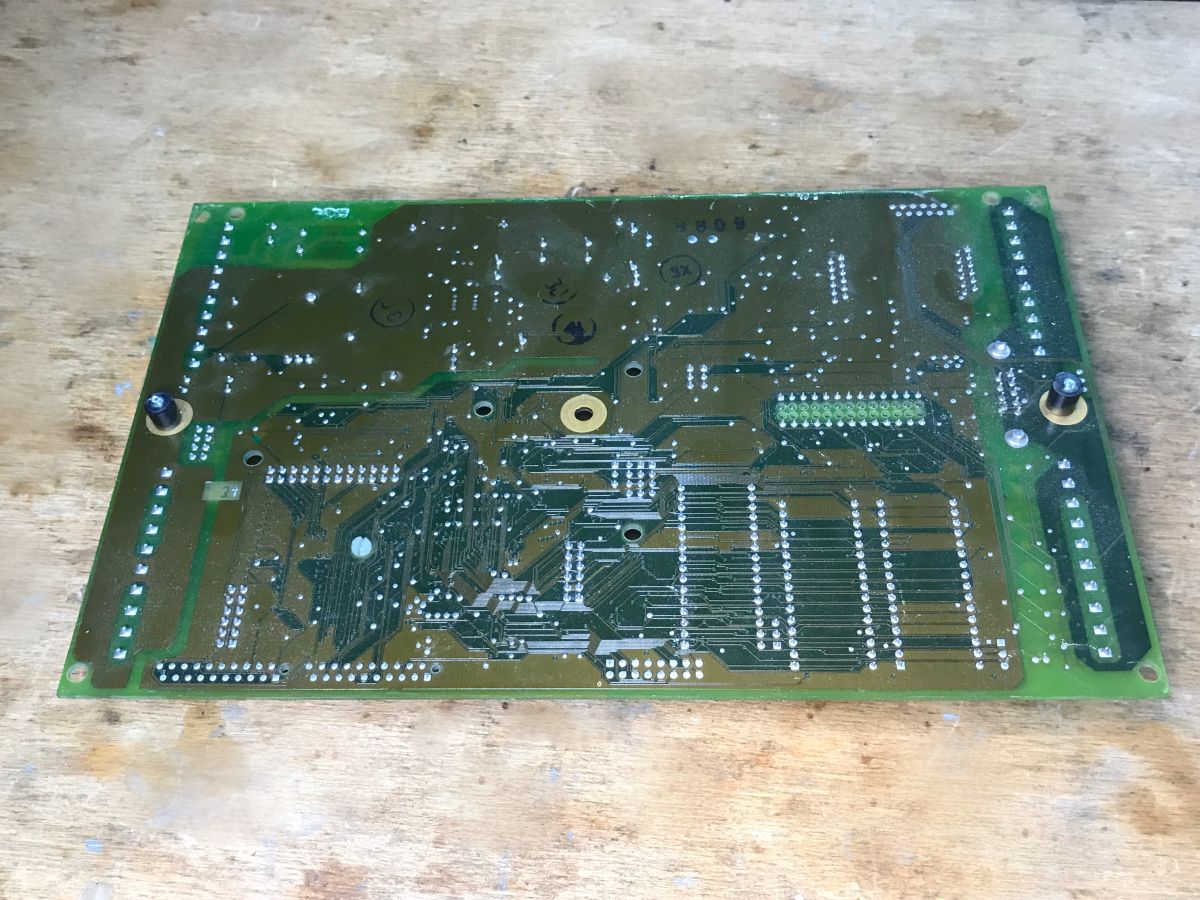

    Let's remove the motherboard now. My copy must have been dropped by someone because there are broken plastic spacers:
    Underside of a green PCB with many traces and solder points on a wooden workbench

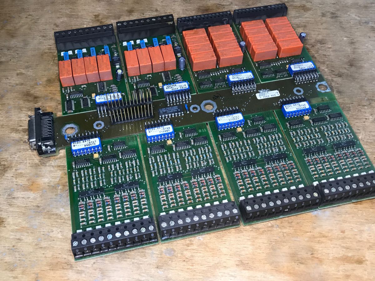

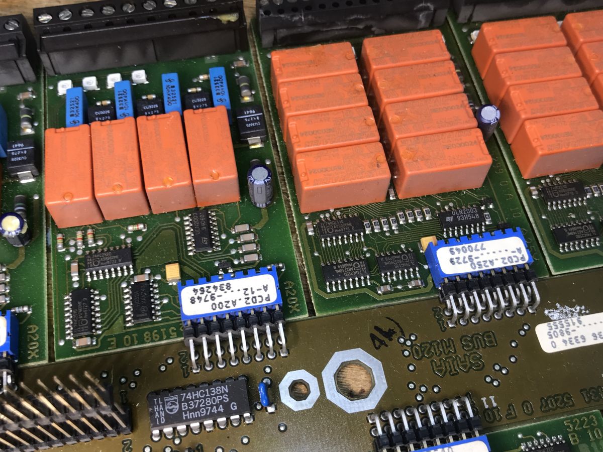

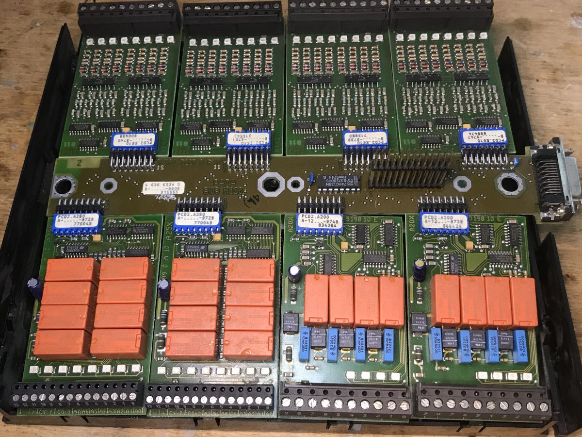

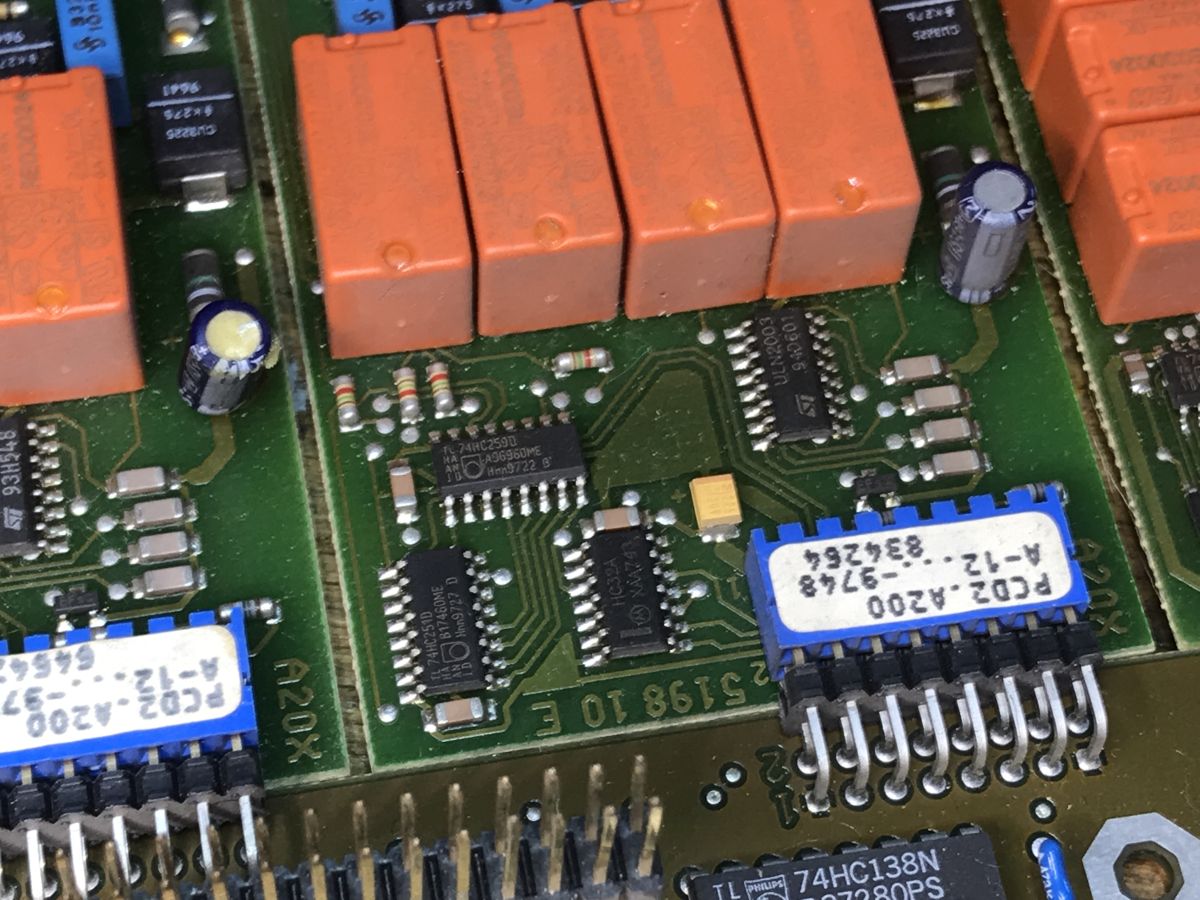

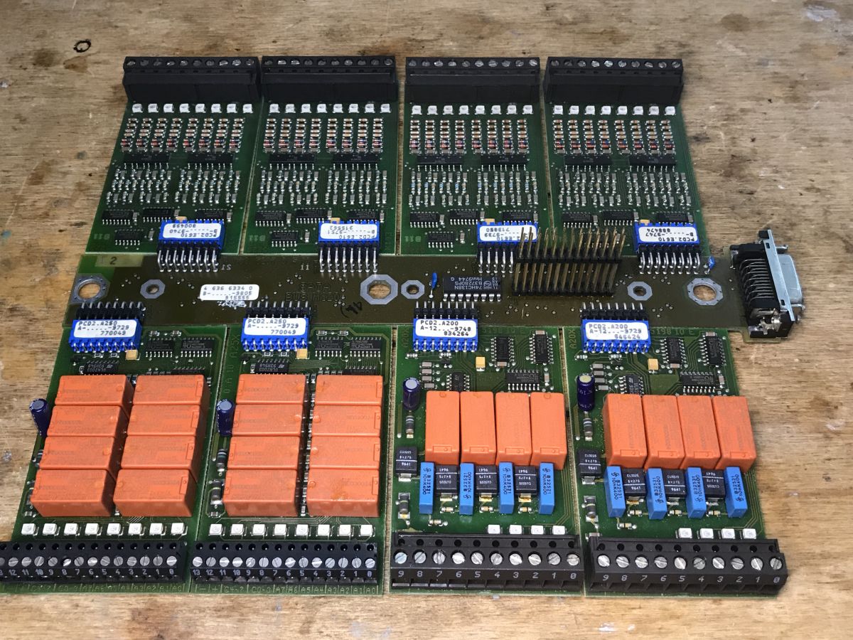

    Four I/O modules can be placed on each side of the bus.
    Inside a modular controller: four green PCBs with orange relay blocks, many ICs, and screw terminal strips Black plastic chassis with four metal guide plates and module slots, on a wooden surface Printed circuit board with relays, screw terminals, and a D-sub connector on a wooden surface

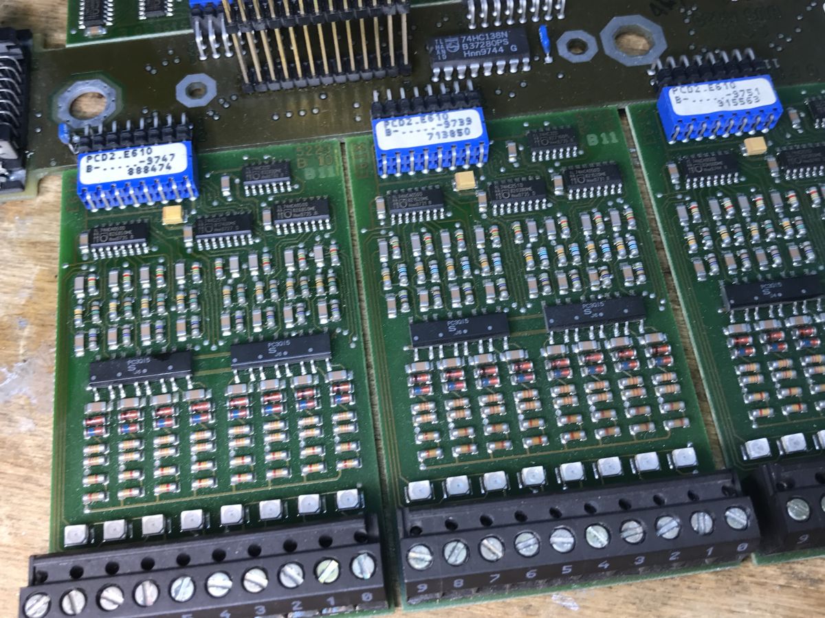

    I can still show them in a few pictures, but in general I have already discussed these modules: Interior of the Saia PCD2.C100 expansion cassette from the PCD2 programmable controller
    Three green PCBs with orange relays and screw terminal blocks on a wooden table Close-up of a PCB with DIP switches, ICs, many resistors, and screw terminal blocks Close-up of PCB modules with orange relays, integrated circuits, and blue DIP switches
    Close-up of a PCB with orange relays, IC chips, and blue DIP switches Underside of green PCB assembly with eight modules and a side metal connector on a wooden surface

    This unit is 30 years old (the stickers are barely visible, but you can make out the date code ‘97’). The board is secured with screws to plastic sleeves, which become brittle over the years and snap off when you try to unscrew them. The latches break off in a similar way.
    The RS485 interface can be removed – it is an optional module. The display is also an option, though rather rare; the PLC does not require it to function.
    Two EPROM chips containing the firmware are missing – the sockets are empty. It will not work without them. The files required for programming should be available on the manufacturer’s website (in the archive section).
    The third socket is for optional application memory – EPROM, EEPROM or RAM.
    This equipment was discontinued about 15 years ago (and had been in production for around 15 years!). Since then, there have been two further generations up to the present day. There are new models with a similar mechanical design – the I/O cards are compatible, but the expansion modules (communications, etc.) must be new.
    Applications can be ported between hardware versions without much difficulty (even without source code) – the backwards compatibility is truly impressive; modifications mainly involve communication (Ethernet instead of RS232/485) and, where necessary, the oldest analogue modules (replacing them with newer ones).
    The brand is currently owned by Honeywell; in Poland, the distributor is Sabur.
