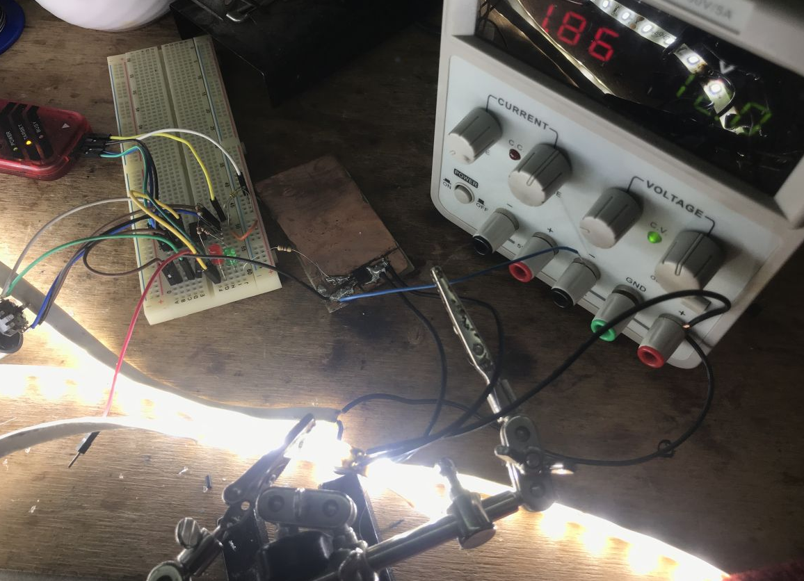

Tests with LED strip
I wanted to check how much my transistor would heat up. Choosing a transistor along with a gate resistor is not a trivial matter and far beyond the subject of this short PIC presentation so I wasn't expecting sensational results, but I still had to see if it would work at all.
The transistor was soldered onto a small piece of copper-coated laminate, so heat dissipation was quite reduced, but maybe that's better - you can always improve performance.
I tested everything with a laboratory power supply at 12 volts, attaching more LED strips to increase the load.
By the way, I advise you against testing LED strips this way, even the rollers bend from the heat, the adhesive layer under the strip also degrades.
At a load of 0.66 A, the transistor is cold. This 40 °C is only due to reflection in the binder.
At a load of 1.85 A the transistor only starts to heat up, it reaches just under 30 °C.
At a load of 2.9 A, the transistor exceeds 35 °C.
At a load of 5.1 A, the transistor reaches 65 °C.
Probably if only some heatsink were added, the temperature would drop even further.
The results are fully satisfactory to me.

How much will be the load on the output of the PIC in full brightness state?
The PIC output does not carry the LED strip load current at full brightness; it only drives the MOSFET gate, stated as direct control from the pin "via a resistor." The heavy current flows through the AOD454 and the 12 V LED strip path instead. In the tested design, the load reached as much as 5.1 A, but that was the switched strip current, not PIC GPIO output current. [#21881566]
How much will the diode current be in the full brightness state?
At full brightness, the LED current is the strip load current set by the connected 12 V strip sections, not a current defined by the PIC pin. The thread does not give a per-diode figure, but it does give measured total load points of 0.66 A, 1.85 A, 2.9 A, and 5.1 A during strip testing. Those values describe the current through the strip and MOSFET in real operation. [#21881566]
Why was the AOD454 MOSFET chosen for switching 12 V LED strips from a PIC12F683, and how do you check whether 5 V gate drive is sufficient?
It was chosen because it is an N-channel MOSFET with high current capability and low on-resistance at gate voltages the PIC can provide. The thread cites about 12 A at Vgs = 10 V and about 47 mΩ Rds(on) at Vgs = 5 V, which makes direct 5 V gate drive acceptable here. The correct check is simple: confirm the datasheet includes a low Rds(on) value at 5 V, not only at 10 V. [#21881566]
What temperature rise is acceptable for an AOD454 MOSFET when dimming LED strips at currents like 0.66 A, 1.85 A, 2.9 A, and 5.1 A?
The thread's test results show acceptable heating for this build: effectively cool at 0.66 A, about 30 °C at 1.85 A, above 35 °C at 2.9 A, and about 65 °C at 5.1 A. Those measurements were taken with the MOSFET mounted on a small copper-clad laminate piece, not a substantial heatsink. That makes 65 °C at 5.1 A a useful upper practical reference for this exact implementation. [#21881566]
How would interrupting on one encoder input edge and checking the other input compare with full state-machine decoding for direction detection on a PIC12F683?
Edge-triggering on one encoder line is simpler, but full state-machine decoding is more robust on noisy or fast turns. The forum comment suggests using one input edge and reading the other signal to determine direction, which can work when transitions are clean. The implemented 7x4 state table is safer because it validates complete sequences and rejects invalid intermediate states that caused wrong readings during rapid rotation. [#21881705]
