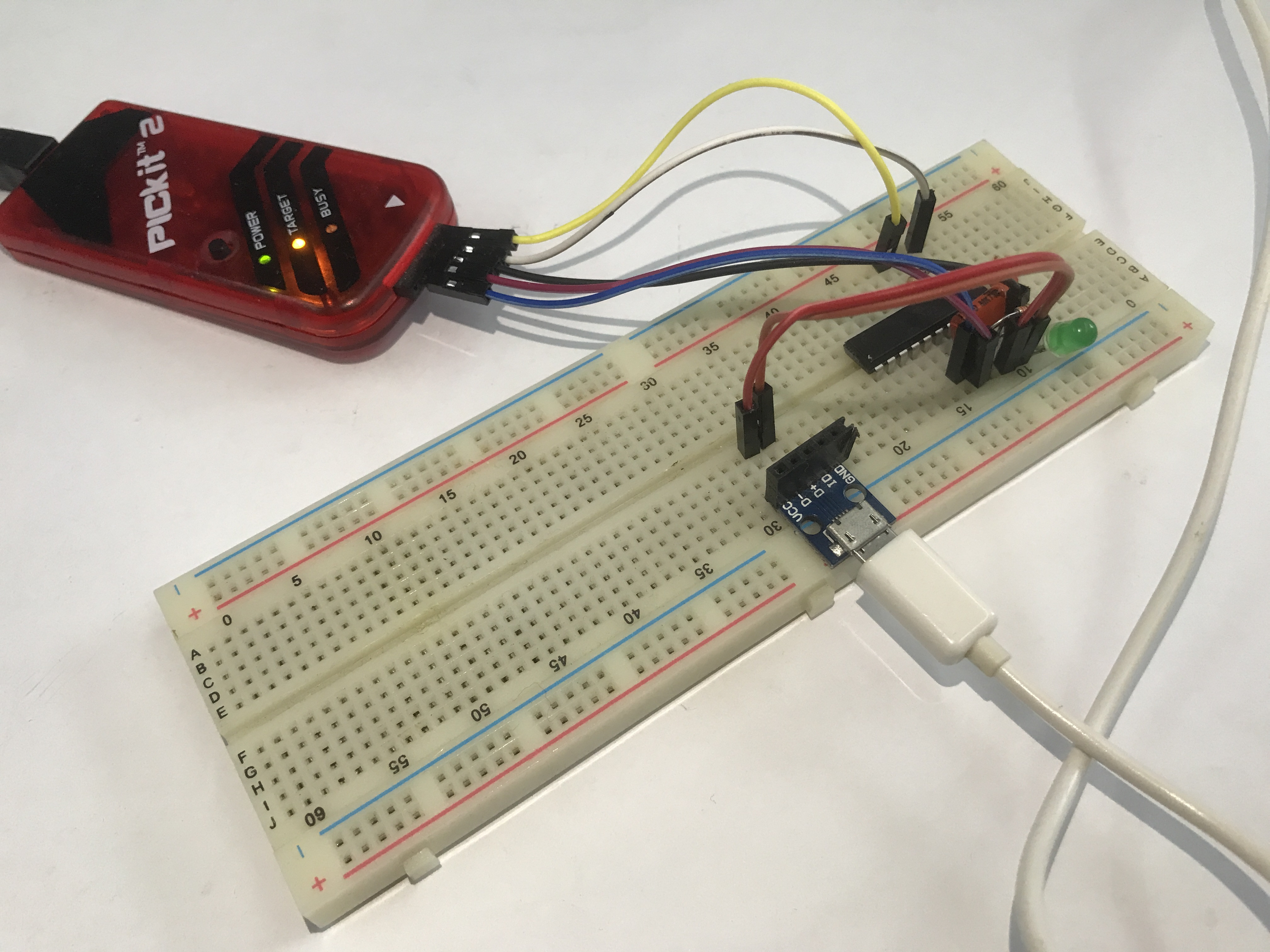

Connecting to the PIC
The PIC shown requires a very small number of components to run. Basically you need to give a 100 nF decoupling capacitor between the power supply pins, this is for the principle, as in any microcontroller, and a 10 kΩ resistor between the MCLR pin and the power supply - this to get the PIC to boot, shorting MCLR to ground resets the circuit.
The PICKIT3 is suitable for programming, although with the new Device File even the PICKIT2 can handle it. We program via ICSP:
I posted the Device File for PICKIT2 in my older topic about this PIC. There I was still running it with a commercial microC, for that reason I think the solution presented today is a big step forward.
PIC16F1459 boot board with USB
PICKIT2 handled this PIC with no problems at my place:
