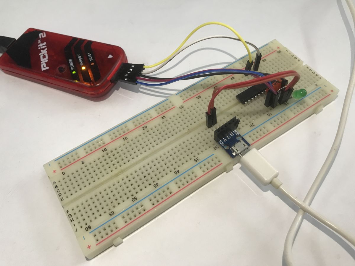

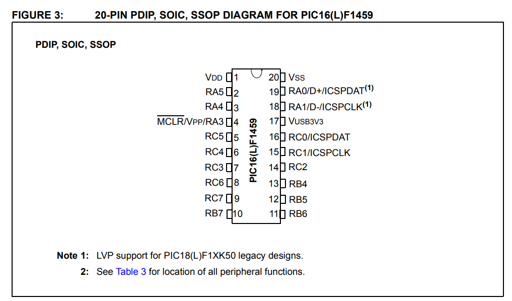

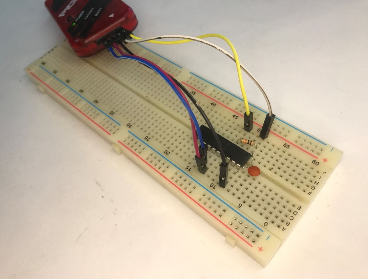

    Connecting to the PIC
    The PIC shown requires a very small number of components to run. Basically you need to give a 100 nF decoupling capacitor between the power supply pins, this is for the principle, as in any microcontroller, and a 10 kΩ resistor between the MCLR pin and the power supply - this to get the PIC to boot, shorting MCLR to ground resets the circuit.

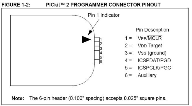

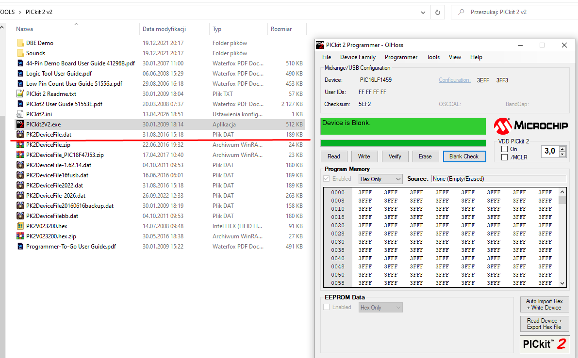

    The PICKIT3 is suitable for programming, although with the new Device File even the PICKIT2 can handle it. We program via ICSP:
    PIC16LF1459 tutorial - USB HID support in the free SDCC compiler - LED, mouse and keyboard
    I posted the Device File for PICKIT2 in my older topic about this PIC. There I was still running it with a commercial microC, for that reason I think the solution presented today is a big step forward.
    PIC16F1459 boot board with USB
    PICKIT2 handled this PIC with no problems at my place:

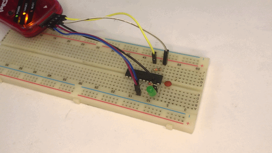

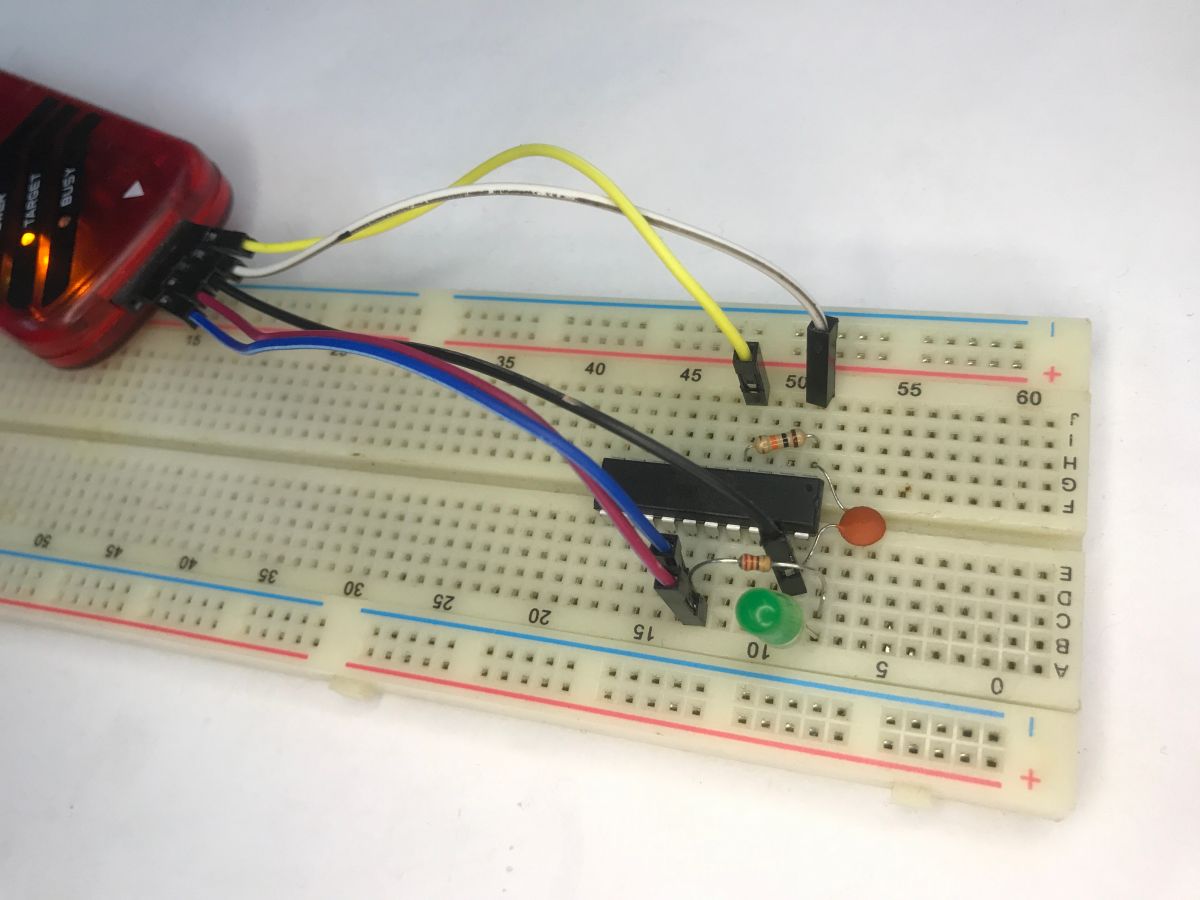

    Hello World - Blink LED
    Blink LED is often the first program I run on microcontrollers. It allows me to check that the batch starts at all and that it works at least somewhat stably.
    Code: C / C++
    The program starts the PIC with the built-in resonator, the OSCCON register is used to configure it. I then configure the entire C port as an output, and flip its state to the opposite state in a loop. The function waiting 1000 ms is a simple blocking loop. In the target program this shouldn't be there, as it just wastes CPU cycles, but for a test it's acceptable.
    Now just connect the LED and resistor to any pin from port C:
    Basically that's it - the LED flashes:

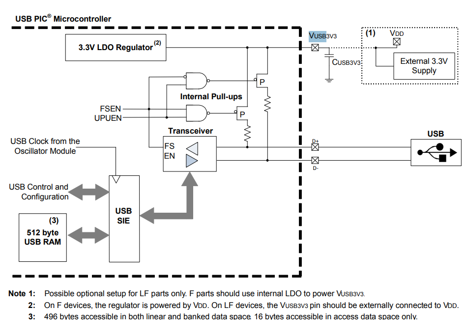

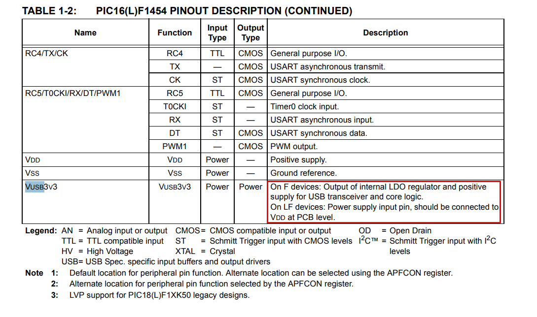

    Hardware-wise we still need to remember the extra capacitor on Vusb (depending on the PIC version):
    In the LF version we connect it to the power supply, otherwise a capacitor is needed.

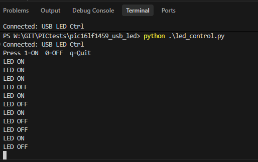

    Now the PC program - for convenience in Python. A short script that finds the device by the entered Vendor/Product and sends this one byte over the HID to switch the LED:
    Code: Python
    The program works and the LED can be controlled.

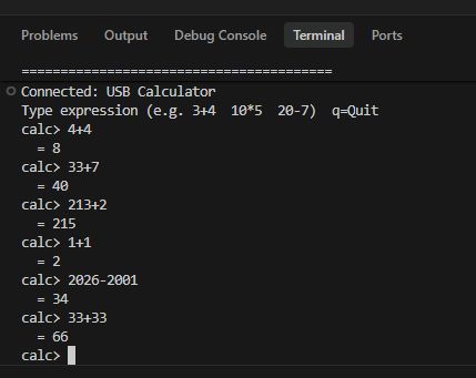

    Packages USB HID - calculator
    Let's further demonstrate for completeness the sending of a byte string. We can base this on the calculator example, the script sends a 2+2 style request and the PIC calculates this equation and returns the result. Such a mechanism requires two-way communication - the PIC has to receive the data, process it and then send back the result. A one-way message is not enough here, as with LED control.
    So, receiving the data - processing it will be realised by the processIncoming function:
    Code: C / C++
    Sending the response - with the readiness flag attached (the program will then detect it and send the data on):
    Code: C / C++
    The heart of the calculator, i.e. parsing and calculations - the least important here, but for reference:
    Code: C / C++
    Result:

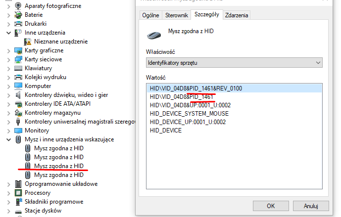

    USB HID device - mouse

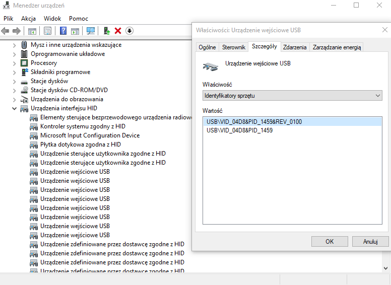

    A standard USB mouse is an HID device these days. This means that the code from the previous example, with very little change, can control the movement of the cursor on the computer screen. The first thing that is missing to fully simulate a mouse is device identification - the device must report in the descriptors as a mouse. You can at least look up the ID values in the documentation at Microsoft:
    https://learn.microsoft.com/en-us/windows-har...dclass-hardware-ids-for-top-level-collections
    I have therefore completed the identifiers:
    Code: C / C++
    Code: C / C++
    Windows has since recognised the PIC as a mouse:

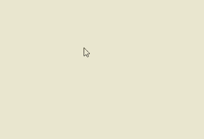

    Now the report still has to be sent. Windows rigidly expects the mouse to report, among other things, two bytes representing the cursor offset. All you need to do is send this via the HID, as in the previous example. For the example, I send the data resulting in a circular movement of the cursor. I didn't want to count trigonometry, so I generated an array resulting in circular movement:
    Code: C / C++
    Sending reports - looped index:
    Code: C / C++
    Generation of HID packet for mouse - format as expected by computer.
    Code: C / C++
    The result - the mouse does circles under any system, practical use is not there, but you can make a joke for someone.
