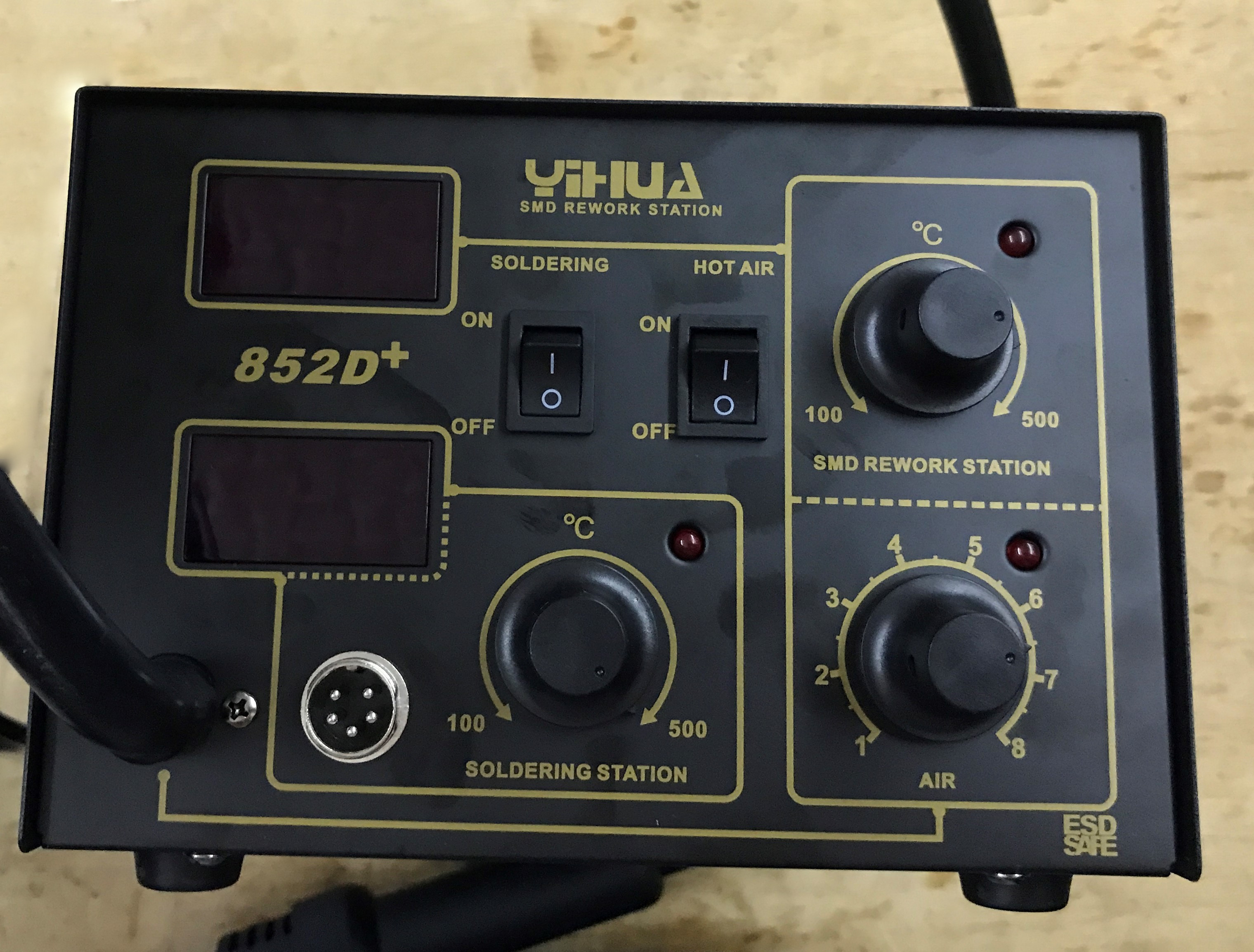

Two soldering irons in one kit and for only PLN 300 - is that a good deal? Here I'll introduce the Yihua 852D+ station and see how comfortable it actually is to work on a motherboard with it. I will test both a hot air and a flask soldering iron. I will take measurements at the 100°C, 350°C and 450°C temperature settings and check how much the sensor will actually heat up to. I will check the advertised asset of this station - the 24L/min diaphragm pump from the centre.
Let's start with the packaging and contents of the kit. The packaging is for a whole series of different stations, including one bearing the mysterious name of USB. It will be interesting to see what the hardware is. The whole thing inside is safely packed for travel, wrapped in polystyrene, and a single manual in duplicate will help us get started with the equipment. In addition, I received three nozzles and a sponge soldering iron stand.
Before starting, unscrew the transport screws located at the bottom, these are marked in red.
This frees this mighty giant of soldering from its cage, but is the enthusiasm justified?
Ostensibly a diaphragm pump in an enclosure has better reviews than blowing from a flask, but let's find out.
Tests of the flask soldering iron At first glance, the soldering iron works well. You can solder goldpins, SMD capacitors, solder parts from an old TV board.... the stairs start when you have large mass spouts and it takes a lot of heat to get the solder hot.
I artificially prepared a test environment - a large motherboard with a copper spout, and a wire soldered to it.
I started the test with a cold soldering iron. I set it to 400°C. After a minute the solder joint started to melt, but the soldering iron did not give. After a minute and a half I removed the wire.
Same thing at 500°C:
Similarly, also more than a minute needed.
I tried more difficult tasks, such as cleaning the pads after the BGA, but here the soldering iron can no longer cope - the board is too massive:
Hot air tests First a warning - the tests presented here do not show the correct method for flying out components and can be destructive to the PCB. Every test starts with a cold board and flask.
The first test was at 350 °C and involved soldering the coil off the board. From cold PCB and soldering iron, it took 50 seconds to remove the component. However, something else caught my eye - noise and vibration :
I've never had this, and I test a lot of hot air.... everything shakes! It's that diaphragm pump....
Test number 2, the chip in 50 seconds:
Attempt number 3, still the same settings, but without the nozzle. The elements are coming off nicely.
Ok, now 400 °C. Continuing full blow. Managed to remove the tiny BGA chip in 40 seconds.
Larger RAM? One minute and 20 seconds. That can be done too.
Another 450 °C. In less than three minutes, the CPU was successfully removed.
Second test - HDMI in over a minute:
Heats well, just that comfort is poor.
Measurements I took temperature and power measurements based on my post presented in a separate topic: OpenBeken configuration for hot air testing - MAX6675, temperature and power logging I wanted to test the actual temperature on the sensor at settings of 100 °C, 350 °C and 450 °C. In addition, I compared the half blow setting to the full blow setting.
https://openshwprojects.github.io/hotair/852Dplus.html 100 °C is overshooting a little. The other temperatures, as is usual in my tests, are much lower in practice at the probe. Less blowing in theory means more spot and slower heating, although my probe didn't show this as much.
Comparison with other stations:
https://openshwprojects.github.io/hotair/version11/450c.html https://openshwprojects.github.io/hotair/version11/350c.html Similarly, as with other stations, these temperatures from the display are not reached. These are only approached by the Sugon 8630 PRO and the Quick 861DW. Also the classic 858 slightly beats this station, although it could probably be better calibrated. It's also interesting to see how much power the station draws, at the initial stage it's almost 700 watts and then quickly drops and stays in the 200-300 watt range. Overall, it's not so bad, there's not the problem of, for example, the cheap and lightweight JCD, that you could heat and heat and the binder wouldn't melt anyway, because the temperature on the PCB was underestimated by a good 100 °C.
Interior of Yihua 852D+ Let's take a look inside. The first thing that catches the eye is the diaphragm pump attached with tritones. In addition, we see the classic massive mains transformer. All the electronics are one panel.
Diaphragm pump 18 W, 32L/min... yes, 32L/min, not 120.
The housing is earthed:
PCB designation: 852D+V5_2-QB , you can see the UTC358D operational amplifier on the PCB:
Could it be the calibration buttons?
BT137 triac for power regulation:
The station is based on the S3F94C8EZZ-DK98 8-bit microcontroller:
Instructions Clear photos of the English-language manual:
The instructions also explain the blowing power - this depends on the version, we have either up to 120L/min or 24L/min. What's more, both versions come on the same model of station - am I interpreting this correctly? My version is pump-based, so I have about up to 24L/min.
Summary I wasn't convinced by this 24L/min diaphragm pump though. I think I would prefer the cheapest classic 858 with a 120L/min fan.
Basically, I have two complaints here:
- this station is extremely noisy and spreads strong vibrations over the table, I have not encountered something like this in either the cheaper 858 or the very expensive Sugon and Quick
- the cob part of this station doesn't offer any revelations, it's no different for me from cheap portable soldering irons, and it only has 60 watts, if I were to buy a set, I would prefer something more powerful. I'm not even pushing for T12 arrowheads here, but the power has to be there.
The rest rather as expected, but so what, as the difficulties detected worsen my working comfort.
And what is your opinion? Is such a station a good choice? Diaphragm pump - is it worth it?

Does the 900 series mainsail have this "60 watts"?
The transformer is poor enough.... [Read more]
Nargo
17 Apr 2026 12:43
I have this station at home, I use it occasionally for lack of space.
I use the Hot Air instead of the tanning machine for heat shrink sleeves and SMD soldering.
The flask has a big drawback for me in... [Read more]
398216 Usunięty
17 Apr 2026 13:23
I apologise enormously, but I find the soldering iron test (first two videos) ... unreliable.
Why? And who uses an SMD soldering tip to solder such a large pad? The situation here is similar - a thin... [Read more]
James596
17 Apr 2026 14:32
I had the opportunity to use such a set.
In fact, it is a howler, it also telephones impossibly. For occasional use, OK.
With more intensive use, after a while the hot-air lost its properties, soldering... [Read more]
Xenlin93
18 Apr 2026 02:40
Nobody wants to appear. The only thing good about Yihua / WEP / Zhaoxin is the low price. These negative reviews don't come "out of thin air" because people have become so fixated on a cheap Chinese product....... [Read more]
398216 Usunięty
18 Apr 2026 14:24
One swallow does not make a spring....
And seriously - I understand your colleague's resentment of this soldering iron, but (bearing in mind the above quoted proverb) is this immediately indicative of... [Read more]
nostromo
18 Apr 2026 21:06
I have had an original Zhaoxin 852D station for 15 years. Other companies made counterfeits (Chinese counterfeit Chinese). It works perfectly. The only problem I've had is that the air adjustment potentiometer... [Read more]
Xenlin93
18 Apr 2026 23:06
Of course it doesn't but these are not isolated cases. We had 4 of them in the service and for pi times door 2 years of daily grind of 8-10h a day 6 cobs flew apart if my memory serves me right. The problem... [Read more]
398216 Usunięty
19 Apr 2026 07:56
This is acutely patented by Yihuia or similar flasks. As far as I know there have been several different designs of the flask itself - including the mount you write about. My 900'ka doesn't have a screw... [Read more]
Xenlin93
19 Apr 2026 12:10
Yihua's patent with these flasks is precisely this plastic nut being the weakest link. And most often they break right there. Maybe we didn't understand each other exactly what I mean, that's why I'm pointing... [Read more]
partyzancik
19 Apr 2026 21:33
After unscrewing the screws marked in red, the pump housing rose higher above the bottom of the housing ? Maybe it rubs when working and is noisy. The housing feet are typically rubber or plastic ? [Read more]
Mateusz_konstruktor
23 Apr 2026 19:49
On the other hand, an even earlier name was 'PT', with particular emphasis on the PT852 model. These are successive variants, differing in detail and having their origins many years back. Hardly anyone... [Read more]
filipcichowskidev
18 May 2026 20:43
Under such a board it is already better to take a stencil, spread paste and solder with hot or reflow oven. [Read more]
