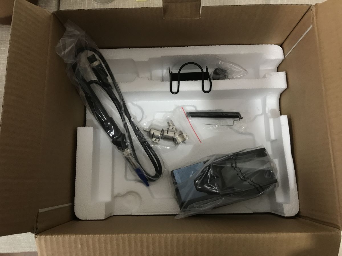

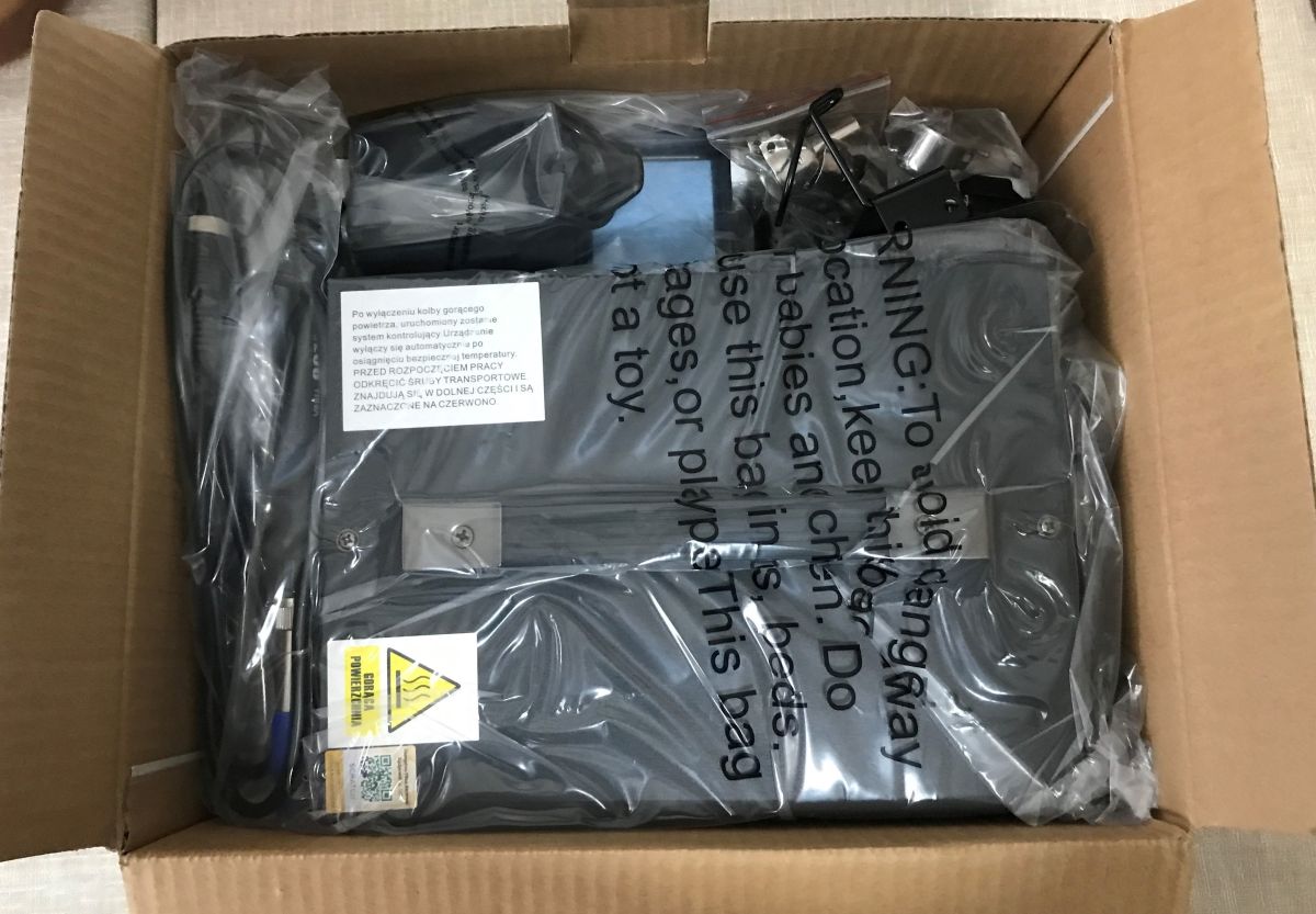

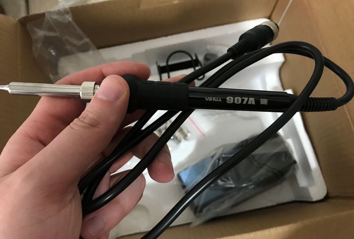

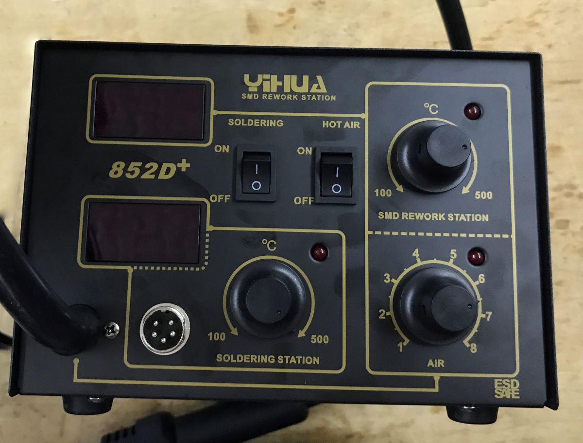

    Let's start with the packaging and contents of the kit. The packaging is for a whole series of different stations, including one bearing the mysterious name of USB. It will be interesting to see what the hardware is. The whole thing inside is safely packed for travel, wrapped in polystyrene, and a single manual in duplicate will help us get started with the equipment. In addition, I received three nozzles and a sponge soldering iron stand.
    Practical test of the Yihua 852D+ soldering station (2-in-1, hot air 700 W and 60 W 900M flask solde Practical test of the Yihua 852D+ soldering station (2-in-1, hot air 700 W and 60 W 900M flask solde Practical test of the Yihua 852D+ soldering station (2-in-1, hot air 700 W and 60 W 900M flask solde Practical test of the Yihua 852D+ soldering station (2-in-1, hot air 700 W and 60 W 900M flask solde

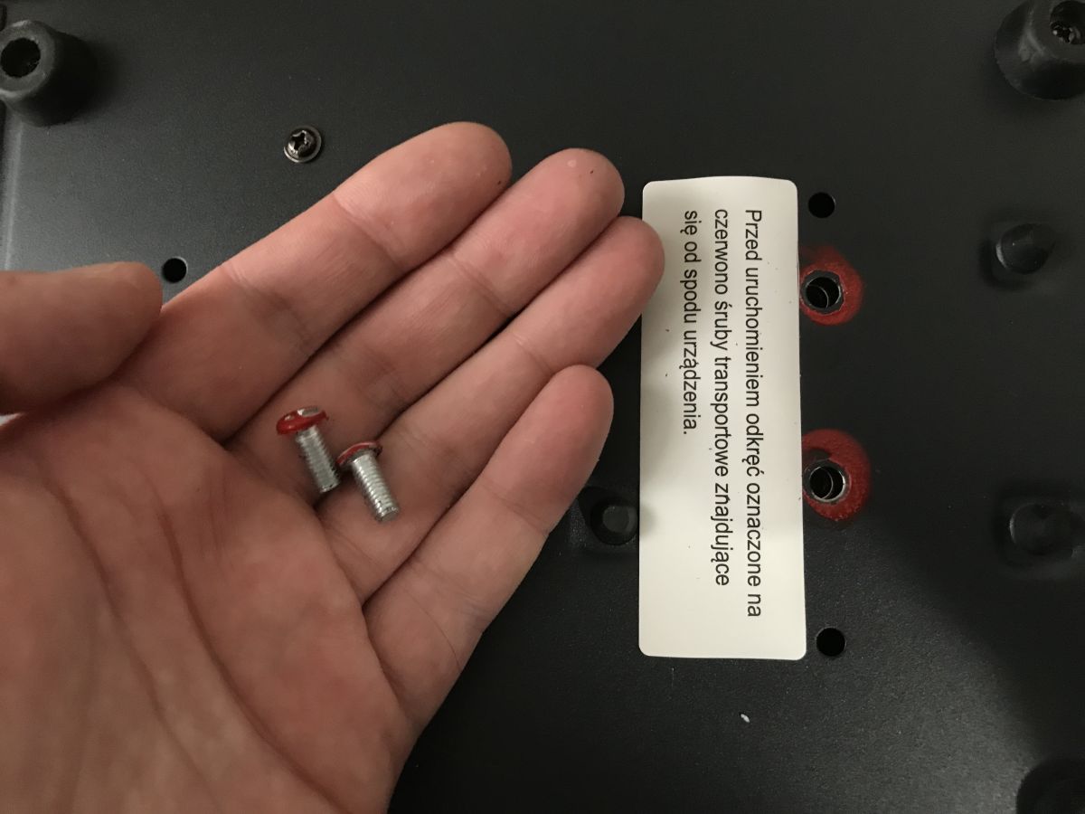

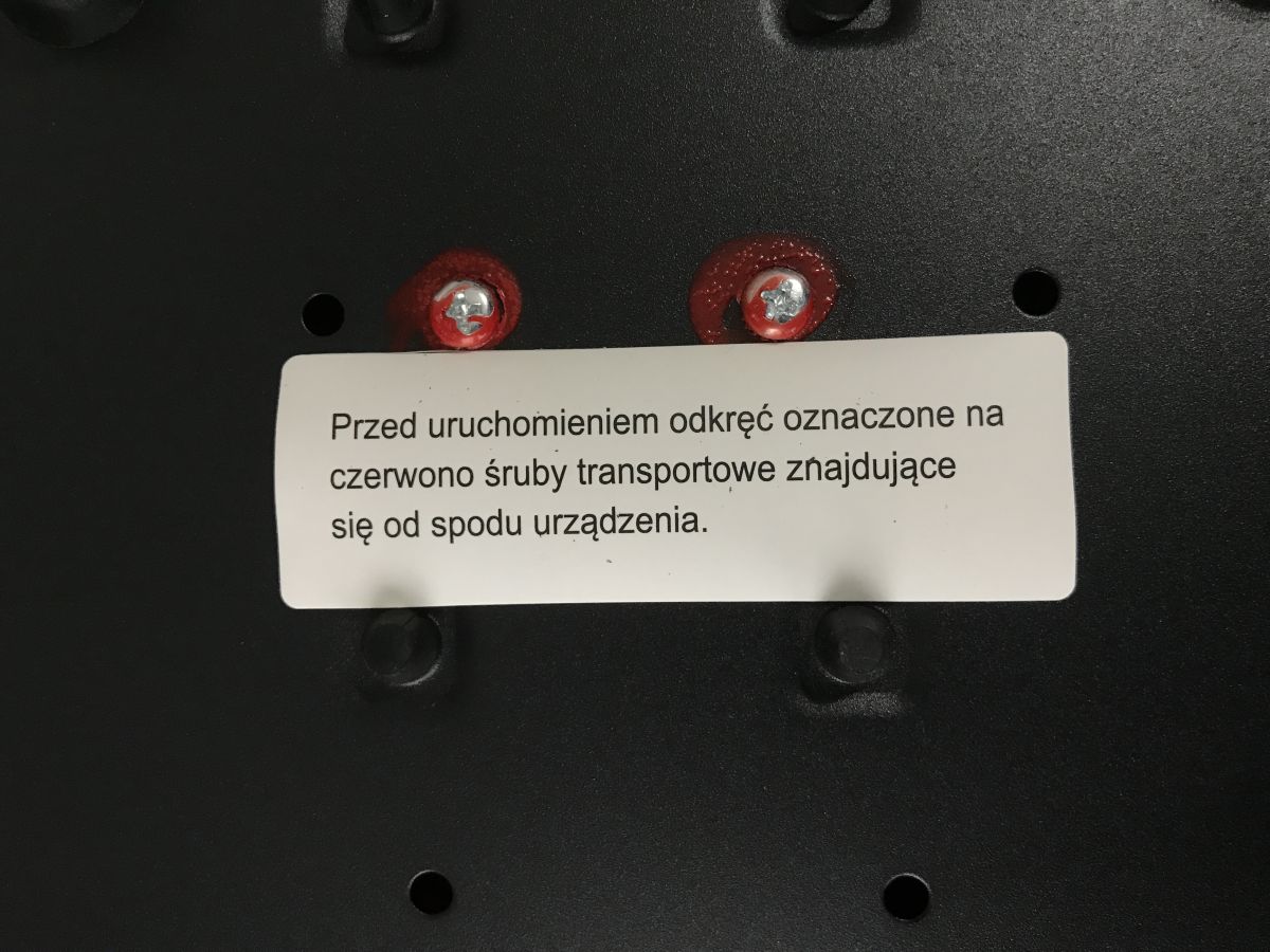

    Before starting, unscrew the transport screws located at the bottom, these are marked in red.
    This frees this mighty giant of soldering from its cage, but is the enthusiasm justified?

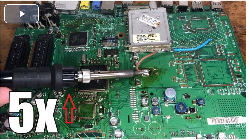

    Tests of the flask soldering iron
    At first glance, the soldering iron works well. You can solder goldpins, SMD capacitors, solder parts from an old TV board.... the stairs start when you have large mass spouts and it takes a lot of heat to get the solder hot.

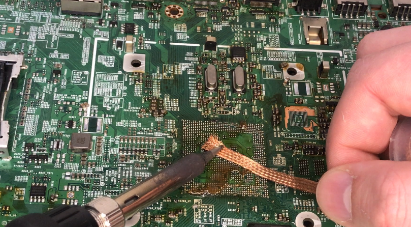

    I artificially prepared a test environment - a large motherboard with a copper spout, and a wire soldered to it.
    I started the test with a cold soldering iron. I set it to 400°C. After a minute the solder joint started to melt, but the soldering iron did not give. After a minute and a half I removed the wire.
    Same thing at 500°C:
    Similarly, also more than a minute needed.
    I tried more difficult tasks, such as cleaning the pads after the BGA, but here the soldering iron can no longer cope - the board is too massive:

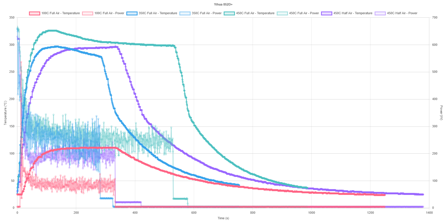

    Measurements

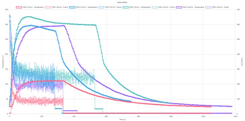

    I took temperature and power measurements based on my post presented in a separate topic: OpenBeken configuration for hot air testing - MAX6675, temperature and power logging
    I wanted to test the actual temperature on the sensor at settings of 100 °C, 350 °C and 450 °C. In addition, I compared the half blow setting to the full blow setting.
    https://openshwprojects.github.io/hotair/852Dplus.html
    100 °C is overshooting a little. The other temperatures, as is usual in my tests, are much lower in practice at the probe. Less blowing in theory means more spot and slower heating, although my probe didn't show this as much.
    Comparison with other stations:
    https://openshwprojects.github.io/hotair/version11/450c.html
    https://openshwprojects.github.io/hotair/version11/350c.html
    Similarly, as with other stations, these temperatures from the display are not reached. These are only approached by the Sugon 8630 PRO and the Quick 861DW. Also the classic 858 slightly beats this station, although it could probably be better calibrated. It's also interesting to see how much power the station draws, at the initial stage it's almost 700 watts and then quickly drops and stays in the 200-300 watt range. Overall, it's not so bad, there's not the problem of, for example, the cheap and lightweight JCD, that you could heat and heat and the binder wouldn't melt anyway, because the temperature on the PCB was underestimated by a good 100 °C.

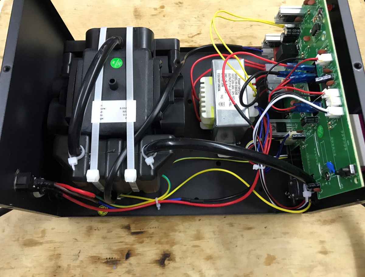

    Interior of Yihua 852D+

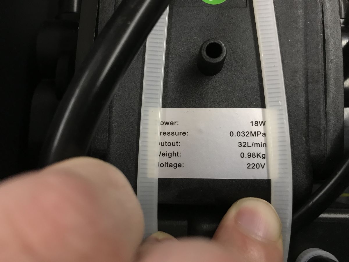

    Let's take a look inside. The first thing that catches the eye is the diaphragm pump attached with tritones. In addition, we see the classic massive mains transformer. All the electronics are one panel.
    Diaphragm pump 18 W, 32L/min... yes, 32L/min, not 120.

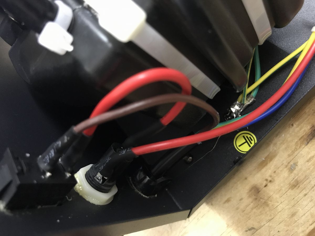

    The housing is earthed:

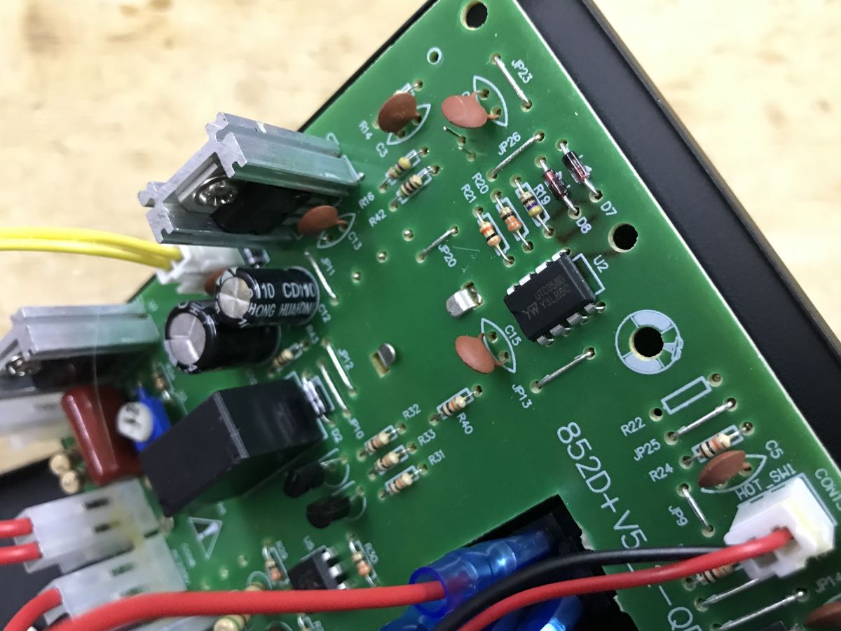

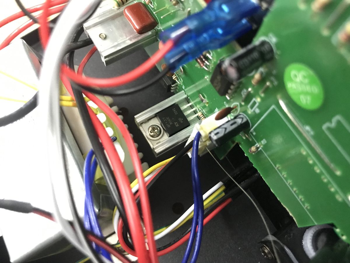

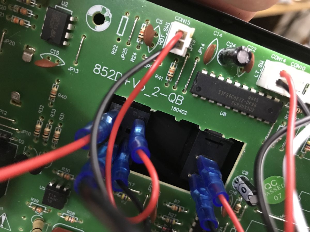

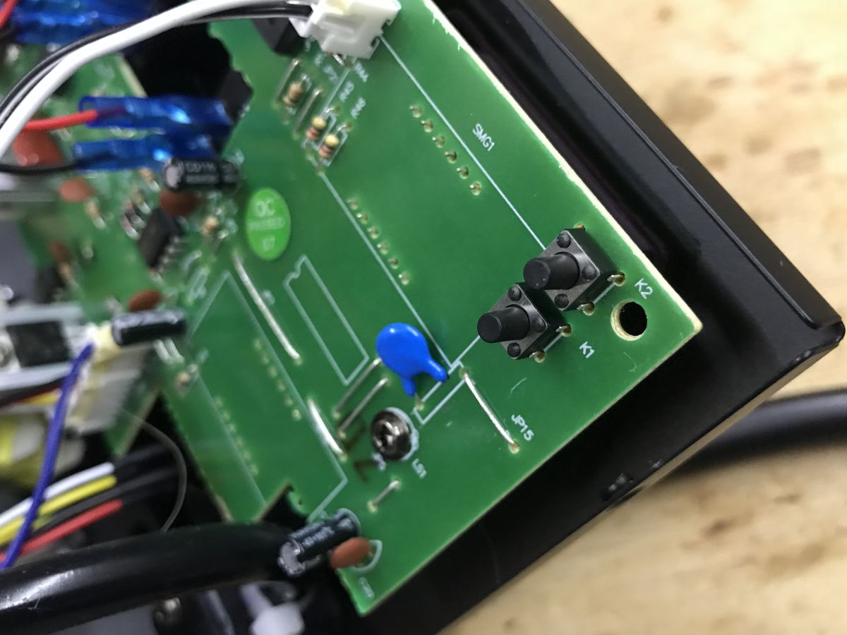

    PCB designation: 852D+V5_2-QB , you can see the UTC358D operational amplifier on the PCB:
    Could it be the calibration buttons?
    BT137 triac for power regulation:
    The station is based on the S3F94C8EZZ-DK98 8-bit microcontroller:

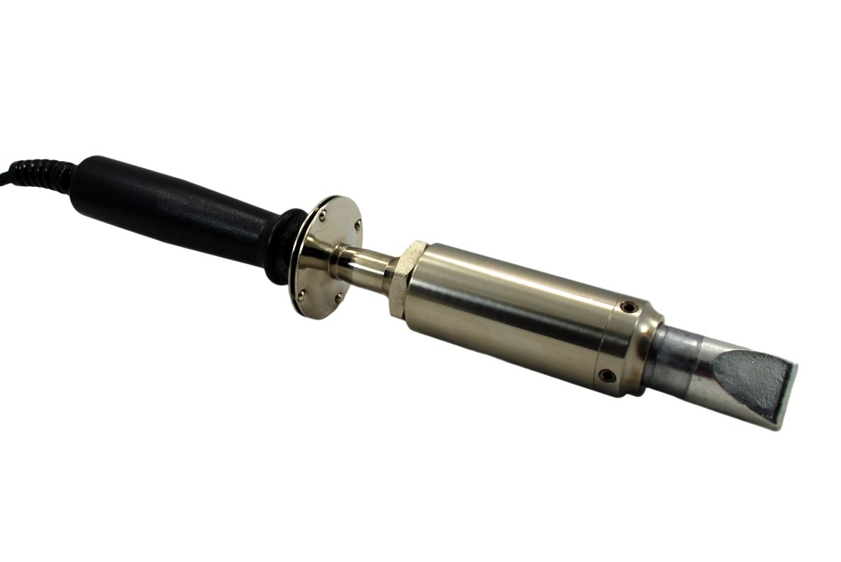

  • Wide tip needed for realistic soldering test

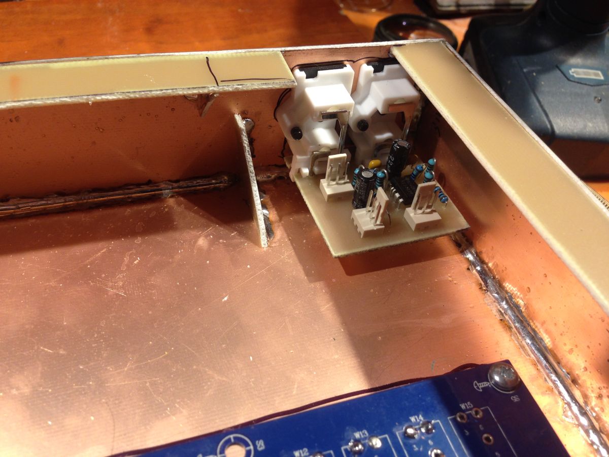

    And for dessert... a colleague showed off his project. This, to make my point a little better and why I would advise against such an archaic WEP....
    I solder these types of structures and it is through the prism of such electronics that I turn my attention to purchasing equipment that is supposed to make this job easier for me ;)

  • Noise and vibration from the diaphragm pump questioned
    #12 21886974
    partyzancik
    Level 25  
    Posts: 1378
    Help: 14
    Rate: 178
    Summary
    I wasn't convinced by this 24L/min diaphragm pump though. I think I would prefer the cheapest classic 858 with a 120L/min fan.
    Basically, I have two complaints here:
    - this station is extremely noisy and spreads strong vibrations over the table, I have not encountered something like this in either the cheaper 858 or the very expensive Sugon and Quick
    - the cob part of this station doesn't offer any revelations, it's no different for me from cheap portable soldering irons, and it only has 60 watts, if I were to buy a set, I would prefer something more powerful. I'm not even pushing for T12 arrowheads here, but the power has to be there.
    The rest rather as expected, but so what, as the difficulties detected make my working comfort worse.
    And what is your opinion? Is such a station a good choice? Diaphragm pump - is it worth it?
    After unscrewing the screws marked in red, the pump housing rose higher above the bottom of the housing ? Maybe it rubs when working and is noisy. The housing feet are typically rubber or plastic ?
    I solder these types of structures and it is through the prism of such electronics that I look at buying equipment to facilitate this job for me ;)
    Under such a board it is already better to take a stencil, spread paste and solder with hot or reflow oven.

  • The tested station combines 700 W hot air with a 60 W 900M iron, and the hot air initially draws almost 700 W before settling near 200–300 W. [#21885538]
  • Real hot-air work from a cold PCB was possible: a coil came off in 50 s at 350°C, a small BGA in 40 s at 400°C, RAM in 1 min 20 s, and a CPU in under 3 min at 450°C. [#21885538]

What should you do with the transport screws on the bottom of the Yihua 852D+ before first use?
Remove the transport screws from the bottom before first use. The reviewer marked them in red and explicitly said to unscrew them before starting. Those screws lock the unit for shipping, so leaving them in place can keep the internal assembly constrained. This is the first setup step before any hot-air or iron test. [#21885538]
How accurate is the Yihua 852D+ temperature display at 100°C, 350°C, and 450°C in real measurements at the probe?
The display reads higher than the probe temperature at 350°C and 450°C, while 100°C overshoots slightly. The reviewer measured the station externally and said the higher setpoints were, as usual in these tests, much lower at the probe. He also noted that 100°C overshot a little. In short, the displayed values were not fully reached in real probe measurements. [#21885538]

How can you calibrate or check the real temperature of a Yihua 852D+ using an external probe such as a MAX6675-based setup?
You can verify it with an external thermocouple setup and compare probe readings to the station display.
  1. Set the station to fixed points such as 100°C, 350°C, and 450°C.
  2. Measure the real probe temperature at half and full airflow.
  3. Compare the measured values with the display and note the offset.
The reviewer used a MAX6675-based logging setup and found that the displayed higher temperatures were lower in real probe measurements. [#21885538]
What components are inside the Yihua 852D+, including the transformer, BT137 triac, UTC358D, and S3F94C8EZZ-DK98 microcontroller?
Inside, the station uses a diaphragm pump, a large mains transformer, a single main PCB, a BT137 triac, a UTC358D operational amplifier, and an S3F94C8EZZ-DK98 8-bit microcontroller. The pump itself was marked 18 W and 32 L/min. The reviewer also confirmed that the metal housing was earthed. Those details show a conventional mains-powered analog-plus-MCU control layout. [#21885538]
