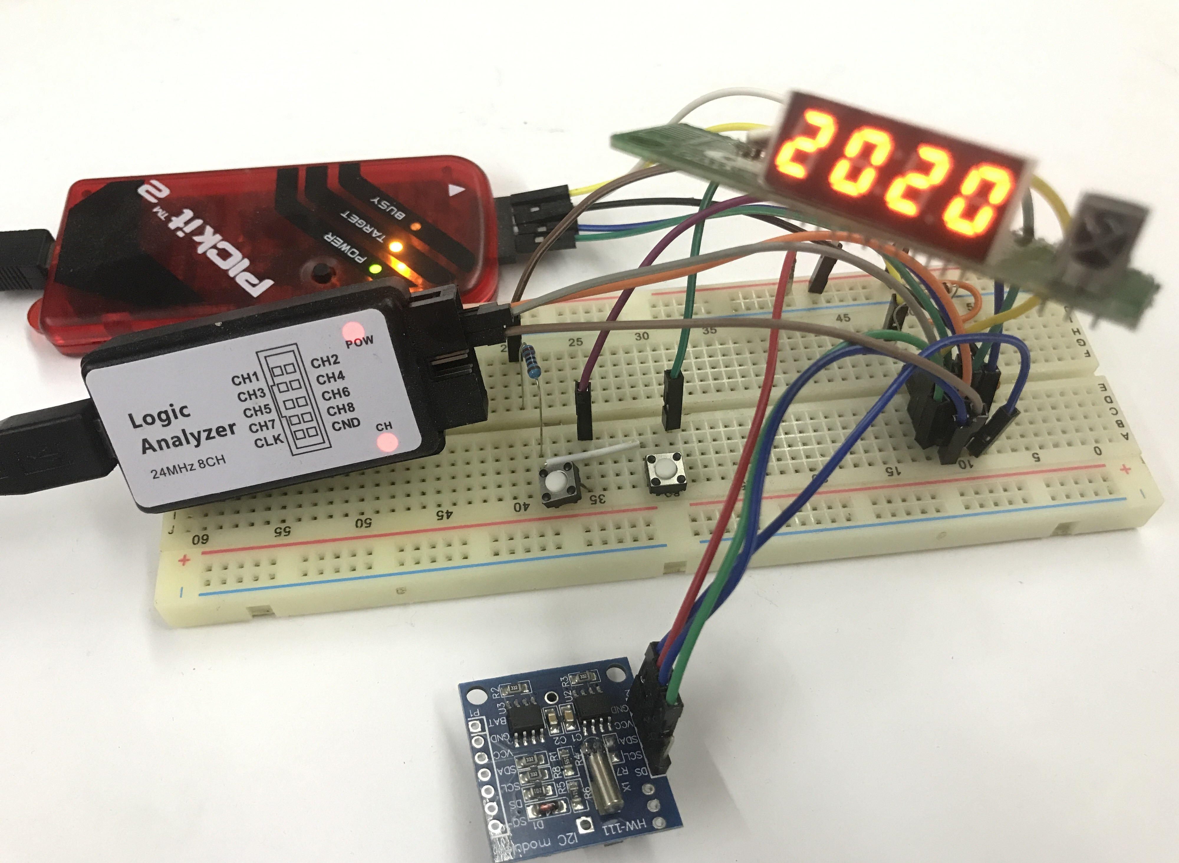

Today we are building a tiny clock with time keeping, we will realise it based on an 8-bit PIC12F683 microcontroller with only 128 bytes of RAM, a 7-segment display module with FD650 controller recovered from electro-junk and a DS1307 RTC clock. I will also show full waveforms from I2C communication captured with a logic analyser in the theme.
Why not one I2C bus?
Let's start with the most important design problem and the obvious question that probably occurs to everyone after reading the introduction to this topic - why two I2C buses at all? Is it not possible to use addresses?
Unfortunately, it so happens that a large number of popular Chinese chips do not fully adhere to the I2C standard and do not support addressing - there, the first byte sent is not the address of the individual chip, but e.g. a command or immediately the address of the register on which we operate.
There is a similar problem with the FD650, on which I based this design. The FD650 is a clone of the TM1650, it also appears under the name HD2015. I have already described it extensively in a topic:
Running the HD2015 display/button controller after reverse engineering, comparison with TM1637
The FD650 has the very affliction that it will interfere with our other addresses on the bus.
The other element used in the project, the DS1307, is fully I2C-compatible and doesn't do the problem, but so what?
The bus needs to be split - I decided to have two SDA data lines and a common clock SCL .

The whole problem here is that I can't put the DS on the same bus as the FD650, because the FD650 doesn't support addressing in principle and takes up all addresses - I showed this in the paragraph "I2C scan with FD650".
For this reason I have introduced dividing the bus , as announced.
Now:
- SDA of the display is pin 0
- sCL common is pin 2
- SDA of the clock is pin 1
To save memory, I broke the DRY (Don't Repeat Yourself) rule and prepared two sets of I2C functions - one for pin 0, the other for pin 1.
Code: C / C++
The pull up resistors turned out to be unnecessary again - the ones from the PIC are sufficient. The code shown works - the time is counted down and displayed. Previously the RTC had to be programmed once, but for now let's assume we did it manually, separately....
The pictures show the time in mm:ss format, so it may seem odd, but it's more convenient to test this way.
What does it look like under the hood? I have connected a logic analyser to the D0 (clock), D1 (SDA first) and D2 (SDA second) lines. I have added I2C decoders.
When zoomed in you can see the correctly decoded transactions. No problems with start/stop conditions, no "ghosts" on the line:
This is what the time reading from the DS1307 looks like. You can see the characteristic address 0x68 (after shifting and adding the read/write bit 0xD0 or 0xD1) and reading from registers 0, 1, and 2, the value 00:28:50.
Similarly, the display control. Here you can see the sent segments of the individual digits.

Result:
