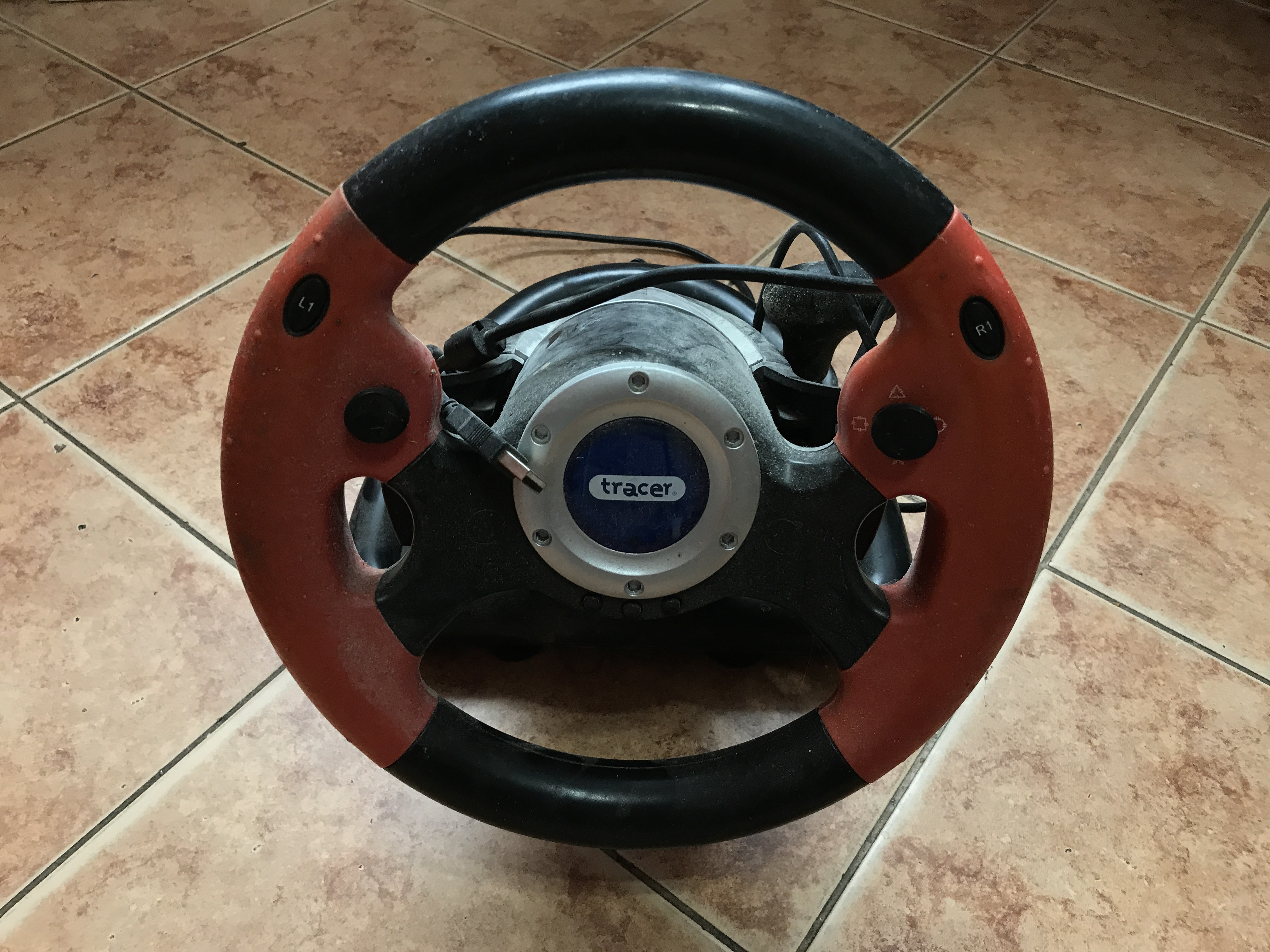

I recently presented the running of the PIC16LF1659 as an HID keyboard or mouse controller . A gamepad or joystick can also be realised in a similar way, it just remains to determine how to handle the buttons and axes. This is a great opportunity to take a look inside two products that I've had set aside in the attic for a while.
The first piece of hardware to be showcased is the MX-V9 Vibration steering wheel, which works with either a PlayStation console or a PC via USB. As the name suggests, it is equipped with an additional feedback system via vibration, the mechanism of which we will also get to know.
Importer - Megabyte, manufacture in China. There is a Playstation/PC switch on the bottom.
The whole thing is held together by countless screws. You can tell by the PCB inside that the hardware is quite old. I was surprised that the separate modules are on plugs, probably this is from before the cost cutting. You can also immediately see how the steering wheel deflection is measured - it's just a potentiometer.
The LED is mounted via hot glue:
Here's another cable mentioned - Playstation or USB:
As for this potentiometer, it is linear, 20 kΩ. The letter B stands for linear. Type A - logarithmic - is also popular, e.g. for audio, but it wouldn't make sense here.

Summarising , it's all just based on buttons (zero-one state - pressed or released), potentiometers (as a voltage divider - reading from the ADC) and possibly digital outputs to turn on/off LEDs and motors. There is not much philosophy here.
It should be possible to bring this to life with PIC , there are enough ADC channels, input pins reasonably too:
There is nothing left to do but to rewire the acquired electronics under the PIC and prepare the USB descriptors. This I will already show in the next topic.
