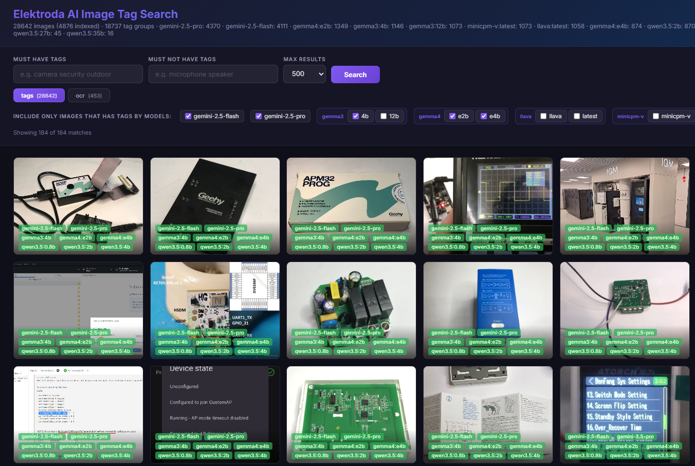

Tested models with number of described images (at the time of topic publication): gemini-2.5-pro (4370), gemini-2.5-flash (4111), gemma4:e2b (1349), gemma3:4b (1146), gemma3:12b (1073), minicpm-v:latest (1073), llava:latest (1058), gemma4:e4b (874), qwen3.5:2b (870), qwen3.5:4b (858), qwen3.5:0.8b (836), llava (379), minicpm-v (379), qwen3.5:9b (300), qwen3.5:27b (45), qwen3.5:35b (16).
The photo database will be updated , so the number of photos described will also grow. By force, the larger models take longer to process the photos, so the described ones have fewer examples.
Previous presentations in the series:
Intelligence has described over 1000 images from the Elektroda forum. How do you assess the results?
Is Qwen3.5 suitable for image description and OCR? Practical tests on your own computer
Image database preview.
Old UI version: https://openshwprojects.github.io/IndexingElektrodaImages/search.html
New UI version: https://openshwprojects.github.io/IndexingElektrodaImages/search2.html
