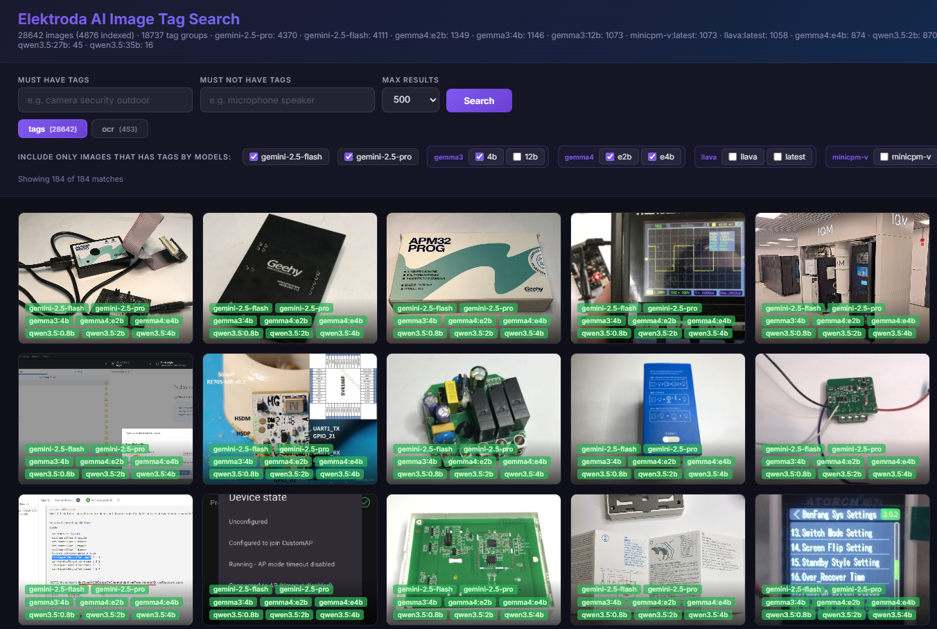

    Image database preview.
    Old UI version: https://openshwprojects.github.io/IndexingElektrodaImages/search.html
    New UI version: https://openshwprojects.github.io/IndexingElektrodaImages/search2.html

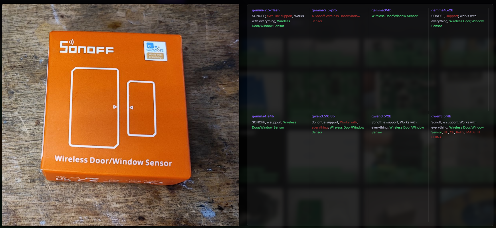

    OCR - something simple - Sonoff packaging:
    Practical tests of Gemma 4 and comparison with Gemini 2.5 - image tagging and OCR
    The main inscription "Wireless Door/Window Sensor" decoded every model tested - both the gemma4 and the professional gemini 2.5, as well as the slightly older qwen 3.5. It also went well with "Sonoff", but the gemma3 version 4b lost it. In addition, the other subtitles were also reasonably translated, although the eWeLink logo made the e itself.

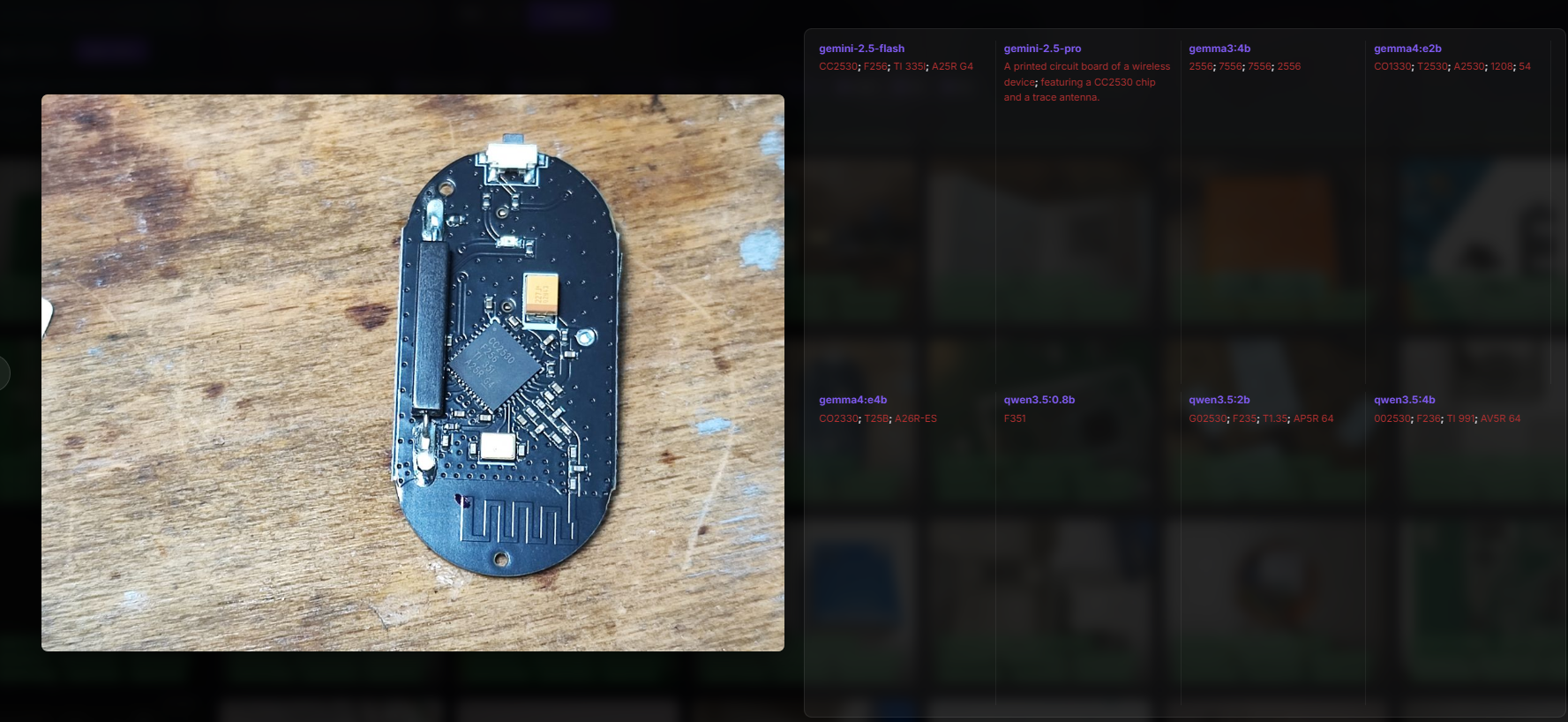

    OCR - CC2530 chip:
    Gemini coped with this. The other models had a problem. Gemma 4 was close, CO2330 came out, qwen too - G02530. Probably too poor quality, or these smaller models internally operate on too small graphics.

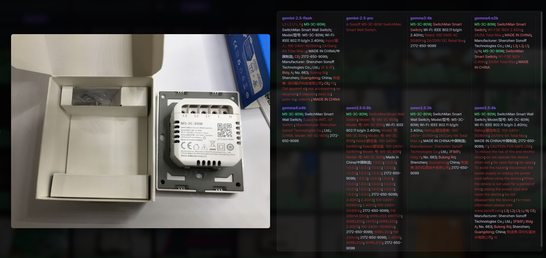

    OCR - the name of the switch:
    The product name is M5-3C-80W and it decoded every model. Not bad! The models also decoded the inscriptions in smaller print, such as "SwitchMan".

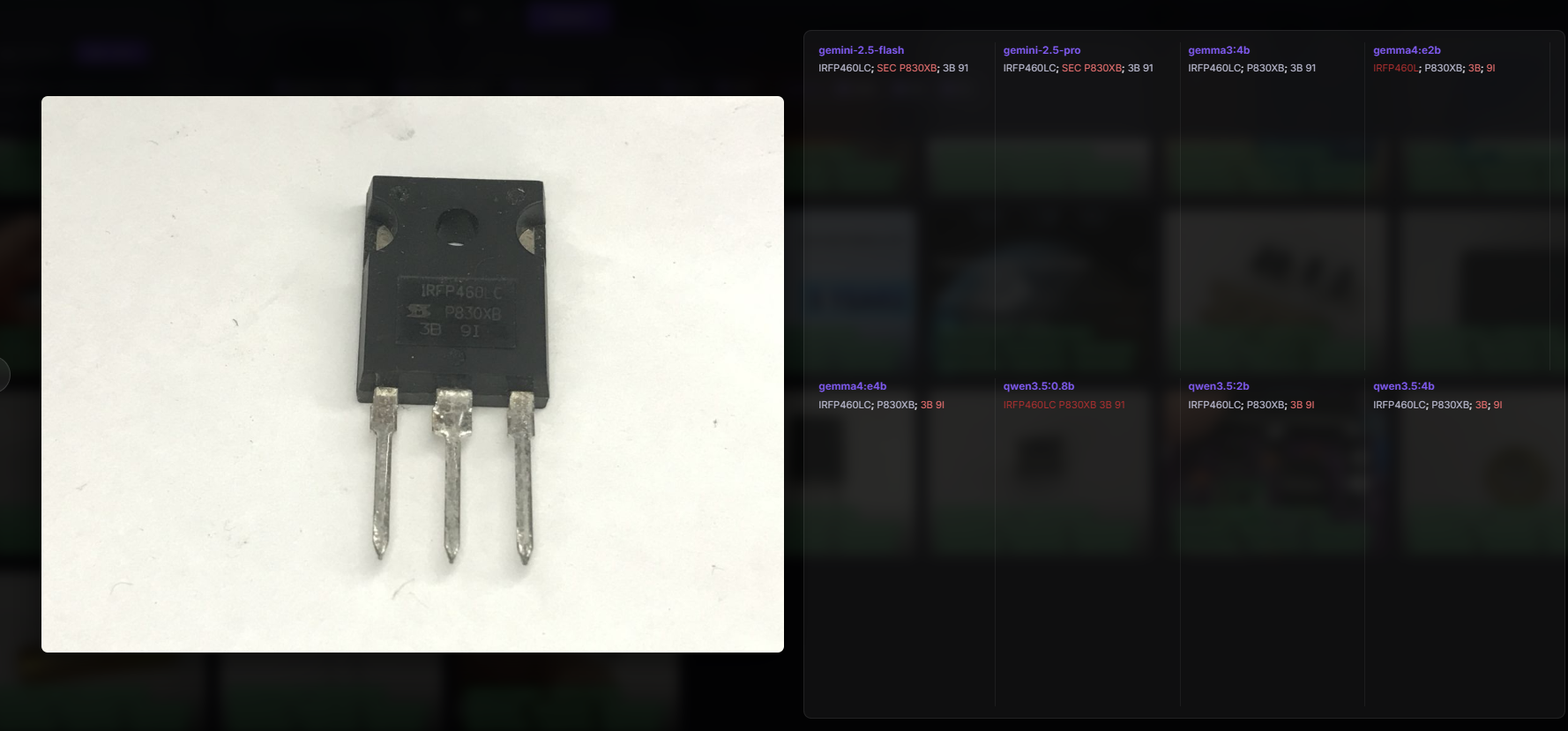

    OCR - IRFP460LC transistor:
    Every model correctly decoded the IRFP460L, only the gemma4 in the e2b version lost the 'C'.

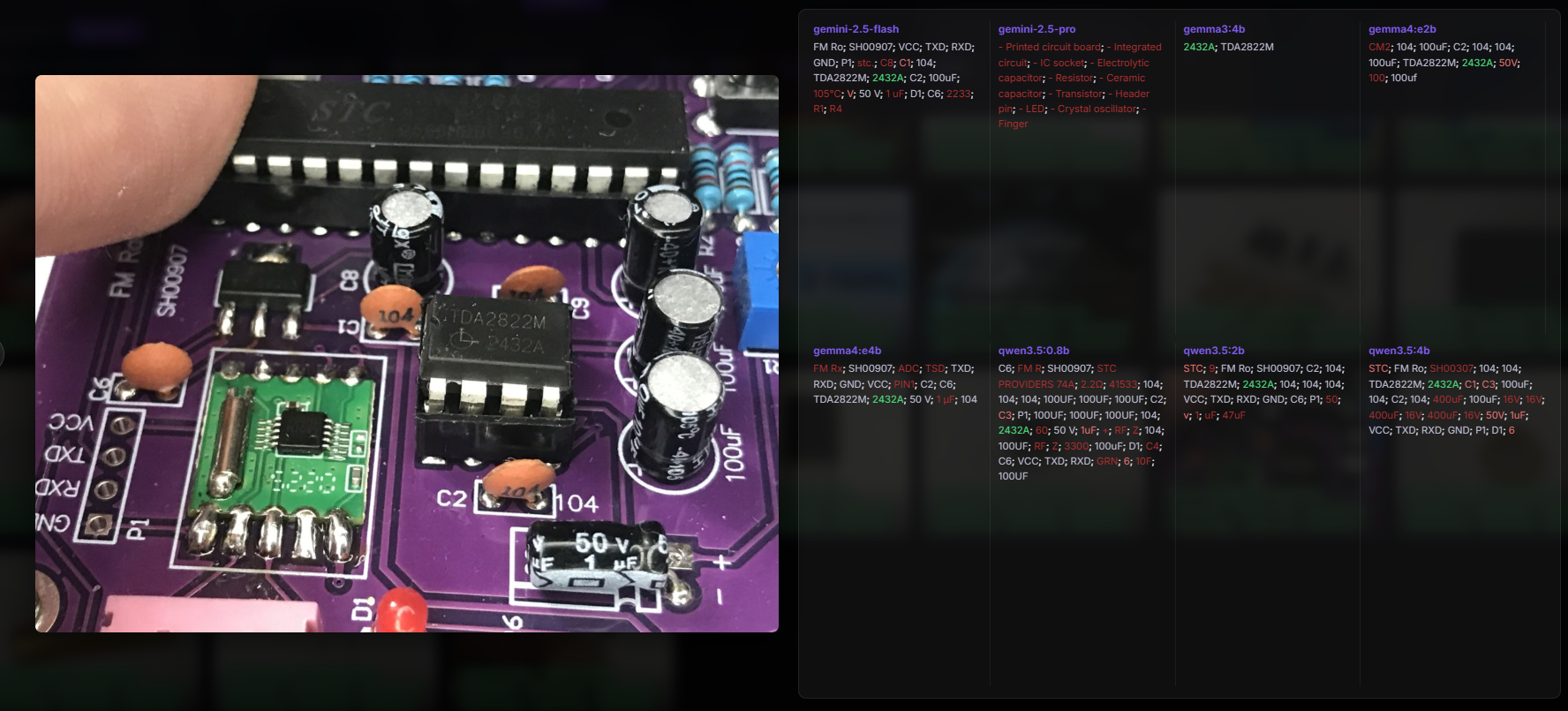

    OCR - TDA2822M audio amplifier:
    Virtually every model read the TDA2822M, the exception being the gemini 2.5 pro, which by some miracle started to list tags instead of reading subtitles. A large proportion of models also read more information from the board, RXD pads, TXD pads, etc.

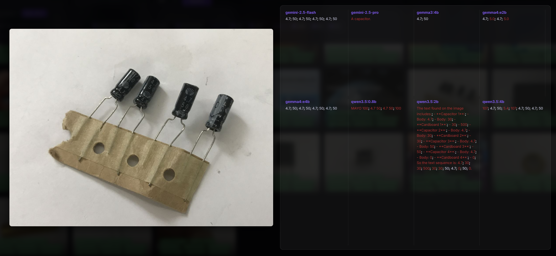

    OCR - electrolytic capacitors:
    The values 4.7 and 50 were read correctly, but are without units. In addition, gemma4, for example, misrepresented one of the values and the result was 5.0. All in all, however, the lack of units is understandable, as the photo does not show them either.

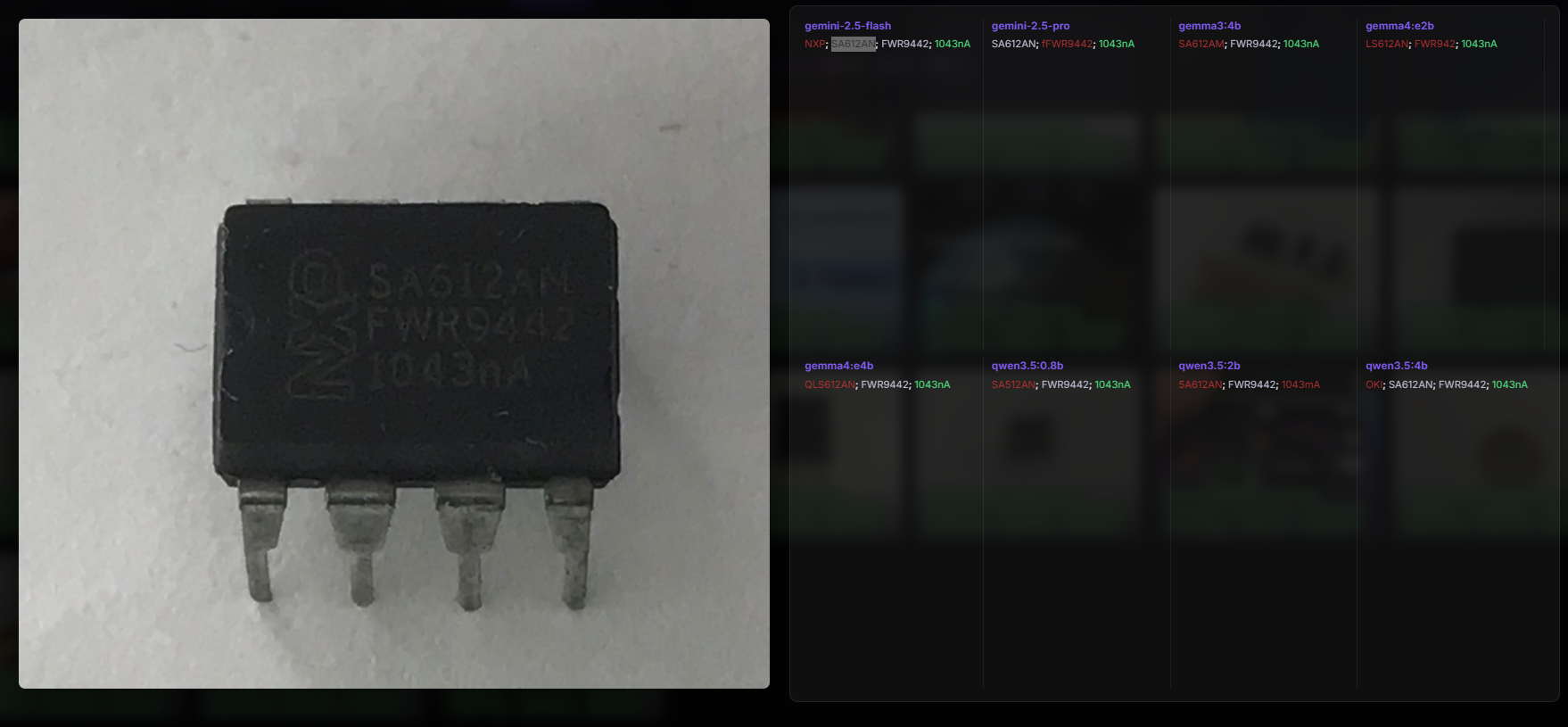

    OCR - SA612AN with NXP logo.
    It went quite well, although there are some hypocrisies, e.g. qwen3.5 rebranded as 5A612AN. Gemini 2.5 Flash was the only one to decode the NXP logo.

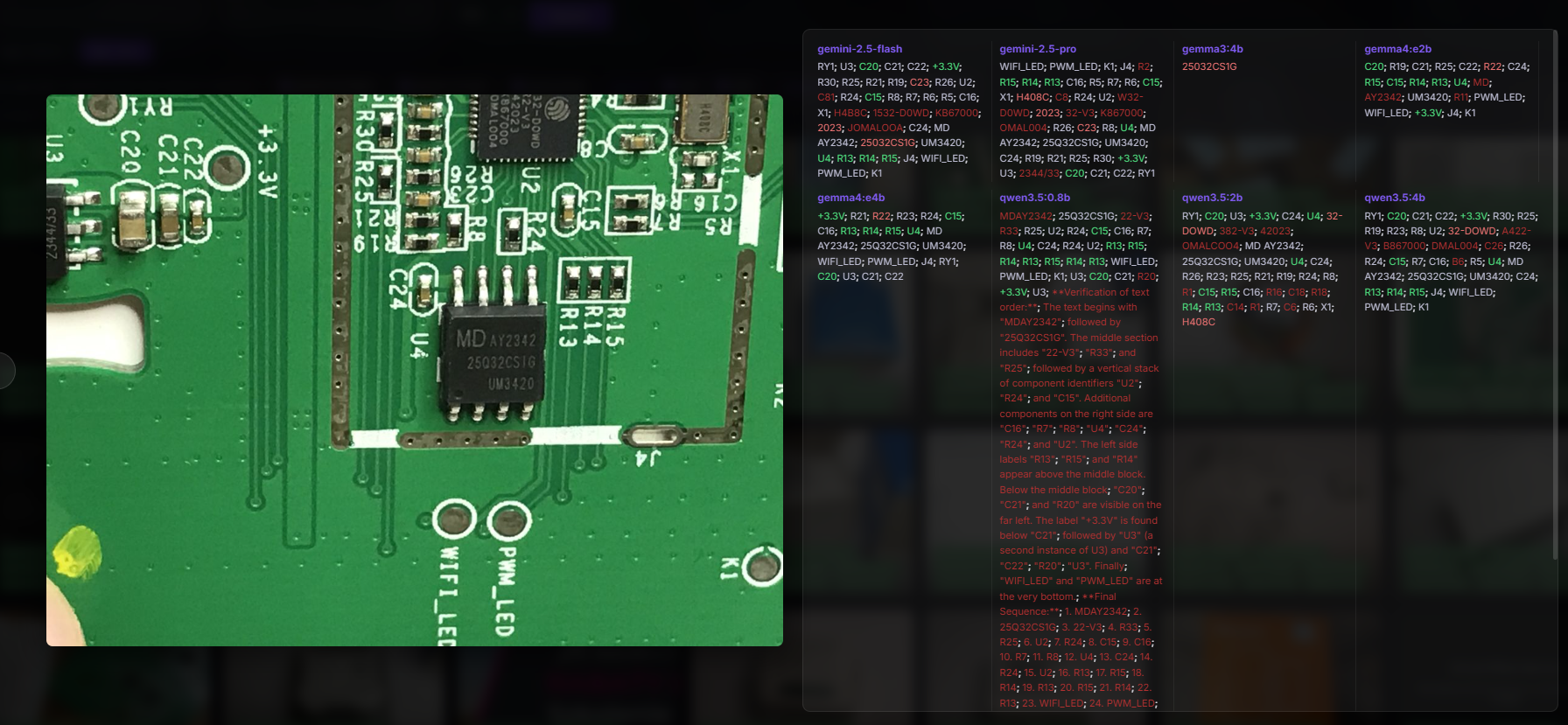

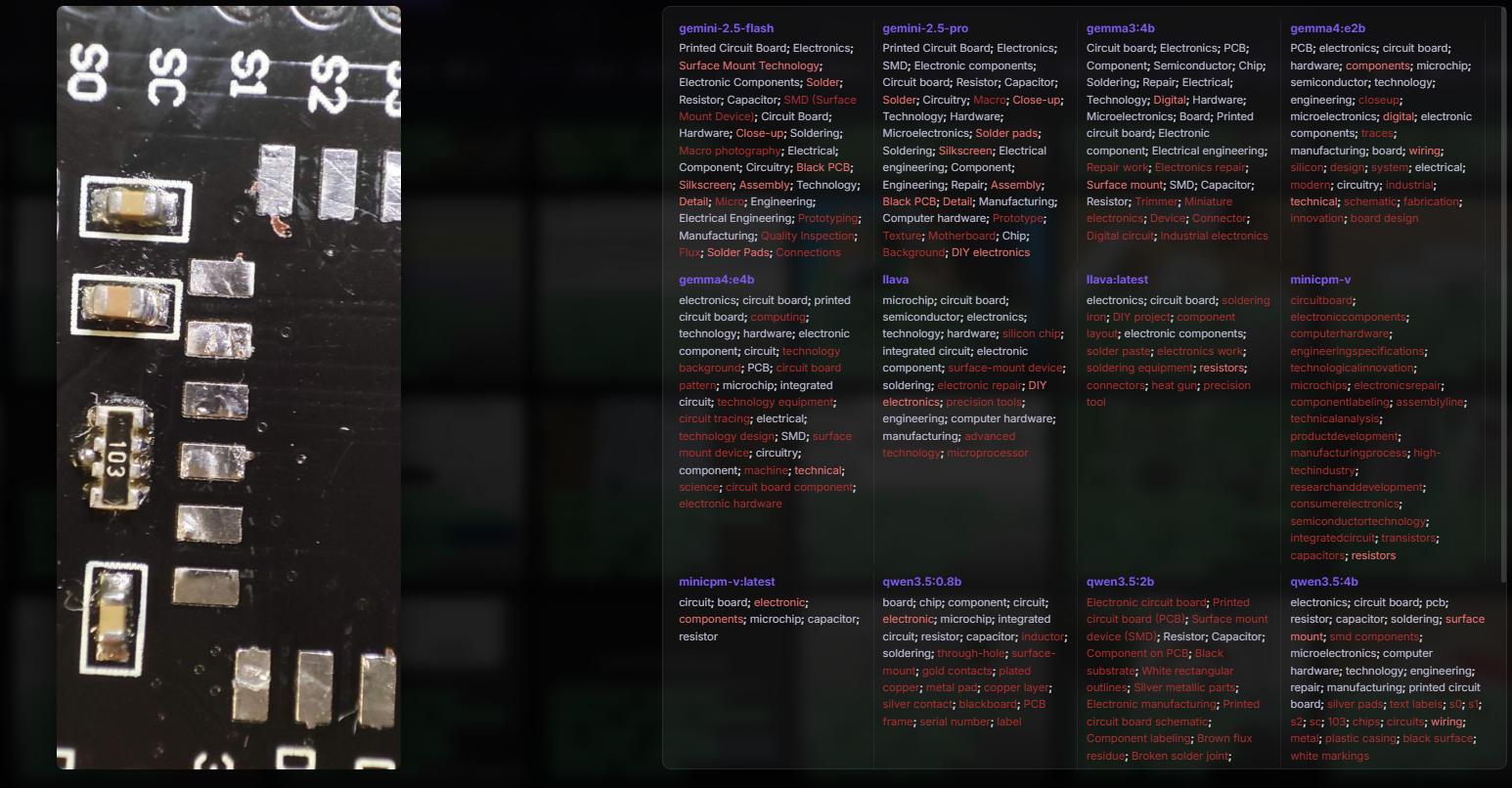

    Tags - board:
    You can see here how the newer and newer models are doing better. The old minicpm-v doesn't have precise keywords, but the new gemma does. It's only a pity about the keywords added by force, for example "heat gun" should rather not be here, but again, it's an older model - llava.

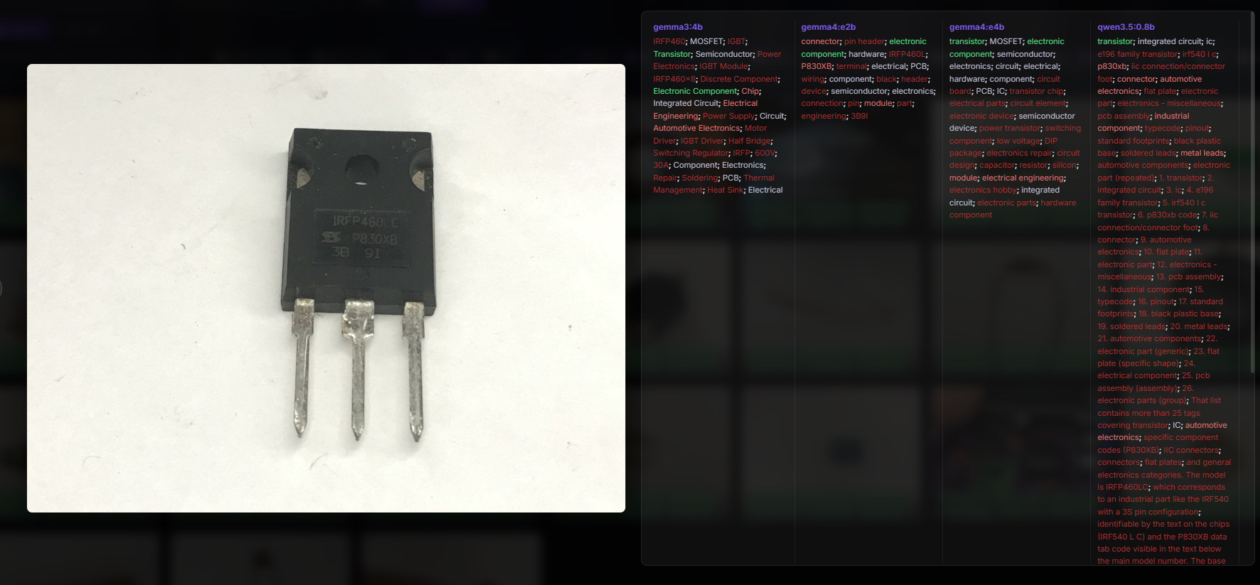

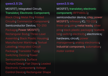

    Tags - IRFP460LC:
    Practical tests of Gemma 4 and comparison with Gemini 2.5 - image tagging and OCR Practical tests of Gemma 4 and comparison with Gemini 2.5 - image tagging and OCR
    This time the prompt was about the tags, but some models intelligently deciphered that it was an IRFP460 anyway, and even added MOSFET and IGBT tags. This is a MOSFET transistor with an N-type channel, so IGBT is not correct here, which makes me hesitate how to judge it. I was also surprised by this 600V and 30A at gemma3. This is not from its datasheet, so it must have been adjusted by force. Too bad qwen3.5 too guessed and even added some IRF540. Another qwen added the word Infineon, but it's not that manufacturer after all?

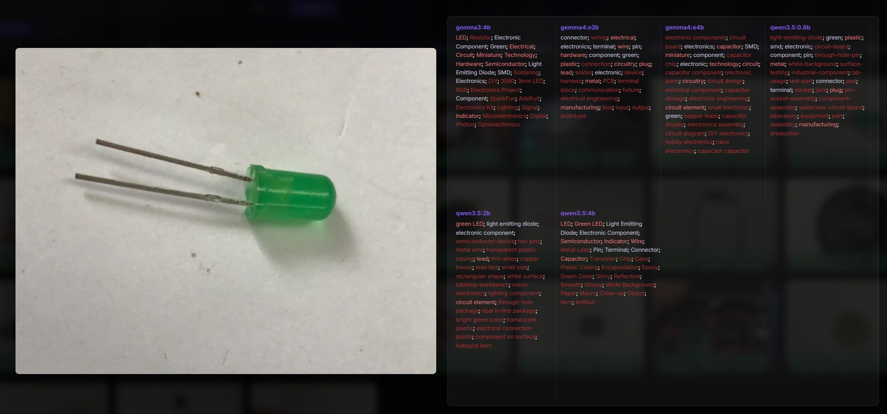

    Tags - LED:
    This was fairly straightforward, although surprisingly some of the models did not detect the word LED. That's too bad, especially as two of them are the newer Gemma 4 family. What's more, the term SMD appeared in Gemma4, which is total nonsense here. This raises some doubts about the use of these models for parts sorting.

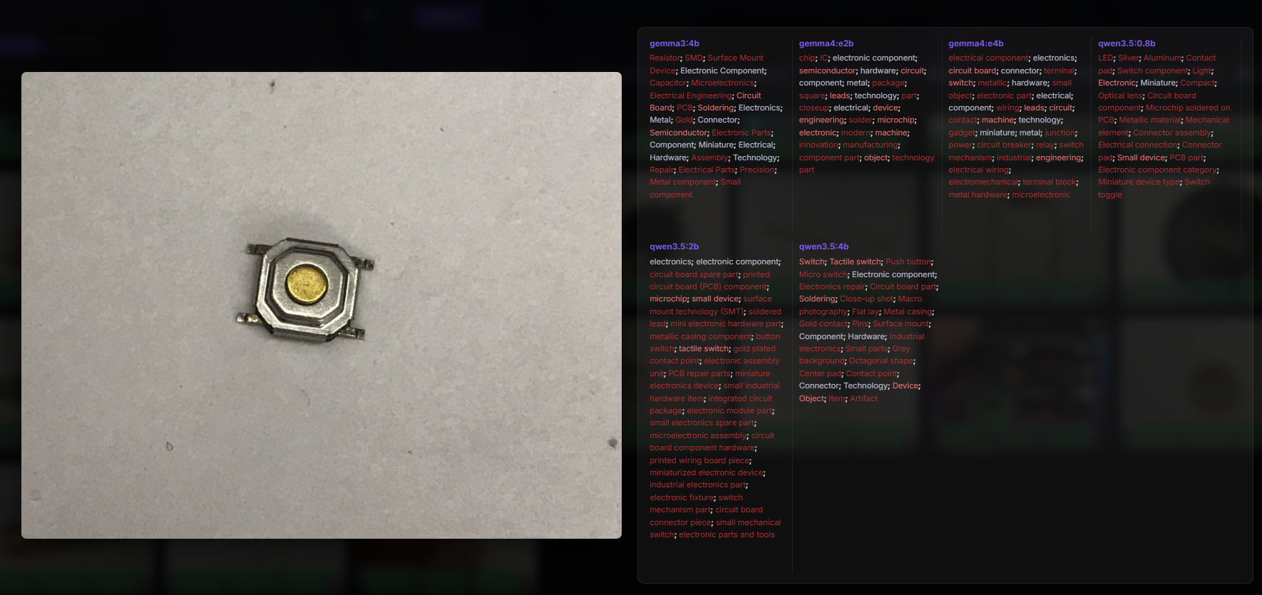

    Tags - microswitch button:
    Same here - seemingly related tags, but also meaningless. In gemma 3 the term resistor appears, in qwen 3.5 on the other hand LED.... "Switch" also appears, but with a lot of noise.

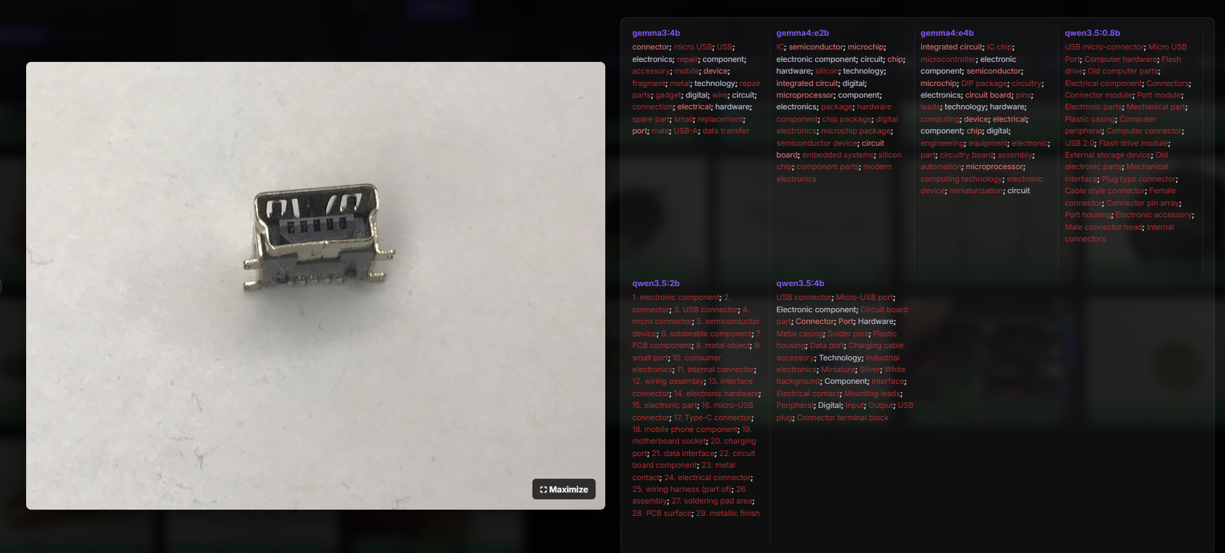

    Tags - USB:
    Similar situation, although here it looks like it's the gemma4 that doesn't know the USB connector. The other models recognised.

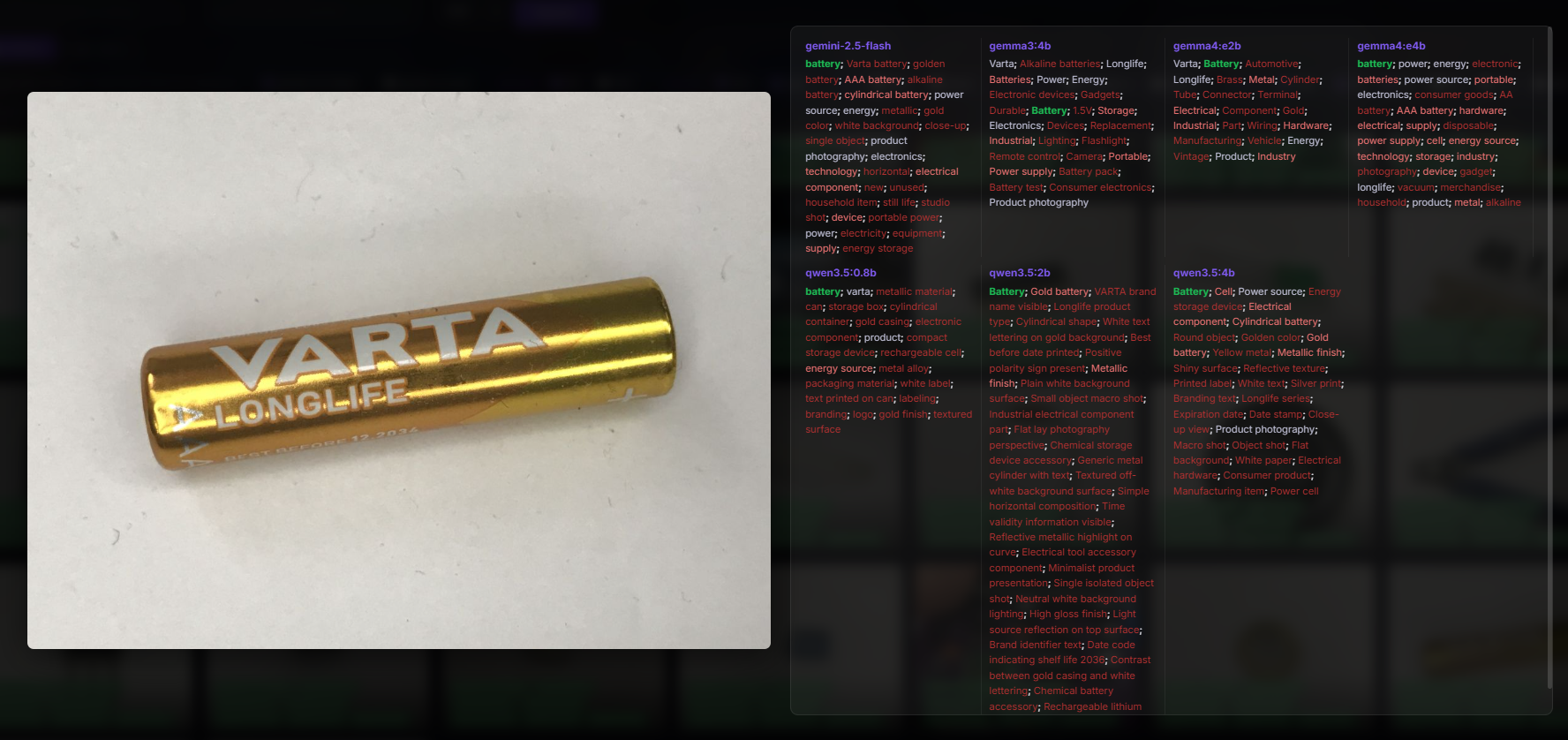

    Tags - battery:
    Not bad, although too much. I think the prompt needs to be changed. Even that gemini 2.5 - "still life"? Interesting that gemma3 has added the 1.5V tag and Gemini no longer. Qwen3.5 on the other hand caught the expiry date - 2036.

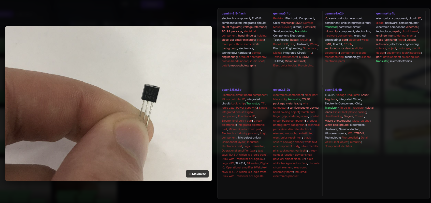

    Tags - TL431:
    Some models read the tagging, but not all. In addition, a part specified a TO-92 enclosure. Again, in response one of them came up with some form of "thought", and I quote "Operational amplifier (Wait; text says TL431A which is a logic trans). Stick with Transistor or Logic IC.". This is also incorrect - it is not an amplifier or transistor.

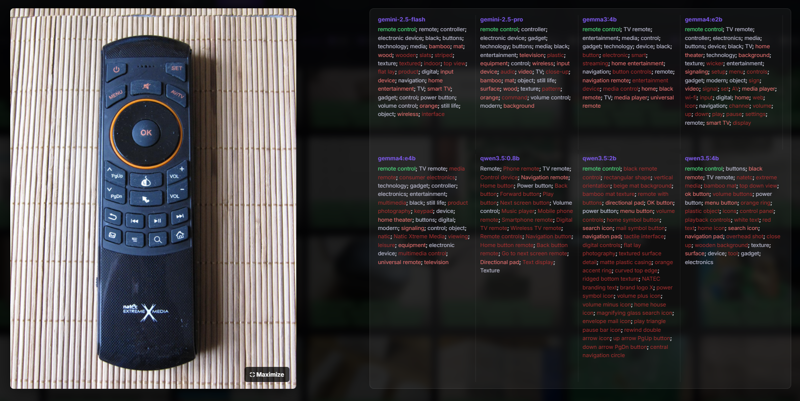

    Tags - remote control:
    The consensus of the models is for the "remote control" tag, then the stairs begin. Gemini 2.5 Flash detected the colour orange and gave the tag "orange". It even described the mat as 'bamboo'. The other models are also fine, although some tags don't seem all that practical, such as 'text display', it doesn't fit in my opinion. Interestingly, only the qwen3.5 2b decoded the Natec logo.

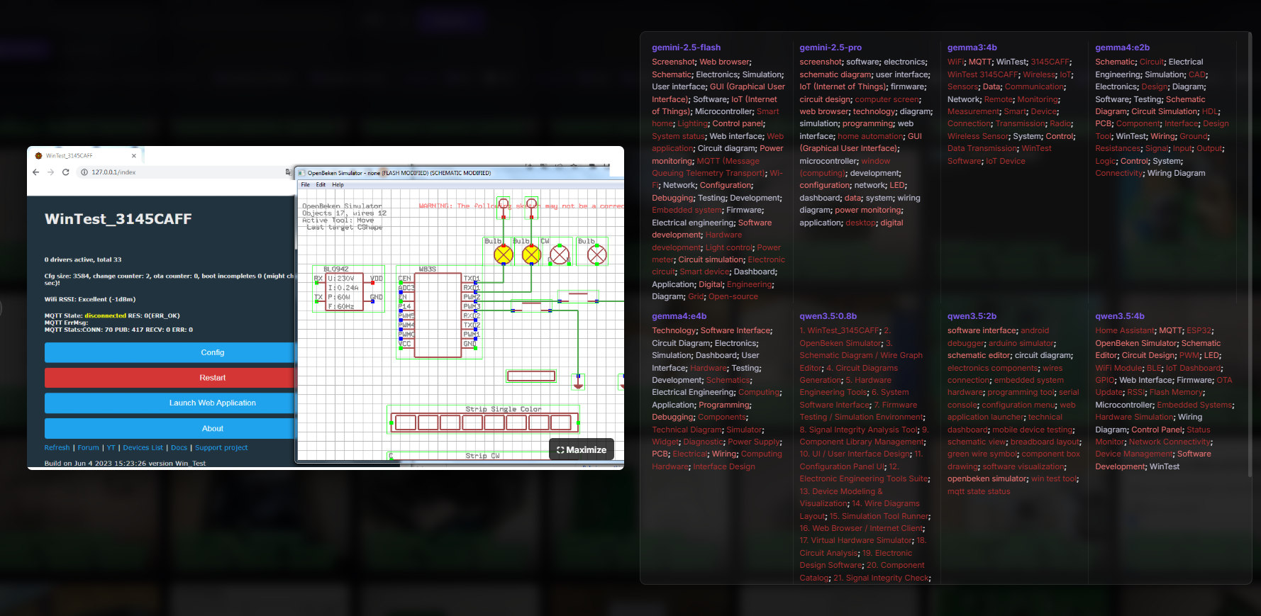

    Tags - OBK simulator:
    Screenshot UI with a circuit diagram and multiple columns of LLM-generated tags on the right
    They did pretty well here, but where did qwen3.5 4b get the ESP32 from? Version 2b referred correctly as "openbeken simulator", not bad.
