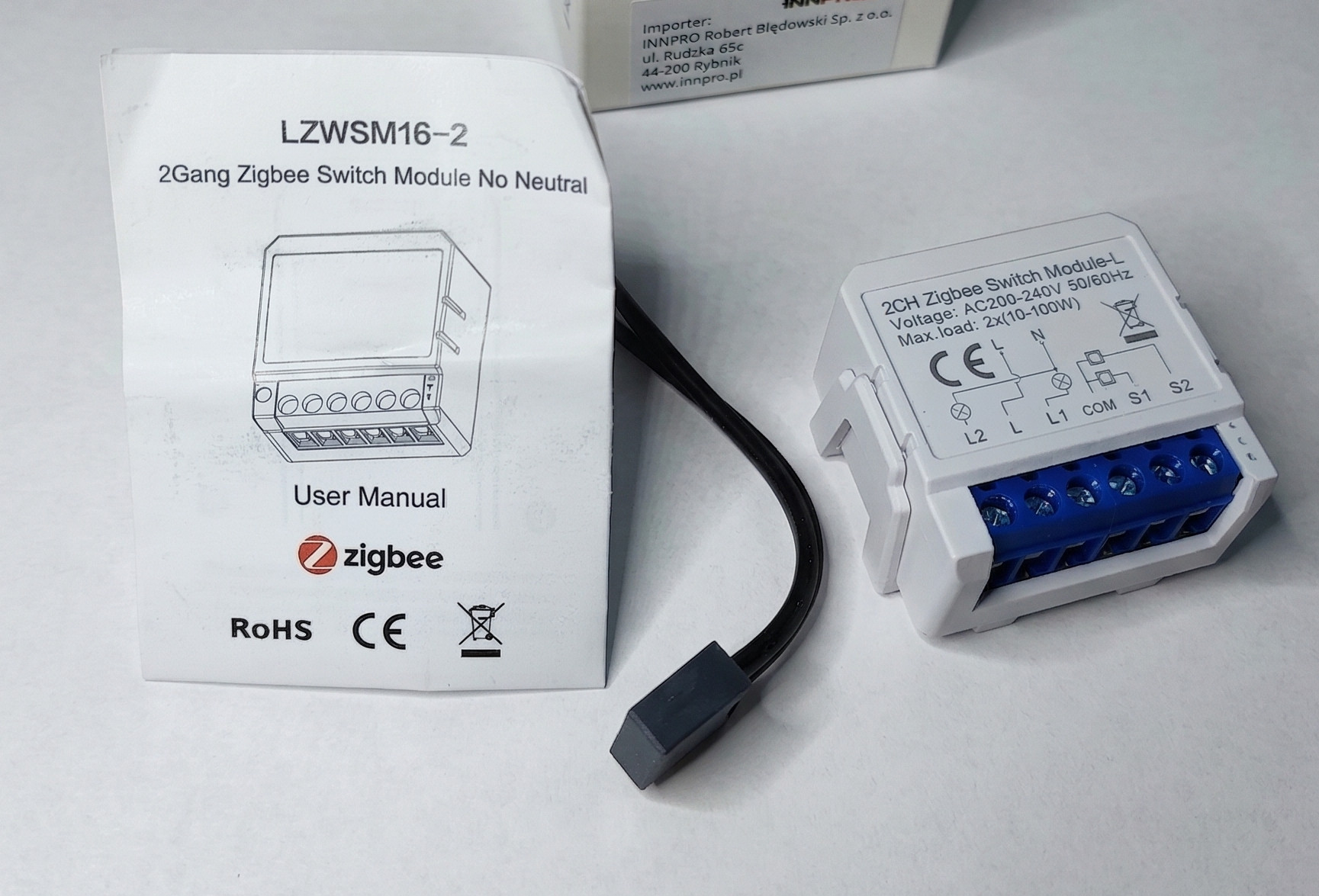

  • The LZWSM16-2 is a two-channel Zigbee lighting controller for two switches and two loads, designed to work without a neutral wire and avoid relay clicks.
  • Inside, it uses a Tuya ZTU module, a rectifier bridge, extra rectifier diodes, an AMS1117 LDO, two BTA16-600BW triacs, and thermal protection instead of relays.
  • The unit is very compact at 39x39x19 mm, costs £65, and supports loads up to 200 watts.
  • Home Assistant via Zigbee2MQTT and CC2531 detected it as TS0012, and the switch worked noiselessly with a bulb.
  • Moisture traces inside raised some concern, and long-term stability remains unproven.
Not everyone likes the distinctive loud click of relays accompanying the switching on of lights in most home automation products available. Nor does everyone have a neutral wire available in the box - in old installations it may have been unnecessary, and its absence makes it difficult to connect some of the 'smart' controls. The product shown here solves both of these problems at the same time.
I bought the LZWSM16-2 for £65 from the Polish importer. The LZWSM16-2 is characterised by its small size, only 39x39x19 mm. The device has two channels, can control two devices and allows two buttons to be connected. It supports a load of up to 200 watts.
The device normally works with the Tuya cloud, but I tested it with Home Assistant via Zigbee2MQTT and CC2531. It is seen as TS0012, but oddly enough, HA suggests it is powered by a battery.
However, this does not affect its performance. The whole thing is indeed noiseless and can cope with a connected bulb. I tested the whole thing quickly on a table before plugging it in, forgive the cottage industry aspect of the experiment.
This is where it could end, but I still wanted to look inside.
First we see the rectifier bridge, additional rectifier diodes (from the mode without neutral wire?) and the LDO AMS1117. The traces of moisture inside are a bit worrying.
After removing the whole thing from the case, you can see how everything has been nicely packed by the manufacturer. The communication module is a ZTU from Tuya. Next to it we have capacitors and two BTA16-600BW triacs. These triacs replace the relays. In addition, we have thermal protection.

I recommend an update, because according to the LZWSM16-2 profile there are additional entities, allowing, among other things, to specify the type of connected button.
In summary , the device looks promising. The whole thing is small, compact, and quiet and undemanding (literally - no neutral wire needed). The question, of course, is how it will be with the stability of operation, but time will tell.

I get the impression that by writing "loud" you are engaging in demagoguery. Somehow, "without automation", no one complained that the switch "clicks loudly" and yet the mechanical system of the light... [Read more]
p.kaczmarek2 14 May 2026 00:42
At my place, the relays on the smart switch are genuinely louder than when switching the lights with the classic switch. The LEDs are then connected to what is colloquially known as an "adapter", i.e.... [Read more]
