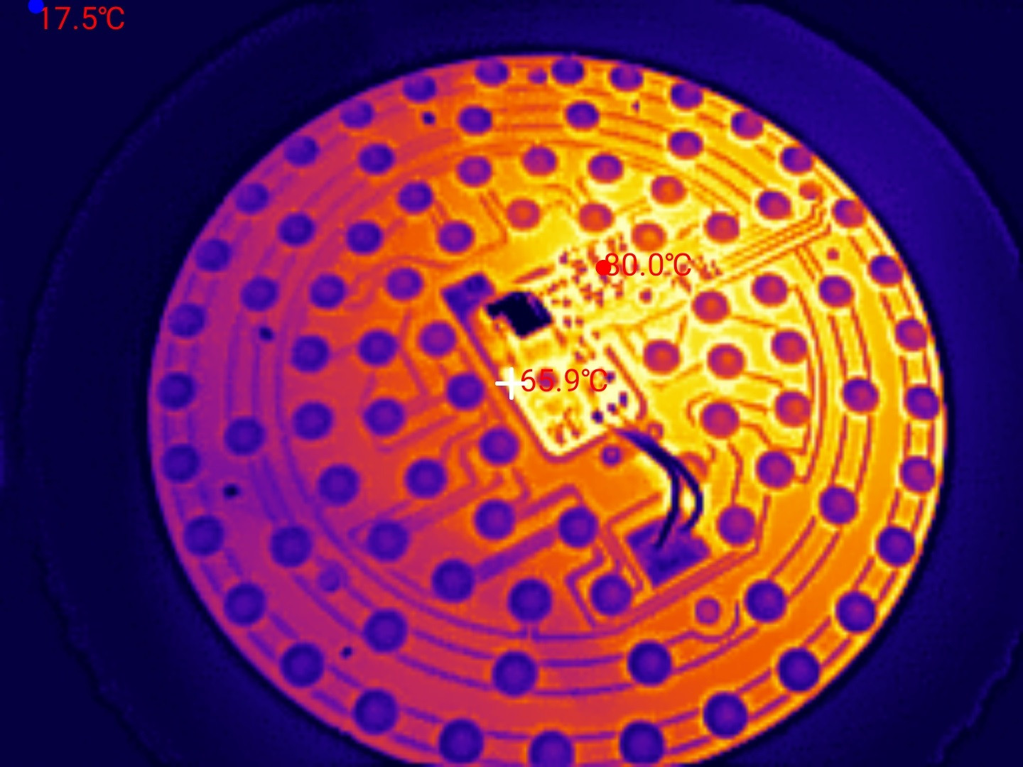

Warm-up test
I set the full brightness and applied the cover. Without the lid the temperature would have been lower, because with it the lamp is quite tightly sealed. Here are the results after two hours:
LED DC drivers heat up to 90 °C.
The power supply (for the Wi-Fi module) also heats up, but a little less:
At the Wi-Fi chip itself it is around 60 °C.

Factory this lamp heats up quite a bit. I wonder how much this shortens the life of the LEDs.
Once the firmware has been changed, the heating can be reduced at will, although this is not the only gain from the redesign. Above all, it frees the product from the cloud and allows you to connect it to Home Assistant.
