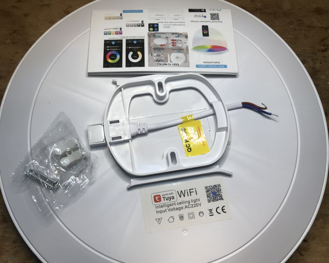

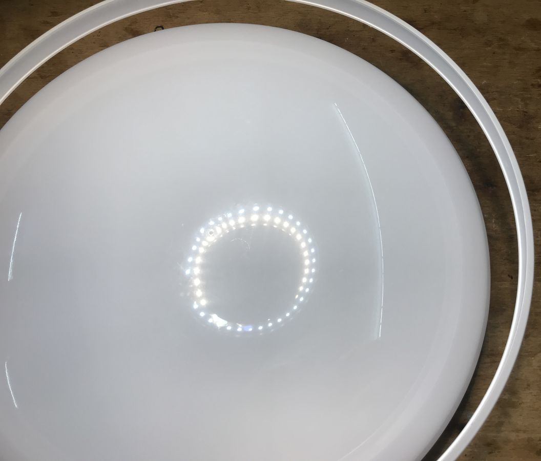

    Let's start with the contents of the kit. What do we get when we pay a good 80 zl?
    How hot does the 24 W Tuya ceiling lamp get? Test, interior and firmware change How hot does the 24 W Tuya ceiling lamp get? Test, interior and firmware change How hot does the 24 W Tuya ceiling lamp get? Test, interior and firmware change
    Included are the manual, the lamp, the screws for fixing and the remote control. The remote control is just an extra, the most important thing is the Wi-Fi control - the app. The remote communicates with the lamp via Bluetooth, although I have not analysed the details of its protocol.
    Instructions:

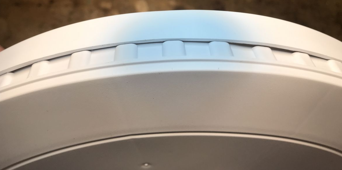

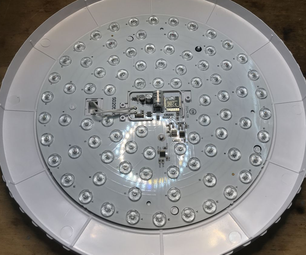

    Inside of the lamp
    Remove the ring - undermine the catches. There are no screws here.

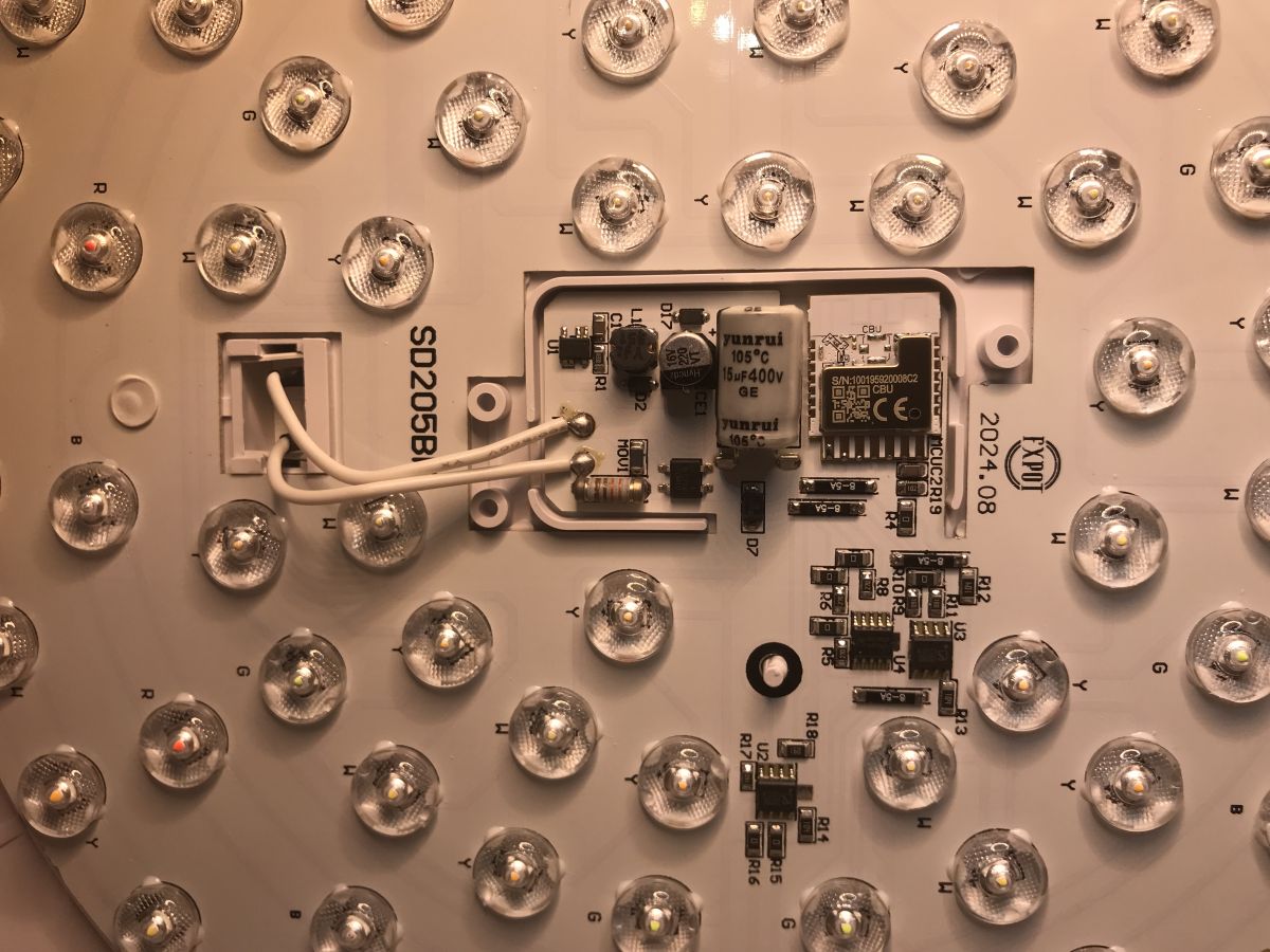

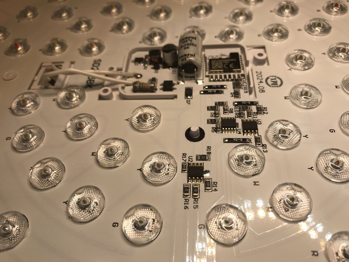

    The lamp is based on a CBU module, the BK7231N. The PCB designation is SD205BK - 2024.08.

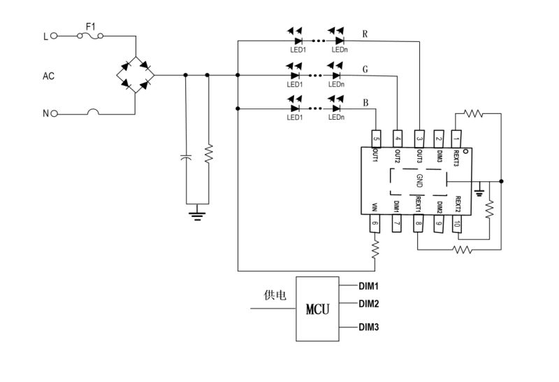

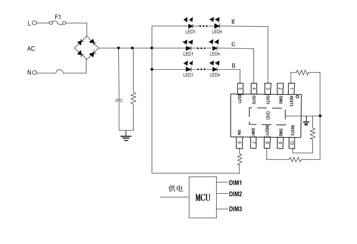

    U2, U3 and U4 are separate constant current LED controllers:
    The DX2286EB is a three-channel LED controller, but from what I understand a few were simply used because there are a lot of LEDs.
    The controller is mains powered and needs a minimum of external components to operate.

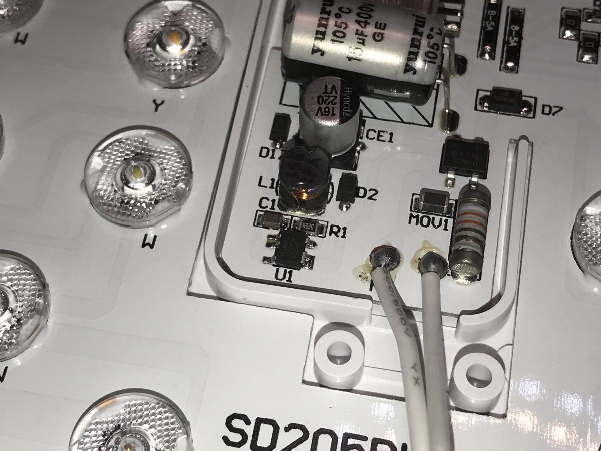

    What remains is the power supply to the Wi-Fi module. This is realised by the BP2525 - a voltage-reducing, non-isolated inverter.

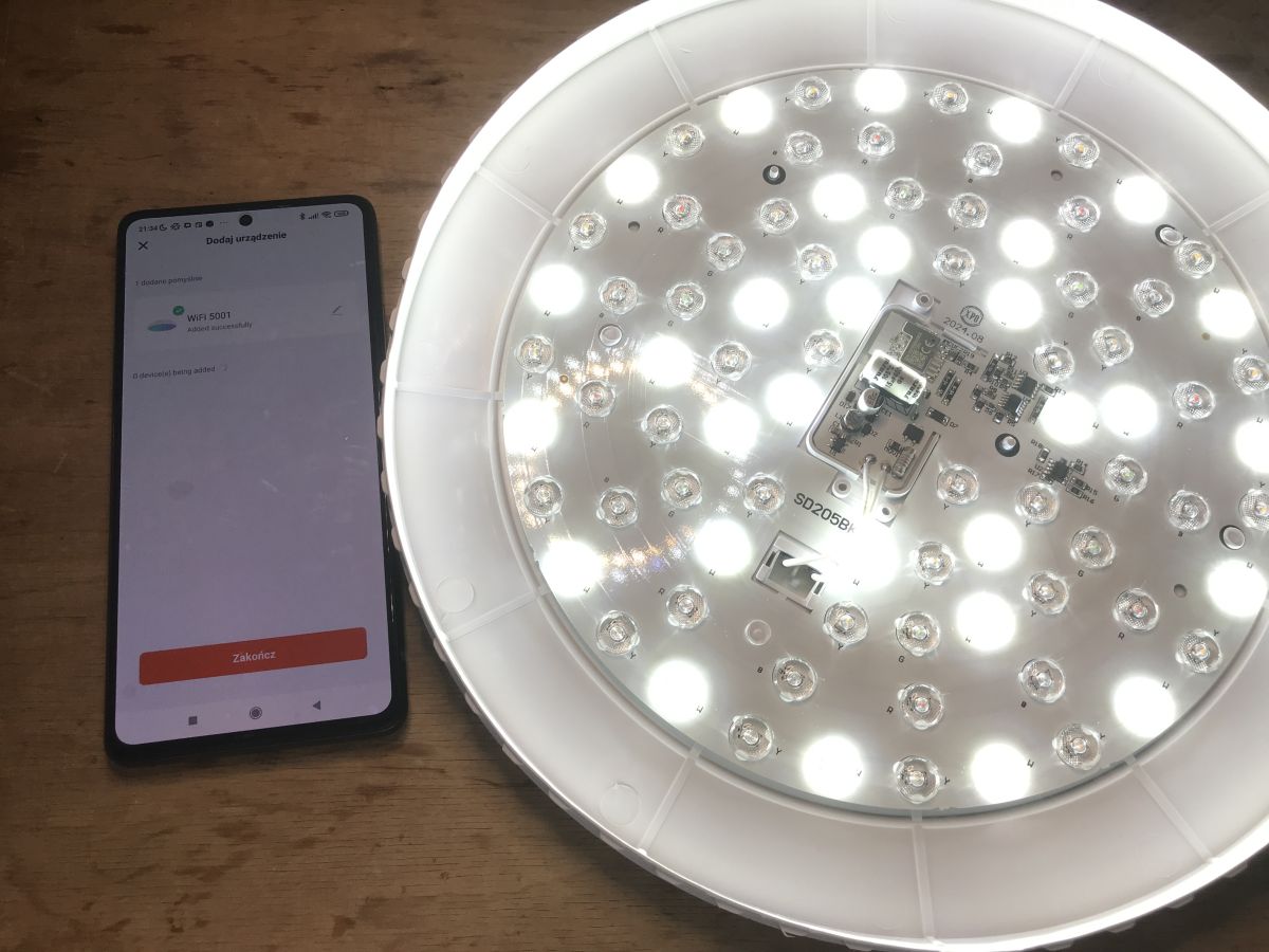

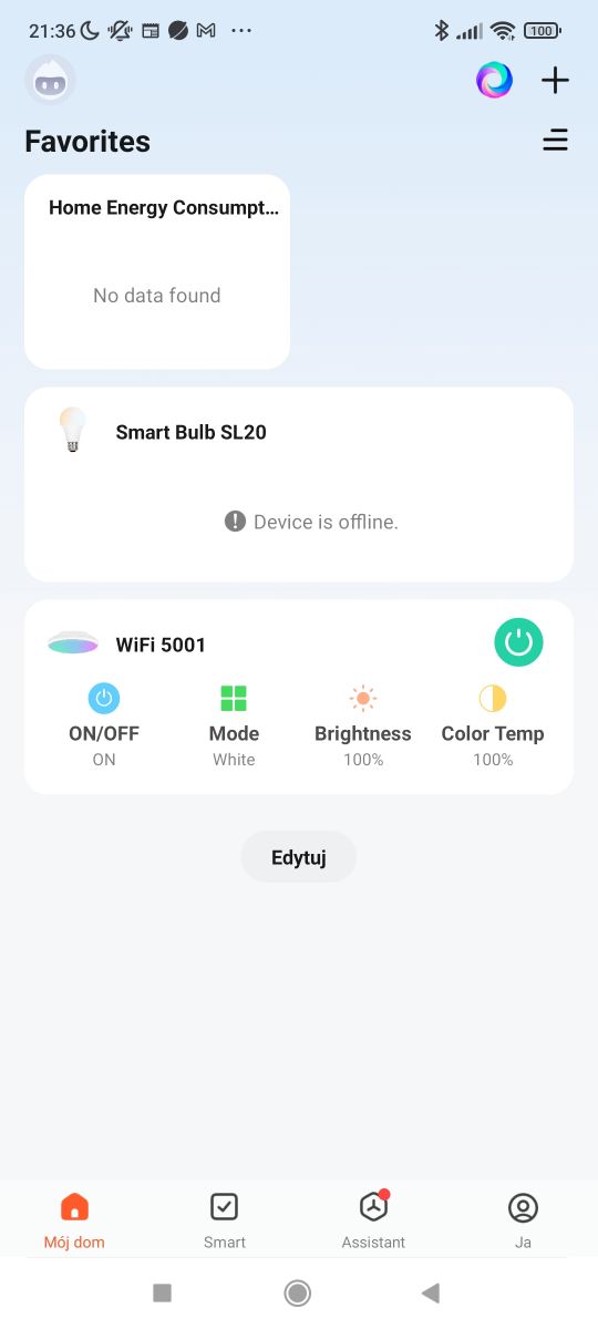

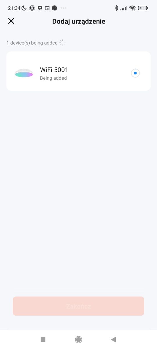

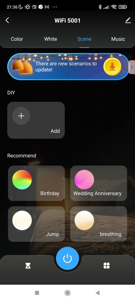

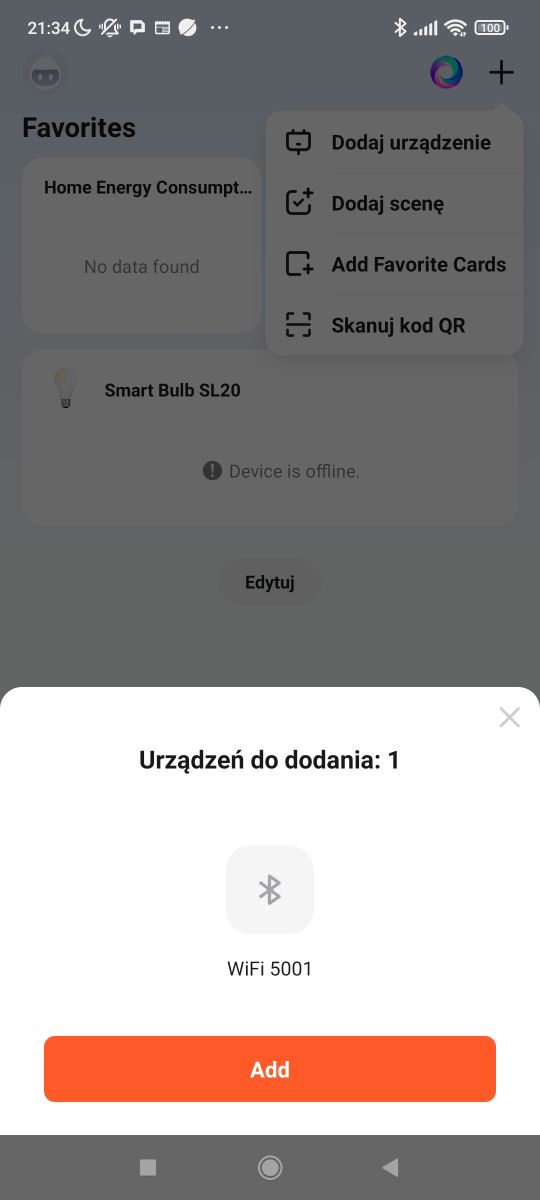

    Test with Tuya application
    According to the instructions - we enter the pairing by performing power on/off cycles, in pairing mode the lamp flashes. We add it via the app.
    According to the app, the product model is WiFi 5001:

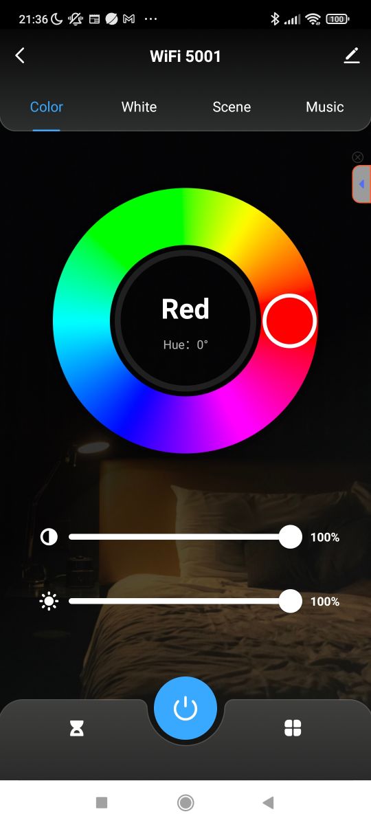

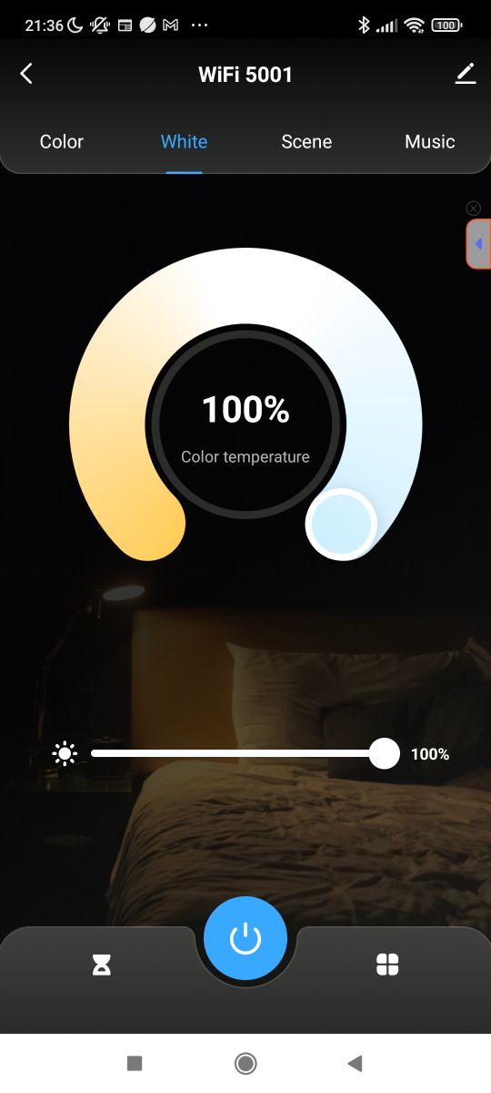

    In the app we have control separately over the white temperature and separately over the colours. It is not possible to light all the LEDs at once:

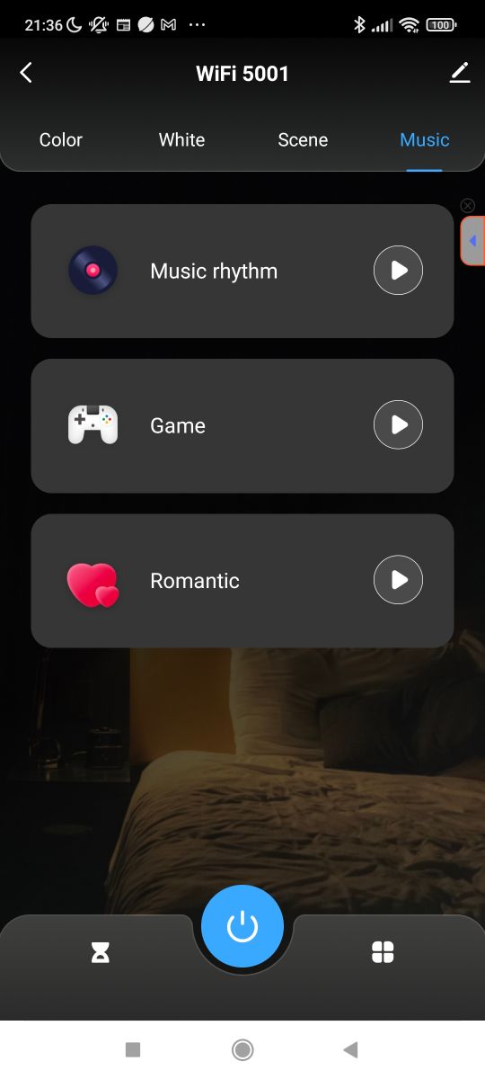

    In addition, we have scenes and a music mode (control from the phone - the lamp has no microphone).

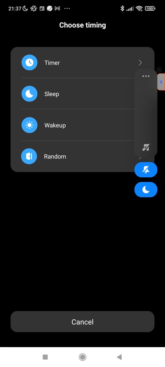

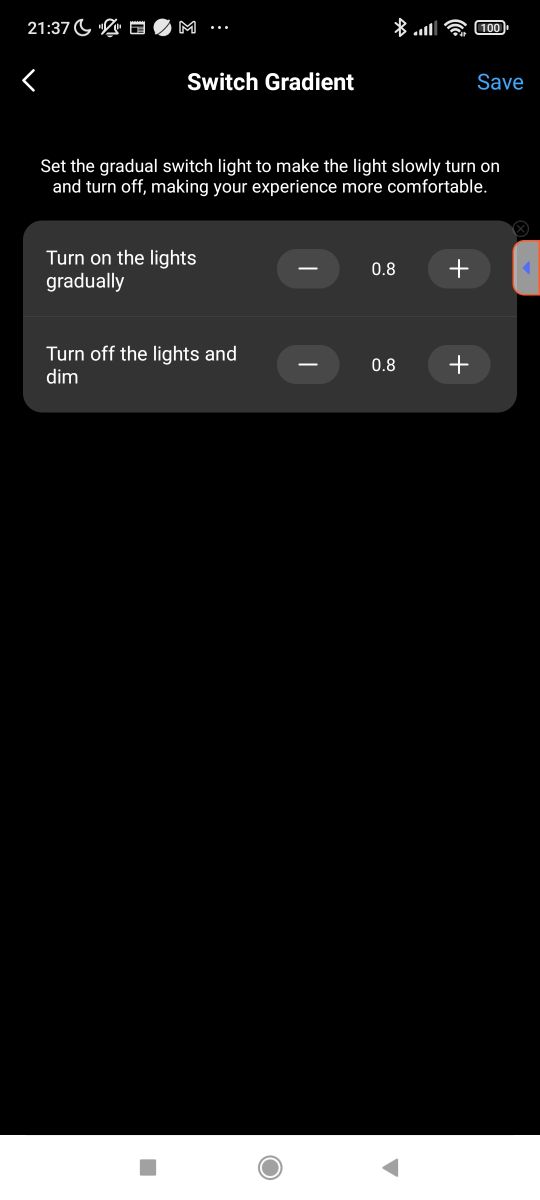

    Of course, there are also automations and scenarios, as there normally are in Tuya. Of the more interesting things, there's a gradient - you can set how fast/slowly the lights turn on. Also interesting is the "do not disturb" mode - it prevents the lamp from switching on when the power returns - I wonder what it's for? I rather prefer it when the lamp remembers its previous state.

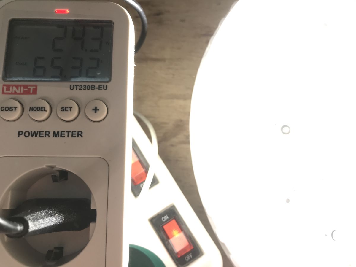

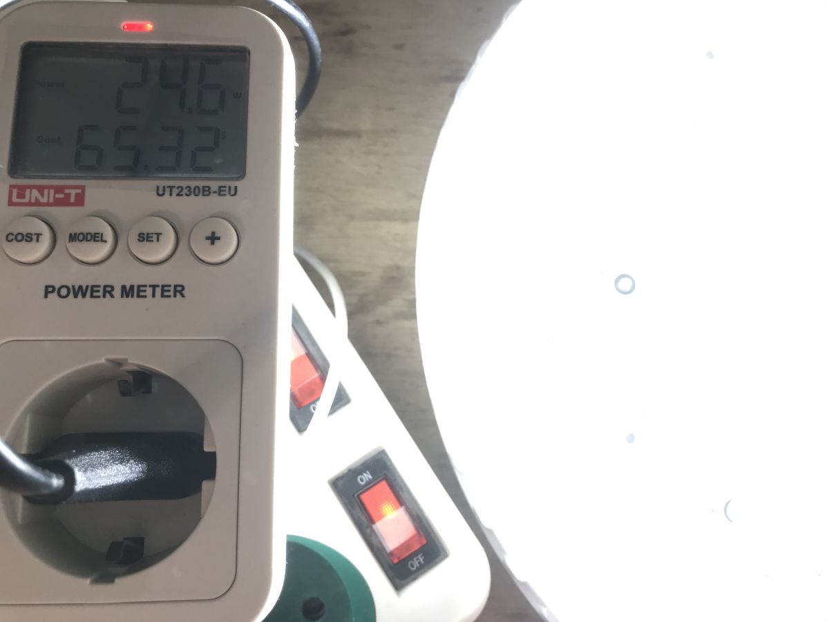

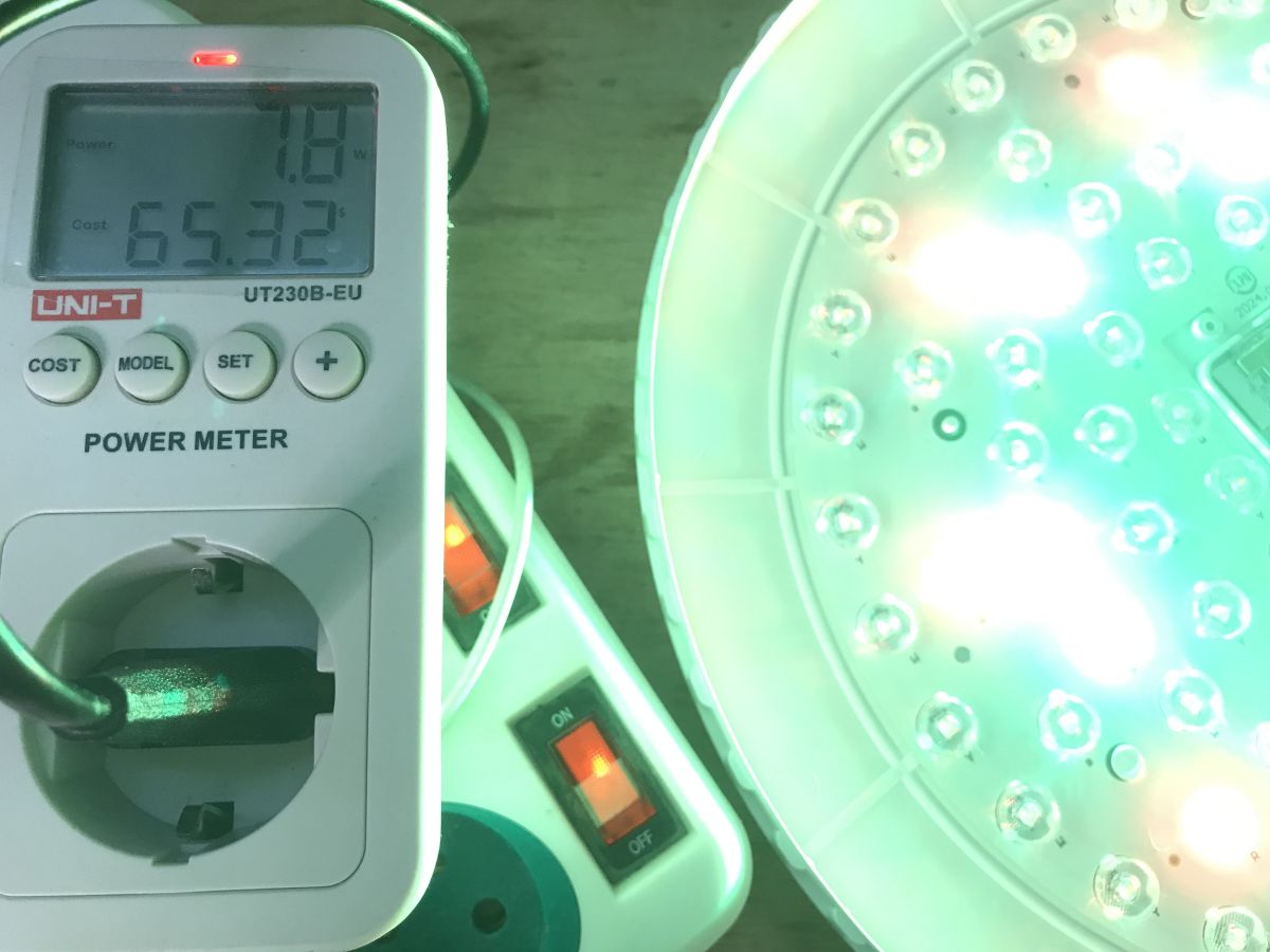

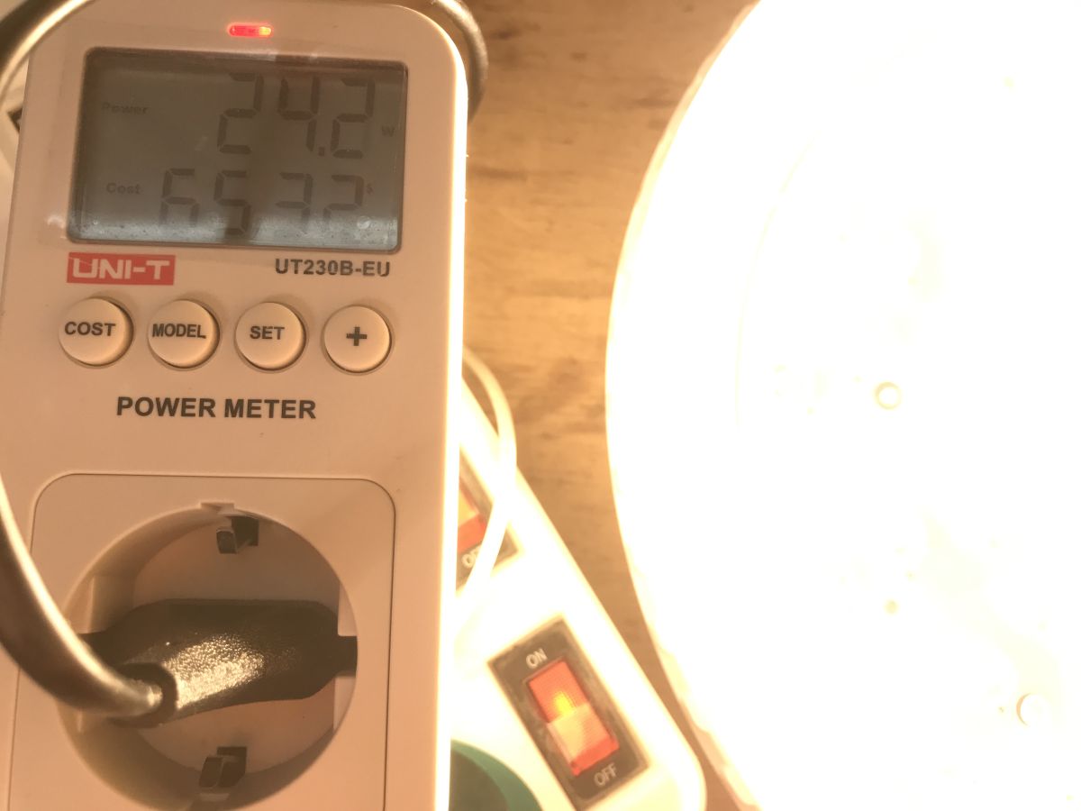

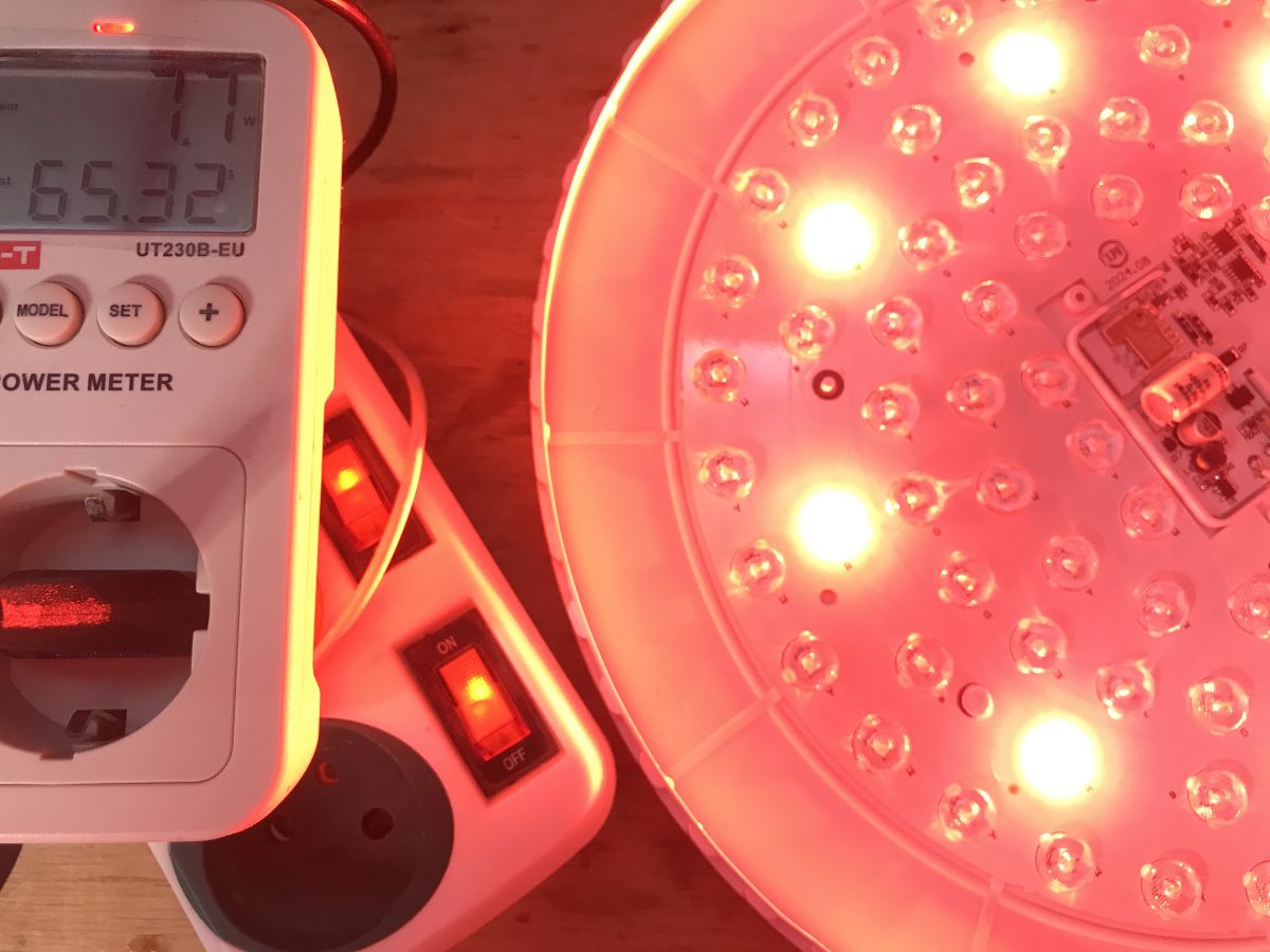

    I measured the power at different colours - RGB came out around 7 W, white temperatures 24 W.

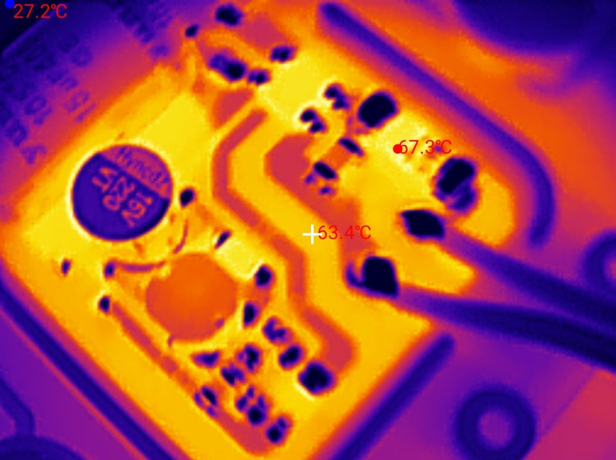

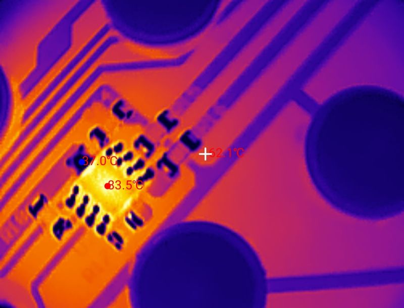

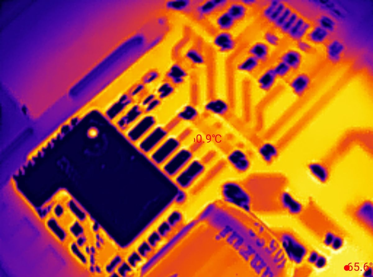

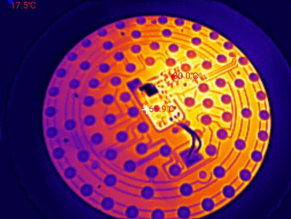

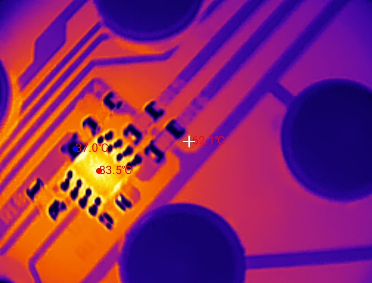

    Warm-up test
    I set the full brightness and applied the cover. Without the lid the temperature would have been lower, because with it the lamp is quite tightly sealed. Here are the results after two hours:
    LED DC drivers heat up to 90 °C.
    The power supply (for the Wi-Fi module) also heats up, but a little less:
    At the Wi-Fi chip itself it is around 60 °C.

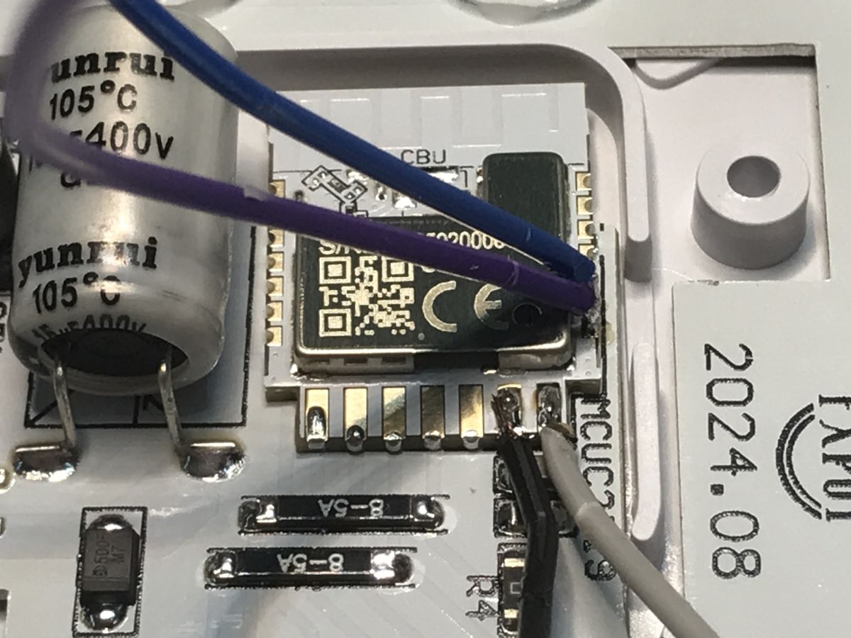

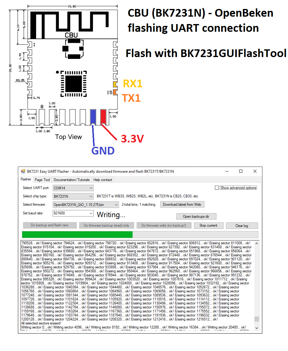

    Changing firmware
    Changing the firmware to OpenBeken allows you to free this product from the cloud, from the manufacturer's servers, and run it 100% locally. It also allows you to pair it with Home Assistant. We use Easy GUI Flasher to upload the OBK:
    You will need a USB to UART converter and four cables:

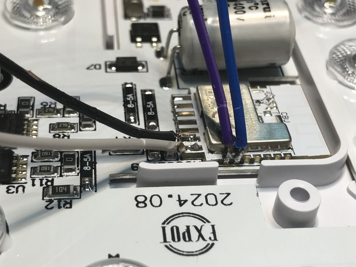

    We do everything with the lamp completely disconnected from the mains. I added flux, whitened the pads, soldered the wires:
    Of course you need a robust 3.3 V source for this, not directly from a USB to UART converter. Everything according to the flasher instructions .

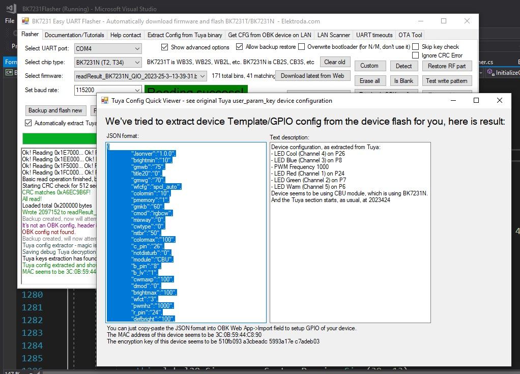

    First a backup to know the GPIO configurations, then upload the new firmware.
    JSON Tuya:
    GPIO verbal description:
    - LED Cool (Channel 4) on P26
    - LED Blue (Channel 3) on P8
    - PWM Frequency 1000
    - LED Red (Channel 1) on P24
    - LED Green (Channel 2) on P7
    - LED Warm (Channel 5) on P6
    Device seems to be using CBU module, which is using BK7231N.
    OBK template:
    Import instructions:

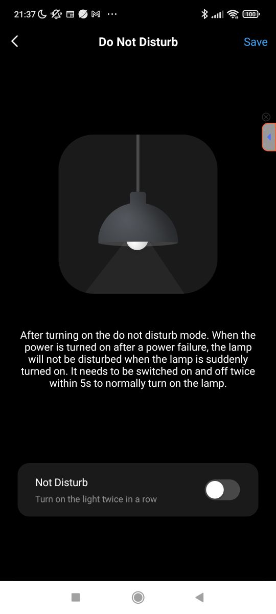

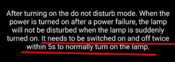

    There is also an interesting 'do not disturb' mode - it prevents the lamp from switching on when the power returns - I wonder why it is there? I rather prefer it when the lamp remembers its previous state.
    You can imagine , you have a power outage so you go to bed , and in the middle of the night you suddenly have a power return....
  • #3 21899042
    Posts: 14795
    Rate: 12944
    All in all, yes, but that doesn't explain why such a strange way of switching on:
    Screenshot of English instructions with a red underline about switching the lamp on and off twice in 5s.
