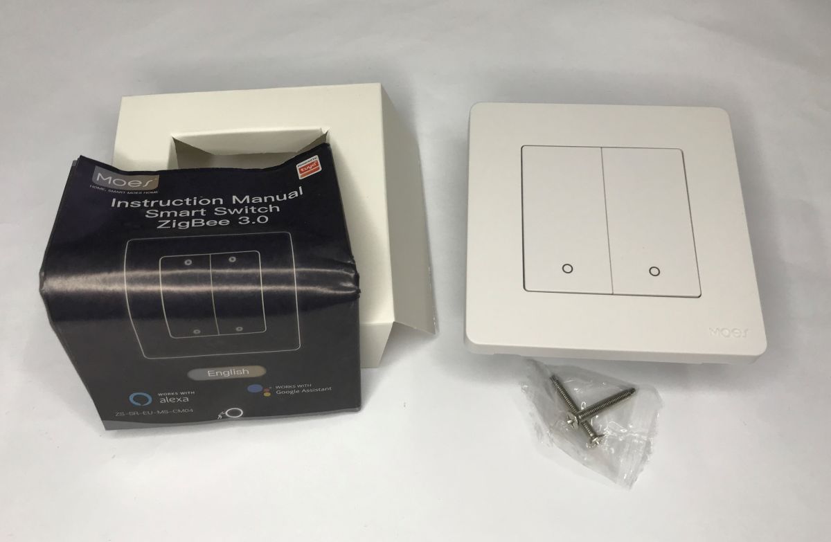

Are you annoyed by the ubiquitous touch buttons? If so, this is the product for you. This light switch offers a combination of Zigbee connectivity with classic, clickable buttons, and what's more, the whole thing can be easily paired with the Home Assistant! The price of the product is unfortunately a little higher than the Wi-Fi version, I paid PLN 90 for this one in our country.
Instructions - the unit is available in two versions, one of which can operate without a neutral wire connection. Interestingly, the recommendations mention Wi-Fi, I guess someone mixed up the protocols.

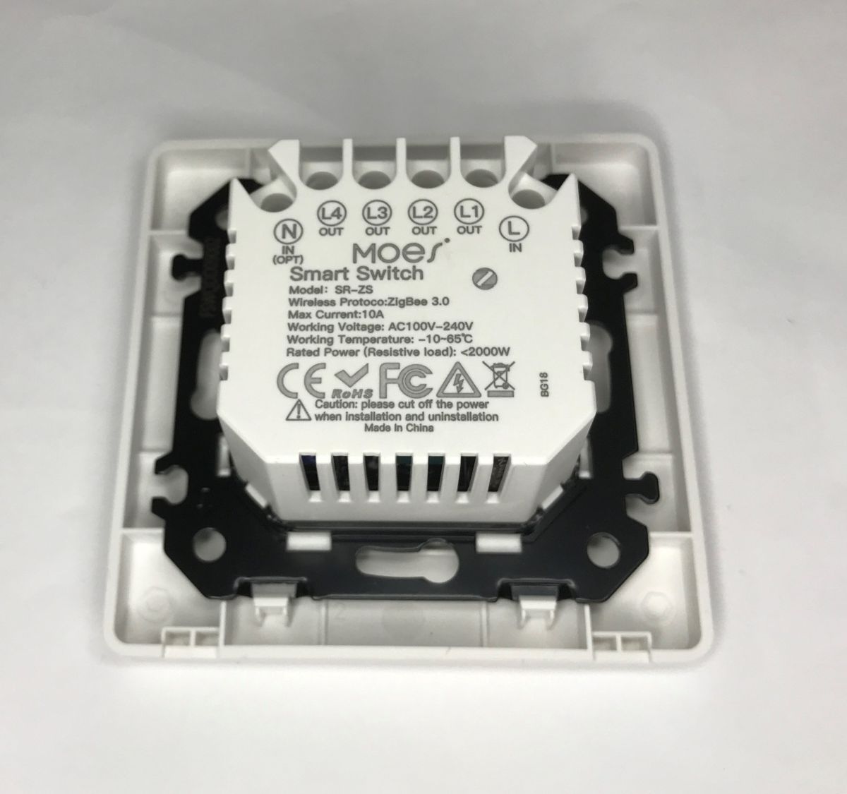

Designation on the housing: SR-ZS, Zigbee 3.0 protocol, maximum current 10 A, load up to 2 kW (for resistive load).

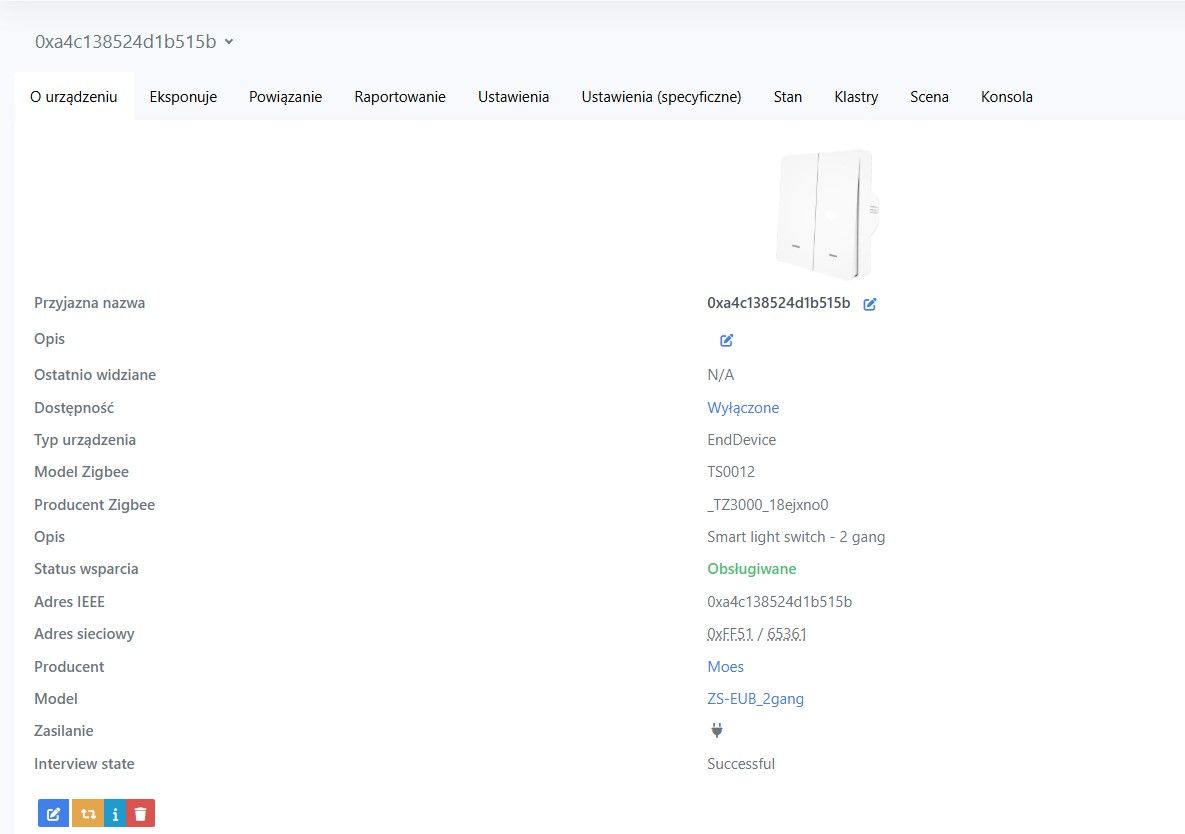

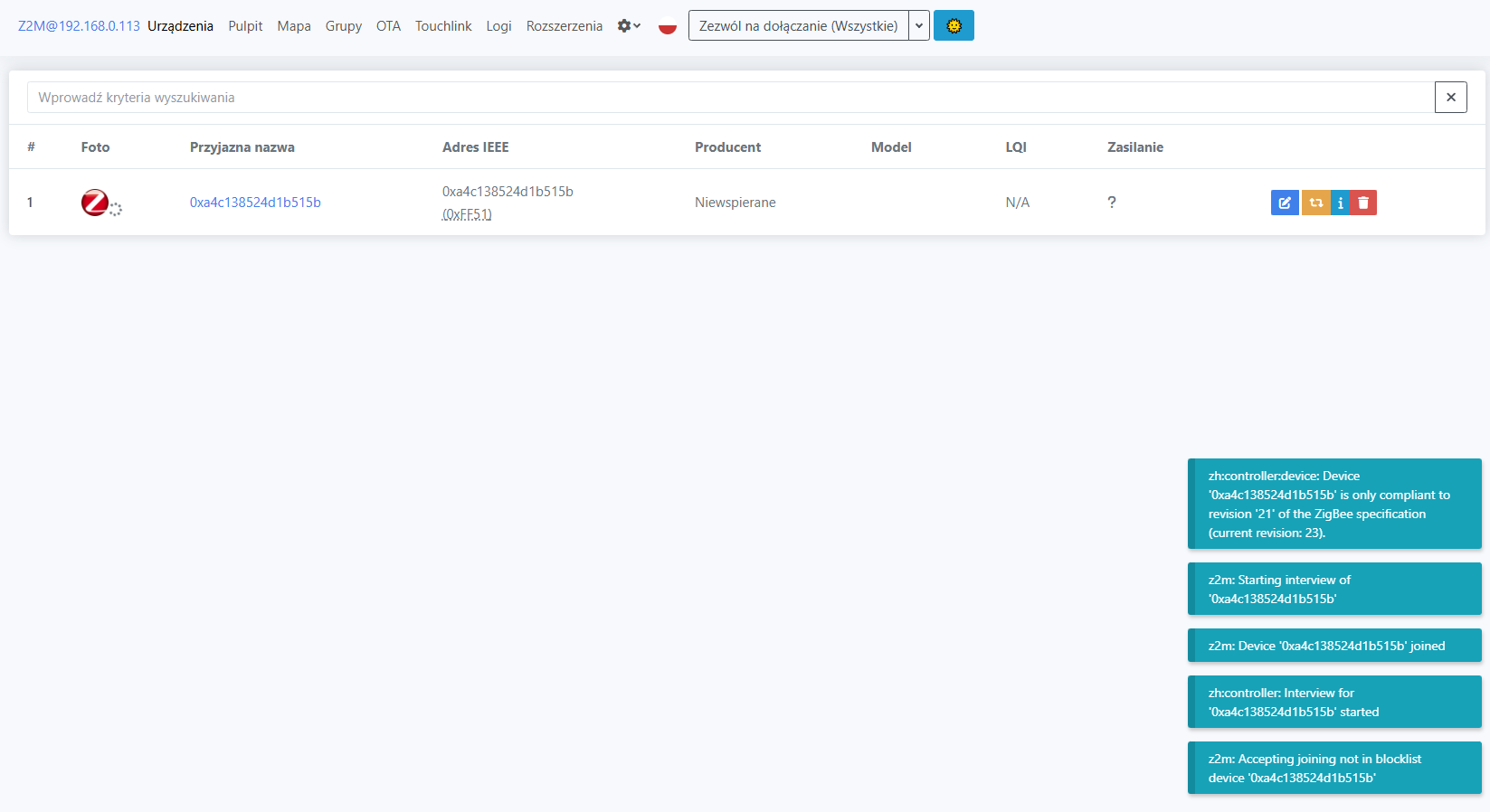

Pairing with Home Assistant
According to the instructions - you need to press the button longer:
HA detects the switch as TS0012:

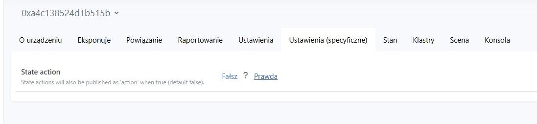

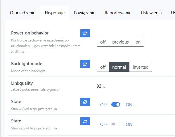

The device exposes quite rich settings - we have control over the initial state and even the backlighting.
In addition, we have a "state action" option - for broadcasting events for automation.

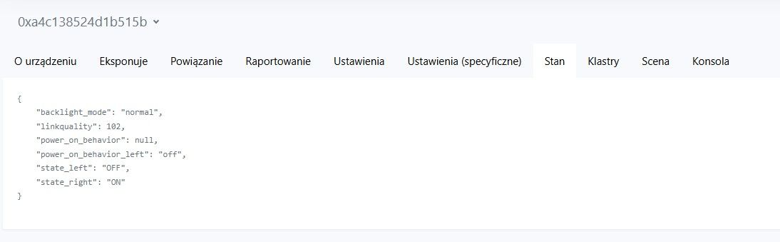

JSON view:
The device works fully satisfactorily with HA and can be used in automations.

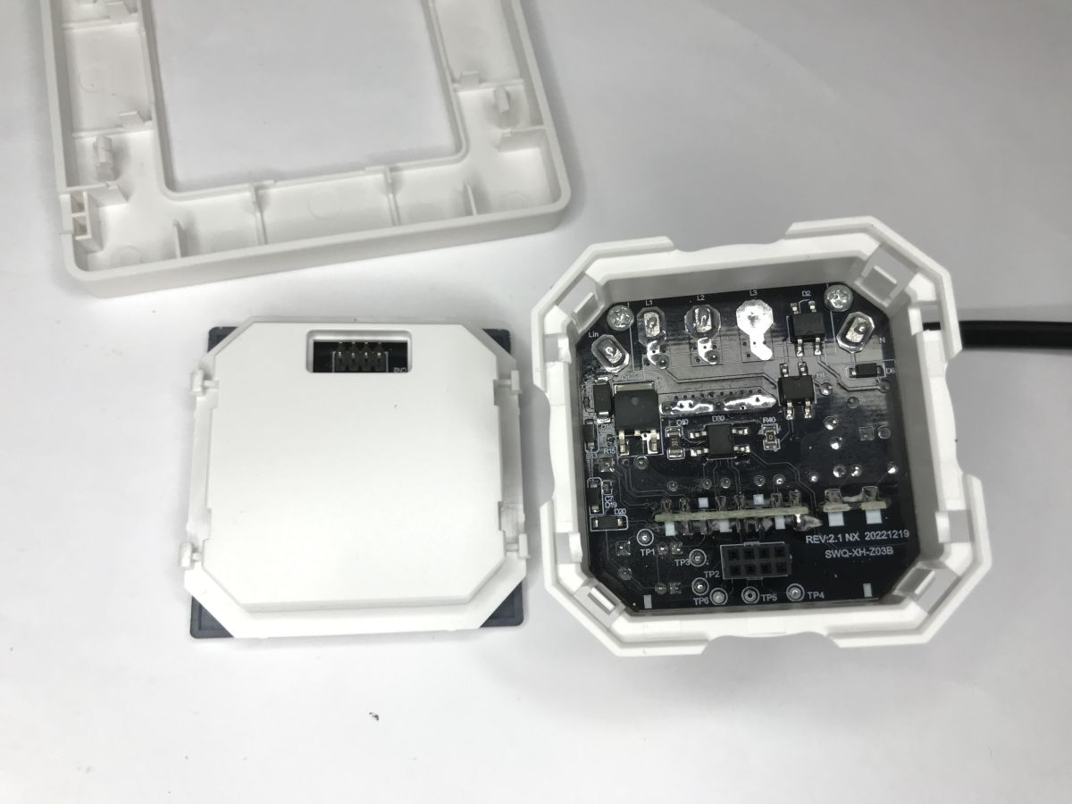

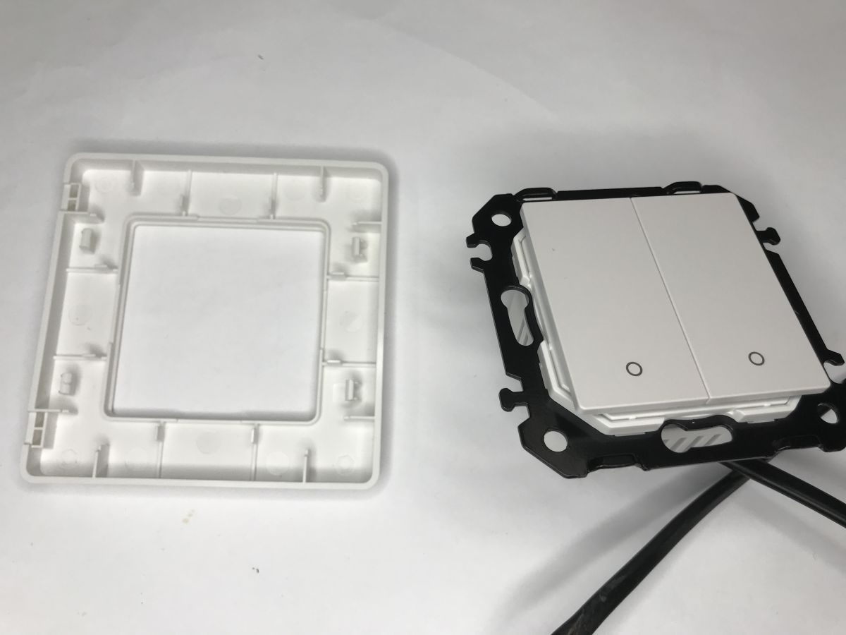

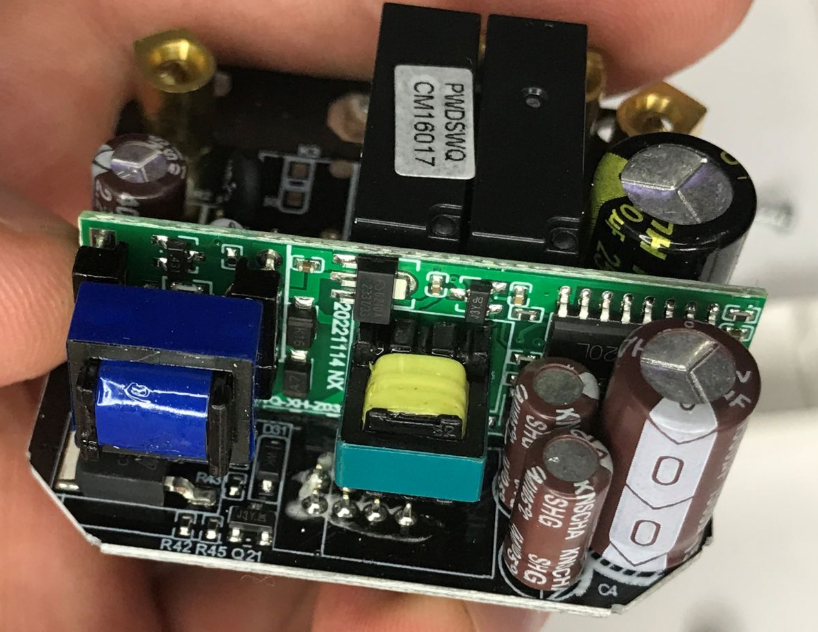

Interior

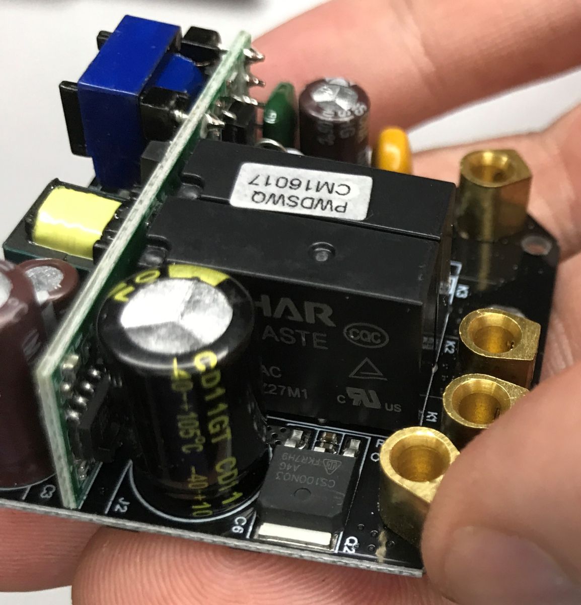

The overall design is more built-in than typical Wi-Fi-controlled switches. The front panel is removable.

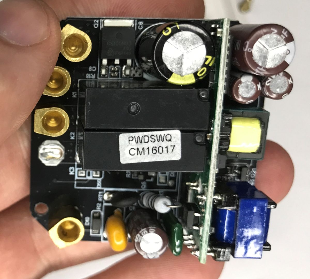

Executive PCB designation with power supply: SWQ-XH-Z03B REV:2.1 NX 20221219

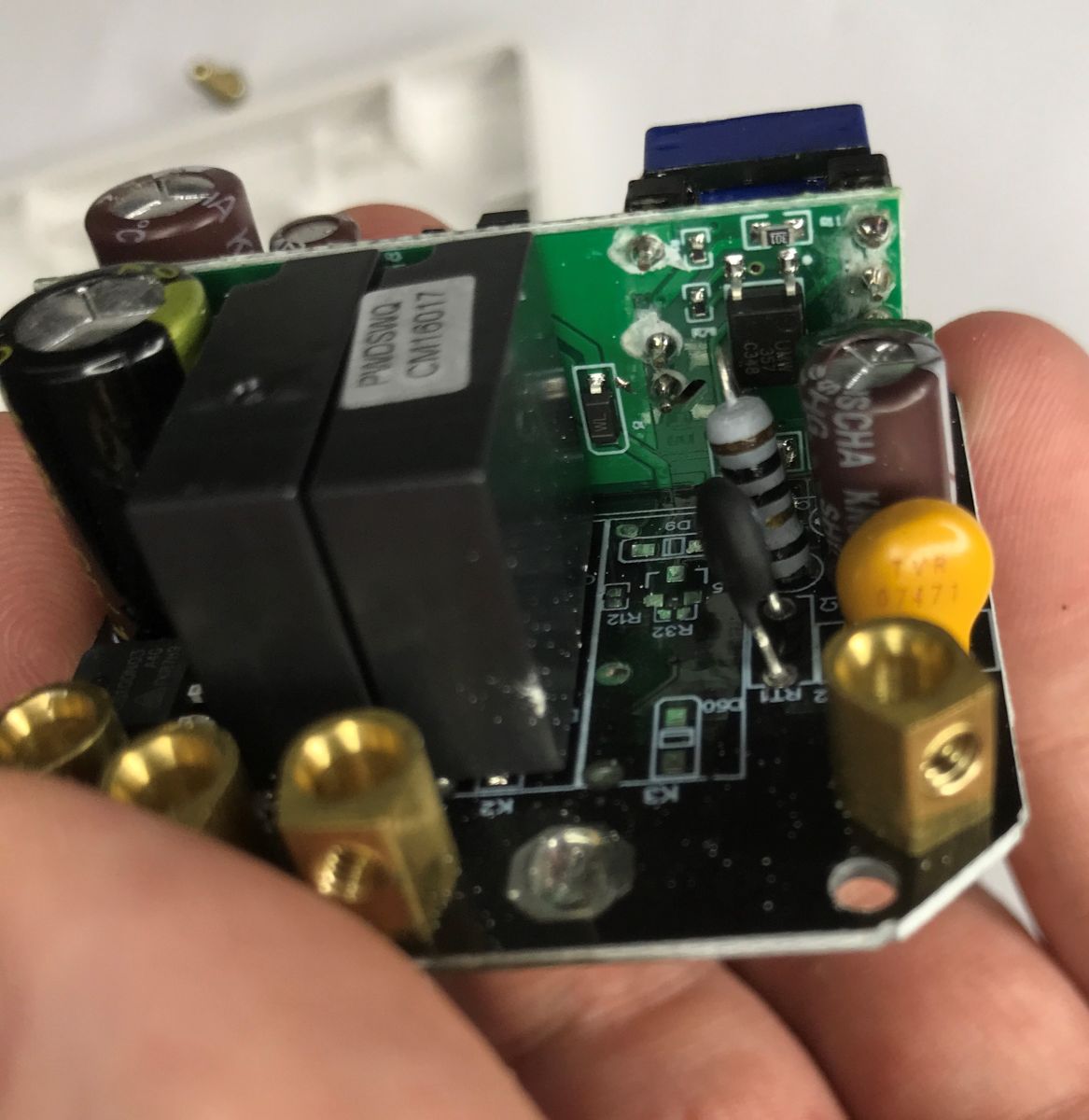

Switching is realised on relays. The presence of a thermistor and varistor surprised me a bit, as a rule manufacturers omit whatever they can.
There is room in the middle for a third relay. Under the relay is the transistor controlling it, you can see the space saving.
Close-up of a PCB with a relay, capacitors, and brass screw terminals, held in a hand

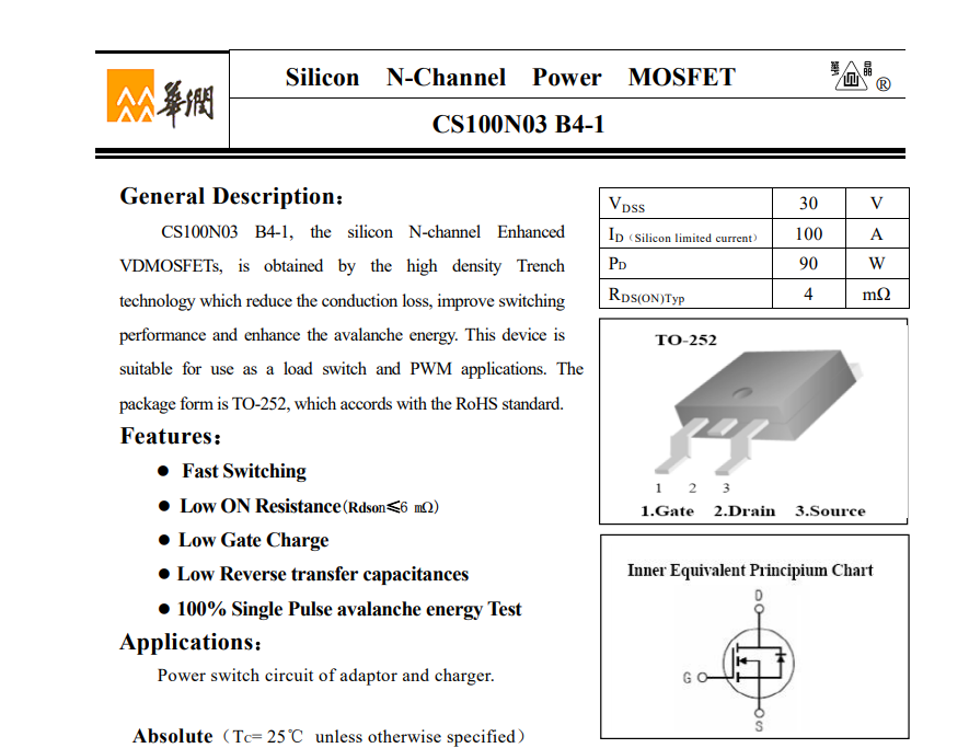

The fundamental question, however, is what is the CS100N03 MOSFET here for? Presumably for operation in neutral wireless mode.
Datasheet excerpt for CS100N03 B4-1 MOSFET with specs table and TO-252 package diagrams

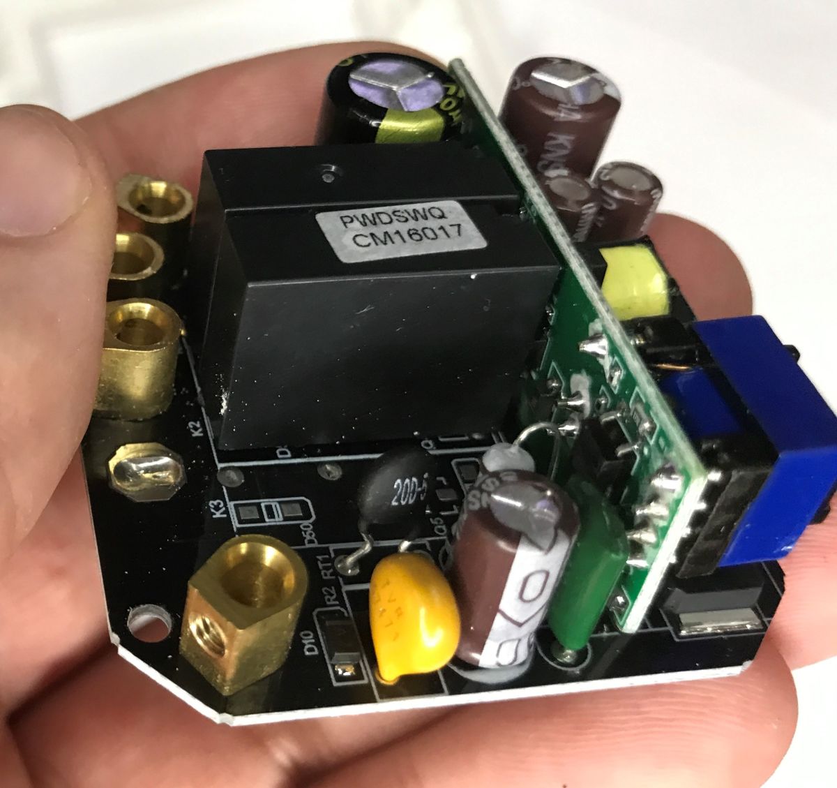

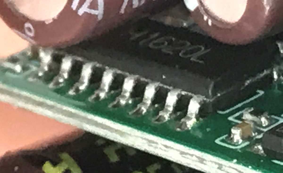

On the other hand, there is a power supply module with an interesting H1620L chip:
Close-up of a switch interior: green PCB with electrolytic capacitors and black relays, held in a hand
Macro of an SOIC integrated circuit on a green PCB, with soldered pins visible.
Summary
This is the type of switch I like. I find the mechanical buttons more comfortable and pleasant to use, I don't like the tactile ones. Plus here we have control over what we need - you can even configure the backlight. Pairing with the HA is easy too, you can confidently buy.
What's still unclear to me is the design of this switch - I don't fully know what the obscure big chip in the SOIC is, and I haven't looked into the front panel, but I didn't want to damage it. If anyone knows anything more - please let me know, for an addendum.
