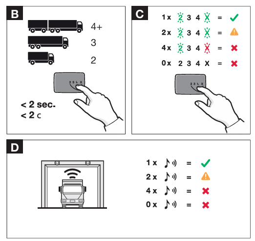

  • Kapsch OBU-4041 is a truck-mounted on-board unit for electronic toll collection, with a single button and axle-count LEDs for 2, 3, and 4 axles.

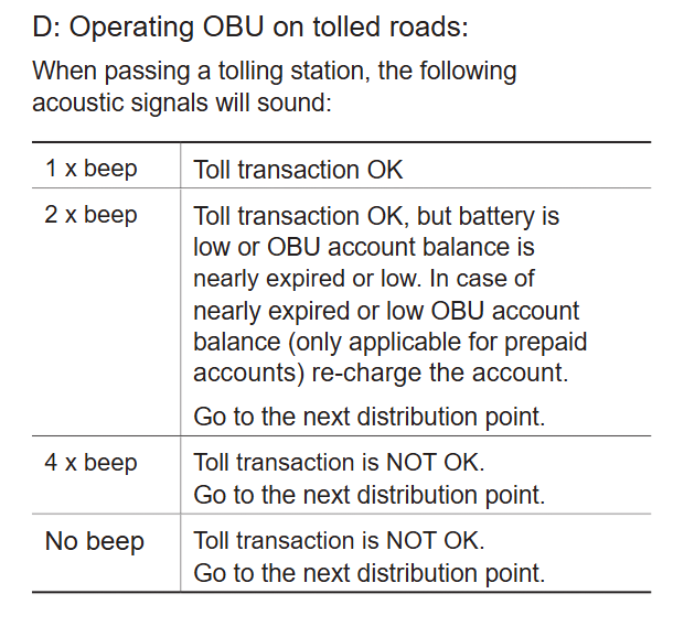

  • A single beep means correct toll collection, two beeps warn of low pre-pay balance or low battery, and four beeps mean the toll was not paid.

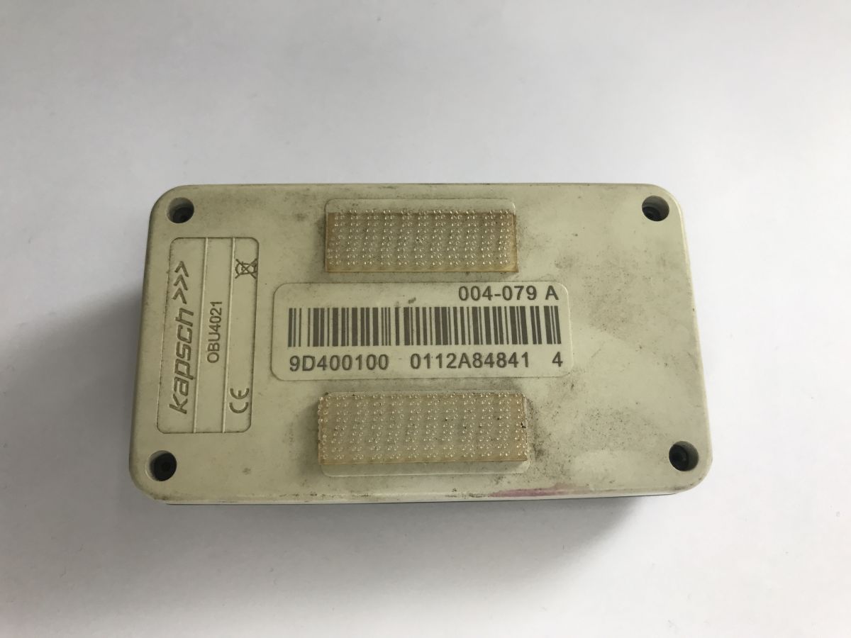

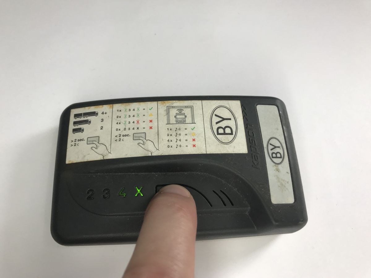

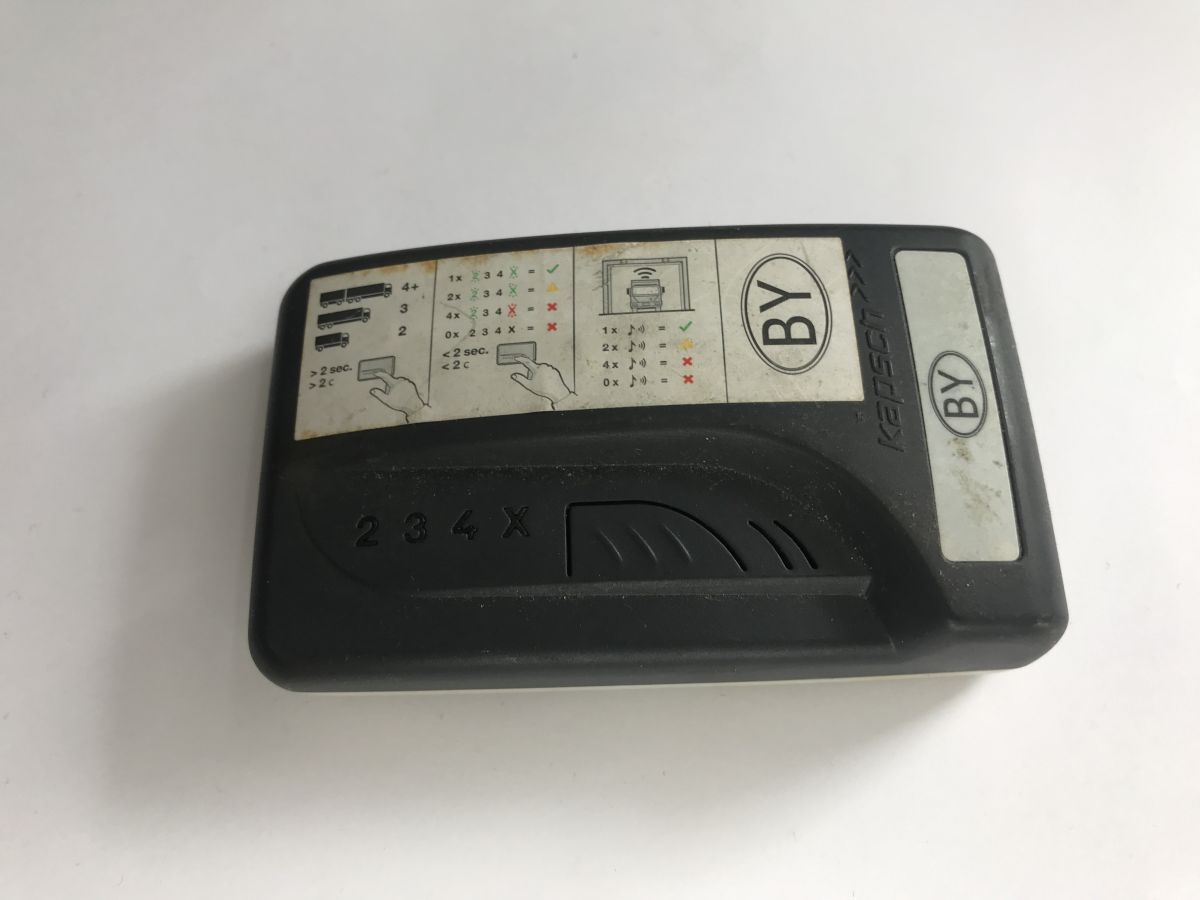

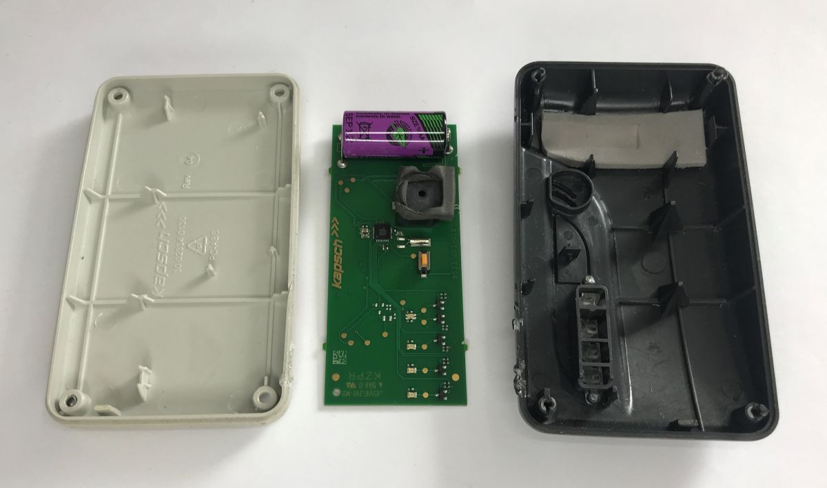

Today we are taking a look inside another automotive device, more specifically the Kapsch OBU-4041 (On-Board Unit). At first glance, it is an inconspicuous box with a single button, mounted on the windscreen of a truck. Its purpose is to interface with electronic toll collection systems. On the front, there is a single button which, when pressed for a long time, is used to select the number of axles; a short press shows the current setting. The separate numbers 2, 3 and 4 are illuminated by LEDs. Correct selection is the responsibility of the driver. The specific method of use is well illustrated by a sticker on the device itself:
A separate issue is the passage through the toll station. Communication is via an antenna mounted on a gantry above the toll road section. The driver is informed of correct toll collection by an audible signal. The device can operate in two modes: pre-pay and post-pay, depending on the contract concluded. A single beep indicates correct toll collection, two beeps indicate a low pre-pay account balance or low battery, and four beeps indicate that the toll has not been paid. If the toll is not collected, the system automatically takes a picture of the vehicle and sends it to the highway patrol after verification.

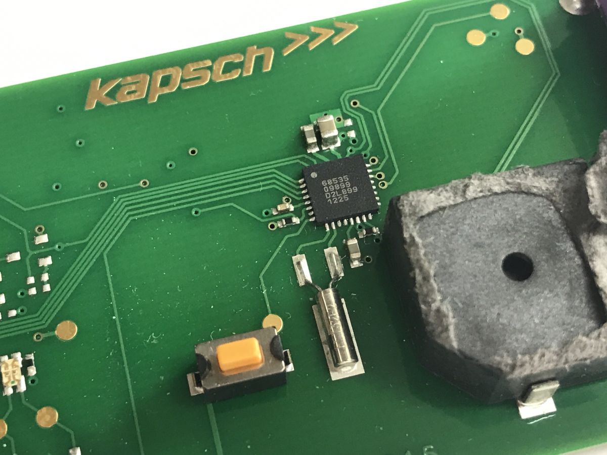

Time to look inside. I thought it was the screws in the corner, but they look more like rivets. I broke out the housing.

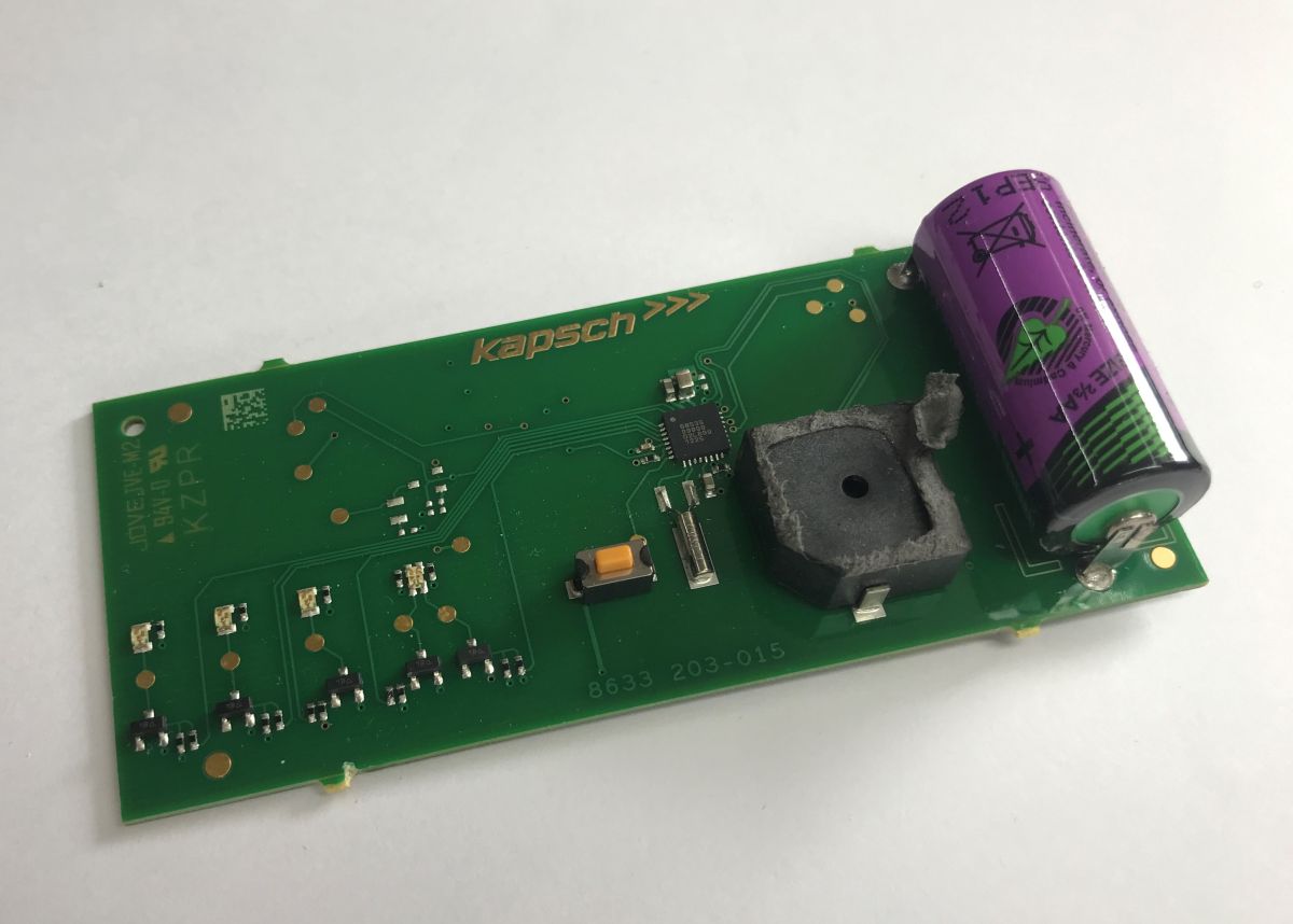

The board is simple - battery, buzzer, one IC with a quartz resonator, the aforementioned button, and, well, LEDs - interestingly, each with a transistor.

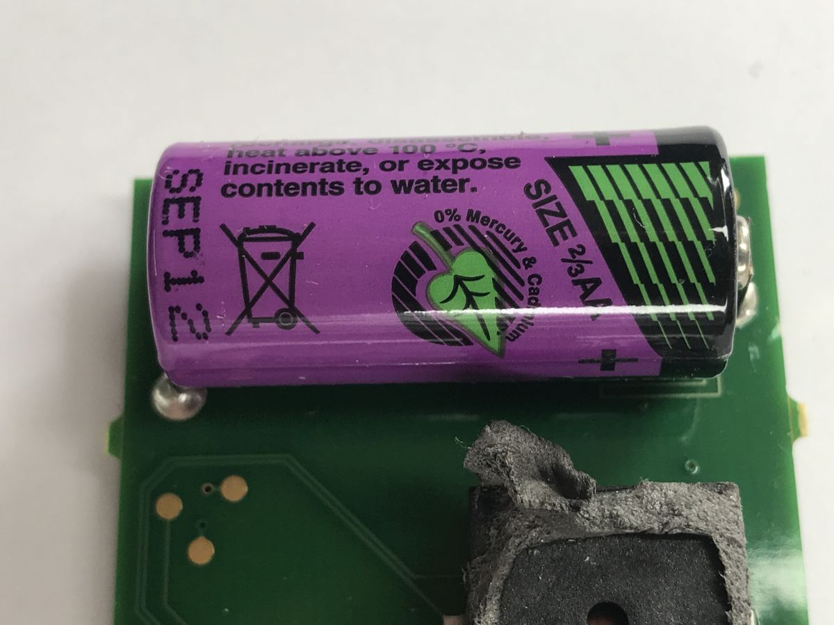

The battery used is a Tadiran 3.6V lithium battery, doesn't look replaceable at all. Presumably the whole thing needs so little power that it is disposable.
The main controller is 68535 09899 D2L899 1225 I couldn't find any information about it, maybe someone reading will have better luck?
Close-up of a Kapsch PCB with an IC, a push button, and a buzzer

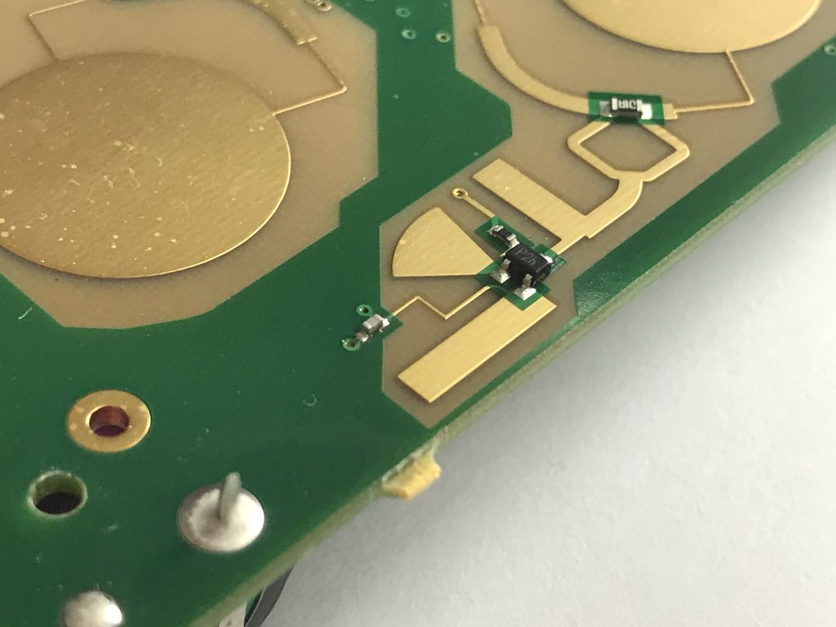

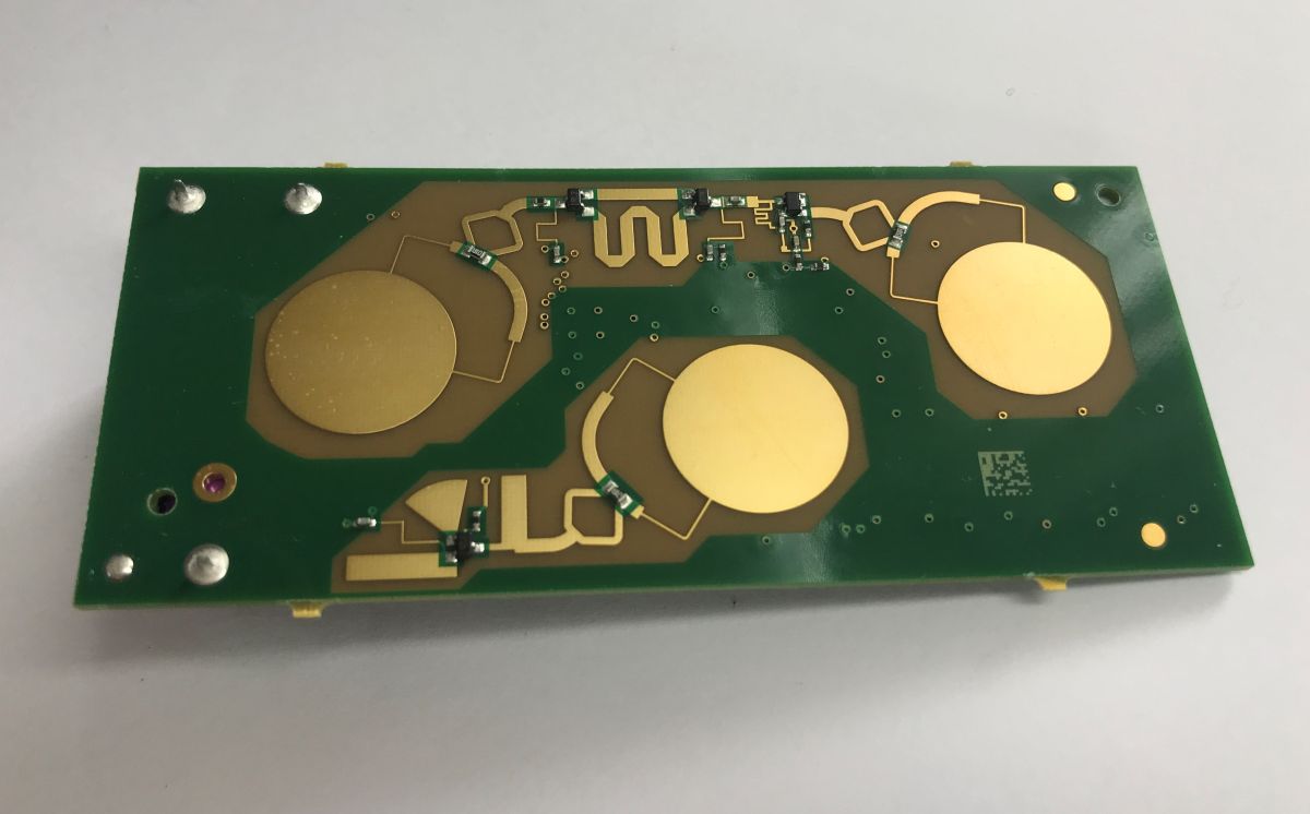

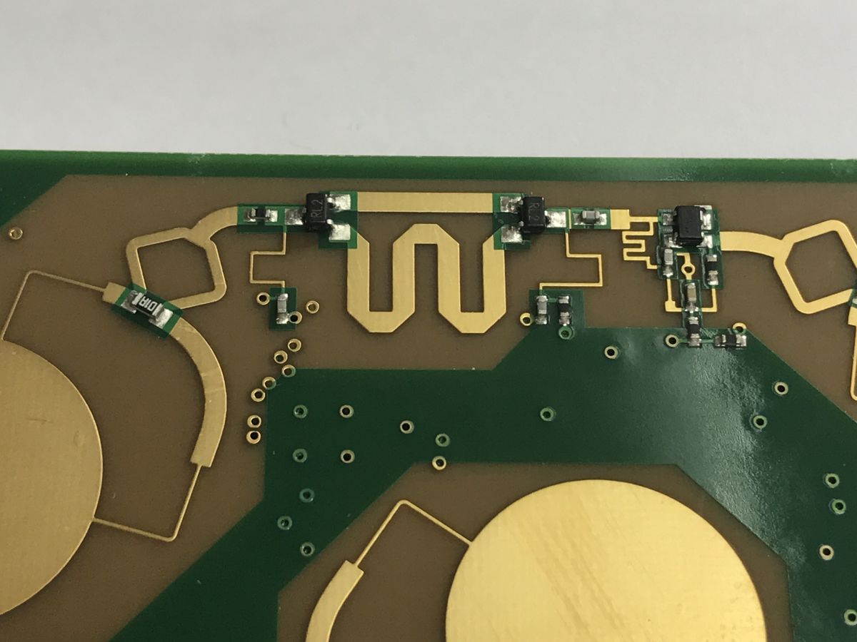

The most interesting thing is from the other side - it looks like we have microwave antennas here:
Green PCB with three large gold circular pads and gold traces, top view
Close-up of a PCB with gold antenna traces and small SMD components Close-up of a PCB with antenna-like copper areas and small SMD components
In summary, the Kapsch OBU-4041 is a very simple device for its application. Inside there is a single integrated circuit with a quartz resonator, a few discrete components, a buzzer, a button and LEDs to indicate the operating status. All the logic and operation of the device has thus been condensed to an absolute minimum, which suits its one specific task well. Probably the most interesting thing turned out to be the antennas. It's a pity I don't have access to the receiver, because then it would also be possible to see what further processes the requests - some kind of microcontroller, an SBC with GSM?
So much for my part in this topic, if anyone is able to add more, please feel free to do so. By the way, I can recommend a related topic about the transmitter from Car Sharing .

I suspect that under the gantry the field strength is high enough to induce a voltage in the detector and wake up the microcontroller and transciver, perhaps the data transmission is at a different frequency... [Read more]
szymon122 08 Jun 2026 07:00
My curiosity is always triggered when I see such shapes that have an "electronic" function in addition to their interesting appearance. Do any of you have any leads on an abridged article on this subject? I'd... [Read more]
zozur 09 Jun 2026 22:50
Such devices operated the viaTOLL toll system in Poland, which is now no longer in force. Problems included a non-replaceable battery and the need to drive off the toll road in the event of a breakdown... [Read more]
olelek 10 Jun 2026 10:56
Thank you for presenting the device. I am not from the industry myself, so I was not even aware of the technical solutions of the Viatoll system. Personally, I would say that the device is complex, just... [Read more]

Pre-pay Toll is charged against a prepaid balance 1 beep = paid, 2 beeps = low balance or low battery, 4 beeps = unpaid Balance can be too low
Post-pay Toll is charged under a contract after passage 1 beep = paid, 4 beeps = unpaid Failed collection still triggers enforcement
Key insight: The hardware is minimal, but the billing result is not automatic. The driver must set 2, 3, or 4 axles correctly before passing the gantry.
  • The unit has a single front button and three axle indicators labeled 2, 3, and 4, so the driver can select the billing class directly on the windscreen-mounted device. [#21916832]

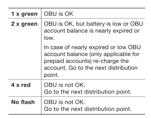

  • Audible feedback uses three distinct outcomes: 1 beep for correct toll collection, 2 beeps for low pre-pay balance or low battery, and 4 beeps when the toll is not paid. [#21916832]

How do you change and check the axle count setting on the Kapsch OBU-4041 using its single button?
You use the single button to set and verify the axle count. 1. Press and hold the button to change the setting. 2. Press briefly to show the current setting. 3. Read the lit LED for 2, 3, or 4 axles. The thread states that correct selection is the driver's responsibility, so this step directly affects billing. [#21916832]
