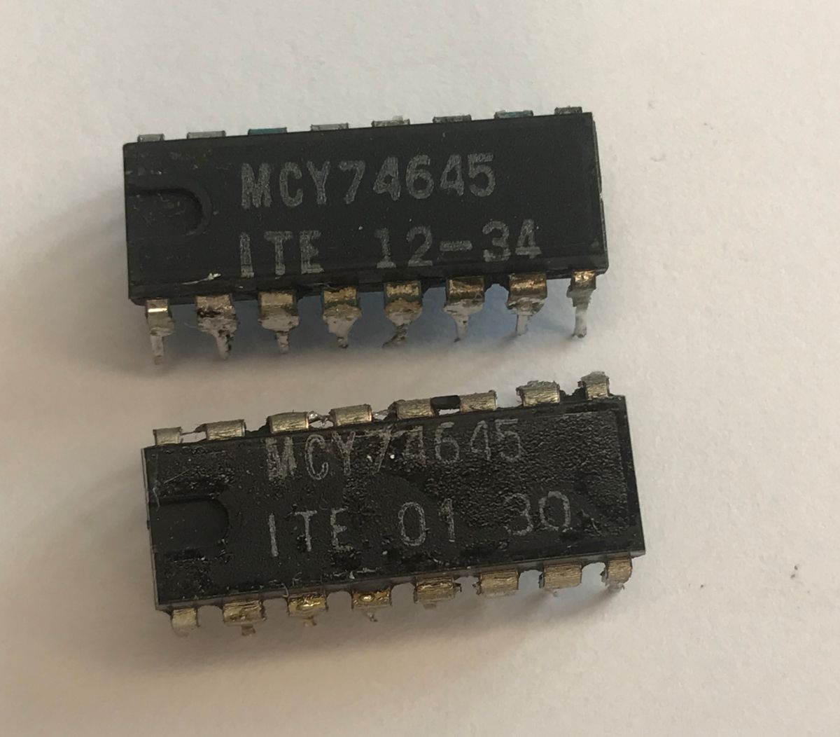

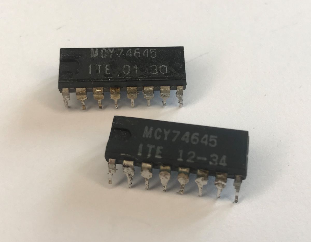

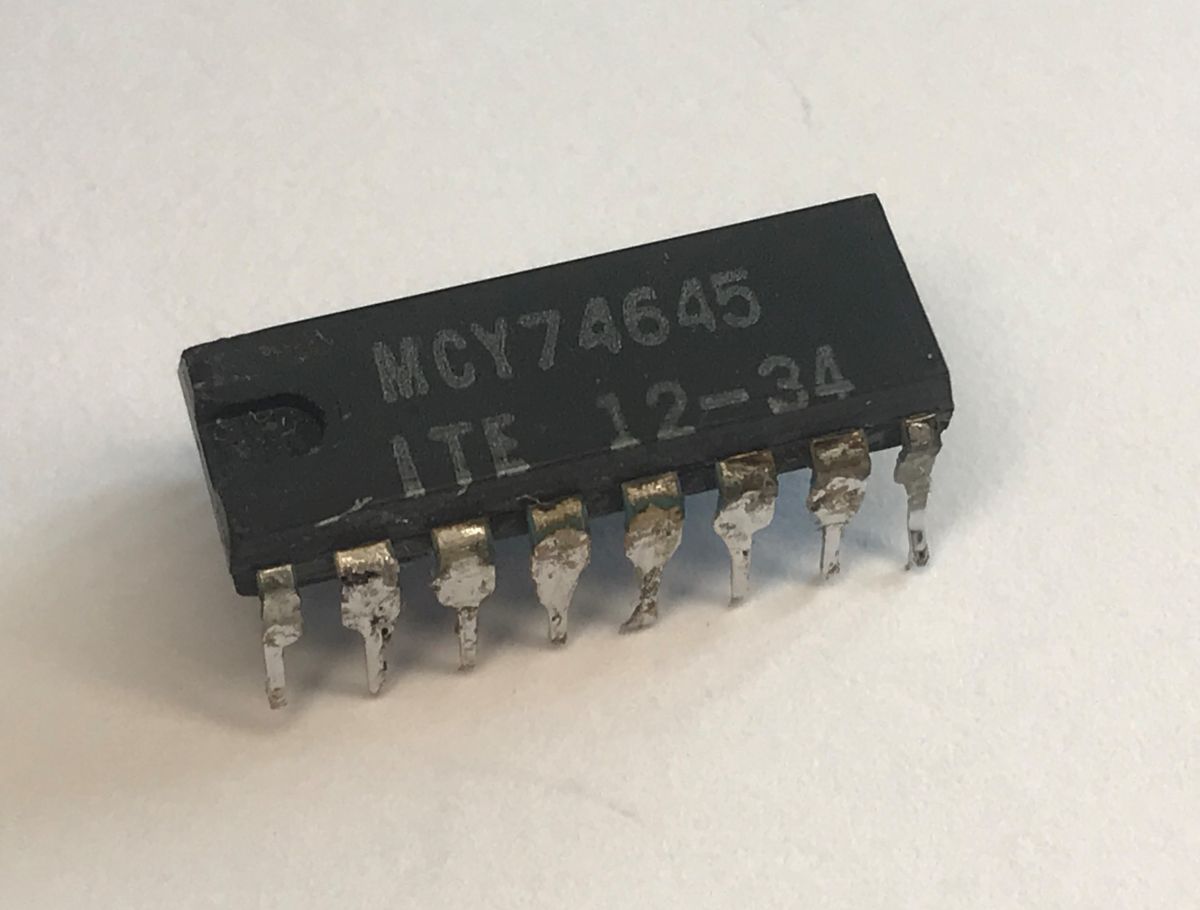

    I haven’t been able to find its datasheet; it looks as though it’s some sort of chip for internal use. It has already been mentioned on our forum:

    At last, a Polish integrated circuit from ‘recent’ production. According to the ITE website, they were still manufacturing it as recently as 2012. Does anyone know if they’re still mass-producing anything at all these days?
  • Polish ASIC design capability questioned
    #3 21935237
    maciej_333
    Posts: 4249
    Help: 488
    Rate: 1611
    In the 2012 report I found a reference to this chip:
    Excerpt from a 2012 ITE report about small-series services and production of ASIC MCY 74645
    I wonder why anyone would make an ASIC when a microcontroller would suffice here. There are Chinese chips, such as the EM78, which are very attractively priced. Apparently, there was some government funding involved, as otherwise there would have been no chance of something like this happening. The aim was probably to maintain at least a minimal level of domestic expertise in this field. On the other hand, there’s talk of selling this chip, not of manufacturing it. Was it actually produced here???
    Is anything else being done in this area? Generally speaking, on the website ITE there is nothing up to date, as some sort of restructuring took place in 2020. You could try searching on the website IMiF . There are colour photos and some descriptions – but absolutely nothing can be made of it. It’s all pretty, saccharine and meaningless. The subpages don’t exist. However, it clearly states that:
    The Institute has a team of specialists engaged in the design of specialised integrated circuits (ASICs) and electronic systems for a wide range of applications in industry, defence, medicine and science. Our experts specialise in analogue, digital and mixed-signal solutions. Our proprietary solutions for specialised readout electronics (ROIC) integrate sensor and detector systems with communication modules and network systems.
    Here there’s no question of any circuit being manufactured – only design. So I’m wondering if there’s still anyone in Poland capable of doing this. Perhaps my colleague @AlekZ will know more.

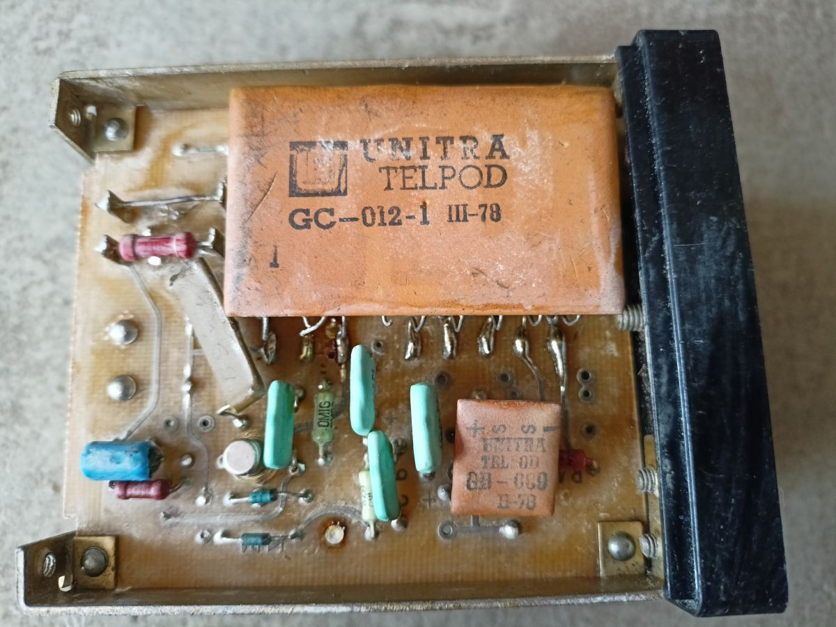

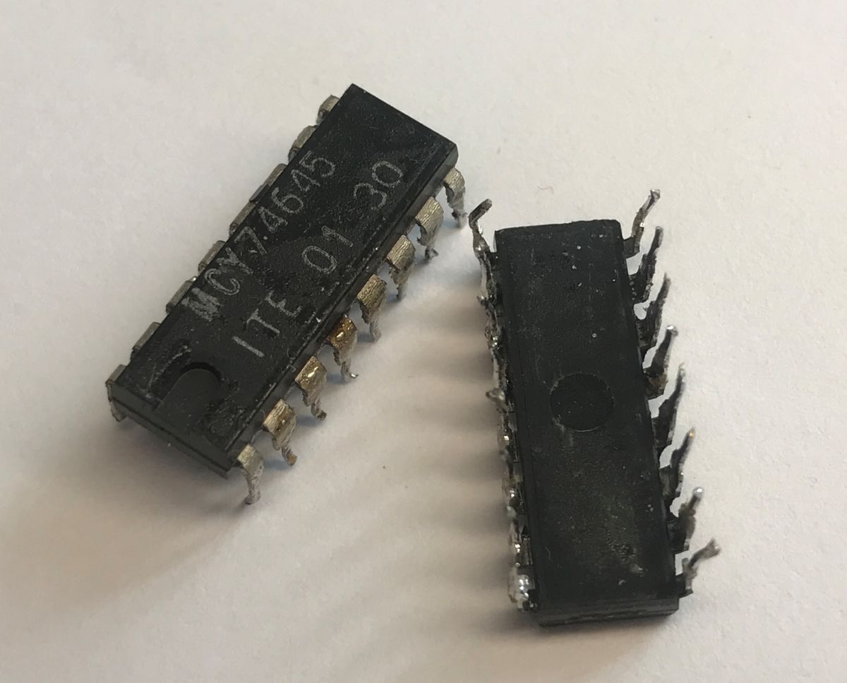

    In the end, I came to an agreement with the owner of the website http://retrokolekcja.pl/ and sent him two MCY74645 relays free of charge. Some farewell photos:
    The interior of the RTx-132 electronic timer, Made in Poland (MCY74645?) The interior of the RTx-132 electronic timer, Made in Poland (MCY74645?) The interior of the RTx-132 electronic timer, Made in Poland (MCY74645?) The interior of the RTx-132 electronic timer, Made in Poland (MCY74645?)

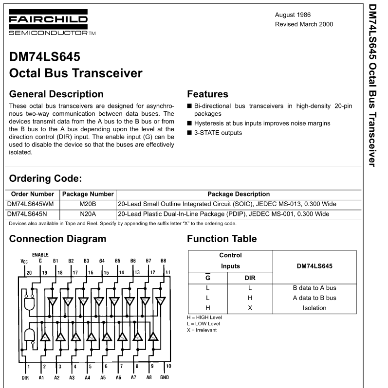

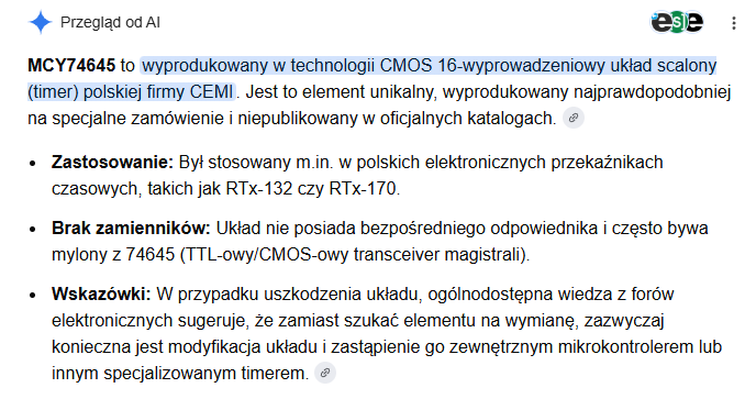

    I couldn’t find its data sheet; it looks like some sort of chip for internal use.
    There is a data sheet for the 74645 chip without the letters ‘MCY’; I’ll ignore the letters ‘LS’, but that’s a completely different integrated circuit.
    Fairchild DM74LS645 datasheet page with function table and pin connection diagram

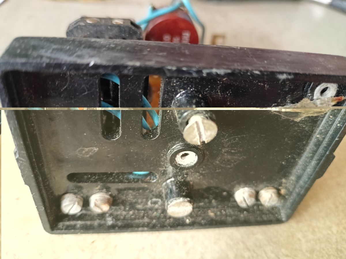

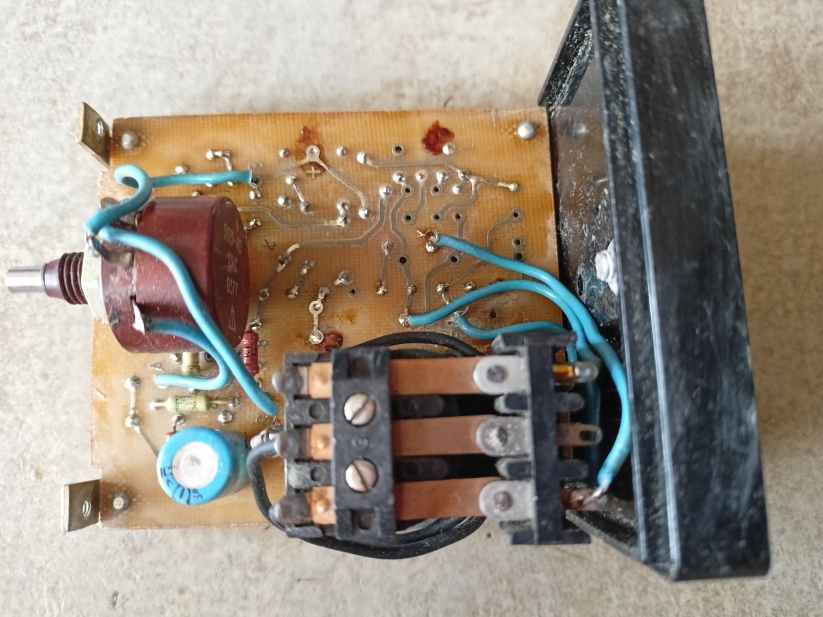

    And what does Wiki have to say on this subject?The interior of the RTx-132 electronic timer, Made in Poland (MCY74645?)
    I’ve probably managed to preserve the predecessor of this relay.
    The interior of the RTx-132 electronic timer, Made in Poland (MCY74645?) The interior of the RTx-132 electronic timer, Made in Poland (MCY74645?) Close-up of a black device housing with vent slots, screws, and internal wires visible.
    There is absolutely no indication that this is the chip in question. The description of the 74645 given here bears no relation to the MCY74645 and its application in this time relay.

    maciej_333 wrote:
    There is absolutely no indication that this is the correct chip.
    I am well aware of that. That is why I posted a screenshot of the data sheet for the ‘standard’ 74LN645 chip, which, apart from having the same part number, has nothing in common with the MCY74546 chip.
    gregor124 wrote:
    If you’re looking for something similar amongst TTL chips, the MCY74645 is closer to the 74123 than to the 74645
    There is also another TTL timer chip – the 74121.
