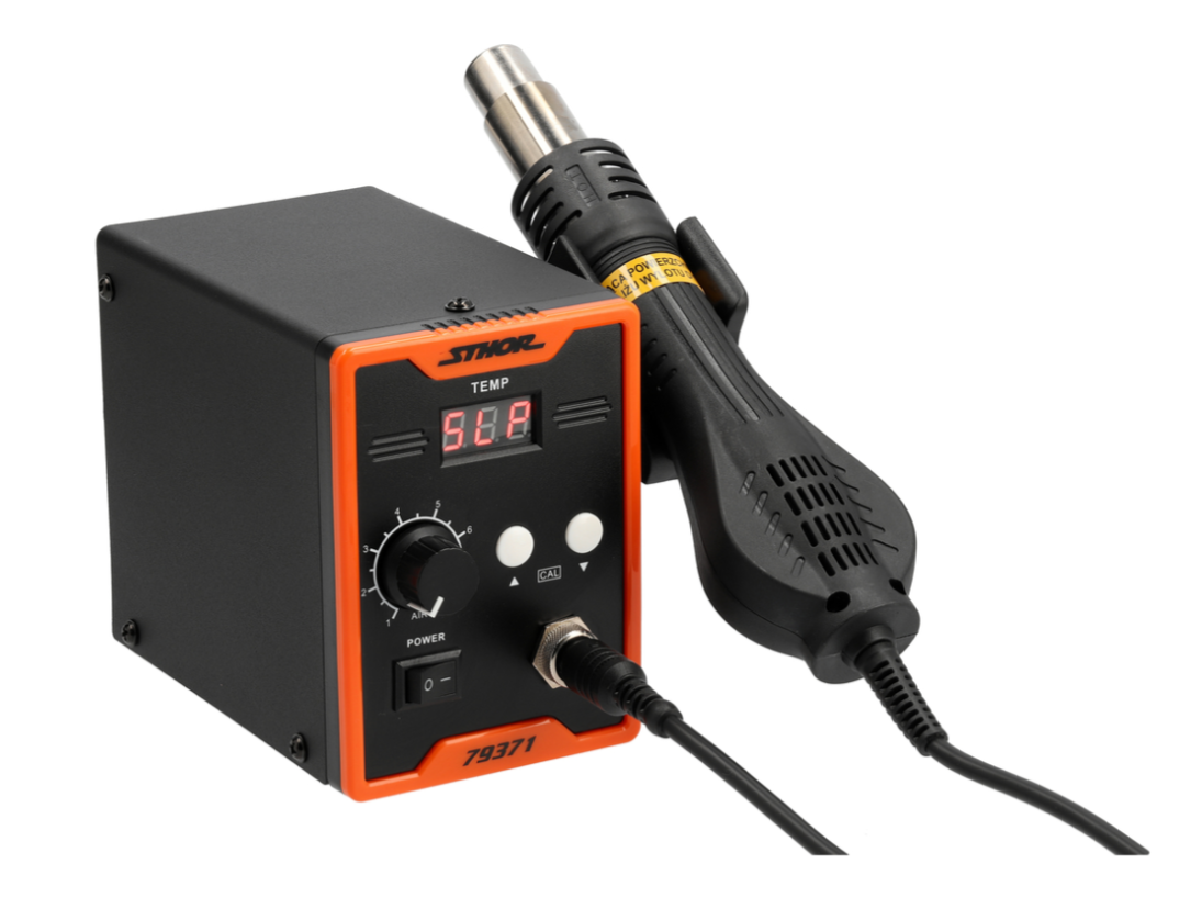

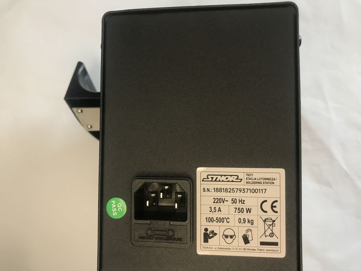

So let’s start with the general information. The brand of this station is Sthor, manufacturer’s code 79371, although it is imported by TOYA. The rated power is 750 W, and the temperature can be adjusted from 100 to 500 degrees. Airflow up to 120 l/min. The handle features a brushless fan and a hibernation sensor.
For around 70 zlotys, the set includes three nozzles, the station and a cable.

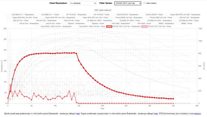

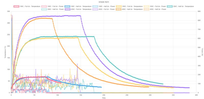

I carried out the measurements using my kit described in a separate thread: OpenBeken configuration for hot air tests – MAX6675, temperature and power logging

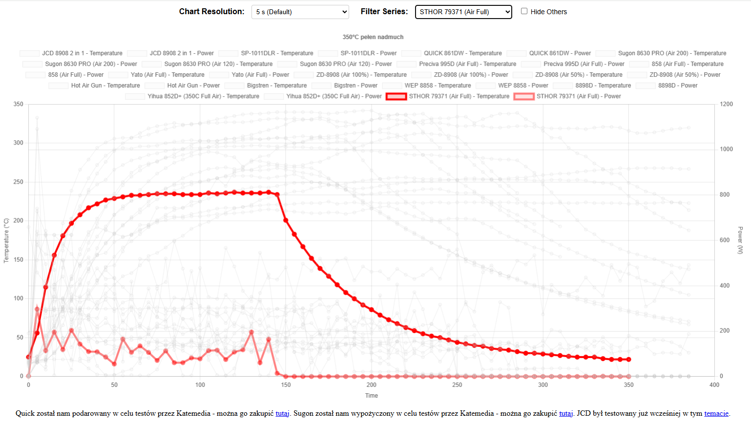

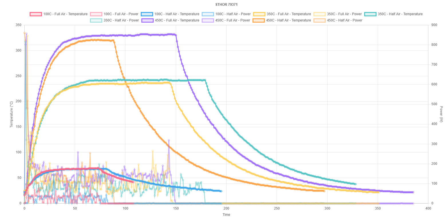

I tested three temperatures – 100°C, 350°C and 450°C, each at full and half fan speed.
Interactive version: https://openshwprojects.github.io/hotair/STHOR79371.html
Well... my Sugon, set to 350 °, reached 320 ° on the probe; I checked this with the same fan setting as here, although I didn’t measure the actual fan speed. STHOR is around 100° lower. At 450°, the situation is similar, with a difference of over 100° as well. Interestingly, a similar drop occurs even at the 100° setting. Reducing the fan speed does not help at all here.
Separately, I compared the unit to other tested models:
The same problem occurs here; the readings on the display are significantly higher than those on the probe. What’s more, when compared to the classic 858, one could even say that 450 °C here is equivalent to 350 °C on the 858...
Interactive versions:
https://openshwprojects.github.io/hotair/version12/350c.html
https://openshwprojects.github.io/hotair/version12/450c.html
The power measurement also explains a lot – 700 W is only achieved right at the start, and then it is heated at a much lower power.

We’ll also take a look at the sticker with the manufacturer’s information. On the back, there is a socket and a fuse slot.

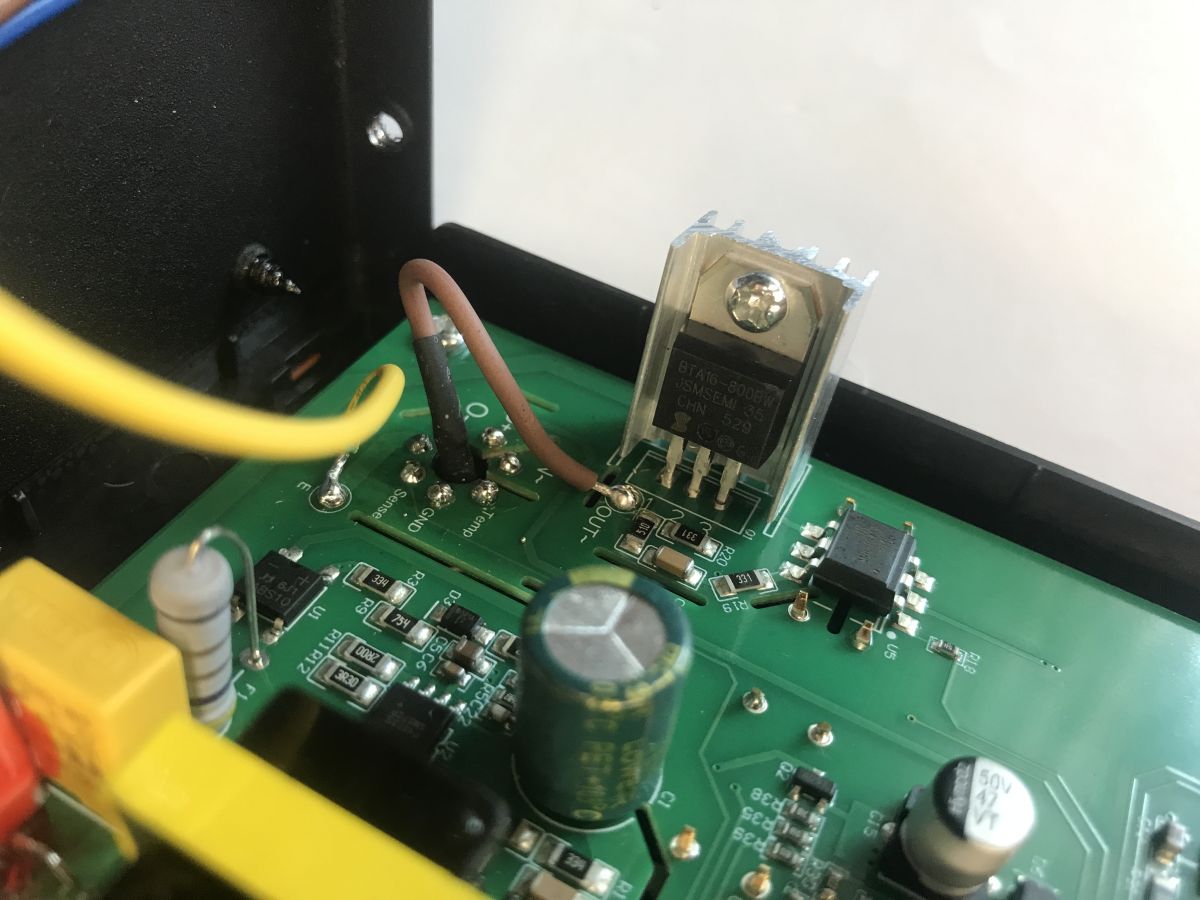

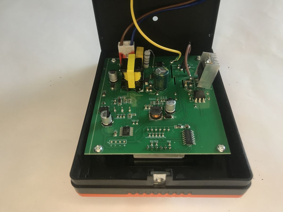

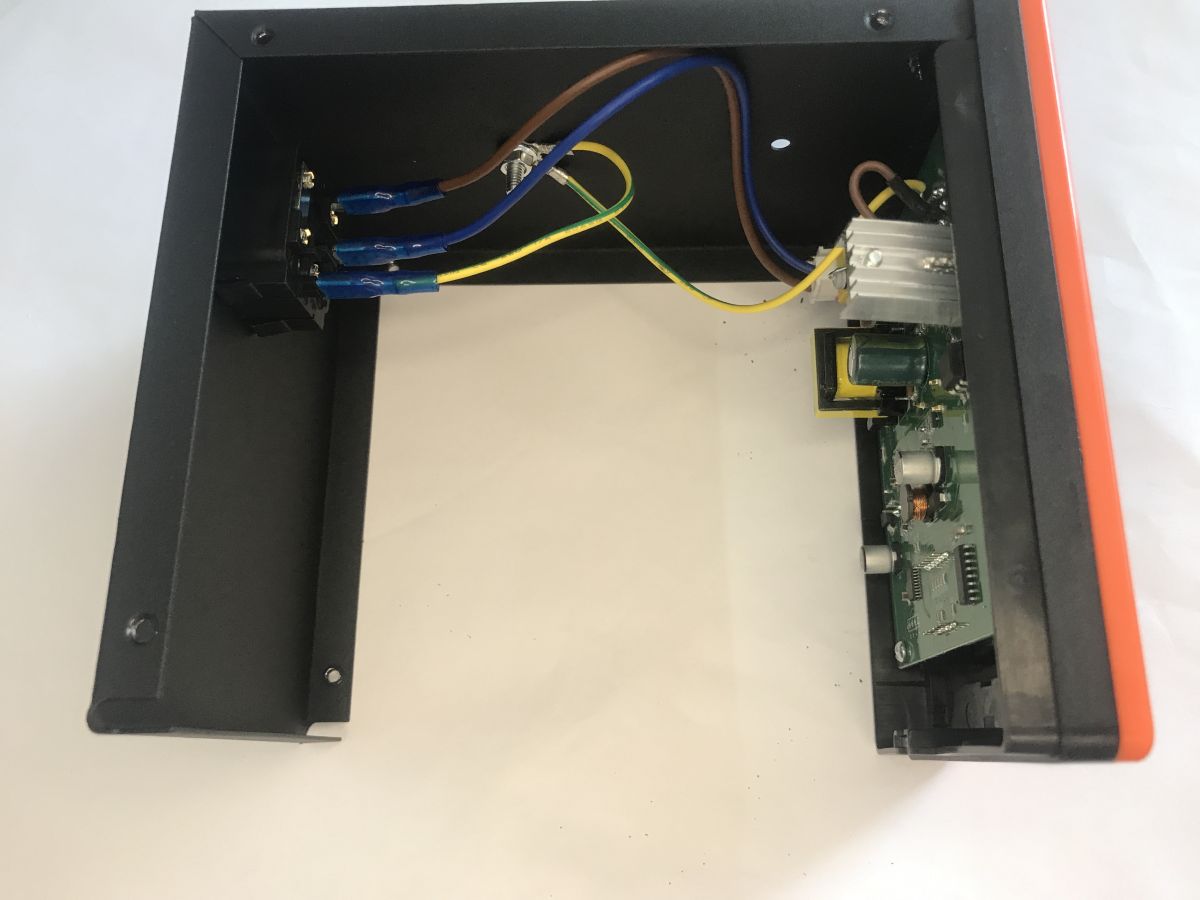

We unscrew the screws and remove the casing. Inside, it’s basically… very empty, which comes as no surprise. The station is very light.

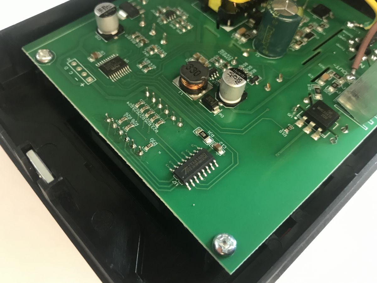

So does it work fully on 230 V? Well, not quite – there is a tiny switching power supply inside. You can also see what is responsible for the digital control and the display.

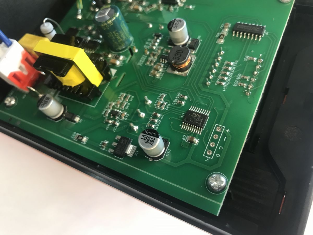

The display is controlled by the TM1650, a controller with a protocol similar to I2C, but without addressing.
The MCU is a Puya PY32F002B, a tiny but already 32-bit microcontroller based on the ARM® Cortex®-M0+ core with 24 KB of Flash memory and 3 KB of RAM. These days, even 8-bit chips are slowly becoming uneconomical, as their 32-bit equivalents are just as cheap...

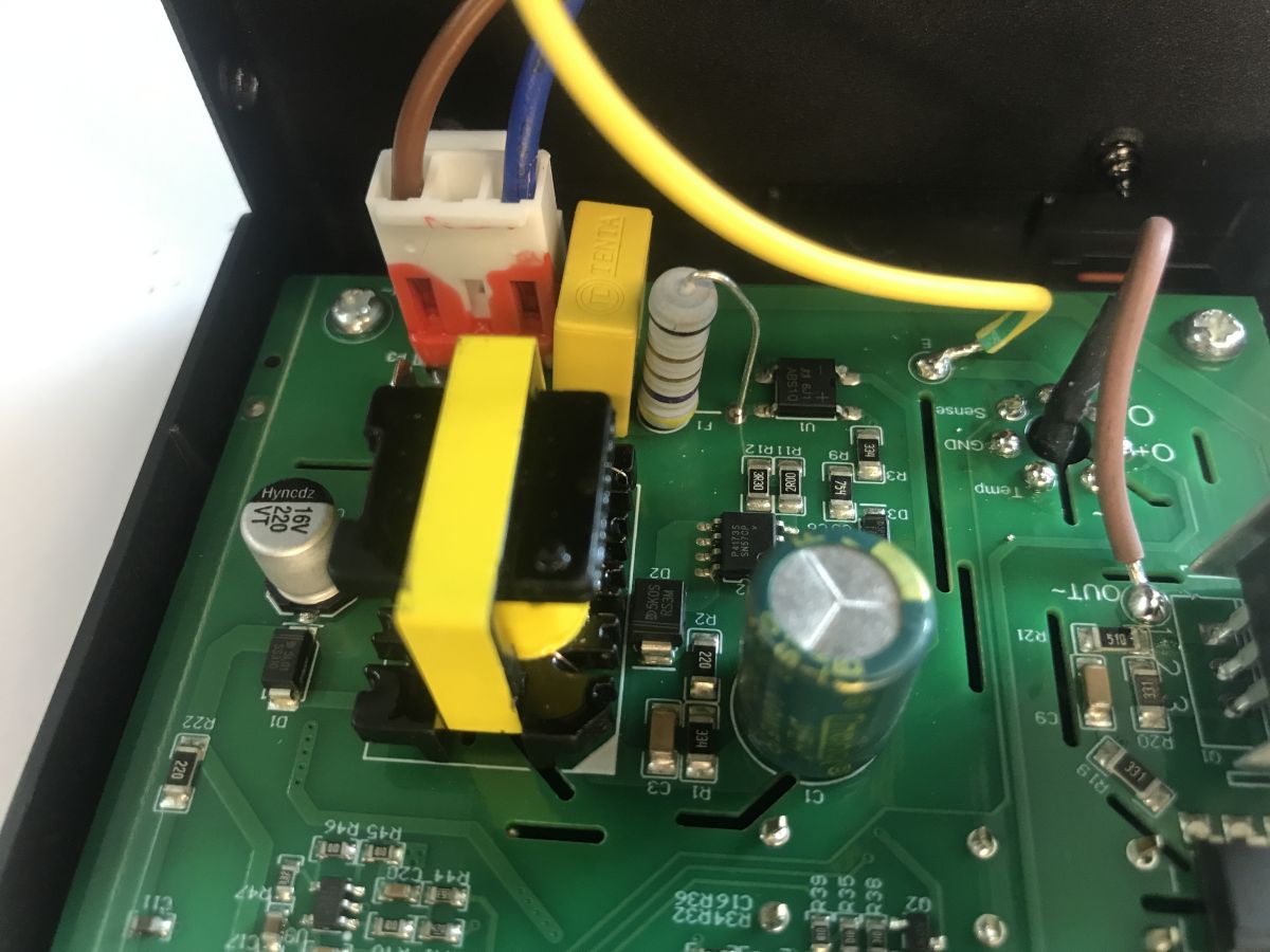

In the high-voltage section, we have a BTA16-800BW triac with a driver; it is used to regulate the heater power directly from the mains and is controlled by the MOC3041.

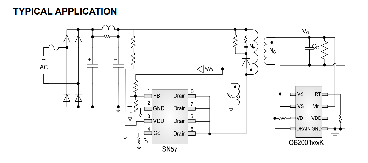

You can also take a look at this power supply section. At the input, there is a capacitor acting as a filter and a fuse resistor. The converter is based on the SN57CP.

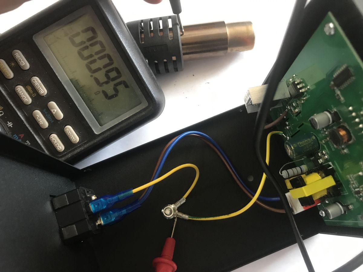

The protective wire is connected to the hot air nozzle:
