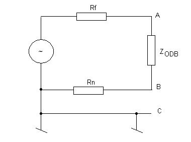

    We consider the circuit in which we have:
    1) power source - transformer
    2) phase conductor resistance - wire resistance
    3) receiver - also some resistance or impedance
    4) resistance of the neutral conductor - wire resistance.
    Risk of Electric Shock from Touching a Live Neutral Conductor
    If current flows through the receiver, voltage drops occur on the resistances Rf, Z and Rn. Thus, at point A there is a potential higher than at point B. Since the resistances Rf and Rn are smaller than the impedance Z, the voltage drop at the receiver is also the greatest - almost an inch of the supply voltage.
    Suppose that Rf and Rn have a resistance of about 1 Ohm (probable values) and that the Z of the receiver is a resistance (2kW heater) of about 26.5 Ohm. Power supply, of course, 230V; The current consumed is:
    I = U / R where R is Rf + Z + Rn -> I = 230 / 28.5 = 8.07A
    The voltage drop across Rf is:
    Uf = I * Rf = 8.07V
    For Rn we have the same, so the voltage drop across the receiver is:
    Uz = 230-2 * 8.07 = 214V (almost).
    This means that the potential of point A with respect to ground (ground) is 214 + 8.07 = 222.07V.
    Point B has a potential to ground of 8.07V.
    Assuming now that a 1000 Ohm resistance is connected between points B and C (human model), we get that as a result of the potential difference of these points, a current of the value:
    I = U / R = 8.07 / 1000 = 8.07mA.
    In such a situation, the RCD should not trip, because its activation threshold is about 50% of the rated value (if we have 30mA, the activation threshold is 15mA). If it works, it means that the resistance of the neutral wire is greater. Let's see that it is enough to increase the value of the resistance Rn twice, which is also not very improbable and we already have a potential of about 16V at point B with respect to ground. This will allow the current to activate the residual current device to flow.
    So summing up:
    The current flows through the neutral conductor during normal operation of the device. Therefore, a protective conductor has been separated in which no current can flow during normal operation.
    Nevertheless, the potential of the neutral conductor to ground is relatively small and results from the resistance of the conductors.
    Since there is some potential with respect to the ground of the neutral, it is possible for the current to flow through the "human model" to ground. This is due to Kirchhoff's law.
