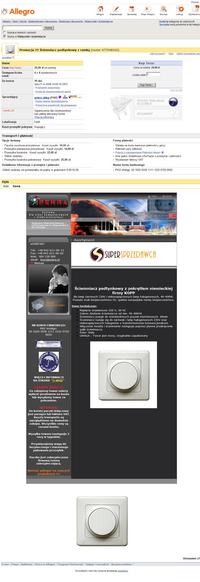

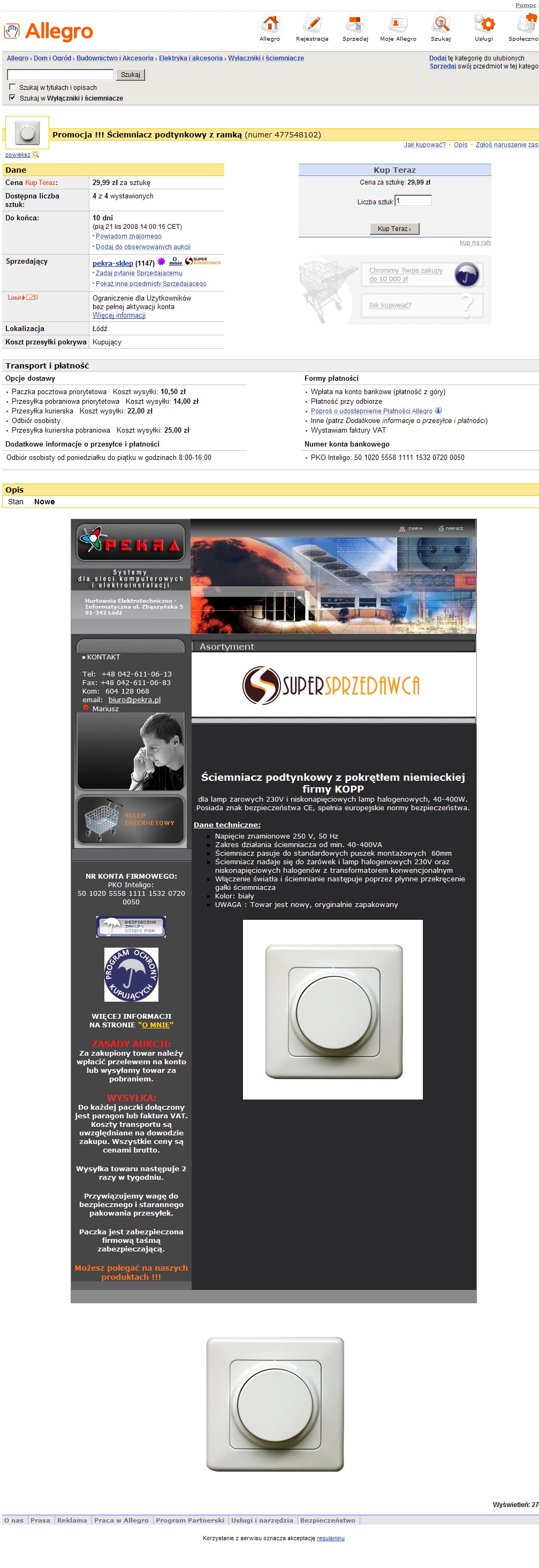

    Hello, they are available and I bought one in NOMI for 20 or 30 zlotys. Pressing you switch it on and turning it dims. All in one.
    Even on the Allegro and I would recommend these because they are nicer than the ones with Nomi :D

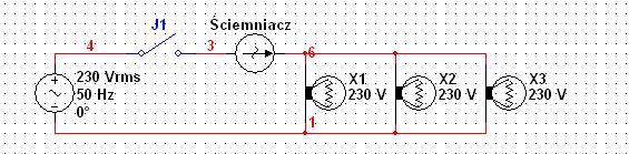

    Do they cooperate ... but why do you need an ordinary switch, like him, with a dimmer built in? Below is the connection diagram (the switch is not needed because the one I mentioned above already has it).
    Staircase Switch with Dimmer: Economical Options for Multi-Lamp Stair Lighting
    Hmm .... do you know the principle of operation of the staircase switch?

    Oh Arturo2005 ... I think I gave a stain - I admit :)
    Everything is nice, but it is not a stair switch, which I presented. And only an ordinary switch.
