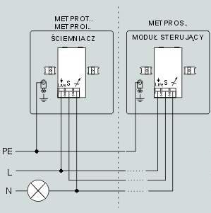

    EMC / Govena used to offer a touch dimmer with an additional module / s.
    In one box there is a dimmer and lighting connected to it.
    In the second box, you install an additional control module (this is not a second dimmer, but the main dimmer control).
    Here is the connection diagram:
    Connecting Dimmer with Staircase Switch: Step-by-Step Guide & Wiring Diagram Explanationemc_sciemn...-moduł.jpg (18.28 kB)You must be logged in to download this attachment.
    You can connect several such modules:
    Connecting Dimmer with Staircase Switch: Step-by-Step Guide & Wiring Diagram Explanationemc_sciem..cz.jpg (15.55 kB)You must be logged in to download this attachment.
    You only need three wires + PE wire between the boxes.
    In this case, you have control from each point (on / off and regulation)

    MarianK98 wrote:
    I recently replaced the cable with a 4-core cable, so it's cool where to buy it?
    I don't want to advertise anyone, so please google: METPROS1
    There are several vendors that offer this.
