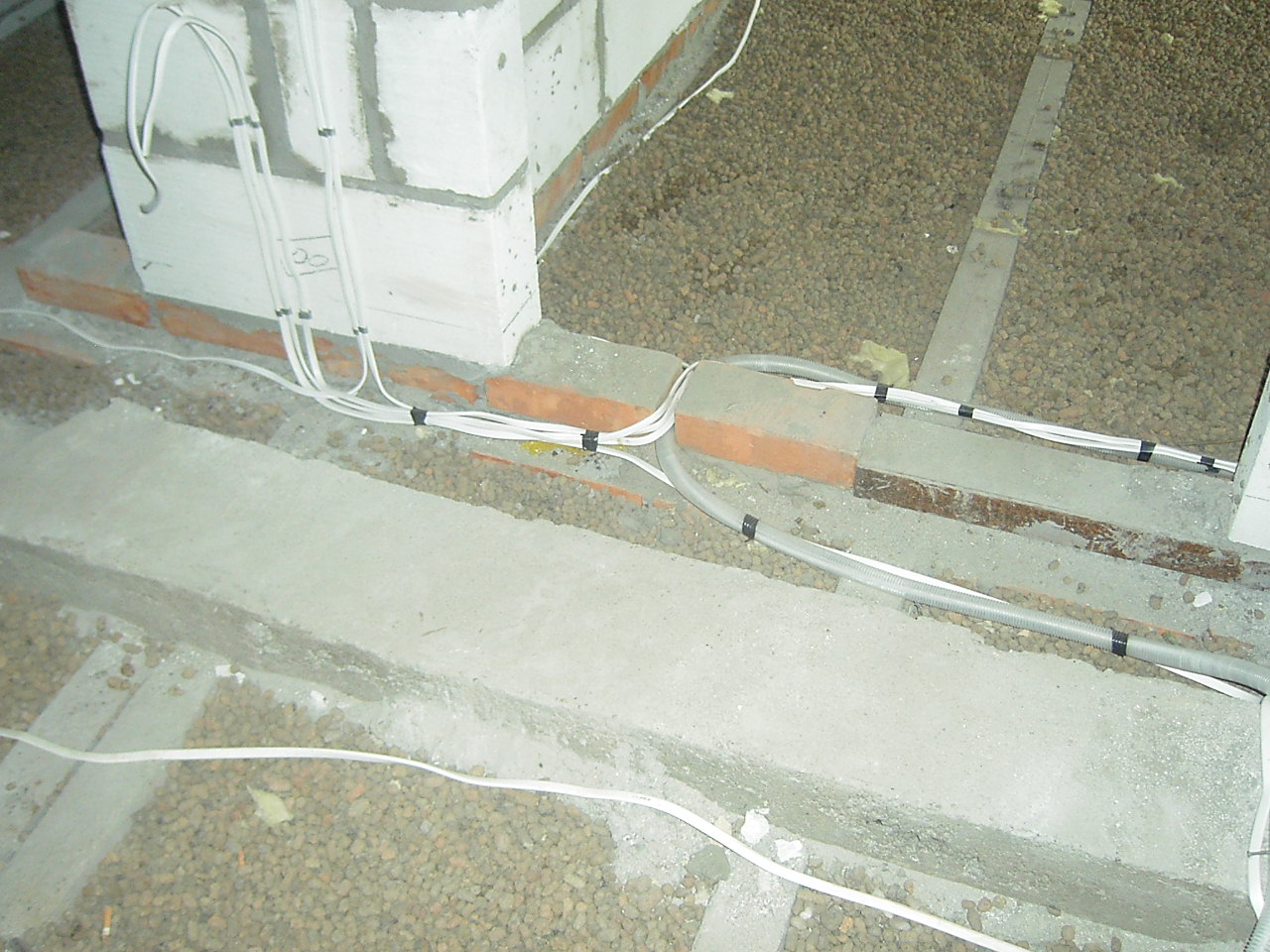

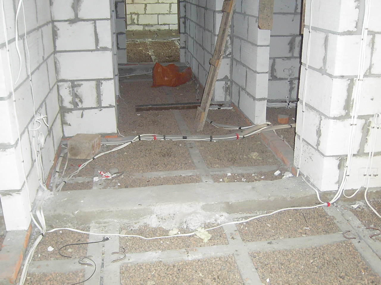

    I read, I read about these passes and .... I still have no idea why the people are adding robots. When it comes to increasing the cost of implementation, it is OK, the spread is 17 euro for 200 running meters, the conduit has a price, the location is also not free. For such a job, you have to pay 12,000. The investor is happy because he has nice pellets flooded with concrete :) . And you can not just lay the wires under the walls, if there are passages, then a metal trough of 1 meter should be mounted with two expansion pins ???
  • #32 11908311
    Łukasz-O
    Admin of electroenergetics
    Posts: 21789
    Help: 654
    Rate: 4292
    Do you mean such performance?

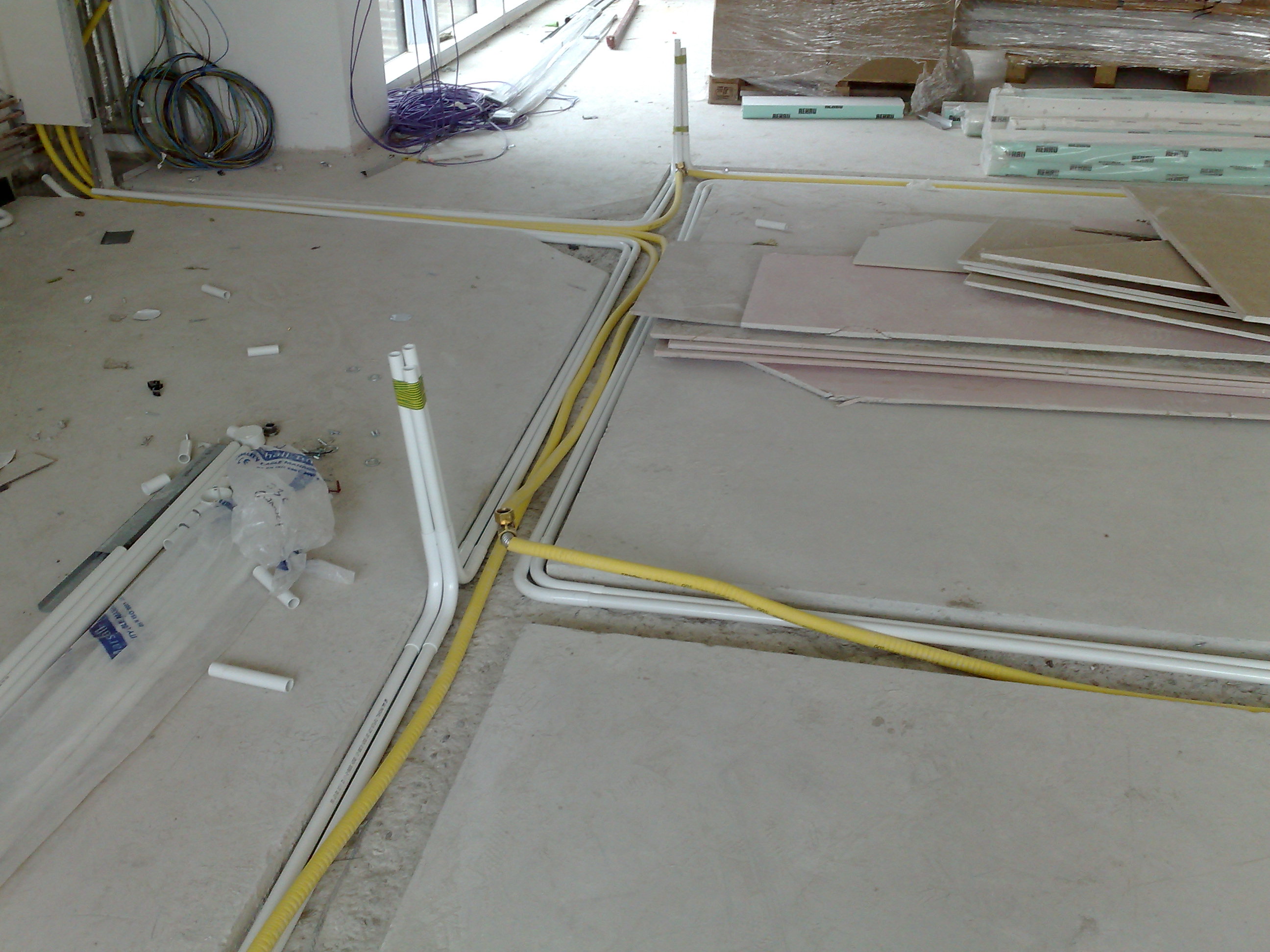

    Or such? :
    Straightening a Haupa Perlon Pilot for Cable Threading in Conduits Straightening a Haupa Perlon Pilot for Cable Threading in Conduits Straightening a Haupa Perlon Pilot for Cable Threading in Conduits
