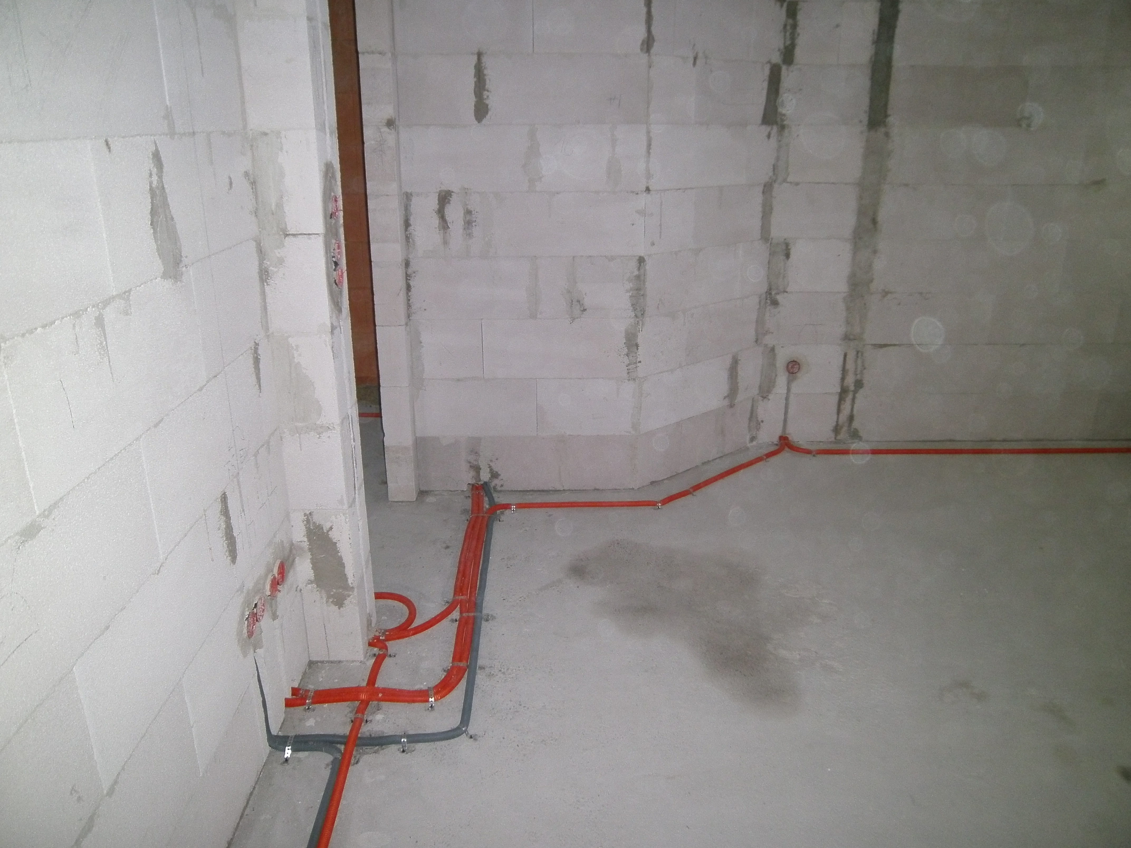

    Ac these conduits could no longer be brought to cans?
    Or maybe some photos after plasterers have passed?
    Metal straps as a fastening are also probably not the best solution.

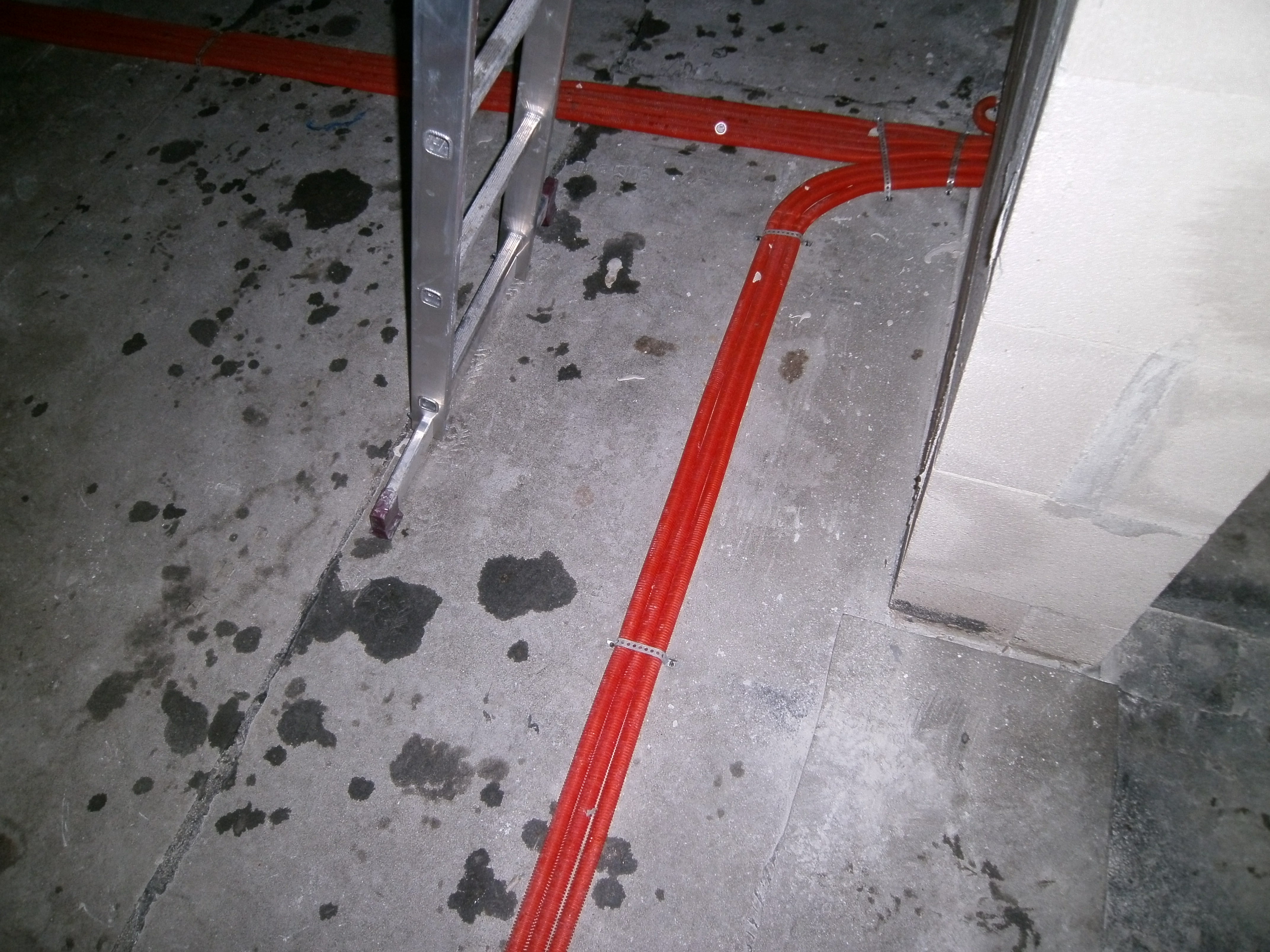

    Once, in a difficult case, I managed to pull the remote control out of the line with an industrial vacuum cleaner.
  • #23 11904820
    bulbulatrix
    Posts: 107
    AIO - professed! and exactly like with me, even Silka the same, polystyrene and only exchangeable conduits ;) and we are talking about them right now!
    I only have a question about the conduits that you put right away with the remote control - how to make it not a one-time haul? withdraw it all over the place using 2 times the cable pulled in?
    Where can you buy this liniment / what to ask so that they do not make big eyes in DIY stores? (after googling, mainly Durex pops up; D)

    I don't think he will do steel pipes in the floor. This is why the site manager is in charge of supervising the work of the builders and preventing it from being destroyed.
