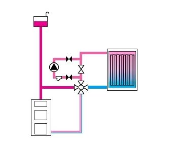

    The four-way valve in an installation with a solid fuel boiler (coal, wood) is used to increase the operating temperature of the boiler (better combustion, higher efficiency)
    and at the same time keep the temperature of the radiators reasonable.
    The idea of the construction of the valve - it looks more or less like in the picture:
    Guidelines on Setting a Manually Controlled, Four-Way Valve for CO Installation - Damian's Query
    By adjusting the diaphragm in the middle of the valve, you change the proportions of the amount of heat returning to the stove and thus delivered to the radiators. In the "0" position, you have a "closed" stove (a useful feature of this valve for the summer if you want to heat your hot water with a boiler connected in front of the valve and at the same time you do not heat the house).
    However, in the "100" position there is a "no valve" system - all the heat from the furnace is sent to the radiators.
    In the second picture, a typical connection diagram:
    How to set it?
    So that the stove was about 80 degrees C and in the rooms such a temperature as you want :-)
