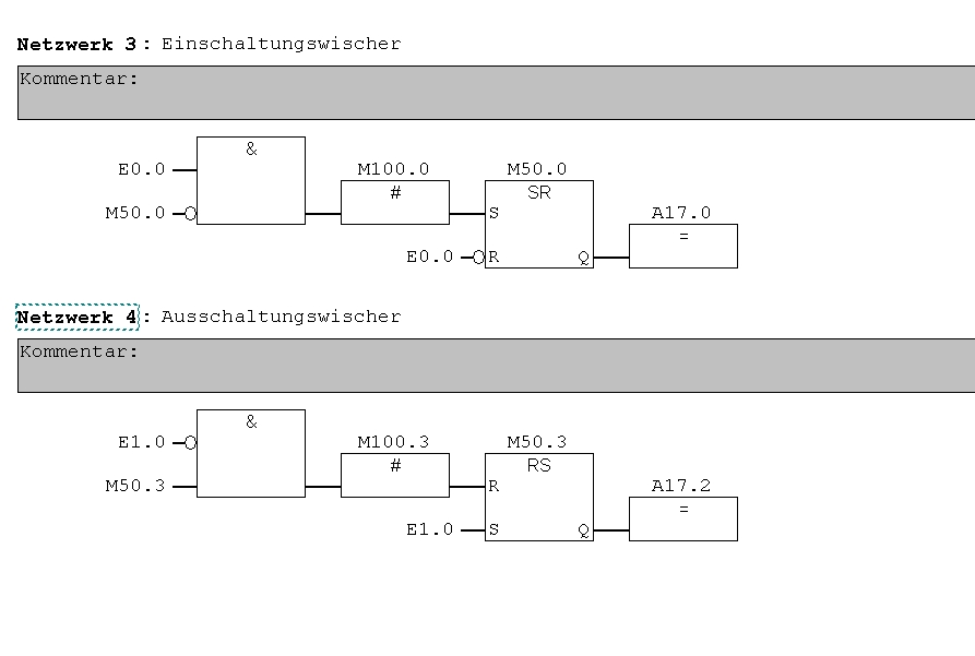

    Or maybe otherwise. Shown below are two circuits built from logic blocks in S7, in which a rising edge (Figure 1) and a falling edge (Figure 2) are realized.
    Understanding Rising & Falling Edges in Driver Programming: S5 & S7, Diagrams & Examples
    Description of the given sizes:
    E0.0; E1.0 - input signal (e.g. some disturbance)
    M50.0; M50.3 - auxiliary parameter (flank memory)
    M100.0; M103.0 - auxiliary parameter (pulse memory)
    A17.0; A17.2 - outputs
    Could someone explain to me step by step or cycle by cycle, what logical values will appear on the appropriate inputs and outputs and how should I recognize that the first system is up to the rising slope and the second to the falling slope?

    Regarding the rising edge:
    Pressing the E0.0 button
    1 driver cycle:
    -Inquiry of inputs and markers:
    E0.0 = 1
    M100.0 = 0
    M50.0 = 0
    A17.0 = 0
    saving these states in memory before logical joining operations.
    -Logical joins, as a result of it:
    Activation of the M100.0 marker = 1
    setting M50.0 = 1
    A17.0 = 1
    - display of outputs and markers
    M100.0 = 1
    M50.0 = 1
    A17.0 = 1
    2nd cycle:
    E0.0 = 1
    M100.0 = 1
    M50.0 = 1
    A17.0 = 1
    disable M100.0 = 0
    because it works
    M50.0 = 1
    and passing this link to the output:
    M100.0 = 0
    M50.0 = 1
    A17.0 = 1
    The next cycles of the controller remain unchanged when E0.0 is activated
    Disabling E0.0 will cause the
    M50.0 = 0
    A17.0 = 0
    !!! will not change the state of M100.0 !!!!
    Conclusions: M 100.0, in the case of E0.0 operation, generates one pulse equal to 1 controller operation cycle, this pulse begins at the rising edge of E0.0. The A17.0 output is not needed here.
    The M50.0 switches off the M100.0 after one cycle
    It is similar with the falling slope.
    Added after 4 [hours] 31 [minutes]:
    Falling slope. M100.3 gives a pulse = to the controller cycle when a falling edge is detected.
    We enclose E1.0
    The first cycle of the controller:
    Polling in, out, markers (markers):
    E1.0 = 1
    M100.3 = 0
    M50.3 = 0
    A17.2 = 0
    Logical linking:
    E1.0 = 1
    M100.3 = 0 !! no reaction to the build-up !!
    M 50.3 = 1
    A 17.2 = 1
    Rewrite linking to output:
    E1.0 = 1
    M100.3 = 0
    M 50.3 = 1
    A 17.2 = 1
    End of the first cycle.
    If E1.0 = 1 is still on, then nothing happens in the next cycles. Only after releasing E1.0 the following changes occur:
    Polling in, out, tags:
    beginning of the cycle
    E1.0 = 0
    M100.3 = 0
    M 50.3 = 1
    A 17.2 = 1
    Logical linking:
    E1.0 = 0
    M100.3 = 1 !!!!!! start of the pulse
    M 50.3 = 0
    A 17.2 = 0
    Rewriting for exit:
    E1.0 = 0
    M100.3 = 1
    M 50.3 = 0
    A 17.2 = 0
    end of cycle
    Beginning of the cycle:
    query:
    E1.0 = 0
    M100.3 = 0 !!!!! end of impulse lasting 1 controller work cycle
    M50.3 = 0
    A 17.2 = 0
    To test this, the m100.3 must be connected to the setting input of the rs trigger.
    The difference between the systems is in the way of remembering the previous RLO state, the flip-flop rs is responsible for this in the case of the falling edge and sr in the case of the rising edge.
    The output A17.2 does nothing in the circuit as well as on the rising edge.

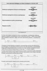

    As for the use of the "function" for detecting a rising or falling edge - its use is as wide as PLC applications are. Every controller has it implemented in one way or another - whether in timers, registers or directly as factory functions.
    a colleague has already given the method of slope detection based on basic operations *Paul* here as a development, i.e. step by step in LD or if you prefer siemens LAD - ladder diagram - http://www.plcs.net.pl/index.php/en/Kurs-Programowania-Sterownik%C3%B3w-PLC /operacje-na-bitsach-wild-discovery.html " target="_blank" rel="nofollow noopener ugc" class="postlink inline" title="" > http://www.plcs.net.pl/index.php/en/Kurs-Programowania-Sterownik%C3%B3w-PLC /operacje-na-bitsach-wild-discovery.html
    regards
    PS. By understanding how edge detection works, you can avoid confusion where it is not directly visible (e.g. ROL, ROR, SHL, SHR etc.)

    Do roks - the link probably does not work, he moved to plcs.net.pl but to the 404 page :)
    As for Paweł's entry - the first picture with the chart should be omitted because it is encumbered with an error.
    The previous state is NOT a negation of the current state, but only its mapping with a delay of one program cycle.
    greetings

    I tried to "improve" the link of my friend Roks regarding the detection of the slope from the website www.plcs.net.pl and I think it works now:
    BIT OPERATIONS - SLOPE DETECTION
The discussion focuses on understanding rising and falling edges in driver programming, particularly in Siemens S5 and S7 controllers. Participants share resources, diagrams, and practical examples to clarify how edge detection works. Rising edges indicate a transition from 0 to 1, while falling edges indicate a transition from 1 to 0. The S7 controller has built-in functions for edge detection, whereas S5 requires manual implementation. Examples include using edge detection for counting items on a conveyor belt and controlling timers based on sensor inputs. The importance of edge detection in avoiding issues with state changes in PLC applications is emphasized, along with the use of logical operations to manage input states effectively.
