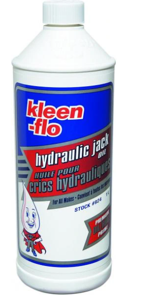

    We use hydraulic paraffin oil such as:
    Pouring into Hydraulic Jack: Choosing between Hydraulic Fluid & Lux Oil for Aluminum HousingHydraulic..ck.png (209.7 kB)You must be logged in to download this attachment.
    It is available for purchase at a price of about PLN 30 per liter.
    In fact, there could be anything there. For lack of something better at hand, I even poured the Z-HM into the "frog", which remained after the repair of the folding roof. Boxol, ATF are very well suited - those with low viscosity, used in power hydraulics. I do not recommend brake fluids - the rust eats the pistons, because they pull water.
