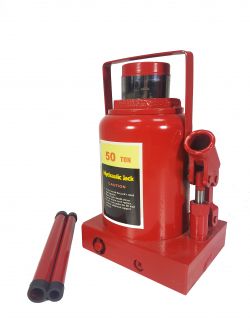

    Yes, I know, but I lent it to my father, and he confused (!) The bolts and drained the oil. I don't really know now how to flood it again so that it doesn't get airborne; /.
  • #4 10916898
    robokop
    Posts: 29412
    Help: 1763
    Rate: 6370
    Normally, you unscrew the filler screw, the one on the top of the body, pour oil over it and that's it.
  • #5 10916921
    tomaszgt1990
    Posts: 19
    Rate: 24
    For me, the fill plug is at the bottom side. I carried out the exchange in such a way that I lowered the piston, tightened the screw from lowering the piston, poured oil and unfortunately, when pumping, the piston did not rise at all; /.

  • #9 10917298
    kwok
    Level 40  
    Posts: 6234
    Help: 494
    Rate: 1339
    You put the jack on its side, unscrew the screw (plug), pull out the spring and the mushroom, and then pour the oil with one hand and pull the piston out to the end with the other hand. You fold and push the plunger, but the jack has to be upside down, ie "foot".
  • #10 10917521
    tomaszgt1990
    Posts: 19
    Rate: 24
    i.e. I have to flood the system upside down, after flooding, hide the plunger (the jack is inverted all the time), screw the cap, and it's ready?

    robokop wrote:
    Or maybe you would be kind enough to show what jack it is at all? Because you probably lost the ball.
    I have such a jack, I unscrewed the left screw too much and it fired with the oil.
    I poured the oil into the left one full, the jack won't even budge. What is the right screw for (there is one more screw and a spring in the middle).
    Now I think I saw a ball from the bearing nearby, is it possible that it was supposed to be in that left screw that shot me out?
    Hydraulic Oil Change for DP 3.5t Lift: Step-by-Step Guide & Recommendations
  • #17 17497441
    mirek_mgj
    Posts: 130
    Rate: 80
    Gentlemen, it's a simple design.
    The left screw (the one with the crossbar) is for locking/lowering the lifter and there is a shot (could be with a spring) and at least in theory it should lock so you don't accidentally unscrew it because it will shoot out under load.
    The second bolt with the spring and shot/plug (or something like that) is the place to fill/bleed the actuator.
    The best way is to unscrew the screw (the one with the screwdriver), turn it upside down and push in a funnel/needle tube or something that fits into the hole and fill it with oil (or the other end of the tube should be sunk in a bottle of oil - preferably thick, not engine oil - I poured hv46 hydraulic for heavily loaded ones and pull the actuator all the way out - so that it sucks in the oil. Then put the contraption together and lower and "overdrive" the actuator a few times until it stops. If you press the actuator (stand on it) - it goes down to the bottom, but then rises up by itself (it's airtight) - pump it up as far as it will go, then turn it over (upside down), stand on it, unscrew the screw to fold it up and release the air release screw (don't unscrew it completely or it will shoot out) to drain the air until oil starts to leak out. Then turn it over and check; if spontaneous ejection repeats, bleed again. If there is too little oil, it will not slide out completely; if there is too much, it will not slide out completely and will be hard as a stone. First bleed it a few times and only then, if necessary, can you "drain it a little from the cross".
