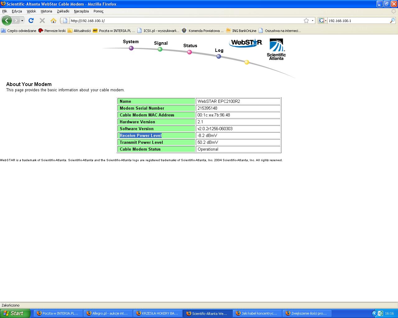

    It is like this with me:
    Choosing the Right Coaxial Cable for Internet Connection: Speed & Outdoor Usage - sebaele22 Inquiry
    If wrong, how should it be and where are these upstream and downstream parameters?
  • #11 6210020
    kasprzyk
    Electrician specialist
    Posts: 5595
    Help: 354
    Rate: 671
    You cannot move this modem at these levels. 40m of cable + connectors - you already have too little of the longstream.
    Report that you have problems with the internet to your operator, that your incoming signal is at -19 - and -15dB is acceptable.
    Kisses

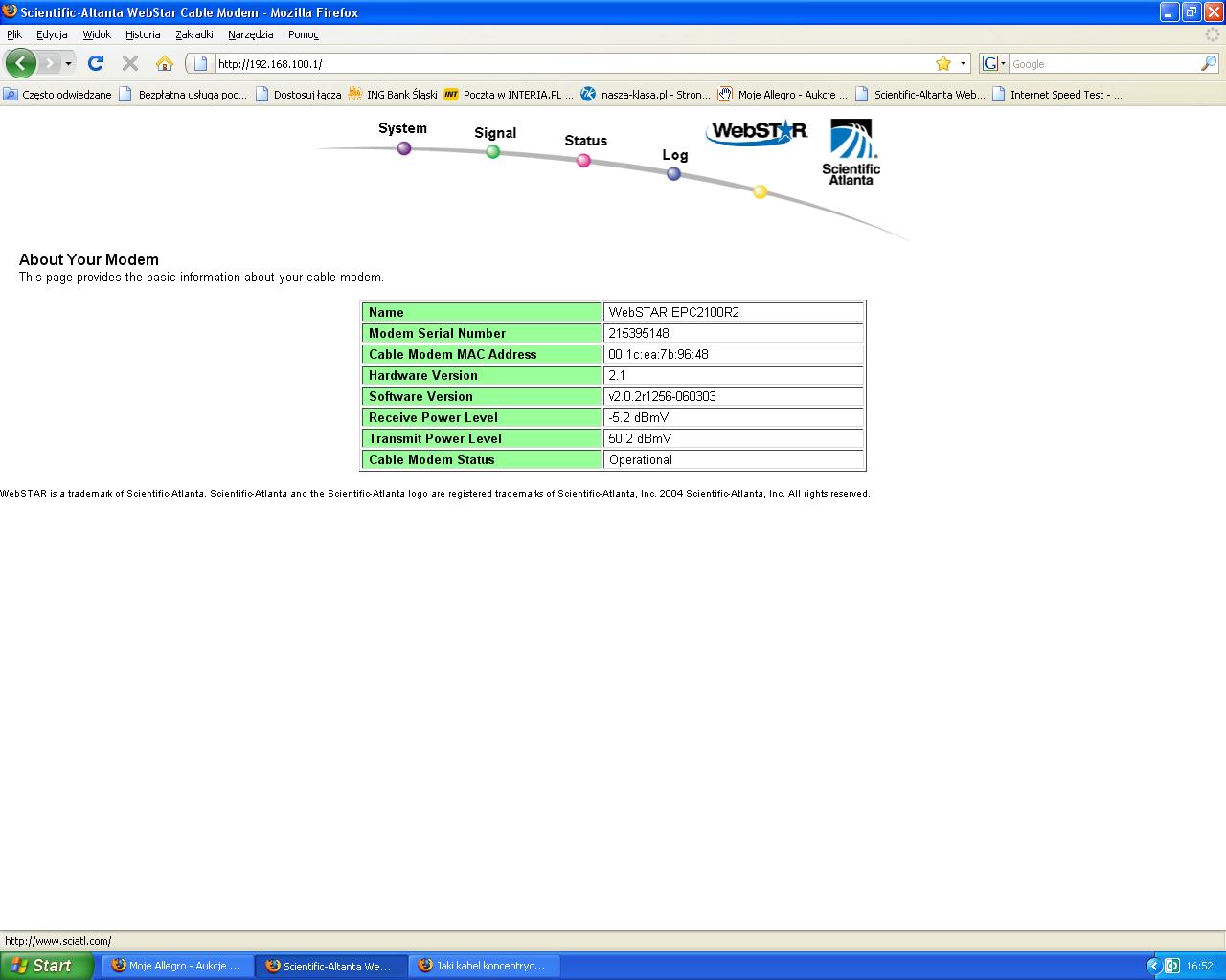

    Hello, I connected everything again and got a signal like this:
    Sometimes Receive Power Level changes to 6 dBmV, are the parameters correct?
    #14 6249867
    kasprzyk
    Posts: 5595
    Help: 354
    Rate: 671
    It's ok, when Receive jumps by a few decibels, something may be damaged, it's good for you.

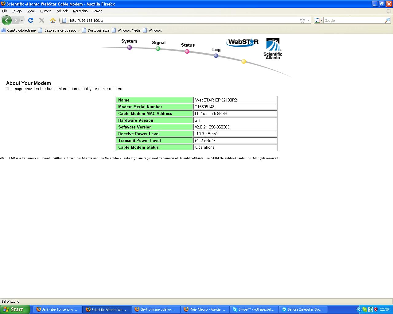

    Hello again, some time ago I replaced the coaxial cables from the Internet and the Receive Power Level signal deteriorated:
    What could it be to blame!
  • #29 6860158
    kasprzyk
    Posts: 5595
    Help: 354
    Rate: 671
    how many have you had before
  • #30 6860165
    sebaele22
    Level 30  
    Posts: 3487
    Rate: 513

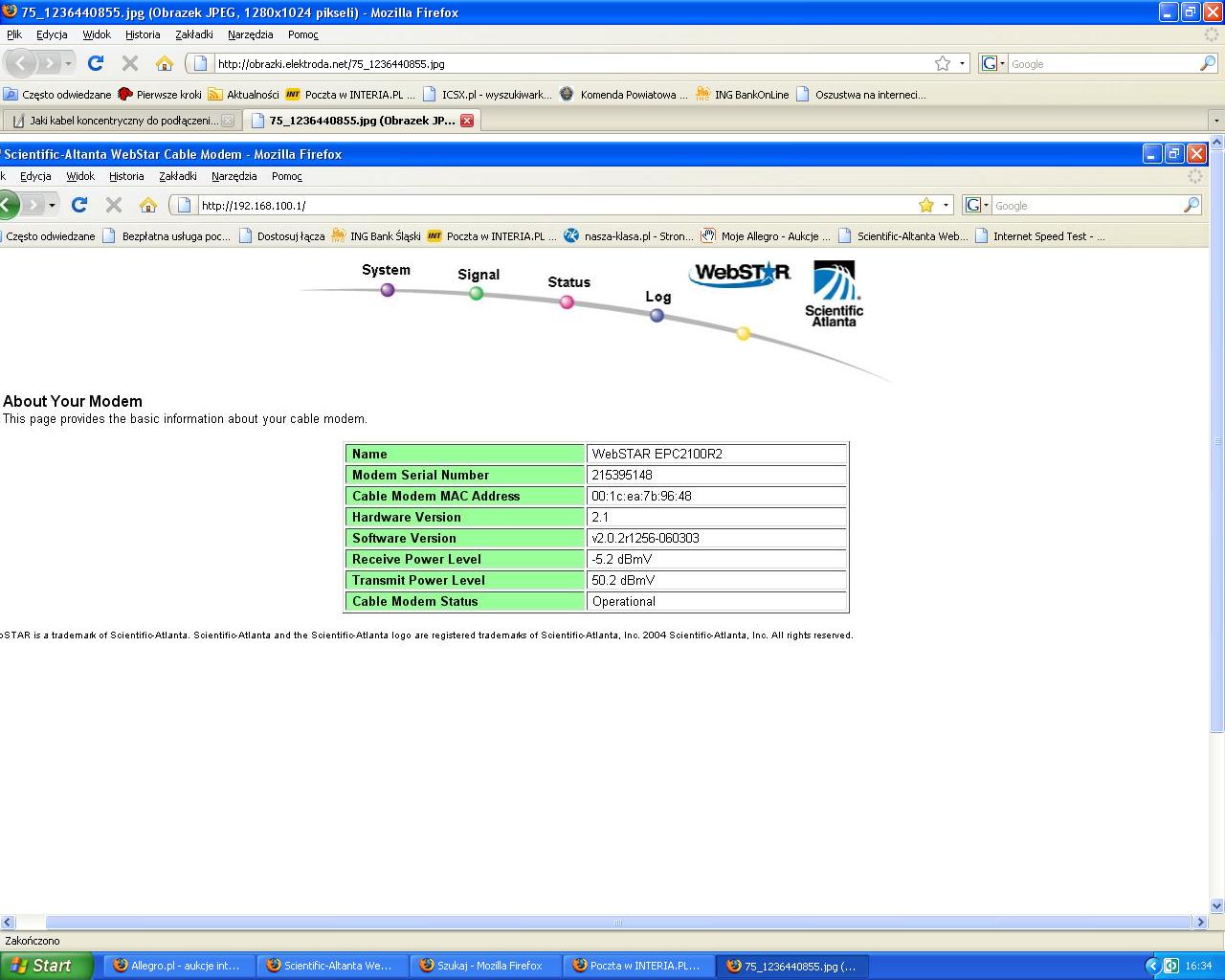

    Before replacing the cable, I had this:
    I would like to add that I replaced the coaxial cables with a copper wire inside, and earlier I had a steel wire (whitewashed copper).
