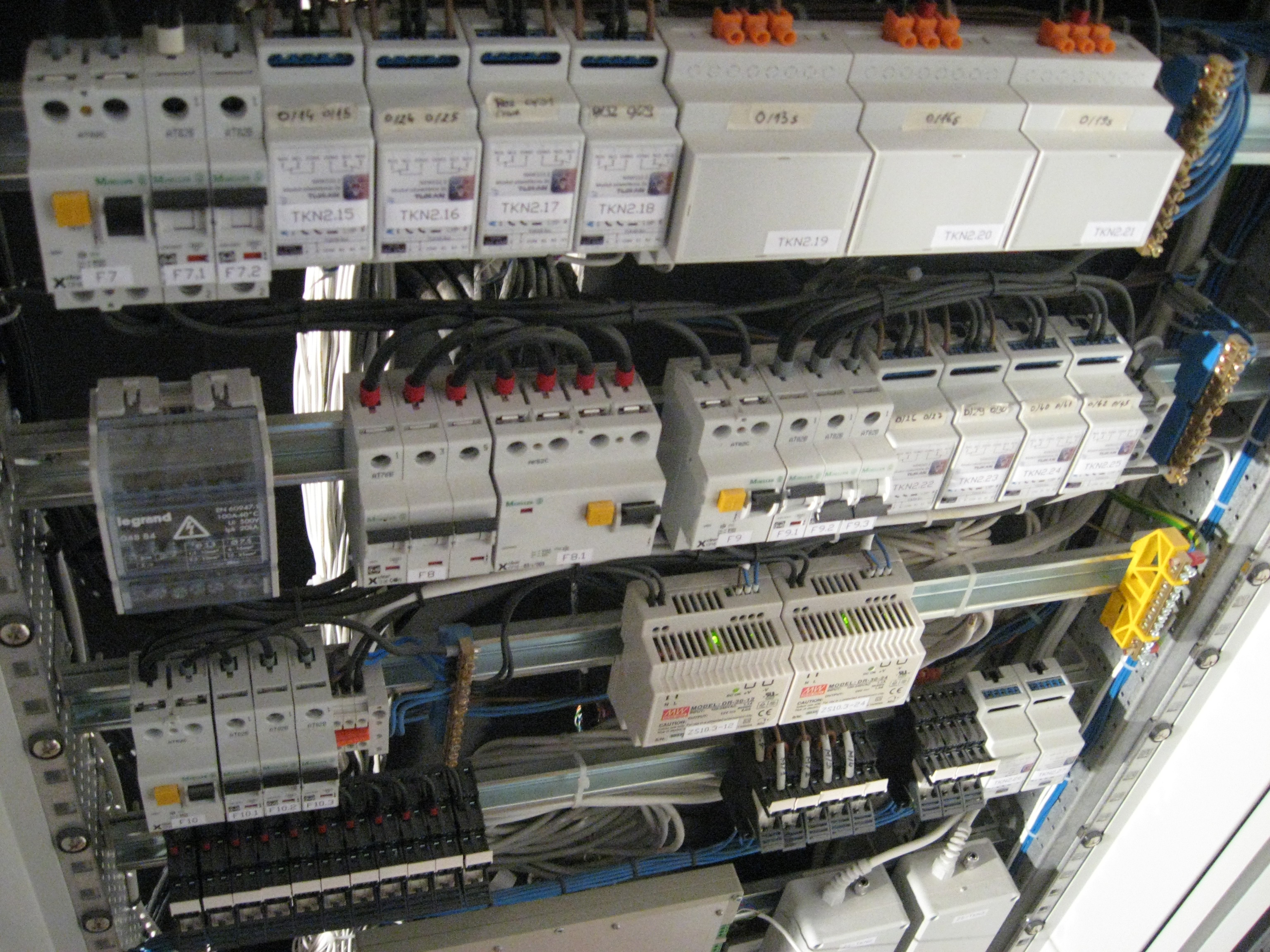

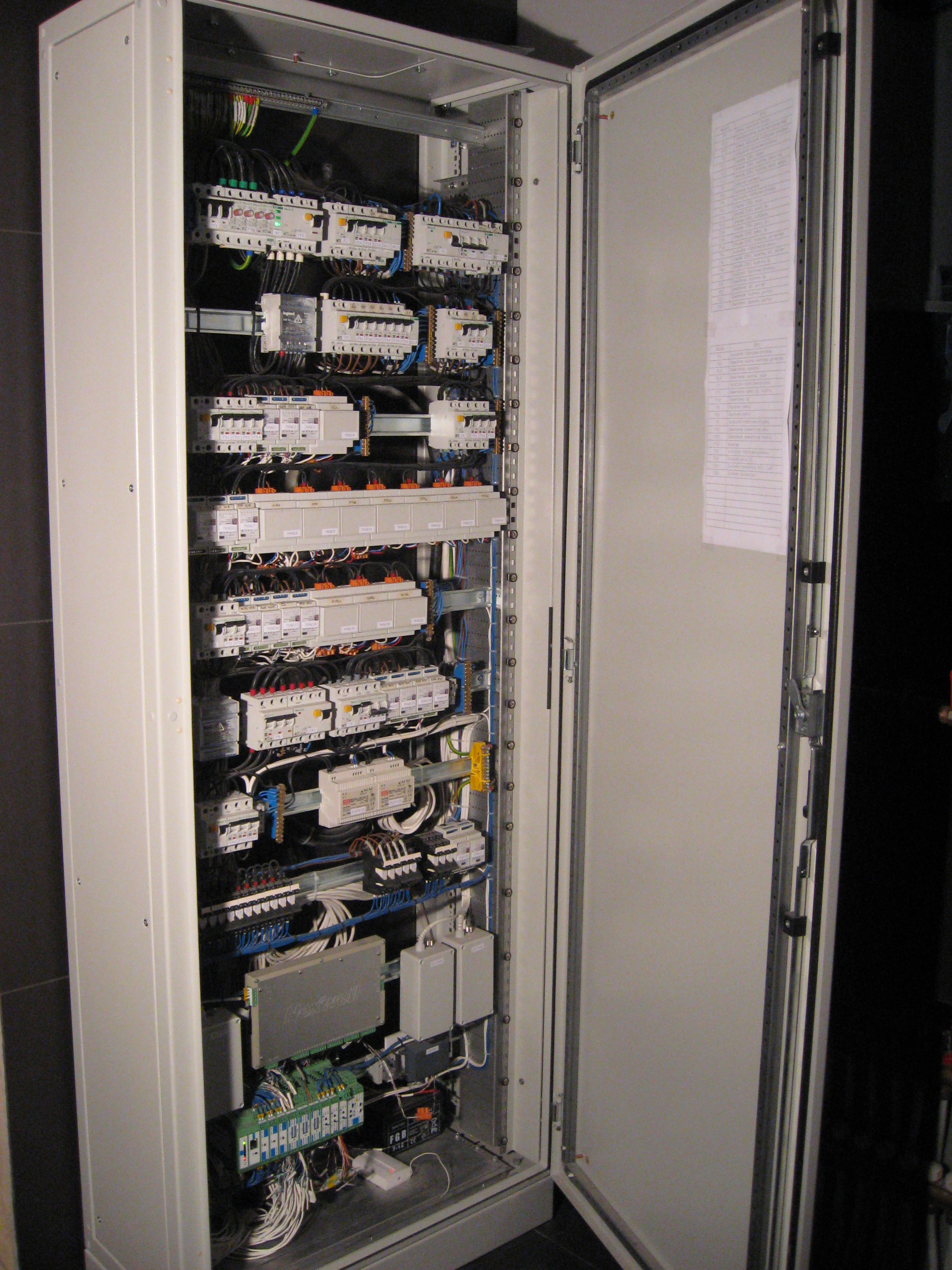

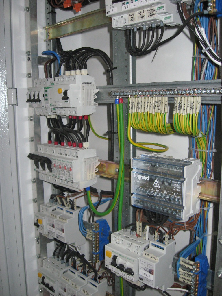

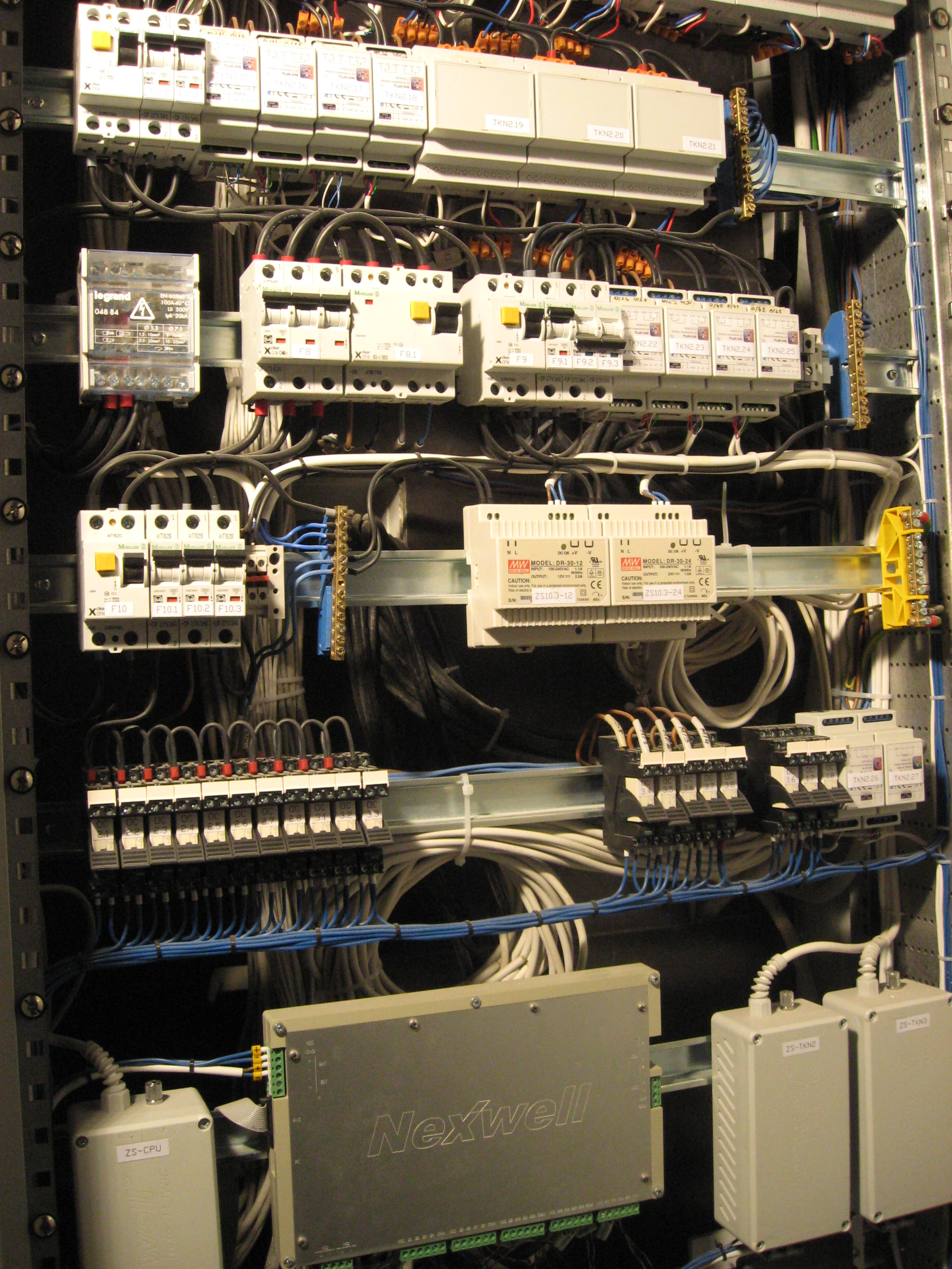

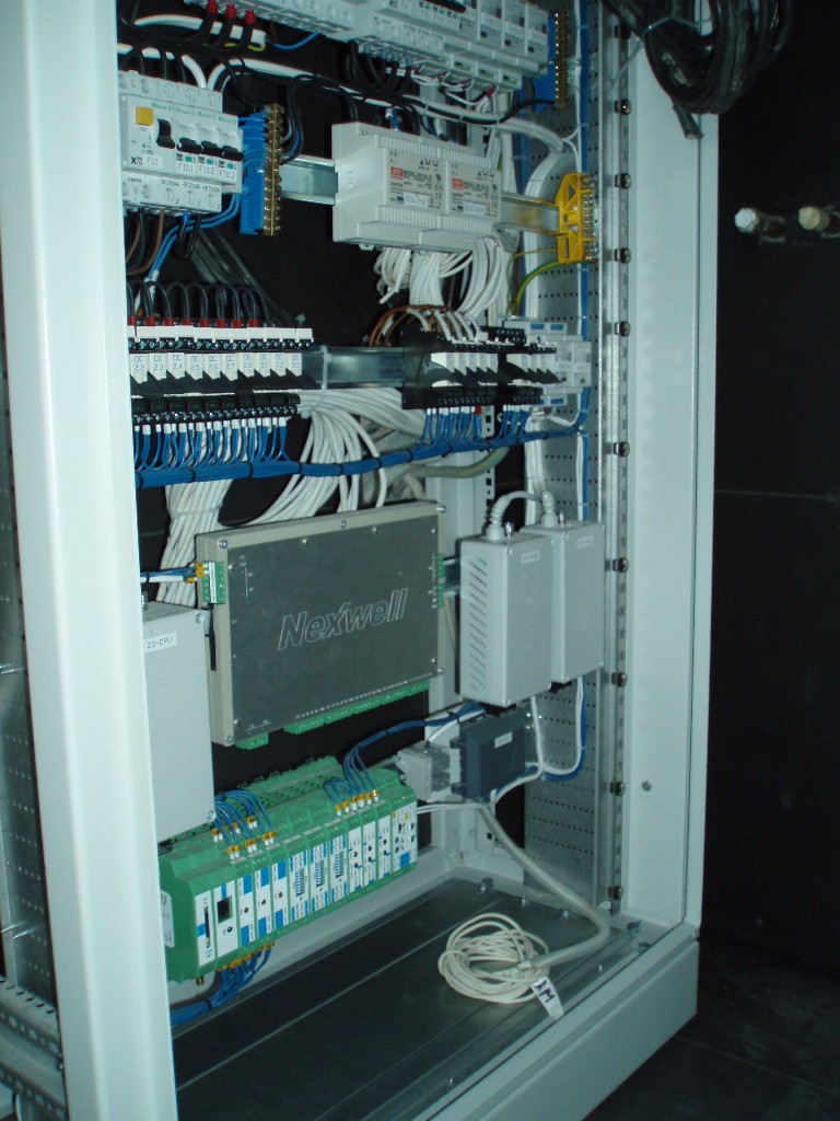

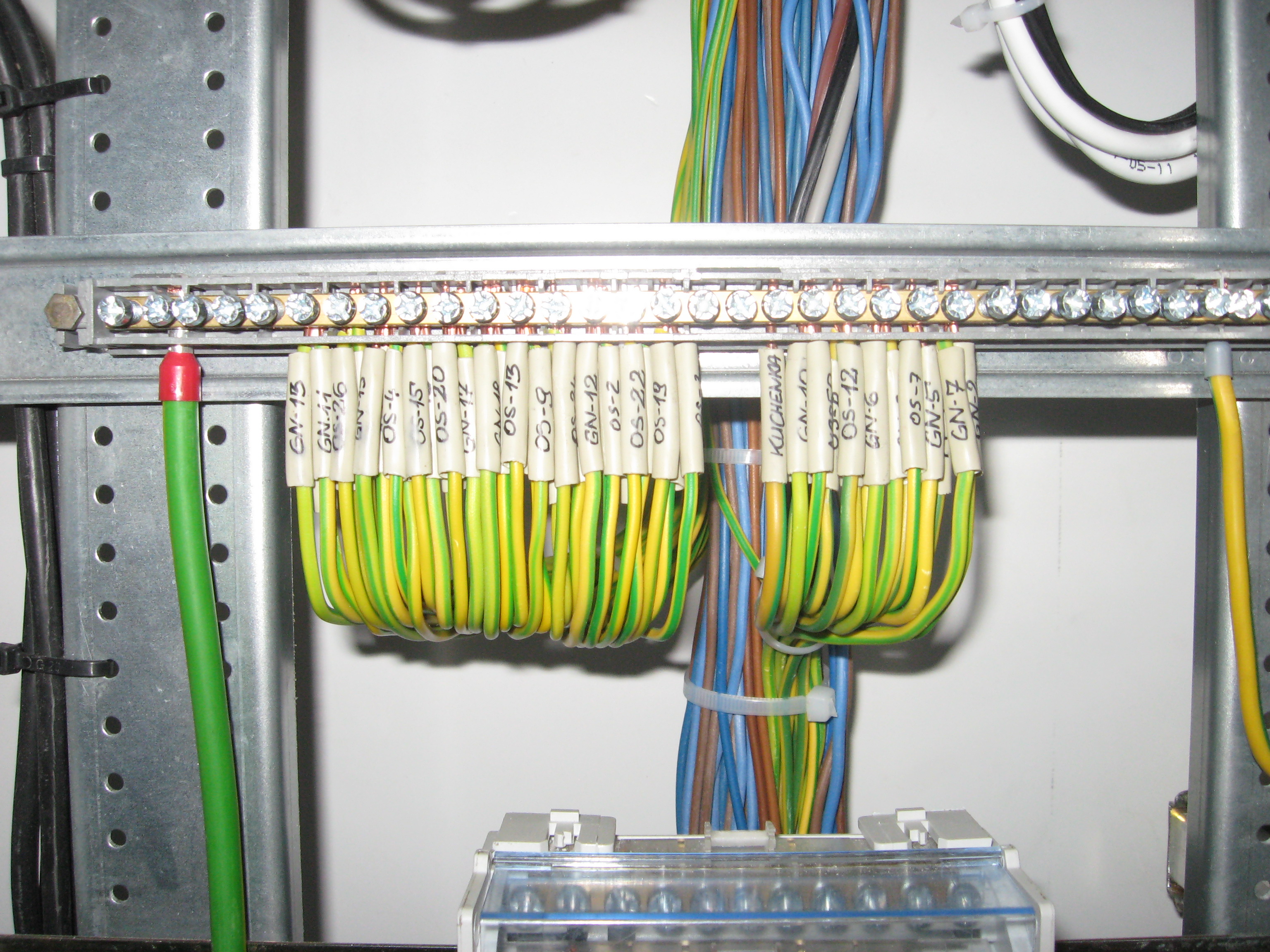

    I see this topic has flared up again. Krzysztof, from what I’ve gathered from your posts, it seems that much of the blame lies with you. You bought a VW and expect it to be like a Ferrari.
    Nexwell has a good system. All things considered, in terms of value for money, it’s one of the leaders on the Polish market.
    I’ve made a few investments in Nexwell so far, and my customers are satisfied.
    The largest one consists of:
    - 2 CCFL touchscreens
    - 2 zone keypads
    - 8 programmable buttons
    - 21 thermometers (for controlling the boiler and solenoid valves)
    - 20 lighting modules (the old type, i.e. each with 2 outputs)
    - 11 dimmers
    - 6 relay modules (also old-style)
    - 1 analogue output, 1 RGB output, LAN, GSM,
    - 3 input cards, 3 OC-type cards, video intercom
    - 2 local control units
    Most of the system components are housed in distribution boards, 3 Tukan buses, several dozen reed switches in windows
    and doors, a dozen or so PIR sensors, carbon monoxide detectors, etc.,
    everything works flawlessly, nothing freezes, the system’s response time when a
    programmable button is pressed is practically imperceptible, and the footage from the recorder and video doorphone can be viewed on the panels
    it works exactly as it should, although the installations need to be thought through and designed so that they
    right from the start. A total of over 3 km of cables were laid in the plasterwork for the above-mentioned installations, plus 1 km buried underground; the
    low-voltage circuits are kept separate from the 230V supply,
    to sum up
    I can see that my colleague Krzysztof has unrealistic expectations of the NEXO’s already considerable capabilities; I refer you to the NEXO motherboard’s technical documentation
    ; if in doubt, please feel free to visit the projects I have completed
    Best regards

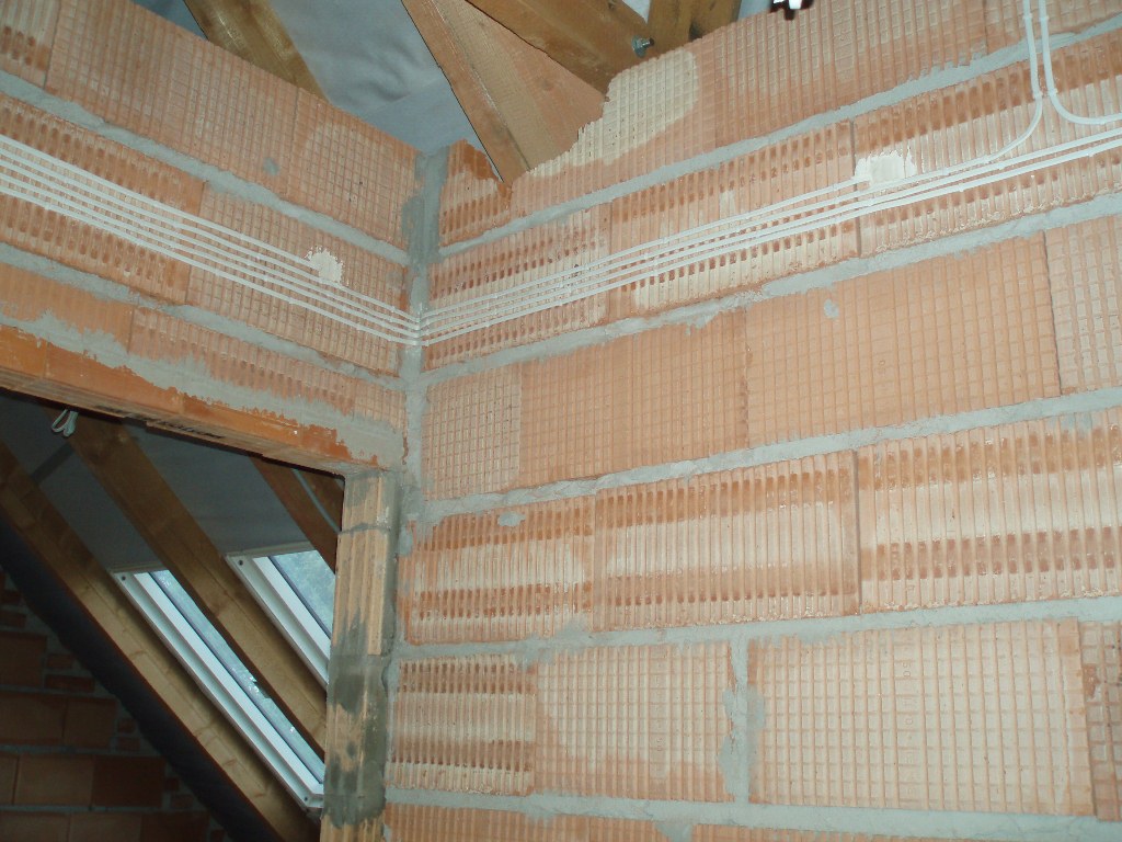

    The installation was carefully thought out and designed from the very beginning; as I mentioned earlier, the entire infrastructure was laid over three years ago.
    It’s true that Nexwell didn’t have everything they offered me at the time, but unfortunately I wasn’t aware of that.
    As for the cabling, the control cables are not only kept away from the power cables but are also shielded with a special metallised foil (or something like that).
    Please don’t refer me to some ‘Nexo motherboard technical documentation’ because I’m not an installer, so I wouldn’t understand much of it.
    I’m a customer who signed a contract with Nexwell over three years ago, laid the cabling in accordance with the instructions of their manager (he checked it on site before the screed was poured) and, unfortunately, to this day I am unable to make full use of what was supposed to be connected.
    Is it my fault? Or have I bought a VW but am expecting a Ferrari? :-) )
    Everything I planned to have connected was handed over right at the start (in the meantime, a few sockets were added – which, incidentally, Michał Kowalczyk himself persuaded me to install) and bear in mind that I didn’t buy all those components at a flea market and set about installing this ‘system’ myself; I simply signed a contract with a company that undertook to do something in return for a specified fee and failed to honour the contract.
    If you can spot any fault on my part here, please specify exactly where.
    Do you think I forced them to issue invoices for all the components installed at my place, or did they do it themselves in an attempt to make as much money as possible????????? And they miscalculated a bit :-) ) – do you think I’m to blame for that?
    Best regards,
    Krzysztof Łukaszewski
    Added after 7 [minutes]:
    I may not have mentioned this at the start, but I didn’t connect any of the equipment installed in my home myself – everything was carried out by Nexwell staff.
    My role was limited to laying the cables in accordance with the instructions received from Nexwell, and as for the length of the cables, there was over 6 km of electronic cabling alone, including FTP cables for the screens and thermostats.

    The company I represent has carried out several fully completed installations of the Nexo system, as well as many other systems: Inels, Dupline, and numerous projects in the field of industrial automation.
    A major advantage for Nexwell is… the fact that, so far, there have been no problems.
    We have commissioned exactly four – and I emphasise ‘highly’ – complex systems, and we have not encountered any problems with any of these projects, apart from three temperature sensors, which were repaired within a day of being delivered to our premises.
    I don’t want to go into details, but in any case, 100% of our installations carried out on the Nexo system are operating reliably.
    We warmly invite anyone interested to join us on our next projects – currently under construction (as it should be done by the book – surprisingly, the art of cable routing isn’t all that simple – Uncle Heniek, the electrician, might not be able to handle it) or those already in operation (in this case, please ring 661 465 095 to discuss the details of a visit and a presentation).
    We carry out Nexo system installations comprehensively from start to finish (design, cabling) right through to completion (commissioning, as-built drawings, final handover), and this is probably why we haven’t encountered any problems.
    On this basis, I can say that the system works and is well worth recommending.
    Please take a look at our projects.
    Please also take a look at the photos:
    https://obrazki.elektroda.pl/8897537700_1319063879.jpg
    https://obrazki.elektroda.pl/9594615000_1319063884.jpg
    https://obrazki.elektroda.pl/6343008400_1319063887.jpg
    https://obrazki.elektroda.pl/9195962400_1319234283.jpg
    https://obrazki.elektroda.pl/7315462400_1319234285.jpg
    https://obrazki.elektroda.pl/8544770800_1319234287.jpg
    https://obrazki.elektroda.pl/5853053500_1319234288.jpg
    https://obrazki.elektroda.pl/8700011000_1319234291.jpg
