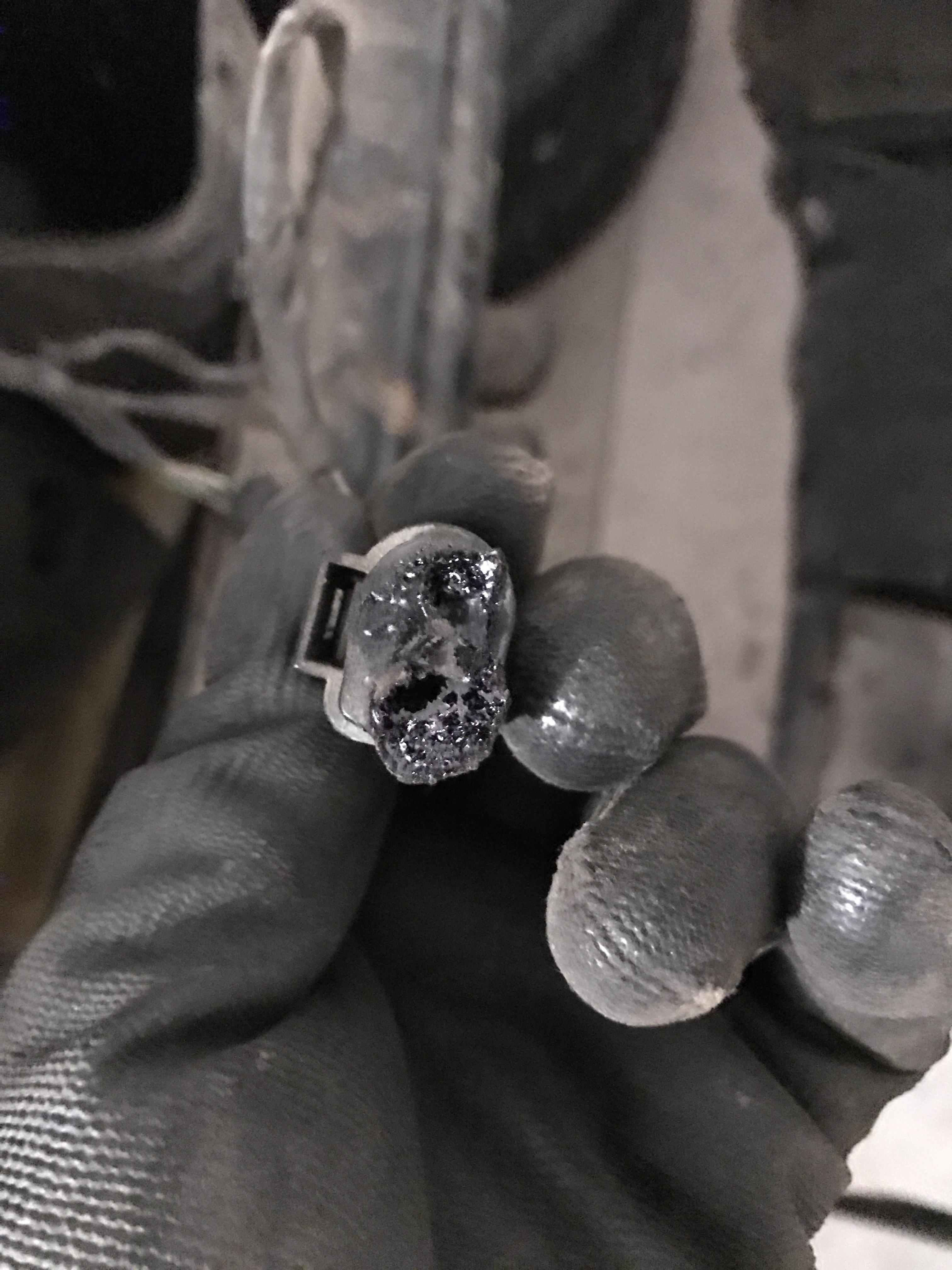

    Seat Ibiza cupra 1.4 tsi. Why are the bulbs behind to be checked? And which ones, because I replaced the lamps a month ago with other ones
    Added after 14 [minutes]:
    Oh, and what can I add? Restriction lighting bulbs just burned down with cubes, etc., everything flooded.
    But I do not know if it will be important because the car does not go out when I take out the key ??

  • #35 16225753
    Sudy2505
    Oki, I will check tomorrow and let you know for sure ?
    And as for the melted lights, I will add all together with the registration housing on the back, I found a mass and plus they were rubbed slightly, let it be it

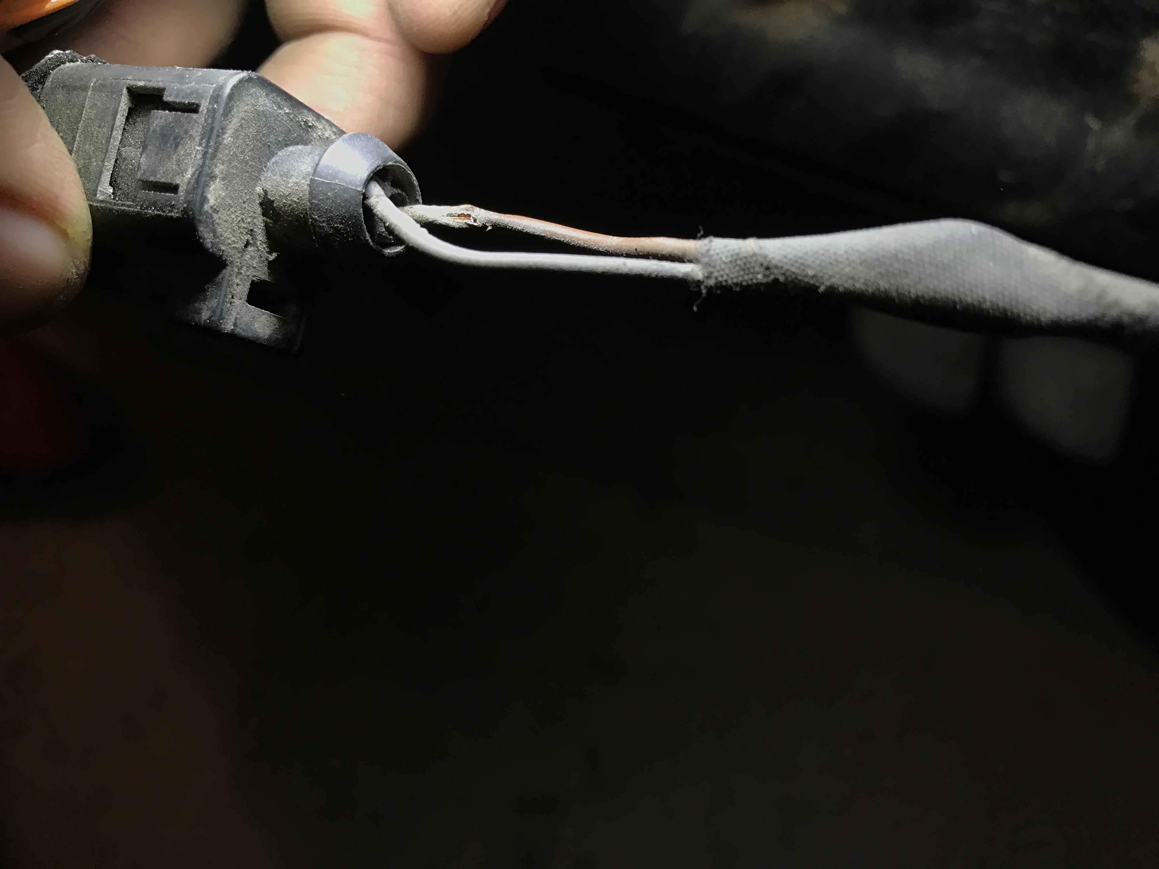

  • #36 19834675
    kacperkisiel333
    Hello, I recently had an identical case (Mondeo MK3 2.0 TDCi)
    In my case, the torn Webasto control cables turned out to be the culprit, when they short-circuited, the car did not want to go out even after removing the key, only when I was strangling it, it went out but the clocks were still on.
    After the cables were insulated, the problem disappeared.
    I hope I helped someone.
