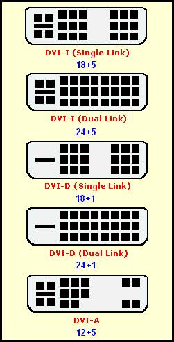

    needs an HDMI to DVI adapter. Among the available adapters (cables) I found two types of DVI 18 + 1 and 24 + 1. Could someone explain to me what is the difference between the DVI 18 + 1 plug and the 24 + 1 plug in this adapter? Will there be better image quality or what?
    Thanks for the help.

    1) Examples of working resolutions (single channel) - DVI SINGLE LINK:
    o HDTV (1920 × 1080) @ 60 Hz with 5% LCD flicker (131 MHz)
    o UXGA (1600 × 1200) @ 60 Hz with GTF (161 MHz) flicker
    o WUXGA (1920 × 1200) @ 60 Hz (154 MHz)
    o SXGA (1280 × 1024) @ 85 Hz with GTF flicker (159 MHz)
    2) Examples of working resolutions (dual channel) - DVI DUAL LINK:
    o QXGA (2048 × 1536) @ 75 Hz with GTF flicker (2 × 170 MHz)
    o HDTV (1920 × 1080) @ 85 Hz with GTF flicker (2 × 126 MHz)
    o WQXGA (2560 × 1600) @ 60 Hz flicker GTF (2x174 MHz) (30 "LCD Dell, Apple, Samsung, HP, Quinux)
    o WQUXGA (3840 × 2400) @ 33 Hz with flickering GTF blanking (2x159 MHz)

    The differences in the supported resolutions are related to the use of DVI-I 24 + 1, thus the refresh rate increases if the receiver allows it.
    In your case, it may only be theory and the refresh rate and resolution will remain the same as when using the DVI-I 18.1 cable.
    You can buy it in advance, unless the receiver you want to connect supports higher resolutions (as the data and the picture show) and supports higher refresh rates.
    What do you want to connect?
    (provide video card, TV model or projector model)
    Regarding your question: if you have equipment that supports higher resolutions and higher refresh rates, it is worth buying an HDMI - DVI-I 24 + 1 cable.

    If a cheaper adapter, as it probably is, buy HDMI - DVI 18 + 1.
    The graphics card supports - it gives a full HD 1080p image, i.e. a resolution of 1920 × 1080. Max type: DVI SINGLE LINK
    However, your monitor does not display full HD 1080p because it has a chapter: 1680x1050.
    But where are you going to connect those HDMIs in this monitor?
    Higher resolutions? question (in your context, HDMI will mean the number of horizontal lines) - just read, I won't rewrite or quote.
