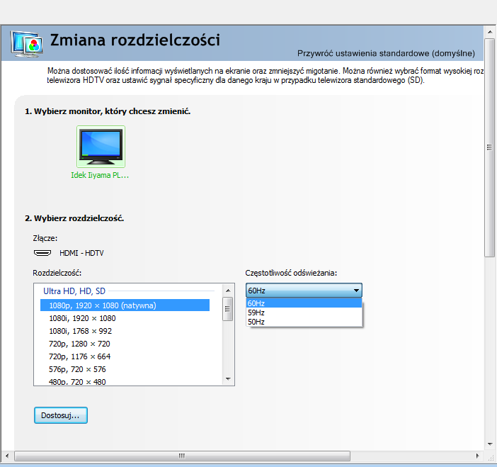

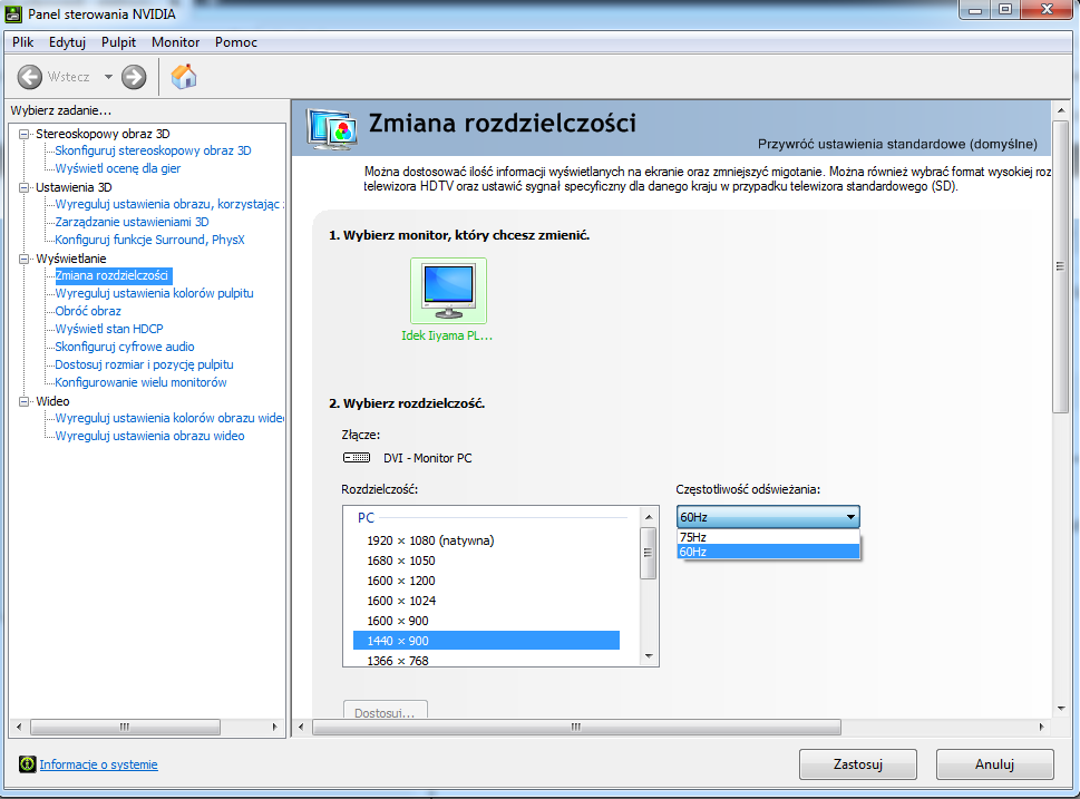

  • #7 17068058
    humbas
    Posts: 33
    It looks like:
    Best Monitor Cable for Iiyama G-Master Black Hawk G2530HSU-B1 & GE2488HS-B2: HDMI, DVI or DP?
    But with the lower one you can:

  • #11 17068367
    icosie
    Posts: 1908
    Help: 298
    Rate: 239
    See if you have the same in both DVI sockets.
    If so, it turns out that you may not get more than 60 frames because you have a poor card.
    Especially in demanding games.

    humbas
    Posts: 33
    There is still no revelation, and Freesync is only for reds, and I have a Nvidia card
    On HDMI it looks like this, still there are 75

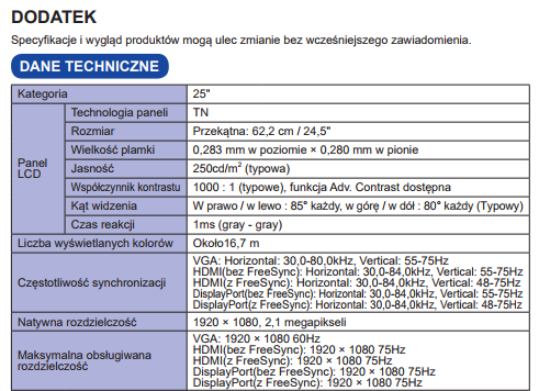

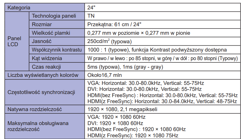

  • #17 17068485
    icosie
    Posts: 1908
    Help: 298
    Rate: 239
    And everything is clear.
    Manufacturer's operating instructions, page 29:
    And the latter has something like this:
    So it should have 75Hz without a problem.
    If you can try to exchange with an extra charge as you need these 75Hz. [/ Img]
