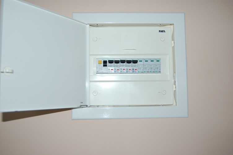

  • #28 6585050
    130880
    Posts: 22
    Rate: 11
    I connected the limiter, but it seems that the problem still exists. When I turned on the main fuse, the socket fuse at home blew. I will test it more thoroughly today.
    I am sending photos from the installation:
    Frequent Breaker Trips: Testing Differential and Fuse Blowouts with Iron Use
  • #29 6585063
    Darrieus
    Posts: 3684
    Help: 406
    Rate: 289
    There must be a faulty varistor in one of the strips and it releases too quickly, check without the strips, or check the strips one by one.
    The switchboard is not the height of professionalism ;)
    PS It probably came from the socket, where is that bad strip?

    I didn`t do it separately and it`s much better now than it was when I first opened it. During the next renovation, I plan to replace it and then I will tidy it up. Either way, I have extra security. I will disconnect the strips and check without them (but only in the evening). In total, I have two strips connected in series on this socket, one of which also has a TV antenna connected.
